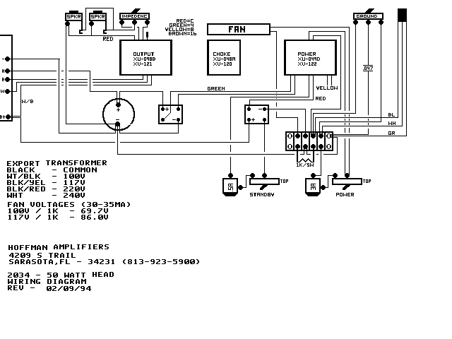

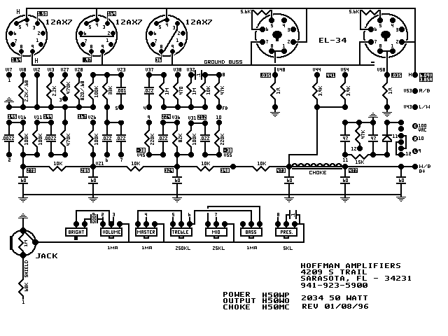

The Original 50 watt Hoffman head layout diagrams.
These heads were called model 2034
Notice that the heaters were run on DC on early models.
 That was dropped later on and the heaters were run conventionally on 6.3 volts ac.
Wiring Diagram
