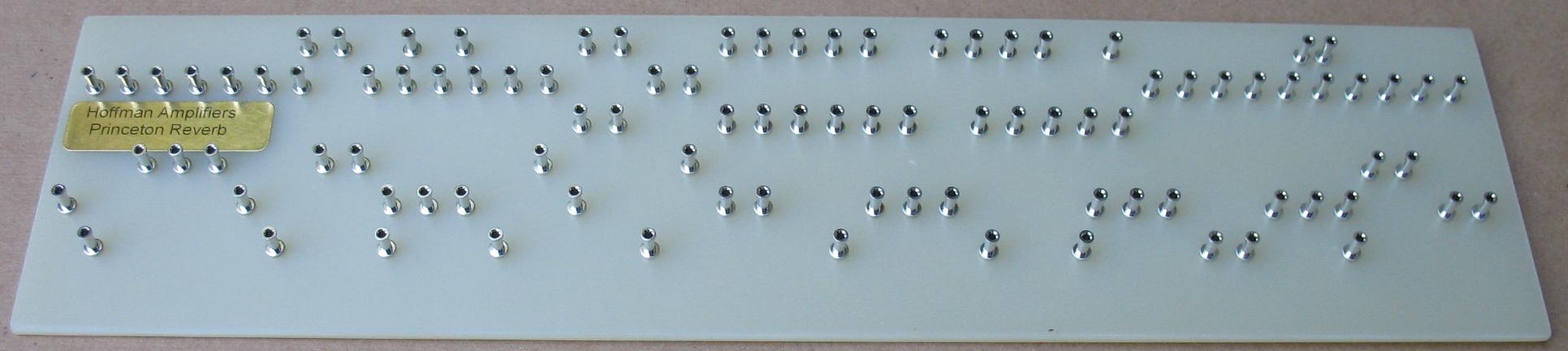

This is the board with the Turret lugs swaged onto the board
Princeton Reverb board
The lugs have been laced and soldered

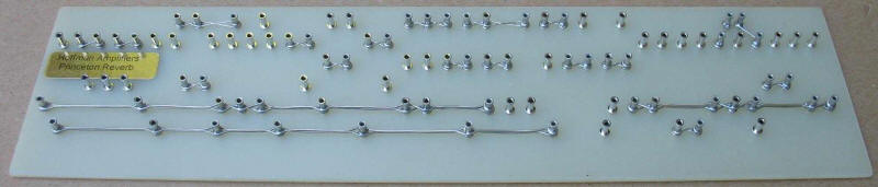

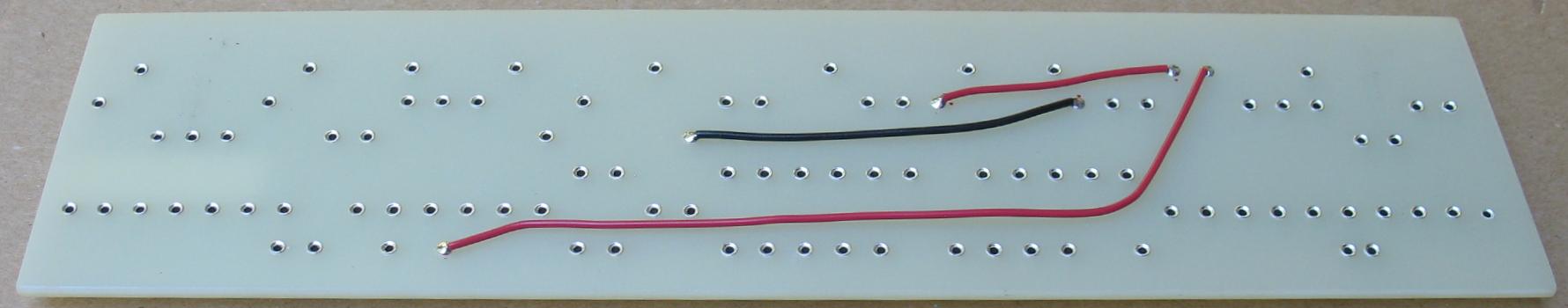

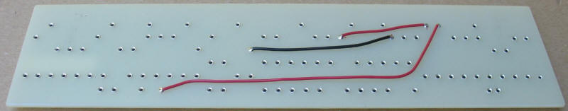

Hoffman Princeton Reverb Board
On the back of the board there are 3 jumper wires

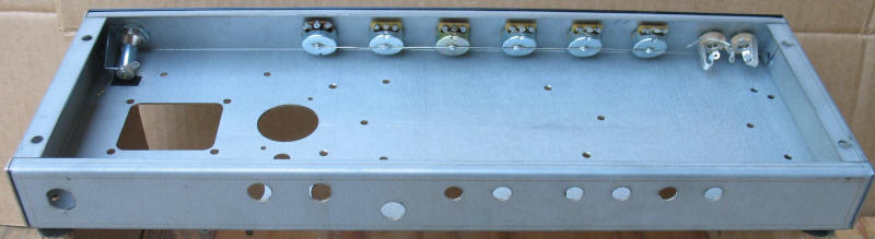

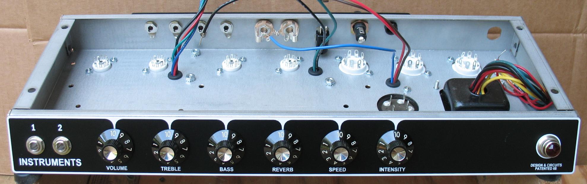

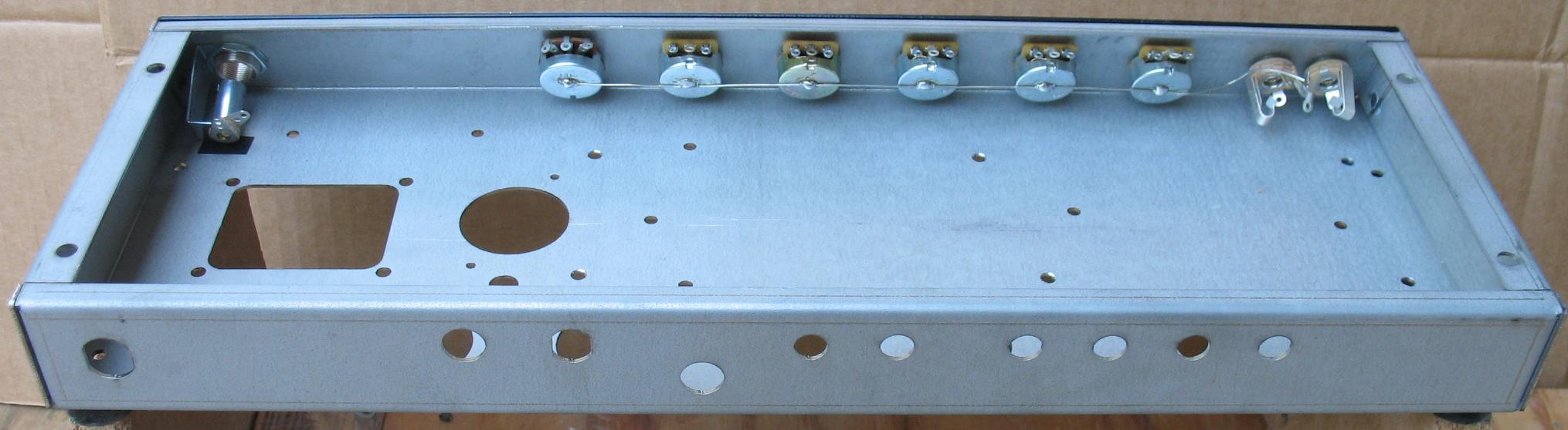

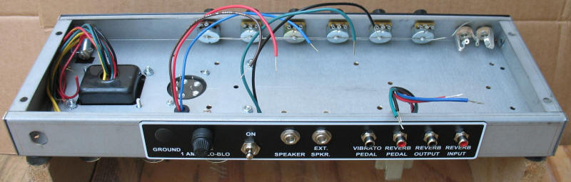

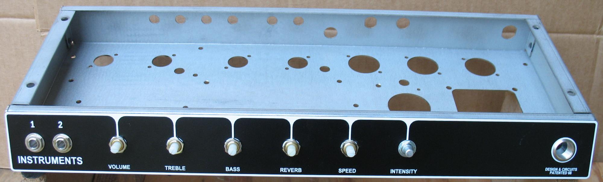

The blank Princeton Reverb Chassis with the face panel and parts installed
The buss wire has been soldered down the back of the pots

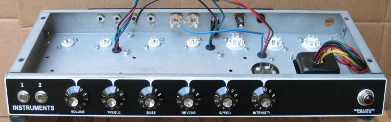

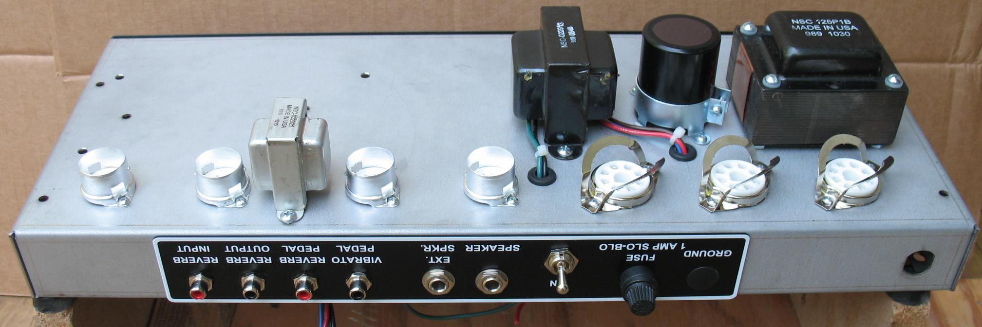

The rear panel and all the parts have been installed
All bolt on parts have been installed
Tube sockets, Transformers, Jacks, On/Off Switch, Fuse holder, Filter cap
I blocked off the ground switch hole with a hole plug

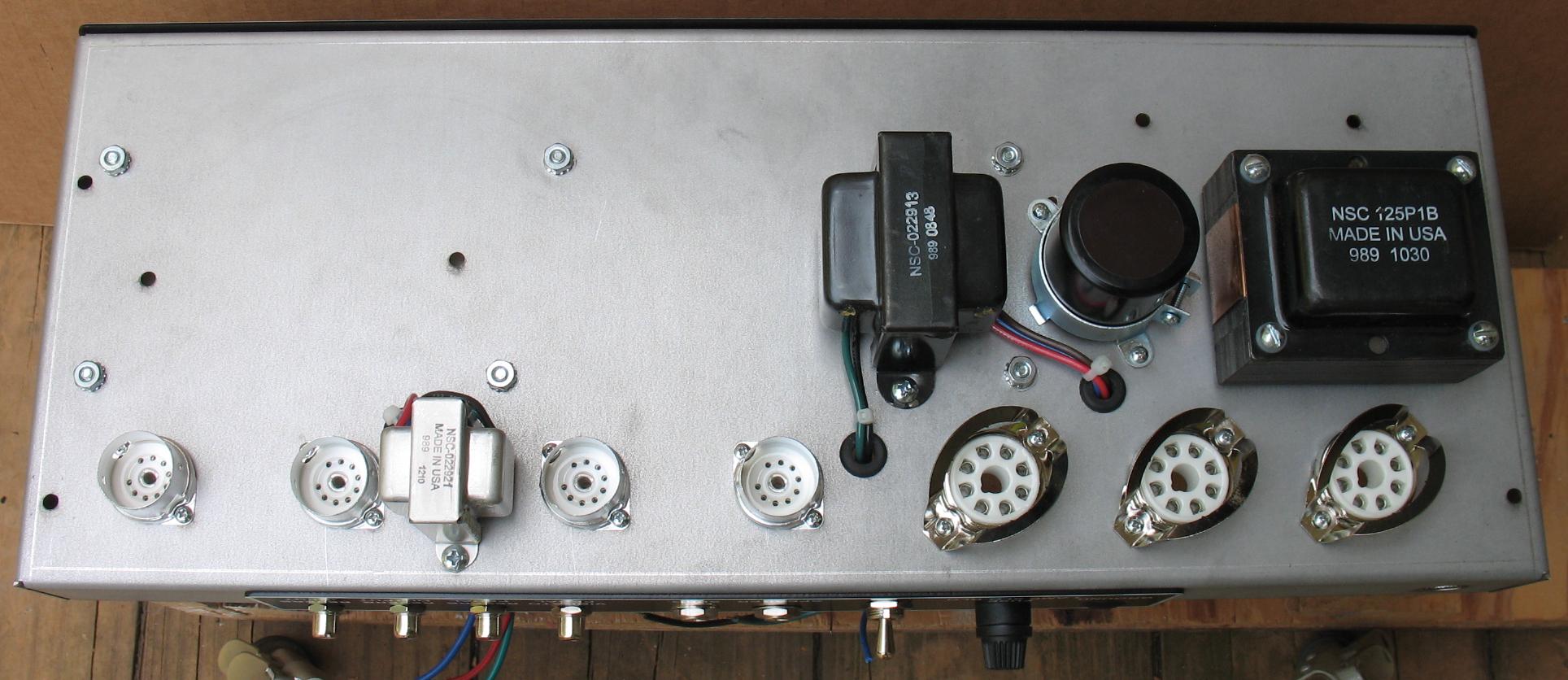

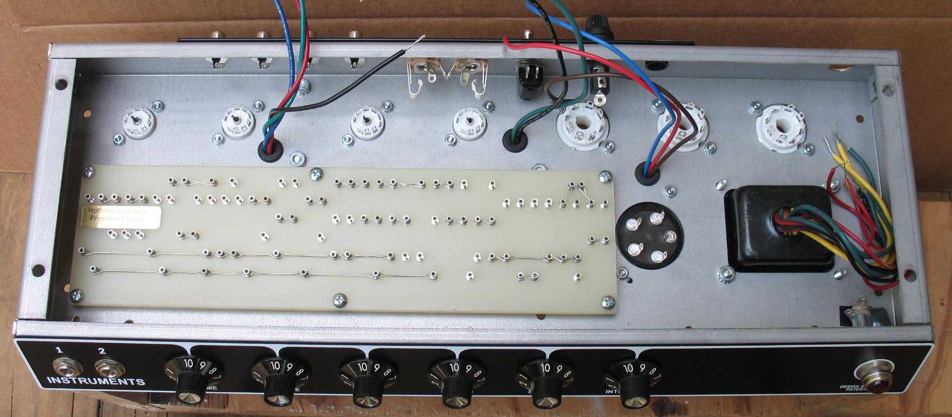

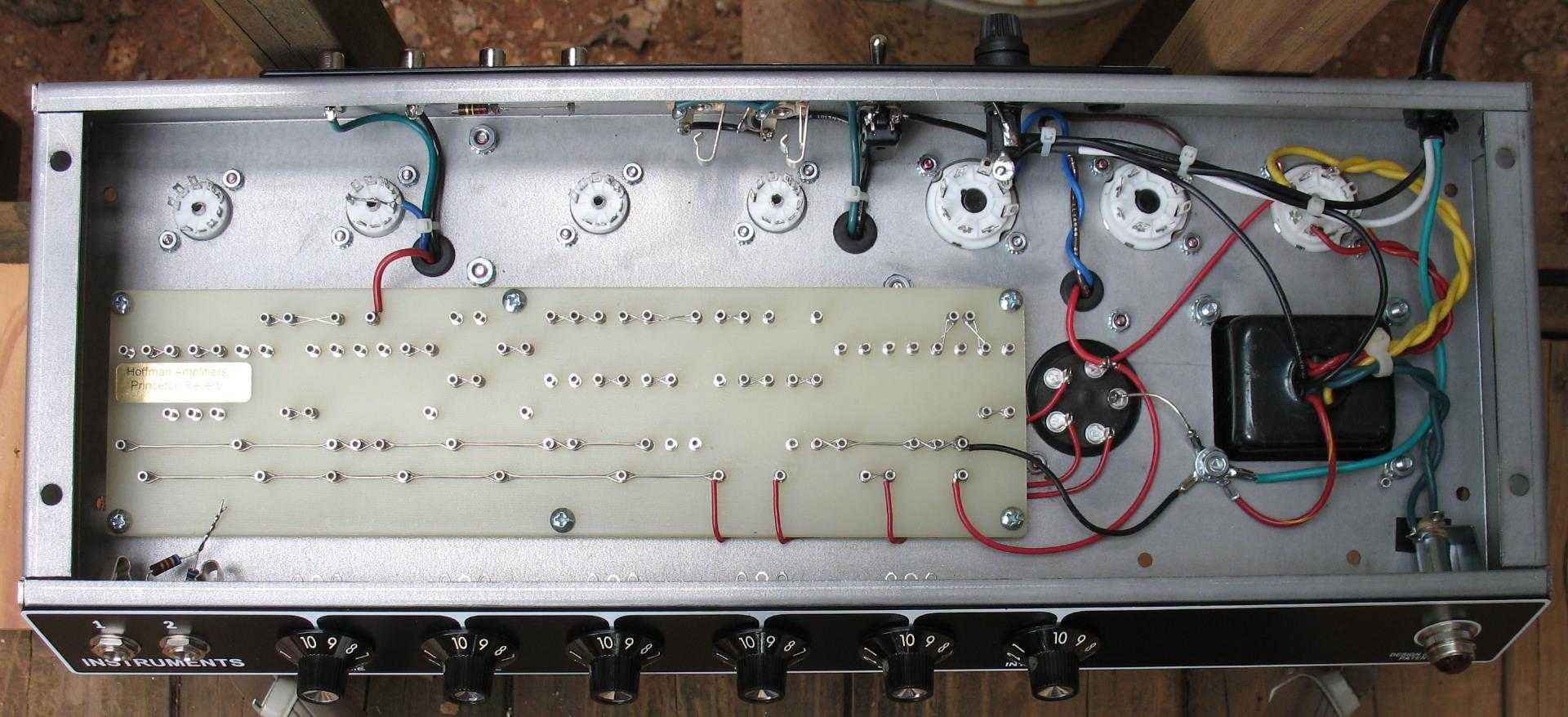

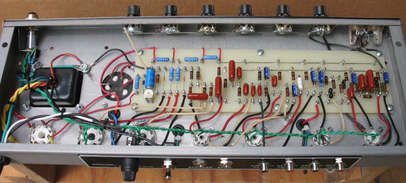

Princeton reverb board
Top View: The board has been mounted
This is the modifies board with the 2 x 100 ohm resistors removed
The new boards will all look like this board
Bottom View
Bottom View

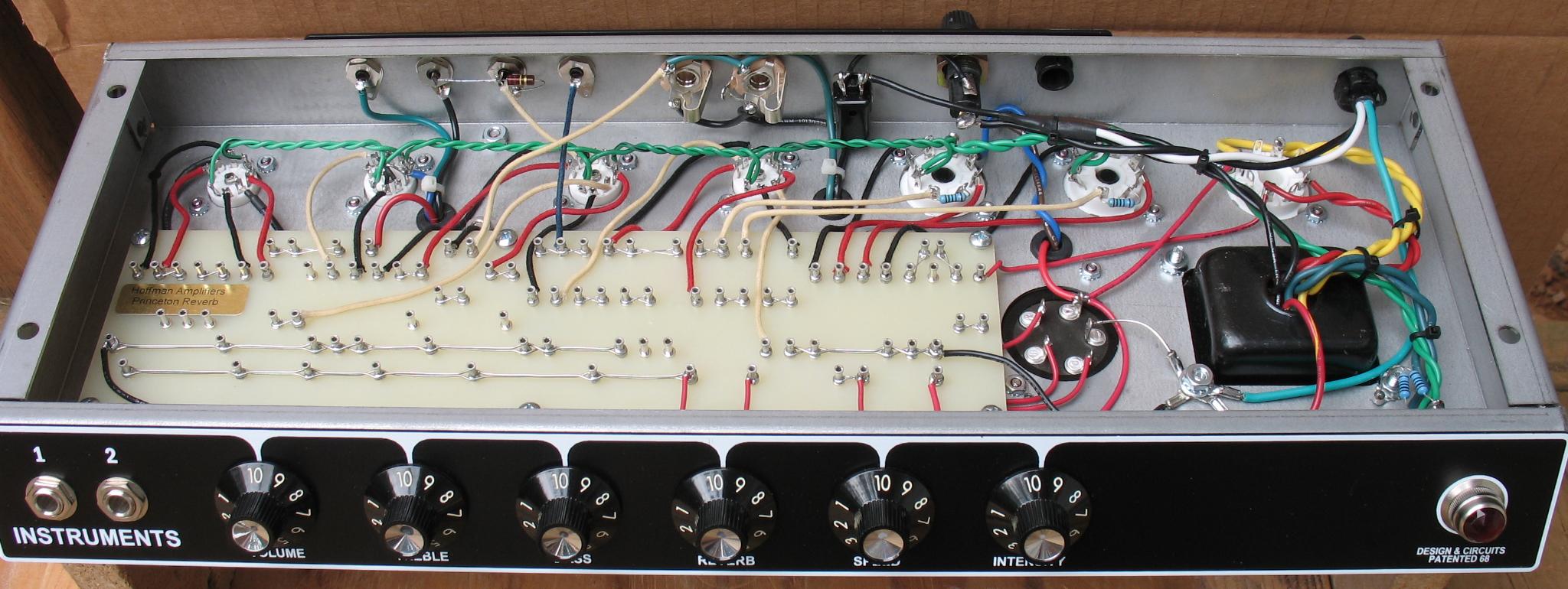

Got a bunch of the infrastructure wiring completed

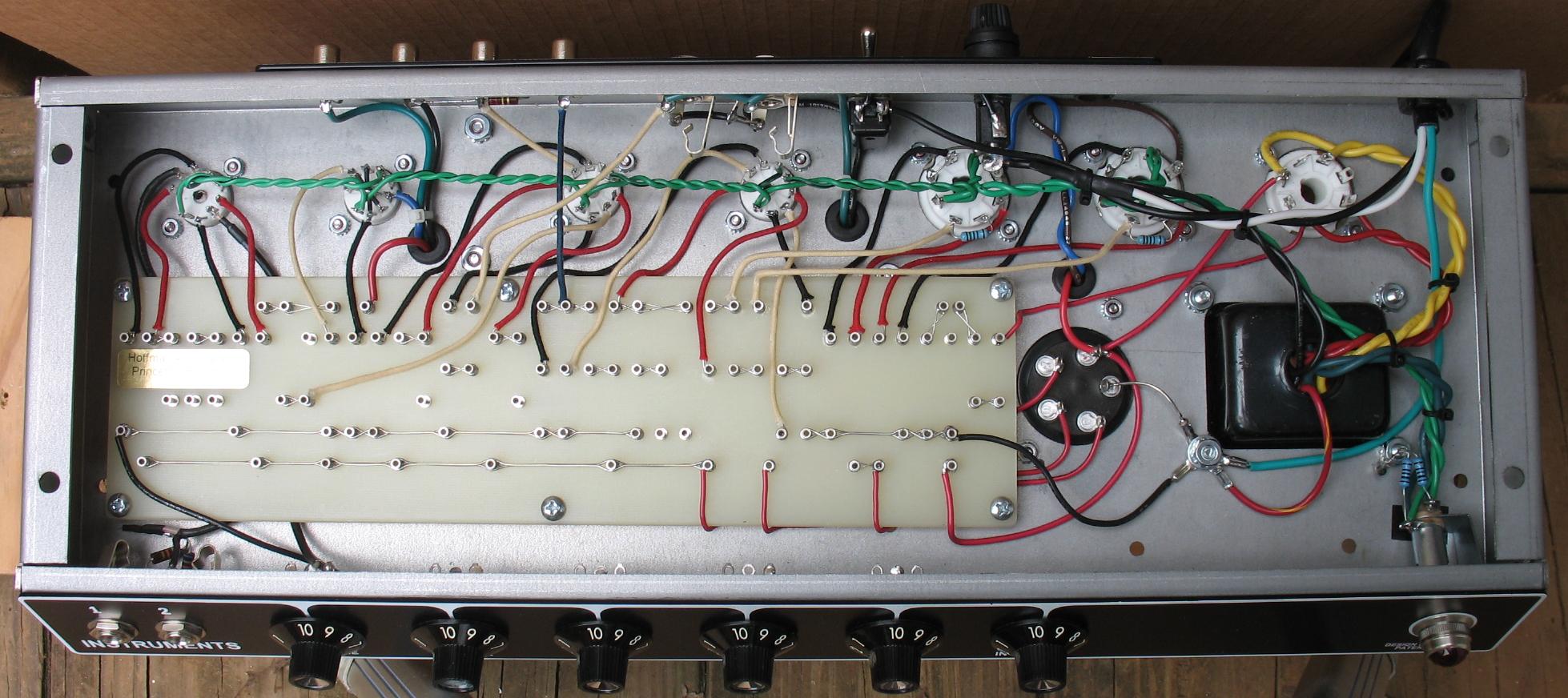

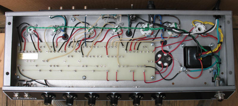

Cloth wire has been installed from the board to the tube sockets
The heater wires have been installed

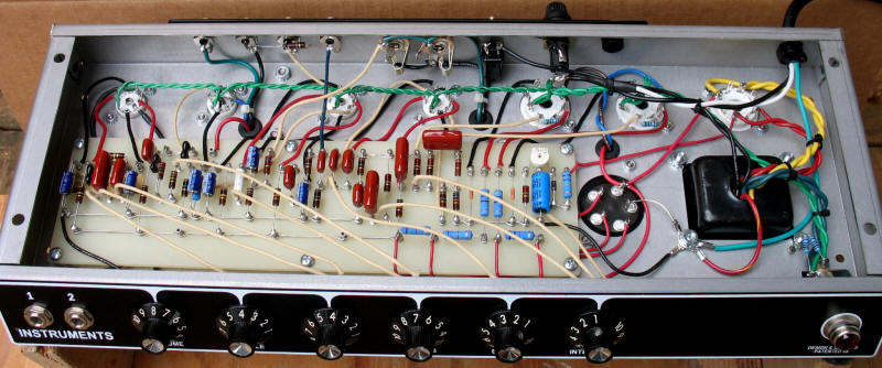

The components have been installed

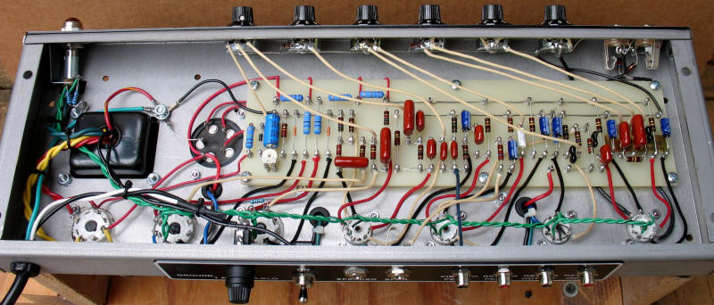

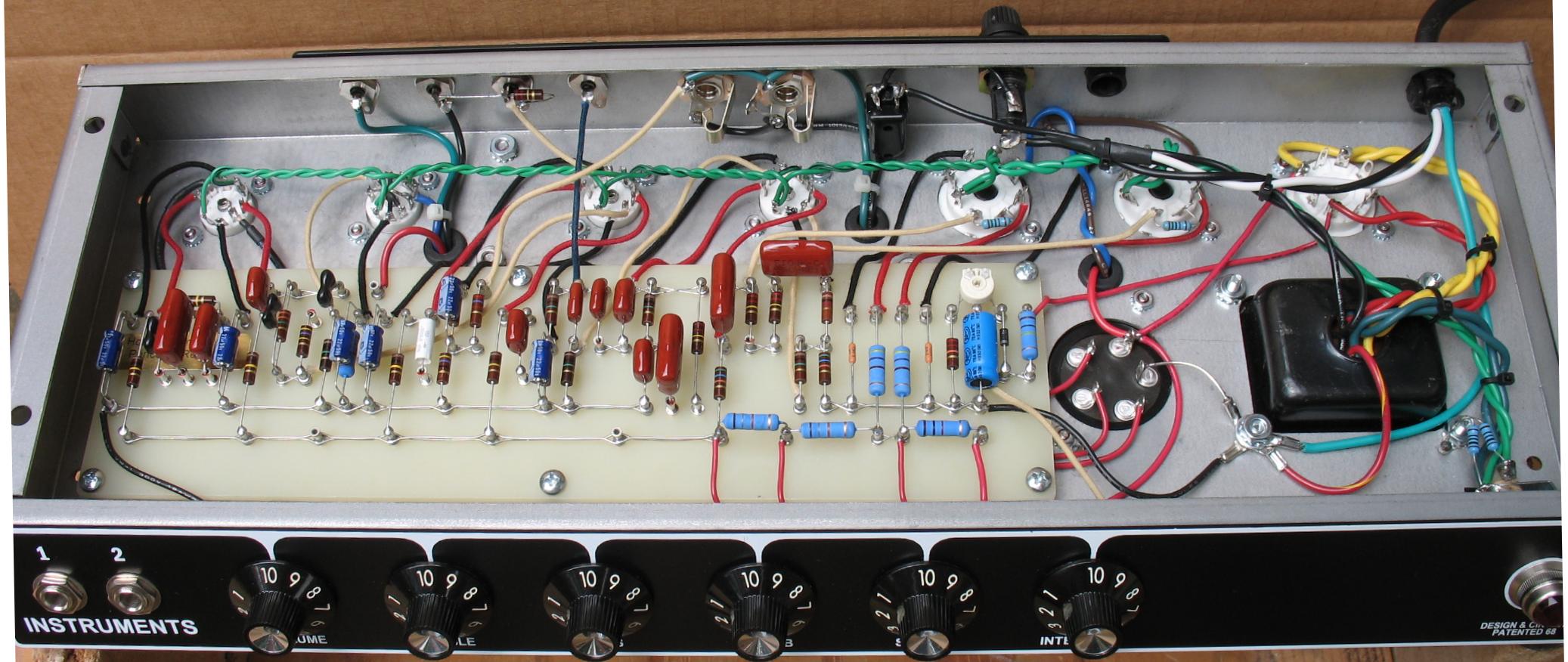

All done and ready to be fired up for the first time

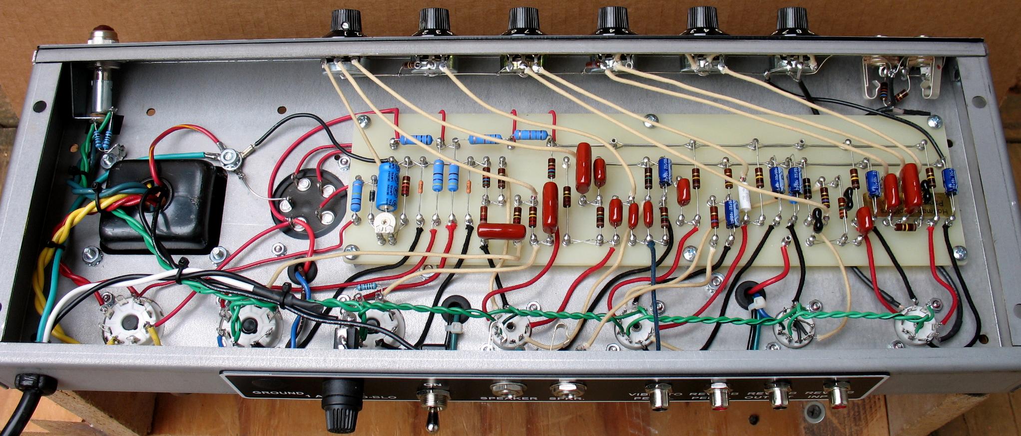

Finished the pot wiring and fired it up
Biased the EH 6V6's at 30ma as a general bias current for my first test
Plugged it into a Marshal 4x12 cabinet set at 8 ohms
It sounds great
