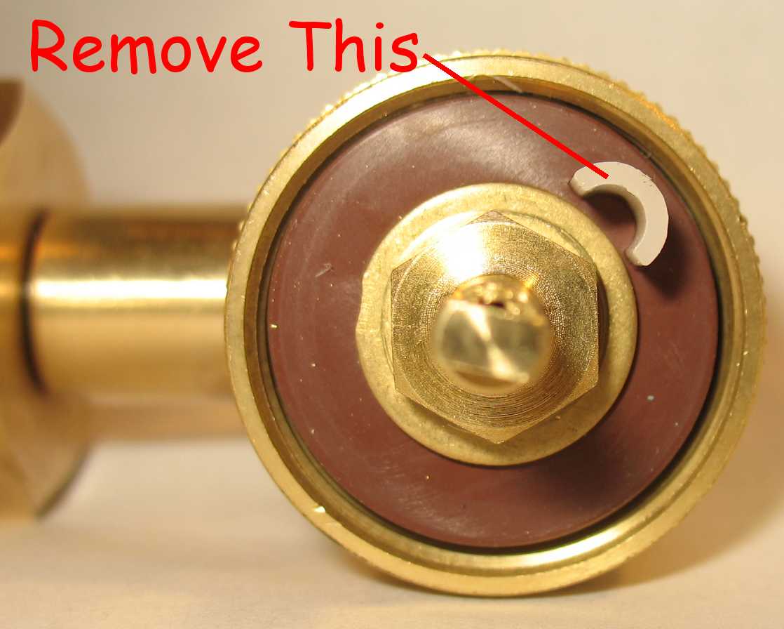

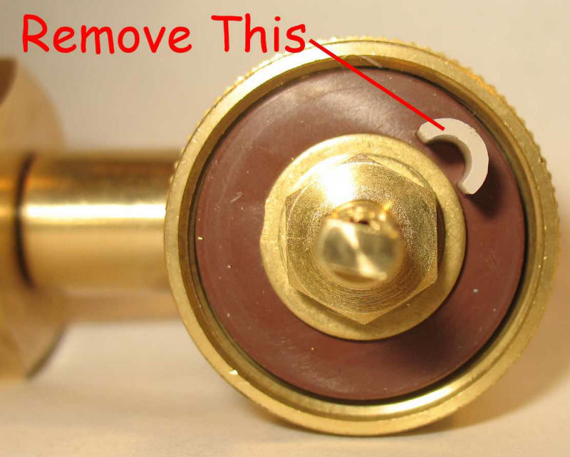

Flame King Mod

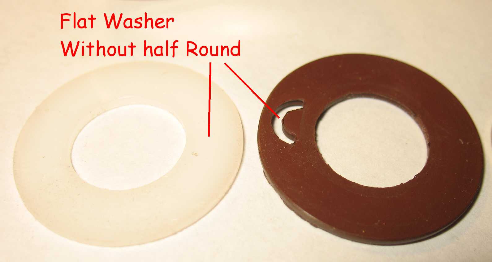

Here's a close up of the white plastic half round piece you will be removing
It is part of a white plastic washer that is under the brown rubber seal
See the instructions below on how to remove this half round piece.
Click on the images to see larger images

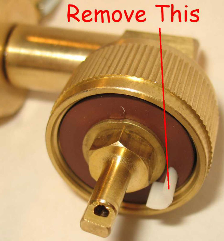

Flame King Mod

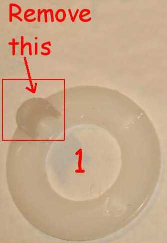

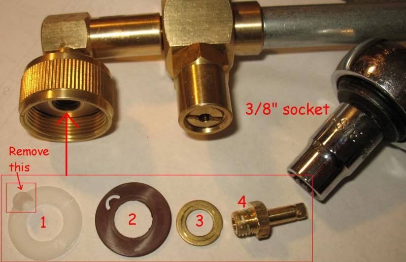

Flame King Mod
I numbered the pieces in the photo so you can follow along easily
Take a 3/8 inch socket or wrench and remove the brass filler tube (#4)
There is a brass washer under the filler tube (#3)
Then you can pull out the rubber seal (#2) and white washer (#1)
The half round plastic piece is part of the white plastic washer
Flame King adapter
This half round piece shown above is what you will be removing
Flame King Mod
Take some flush cut nippers and nip off the half round plastic piece
There will probably still be a nub left since it is just about impossible to trim off that half round piece so it is completely flush with the surface of the washer
You must remove all of the half round plastic piece
I used a Dremel tool to remove the last bit of nub
The surface of the washer must be completely flat where the half round piece once was
The white plastic washer is not brittle, but it is not soft either
So trimming it off with a knife may not work very well

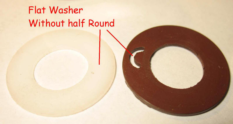

Flame King Mod
To assemble the filler
Insert the plastic washer (#1)
Then insert the rubber seal (#2)
Then insert the  brass washer (#3)
Then screw in the filler tube (#4)
Make sure you keep the rubber seal centered as you tighten down the filler tube
The rubber seal can drift side to side a bit because the hole in the seal is larger than the threads in the filler tube

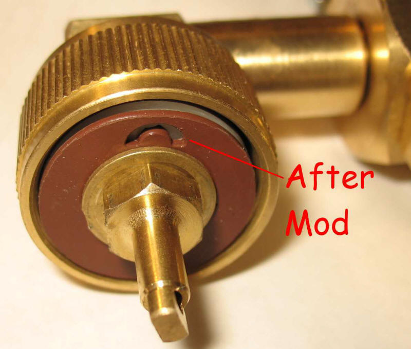

Flame King Mod
So here it is after it has been assembled
You can re-use the rubber washer or install a new one if you have one
I found that the original rubber washer did not leak at all with the half round piece missing
Just make sure you get the rubber seal centered properly
So now you can fill up Coleman 1 pound tanks
