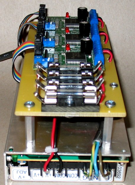

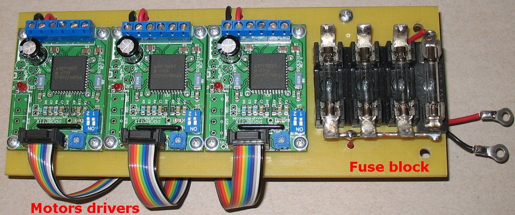

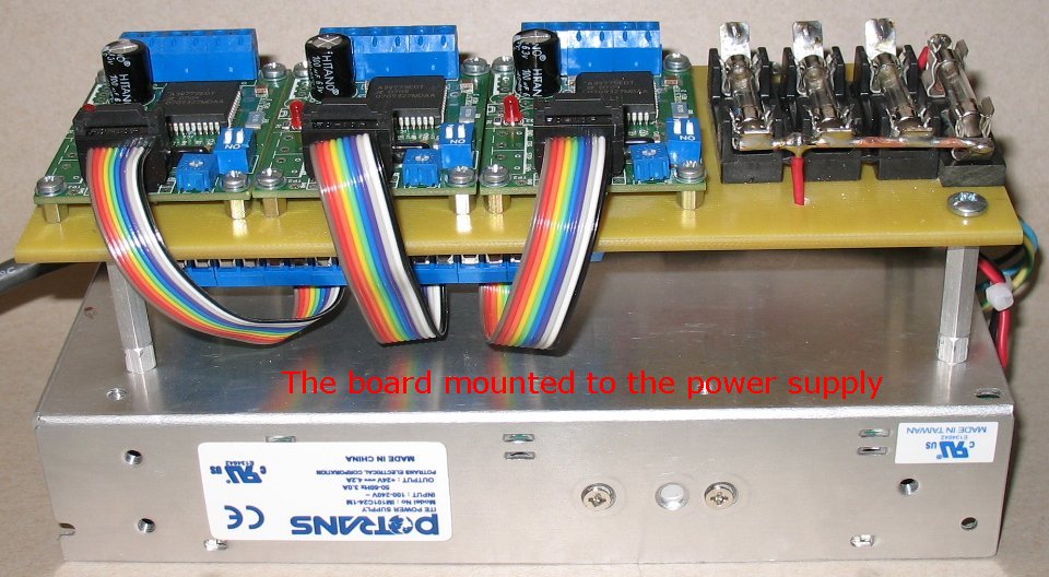

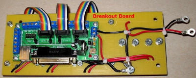

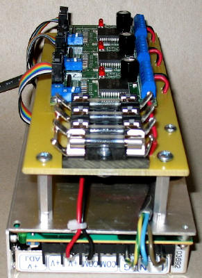

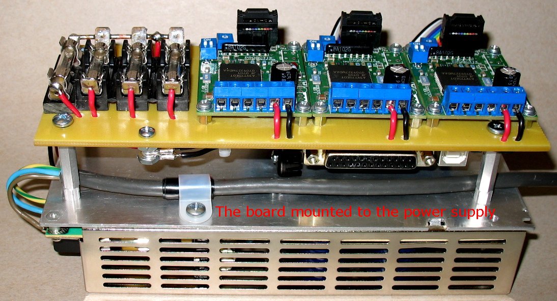

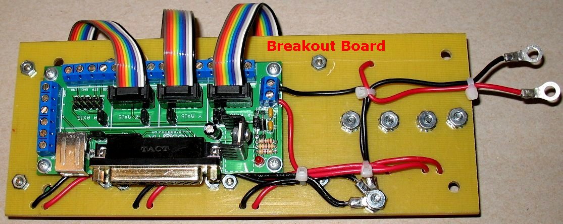

I built a board from .125" thick G-10 Garolite to hold the motor driver Boards, fuse block and breakout board.

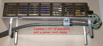

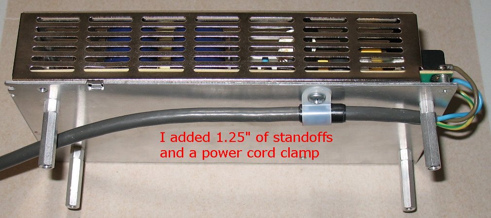

The board sits on standoffs, piggybacked to the power supply. The board sits on standoffs, piggybacked to the power supply.

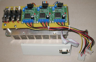

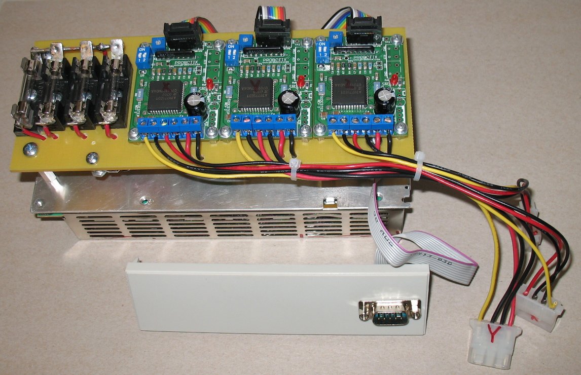

Standoffs drilled and mounted to the power supply case I hooked up a 9 pin serial connector to the x,y,z limits and emergency stop.
I'll run a 9 pin serial cable from the front of the PC to the router table.
I also added computer style power connectors to the x,y,z motor feed wires.

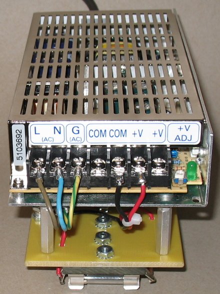

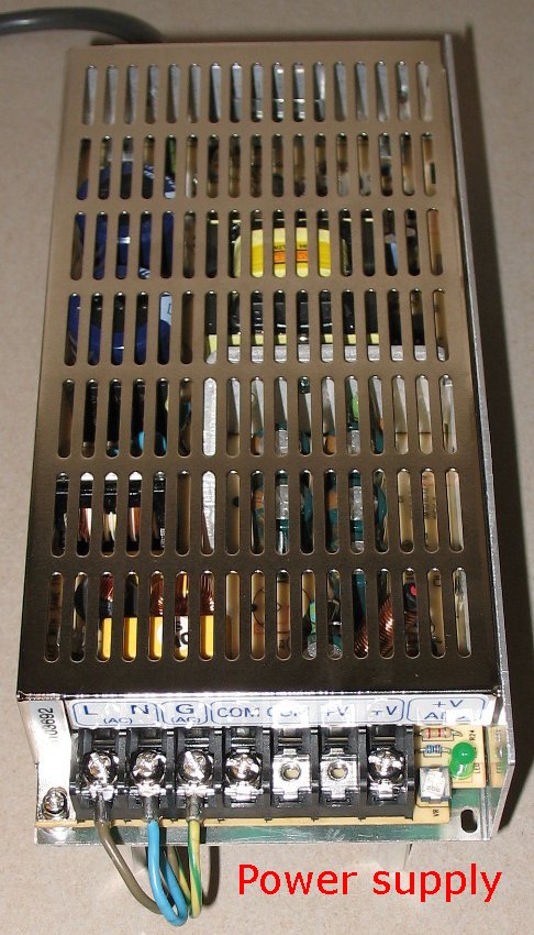

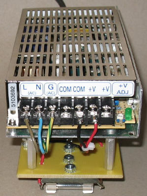

Power supply hook ups Power supply hook ups

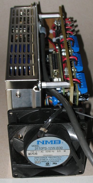

Power supply hook ups and fuse block My plan is to put the power supply/board assembly into a case
 and have a fan at one end to keep things cool.
