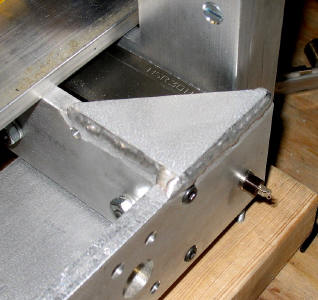

02/04/2008 - Took the machine to be welded

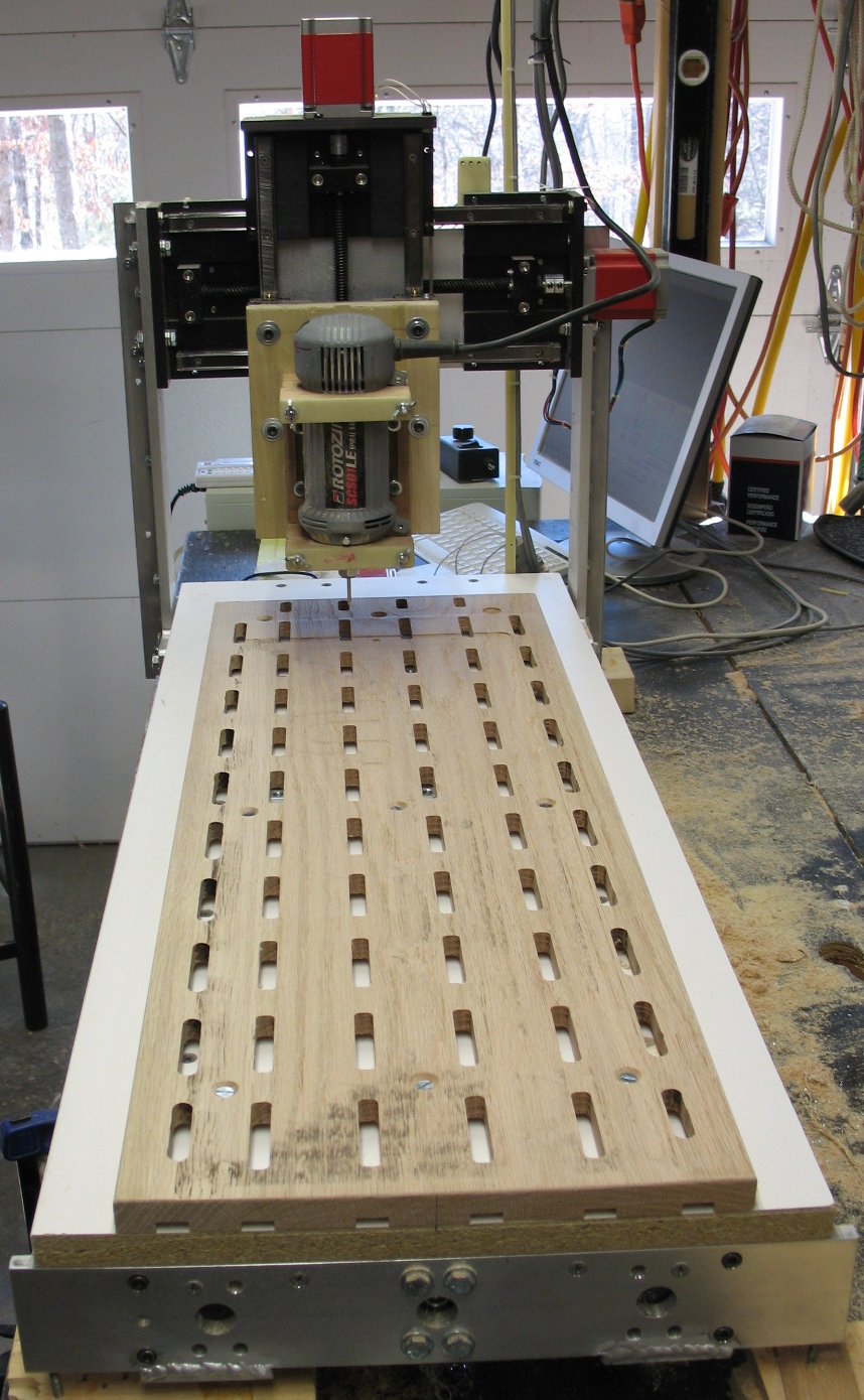

02/06/2008 - I added the top to the frame and made an oak workspace for the top. The machine comes alive

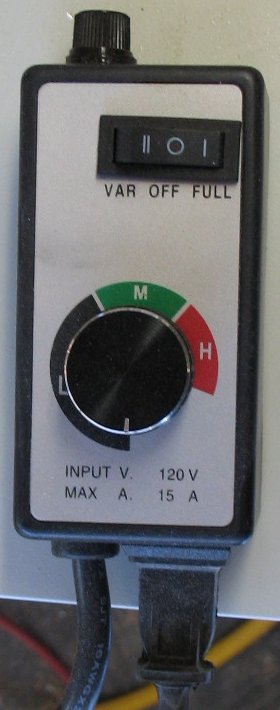

The melamine top is attached to the frame rails. The oak work area is attached to the top. It's alive and working. I have the old tool mounted to the new machine until I make a new tool holder. New motor speed control

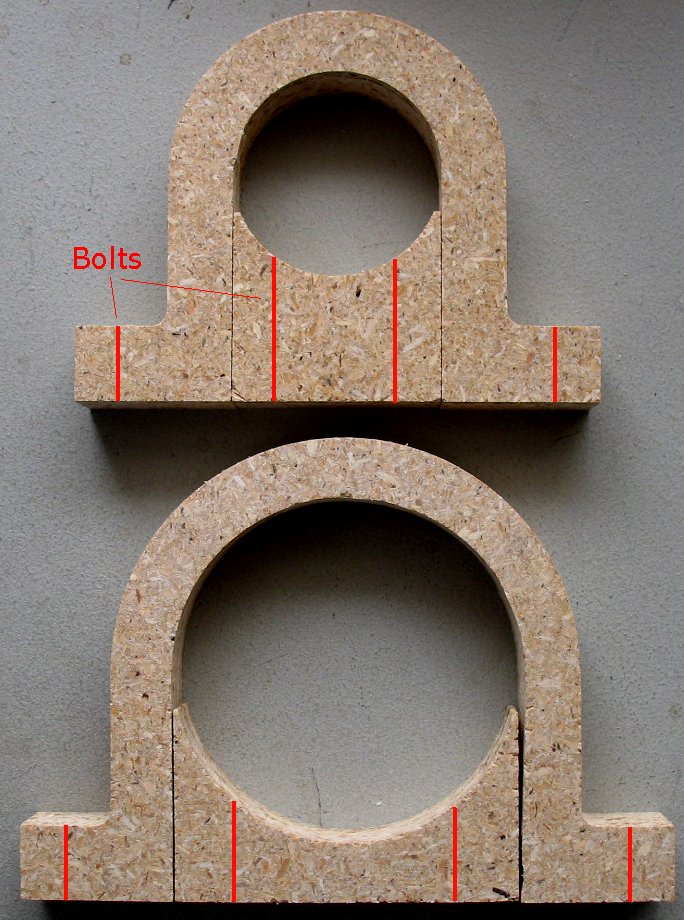

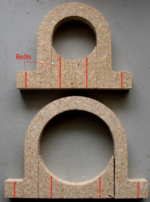

Tool mount idea #1 for the new machine. The red lines are where bolts will be.
The two pieces above will sit in a 1/8" groove on a 1/2" think piece of 6061 aluminum that will bolt to my Z axis.

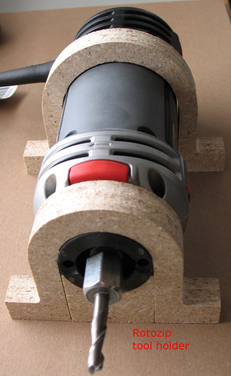

New RZ10 Rotozip sitting in tool holder mock up.

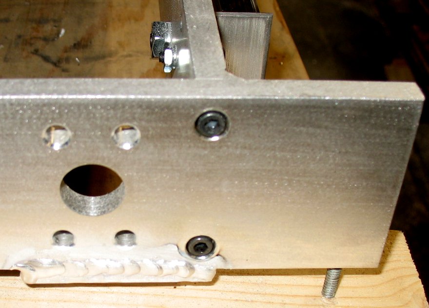

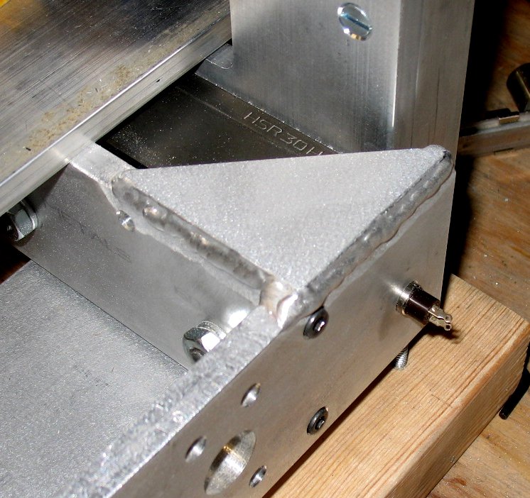

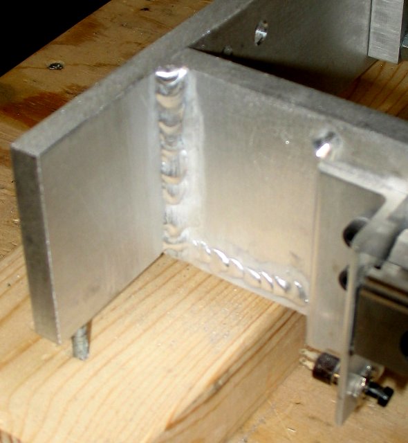

Frame welded - The corner gussets and corners are welded in place

Frame welded - The corner gussets and corners are welded in place-
