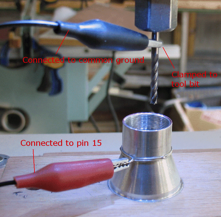

The way it works is that if pin 15 on my Probotix breakout board touches the common ground, then that is the Probe trigger.
The Minus wire is connected to the common ground on my Probotix breakout board.
The plus wire is connected to pin 15 on my Probotix breakout board.
Each wire has an alligator clip on the business end.
I clip the minus wire to my tool bit
The plus wire is clipped to the metal work piece or some other piece of metal used to find an edge
When the bit touches the metal work piece, pin 15 is grounded and that is the probe trigger
Note that my tool is a Rotozip, which is a double insulated tool.
That means that my spindle is insulated from the frame of my CNC machine and so I must also use a ground wire.
If you have a spindle that is connected to the frame of your CNC, you can just use the Red wire.
In that case, you would connect the common negative to the frame of your machine.
Your tool bit would then be connected to the common ground and you don't need the ground wire clamped to your tool bit.

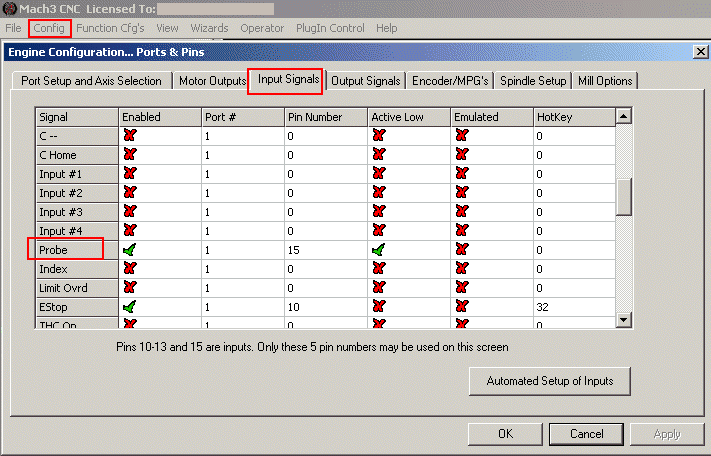

To set up a Probe in Mach3, you have to go to the Config menu, then pick ports and Pins, then the Input signals tab
Scroll down the menu until you see the Probe line
Enable the probe and then set the Pin number you are using (15 in my example above)
Make a green check in the active low column.
Don't forget to save your settings in the Config menu
Now Mach3 is ready to read probe input on pin 15

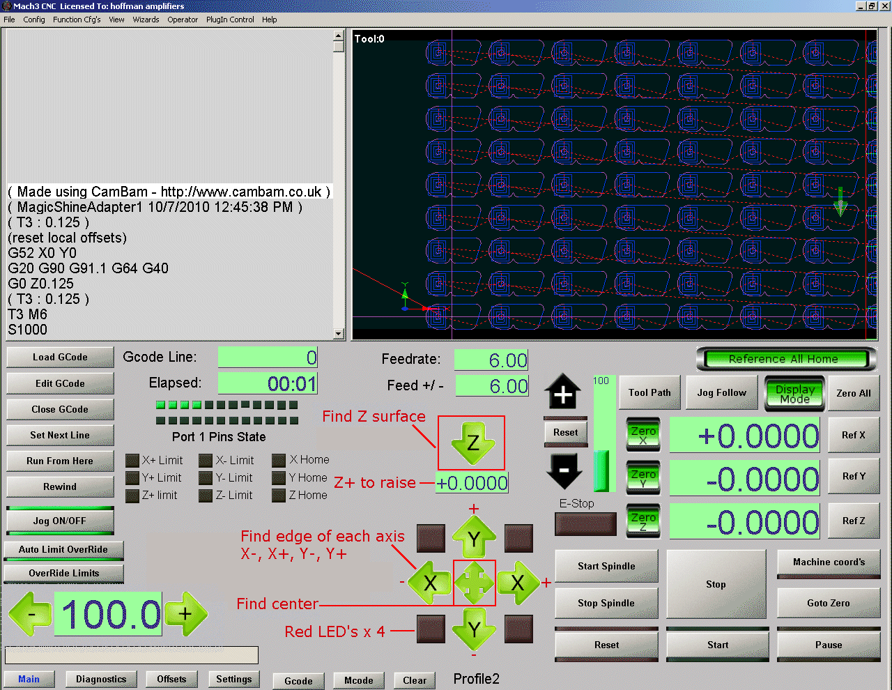

Here's a shot of my custom Mach3 screen.
I created my Mach3 main screen to be very simple, no cluttered graphics and only items that I actually use all the time.
I had to get rid of a few items on my custom screen that I was not using in order to make room for all the new buttons, LED's and Z+ entry field.
The new items I added to my Mach3 custom screen are:
 Z surface Button
The Z surface button is used to find the top surface of the material.
The bit will slowly descend until it touches a metal surface and then it will stop.
If your work piece is metal, you can go ahead and Zero out the Z axis at this point.
If you use a metal plate to find the surface, the Zero Z point would actually be Z- plus the thickness of that metal plate.
The green entry field below the Z surface button.
After the surface is found, the bit will raise up the amount you enter in the green box.
Four Axis buttons, X-, X+, Y-, Y+
Each one of these buttons will slowly move the bit until it touches a metal edge.
You can then zero out that axis.
If you use some other metal plate to find the edge, the thickness of that plate has to be taken into account.
The four way arrow button
The four way arrow button searches all four directions, Y+, Y-, X-, X+ and then goes to the center of what it finds.
You can then Zero out the X and Y axis.
This is the function I like best for many of the small round objects that I have to machine.
Four Red LED's
These led's light up when the bit touches a metal surface.

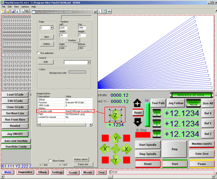

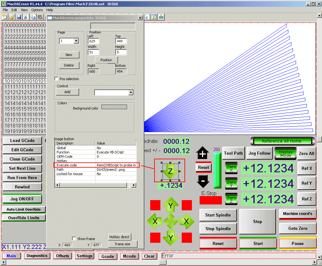

Here's an example of editing a button to run some VB script code.
Note that I copied all the code from the Blue Screen example from the CNC zone post.
See my link at the top of the page to the CNC zone post where you can download the Blue screen.
I had to add my own buttons, LED's and graphics to my page first.
My screen shot example above:
Clicking on the Z down button displays all the properties of this button.
Notice that the Execute code field has some text which is not quite all visible.
This is the VB script code that will execute when the Z down button is pressed.
Double clicking on the Execute code field opens up a text editor that displays the full script code.
See the screen shot below of what the script editor screen looks like.
I copied the code from the Blue screen buttons and added it to my buttons.

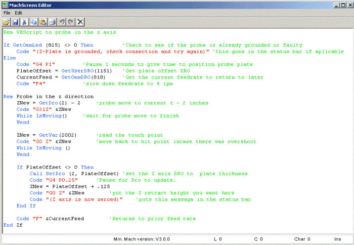

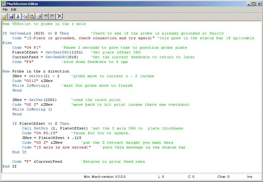

When you double click on the execute code field, it opens up the code in an editor screen like this one.
This is the code for the Z axis down button.
You can edit any of the code you like.
If you close this window, a dialog box will pop up asking if you want to save the code to the screen.
Say yes and then that code is now attached to the Button.
