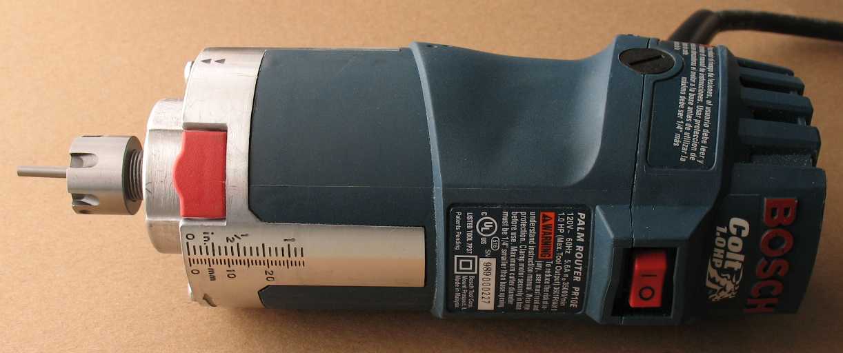

This time I am replacing the old Rotozip tool with a Bosch colt tool.
The Rotozip was ok, but the collets are crap.
The 1/4" Rotozip collet would wobble unless you spent a bunch of time trying to get it right.
The Bosch colt is built way better than the Rotozip and you can buy precision collets for the Bosch.
This is a link to the Bosch web site
I will be converting my CNC router as soon as the Router mount arrives here.

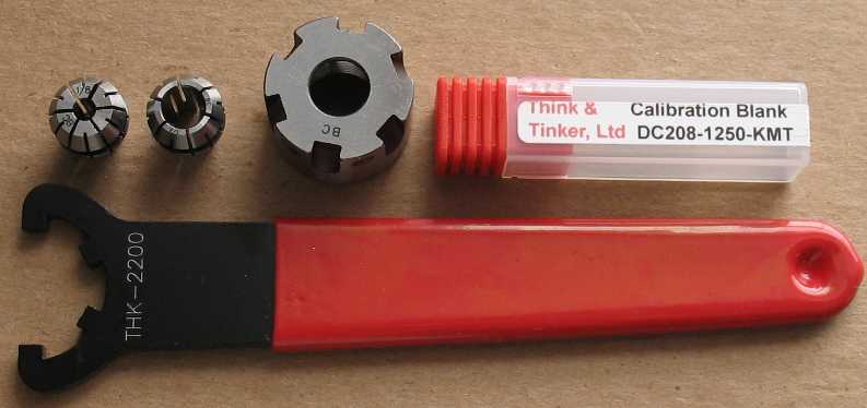

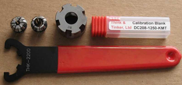

This is the precision collet set made for the Bosch colt router.
This is the web store link where I purchased the collet set.

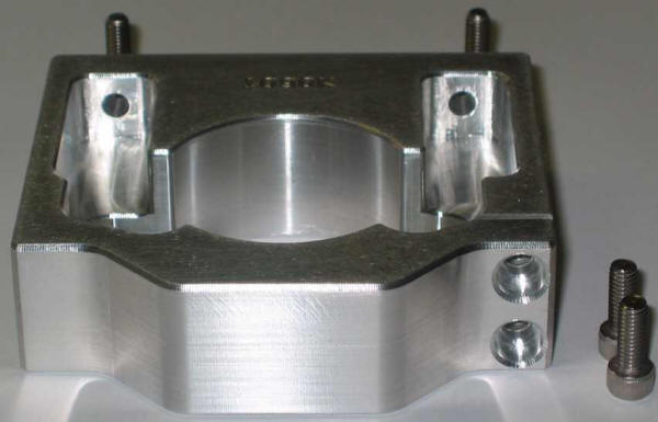

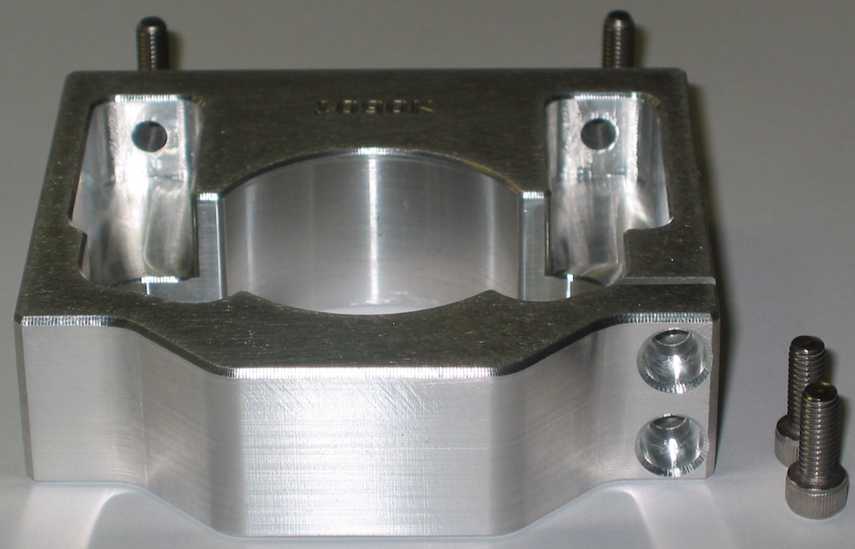

K2CNC mount
I was going to machine my own Router mount for the Colt, but I found a source for a really nice mount.
By the time I purchased the block of aluminum, designed the part and cut it out, it would have cost way more than buying the part above.
The picture above is made for a smaller spindle, but the Bosch router mount looks the same, it just has a larger center hole.
