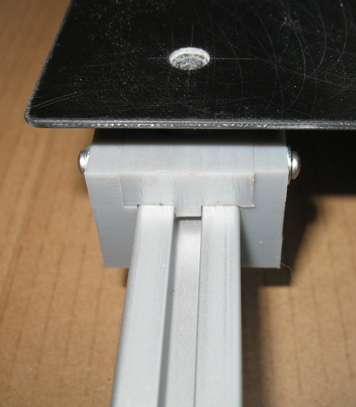

I made all the linear bearings on my CNC machine from UHMW Plastic. The UHMW is from Mcmaster-Carr

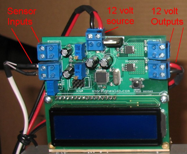

Probotix driver boards, breakout board and power supply
Gnex lab dual temp control board for the hot end and heater bed

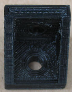

All the black plastic pieces you see in the images below were printed on Printer #1

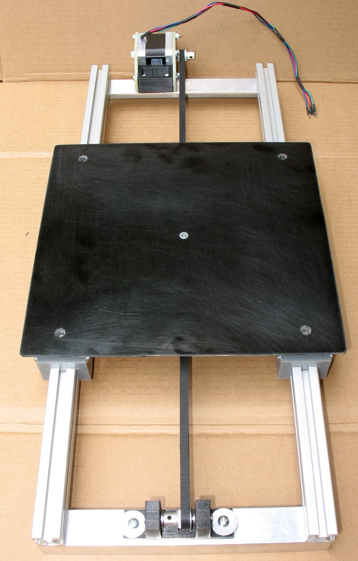

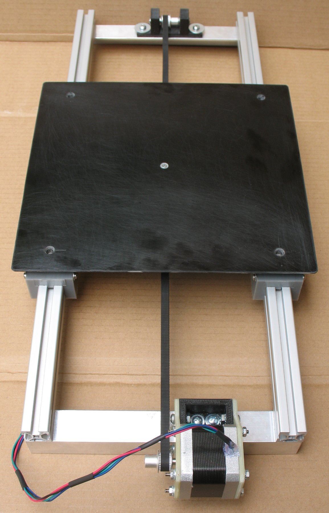

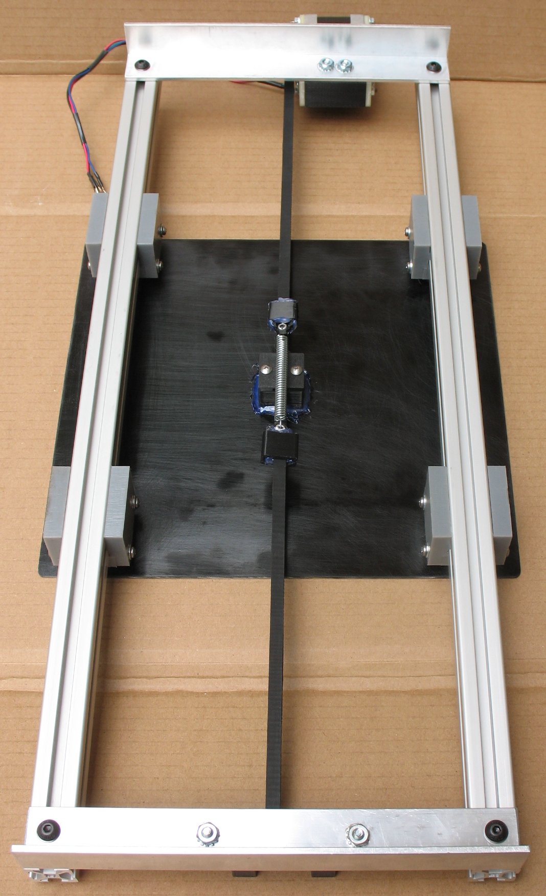

This is the Y axis bed. The black Garolite material sits on 4 round plastic pucks. Those pucks are glued to the Garolite sheet
A screw goes through the Garolite and the puck and then screws the puck to the UHMW bearings.
Once the machine was assembled, I slid shims under the pucks to get the bed within .001 inch level on all four corners
A piece of glass is taped down to the top of the Garolite to get a perfectly flat printing surface.
Blue painters tape is taped down to the glass surface
PLA plastic sticks really nice to the blue painters tape

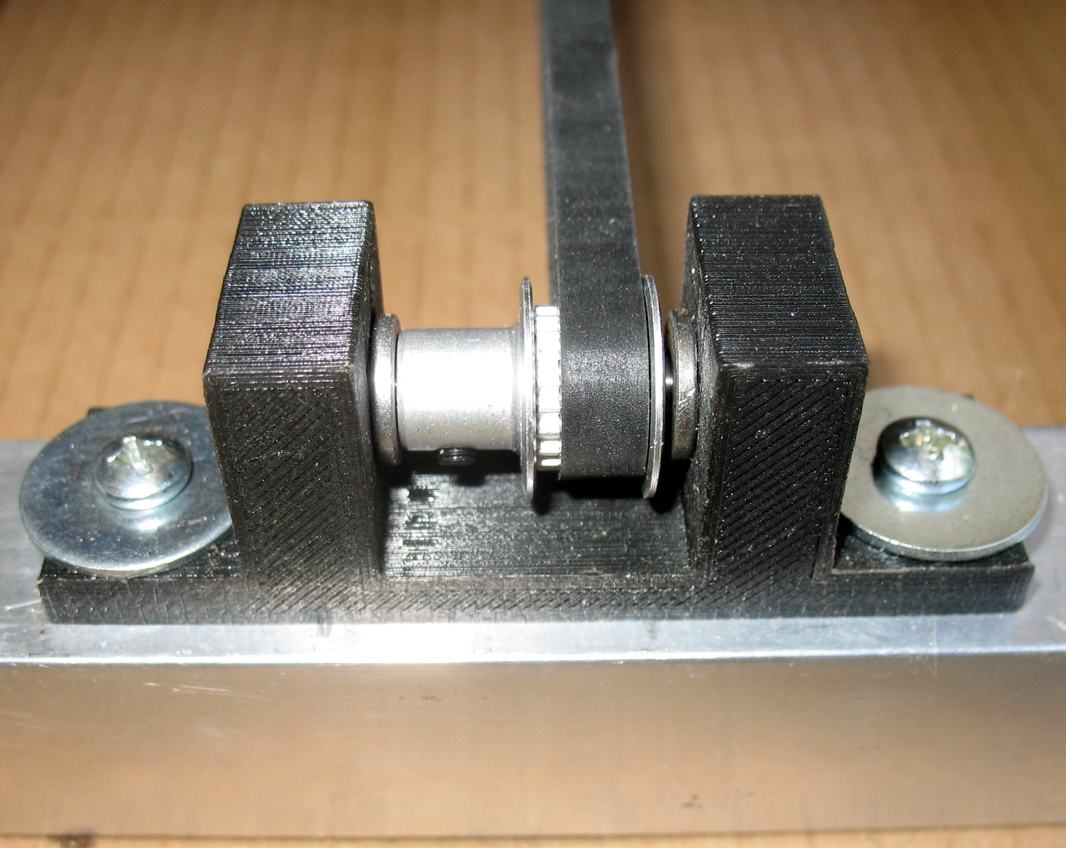

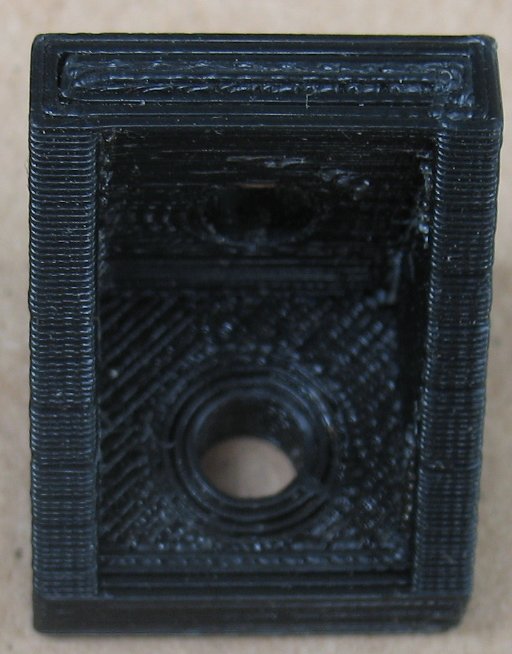

The idler pulley assembly was printed on printer #1
There are two Oilite bearings pressed into the black plastic idler assembly

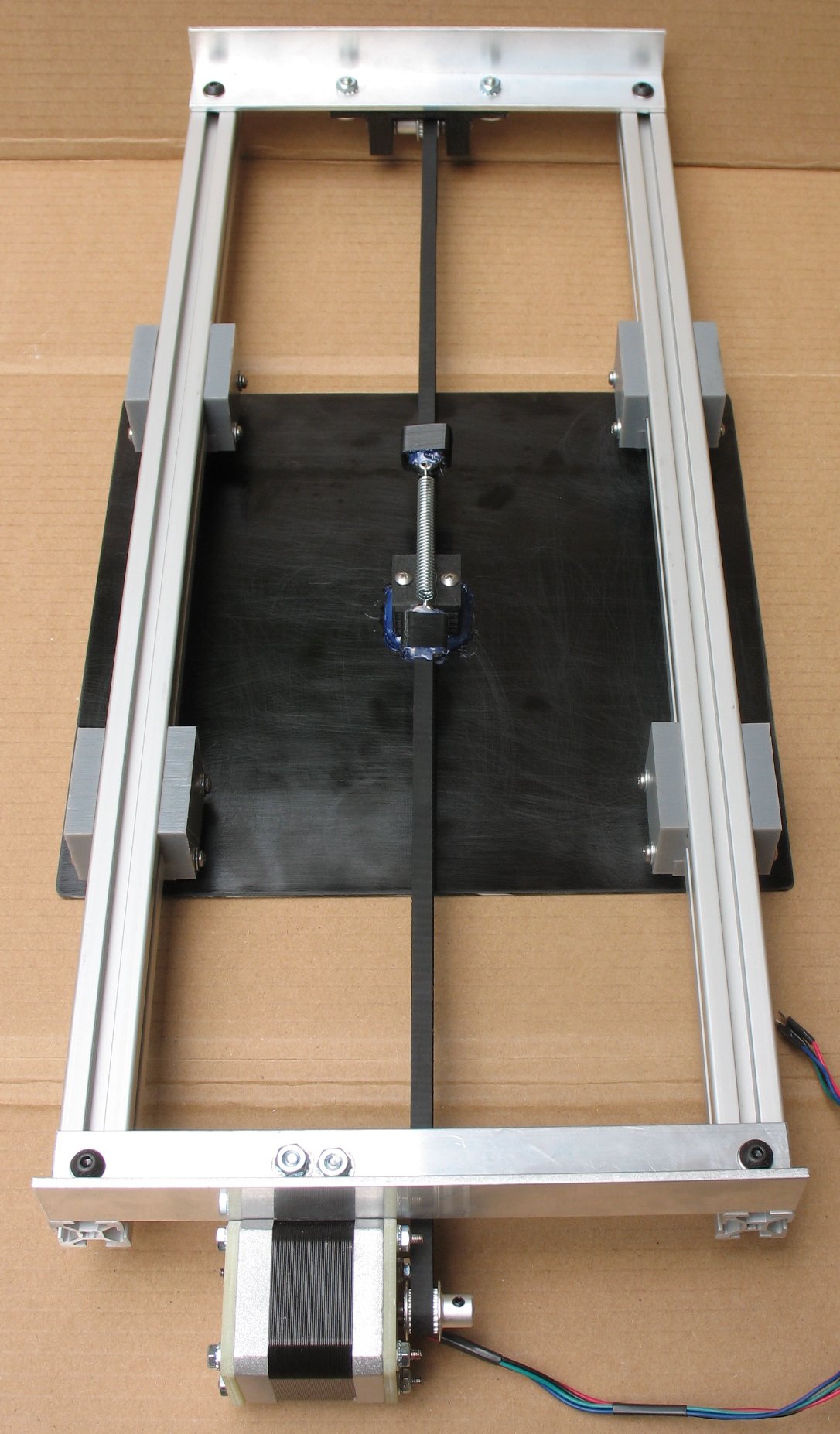

Here's a shot of the underside of the Y axis
You can see the UHMW bearings and my belt tension device
A spring pulls the two belt ends together and keep the belt tight
The belt end clamps and the center belt clamp were printed on printer #1
I reinforce some of the parts connections with hot glue
The UHMW bearings can be adjusted via shims and screws to take up slack and get the right friction level

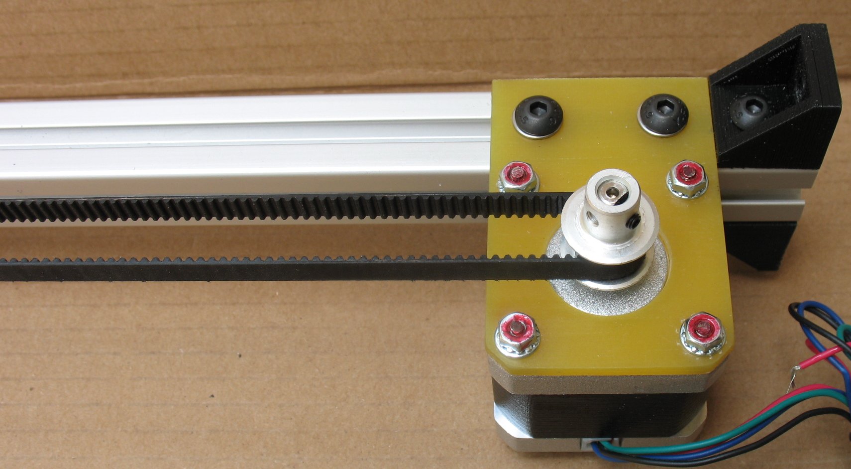

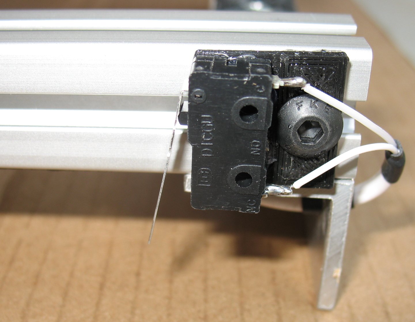

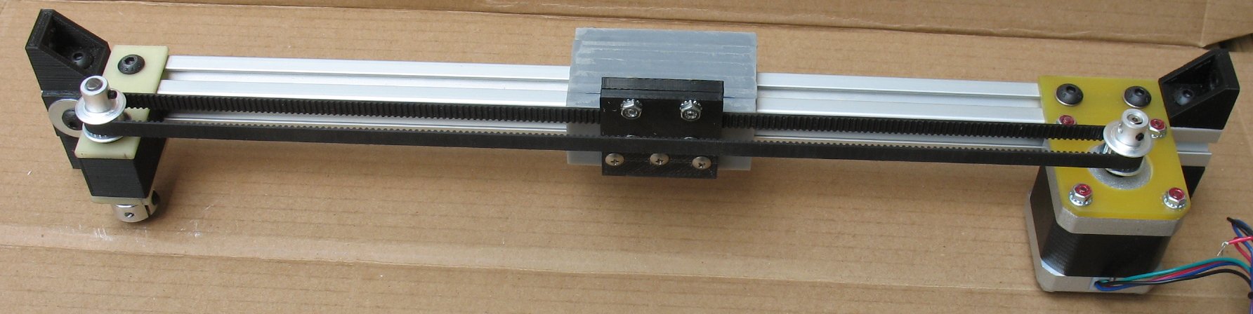

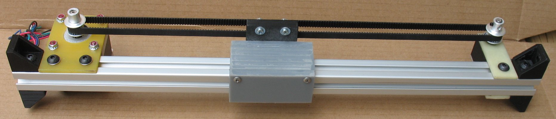

This is the X axis
On this build I have the motor and idler pulley bolted firmly to the 20mm T-slot
This makes the X axis very rigid. This new design turned out very well
I put tension the belt by moving the idler pulley end and tightening down 3 screws
The black plastic ends get bolted to the Z axis 20mm T-slot upright pieces

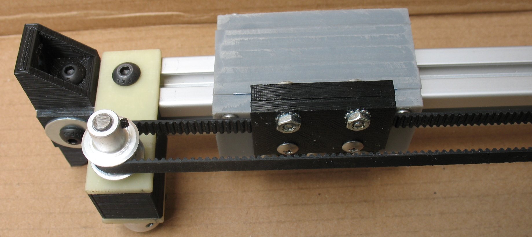

Close ups of both X axis ends
You can see the belt clamp and how it is attached to the linear bearing
The belt clamp, the idler pulley center section and the 90 degree brackets on the ends of the T-slot material were printed on printer #1
I use 5mm Allen head screws and T-slot nuts to connect the angle pieces to X axis T-slot piece
I used 4/40 threaded rod to connect the angled pieces to the Z axis linear bearings
The motor is attached to a 1/8 inch thick Garolite bracket
That bracket is bolted to the 20mm T-slot using 5mm bolts and T-Slot nuts

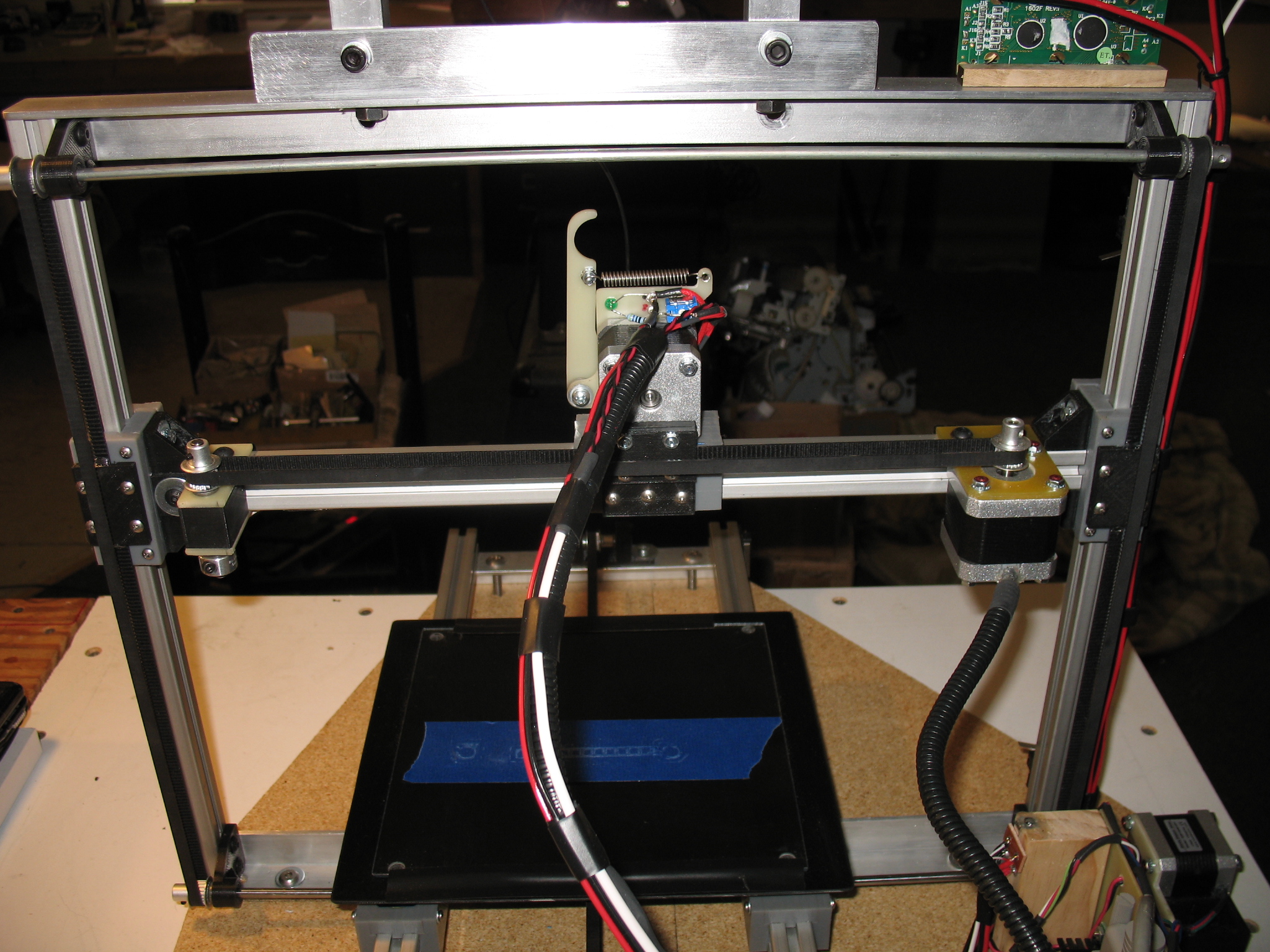

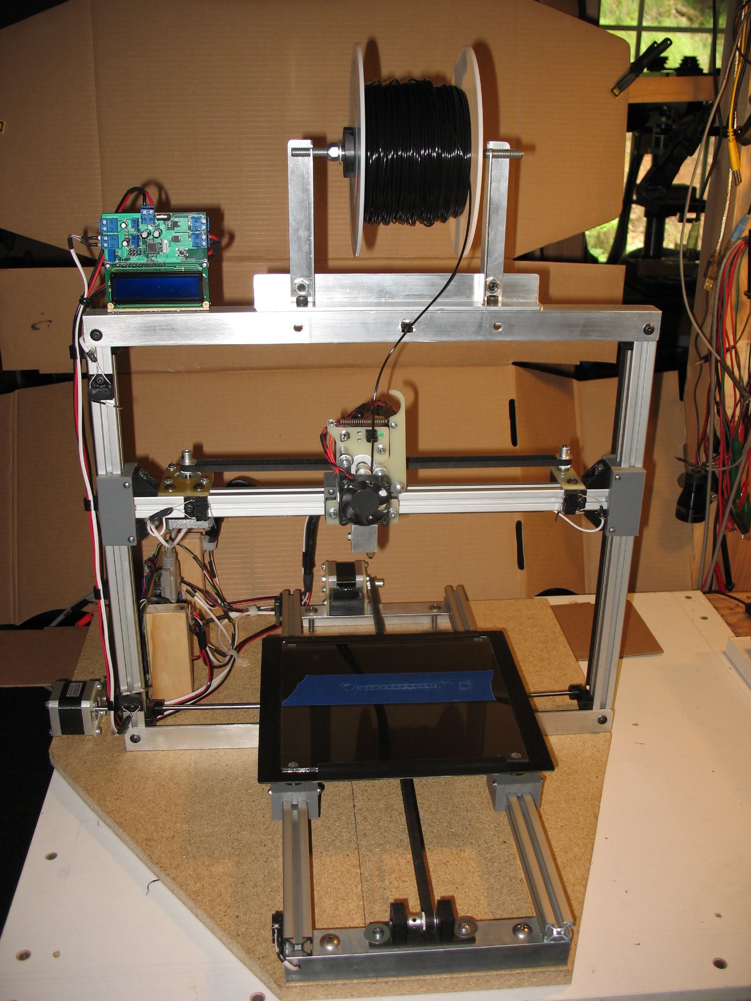

The assembled printer
You can see the glass printing surface with some blue painters tape applied
The black Garolite bed was leveled with .005" shims at all four corners and so the glass sits on a level surface
When printing small parts, I only stick down a small piece of blue painters tape
The tape is only good for a couple uses or until it rips so it's not a good idea to cover the entire glass piece with tape
I only use enough tape to get the job done
If I was printing a large area I would have to cover the glass for that area
I am using 2 inch wide blue painters tape

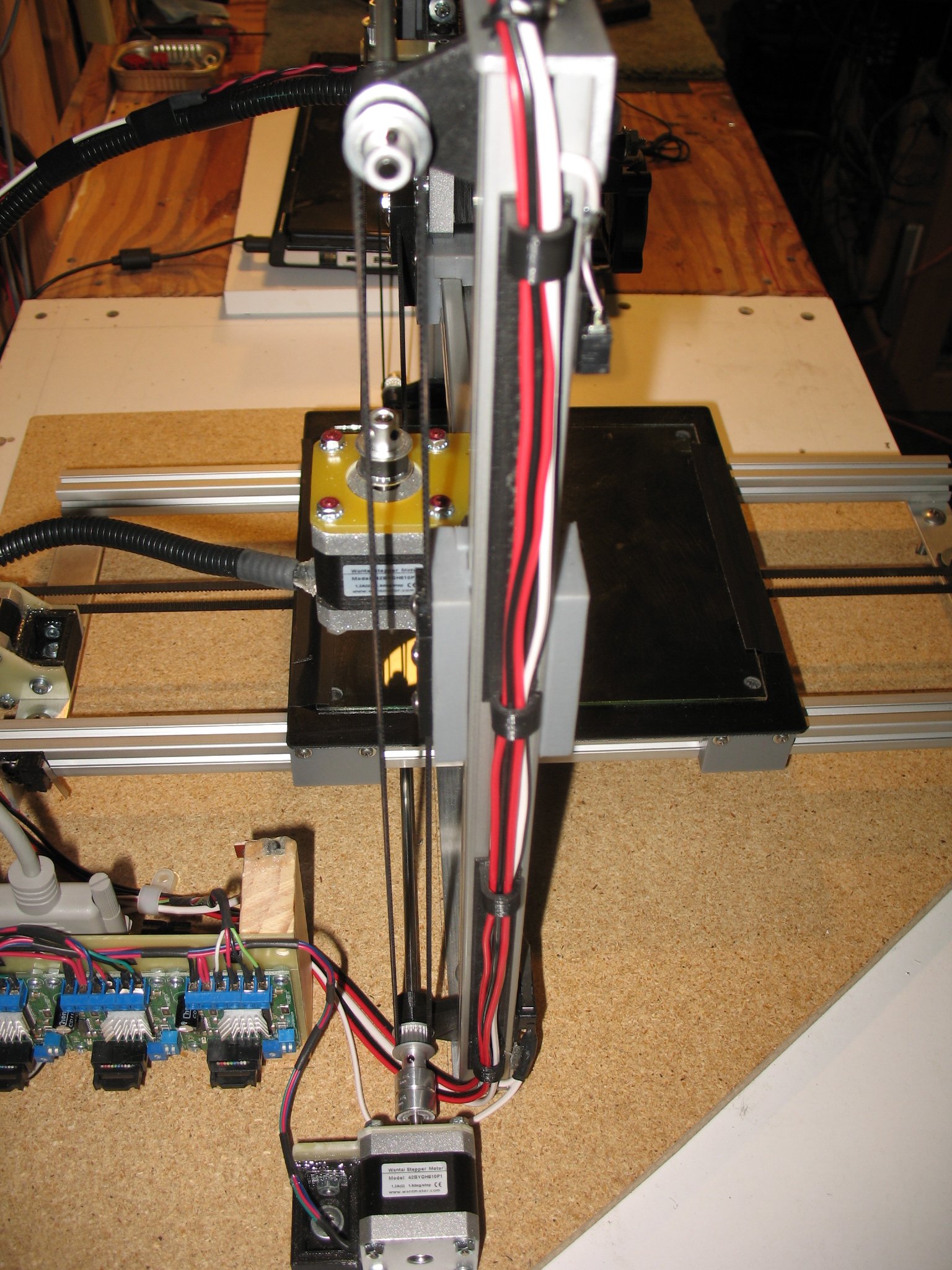

Right: You can see how the Y axis motor connects to a drive shaft
The drive shaft has a 2mm GT2 pulley on each end
Two GT2 belts go up to the second drive shaft at the top of the printer
The 2nd drive shaft also has a GT2 pulley on each end
The two drive shafts and four GT2 pulleys pull end end of the Z axis up and down evenly

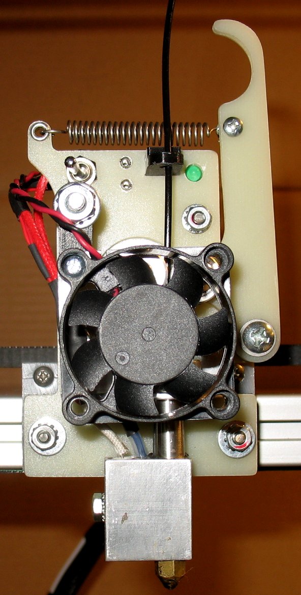

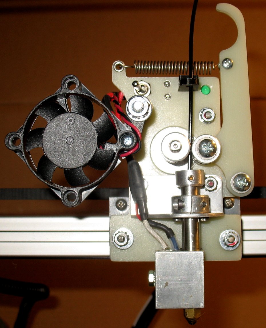

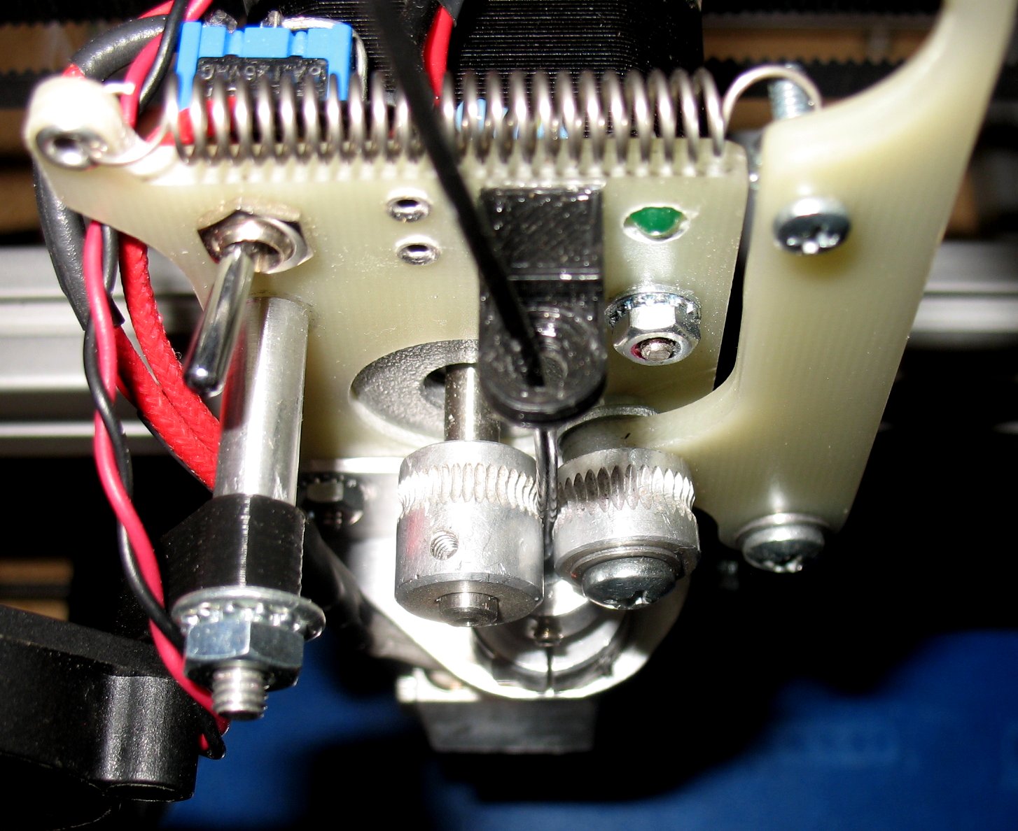

This is my latest print head design
A big improvement over my first few designs
This hot end design produces very clean prints
The Nema 17 motor is bolted to a Garolite support
All the other pieces shown are bolted to the Garolite support
The Garolite support is bolted to the UHMW linear bearing
There is a relief cut on each side that lets me get access to the two UHMW bearing screws

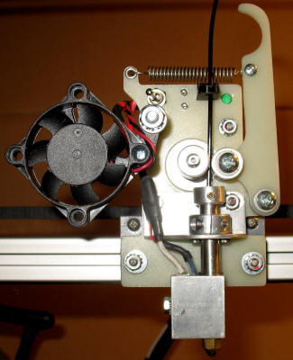

There's allot going on in these pictures so here's how it all works
Starting at the bottom of the extruder:
The brass nozzle tip is a Makerbot style tip.
I am using these nozzles because they work really well and they are only $5 each
I can't make a nozzle tip for $5 so it's better to just buy them
The nozzle has 6mm threads and it screws into the aluminum heater block
The aluminum heater block has 3 holes drilled into the top
Hole 1 is for the stainless steel hollow tube which is pressed into that hole using a small press I have in my shop
Hole 2 is a small 1/8th inch hole that the thermistor tube slides down into to sense the hot end temperature
Hole 3 is where the 40 watt heater cartridge goes
There is a small set screw and nut on the left side that holds the 40 watt heater in place
A stainless steel tube is used because stainless steel does not transfer heat very well compared to many other metals
The stainless steel tube has a PFTE tube inside it
The PFTE tube has a small 2.3mm hole drilled down through the center
The 2.3mm hole guides the 1.75mm PLA filament down to the hot end
The PFTE tube insulates the PLA filament so it does not melt on the way down to the hot end
It is very important to keep the filament rigid because you cannot push it if the filament will become soft on the way down
It's like pushing a piece of rope
The PLA filament only melts when it reaches the brass nozzle
The Stainless steel tube is clamped in place using an aluminum collar with a set screw
The collar is screwed down to an aluminum angle piece
At the top of the stainless tube is a small collar that keeps the PFTE tube from being pushed out of the stainless tube.
The top collar has a small set screw to keep it from moving
When the PLA plastic is forced down into the hot nozzle, there is allot of pressure trying to push the melted plastic back up
If the PFTE sleeve is not kept in place it will just pop out of the top and the hot end will stop working
The PFTE tube has a chamfered hole at the top to make filament loading easier
The Nema 17 motor has an aluminum gear with teeth that grip the PLA filament
There is an idler gear to the right of the motor gear and that gear also has teeth
Both gears have a concave tooth shape that the PLA filament rides in
The idler gear pushed hard against the filament forcing it into the motor gear
The idler gear is on a pivoting arm that has a spring
The pivoting arm has a finger indent at the top
The spring is what pulls the idler gear into the motor gear
Here's a shot looking down from the top
3d printer
Above the gears, the filament goes through a plastic guide that was printed on printer #1
The 40mm fan keeps the upper stainless tube and aluminum parts cool and the fan can pivot out of the way if needed
Upper Left: There is a switch to turn on the 40 watt heater cartridge
Upper Right: There is a green led that is on when the heater is on
The thermistor tells the temp control board what the temp is and the
The temp control board controls the 40 watt heater
The heater turns on and off when the printer is printing

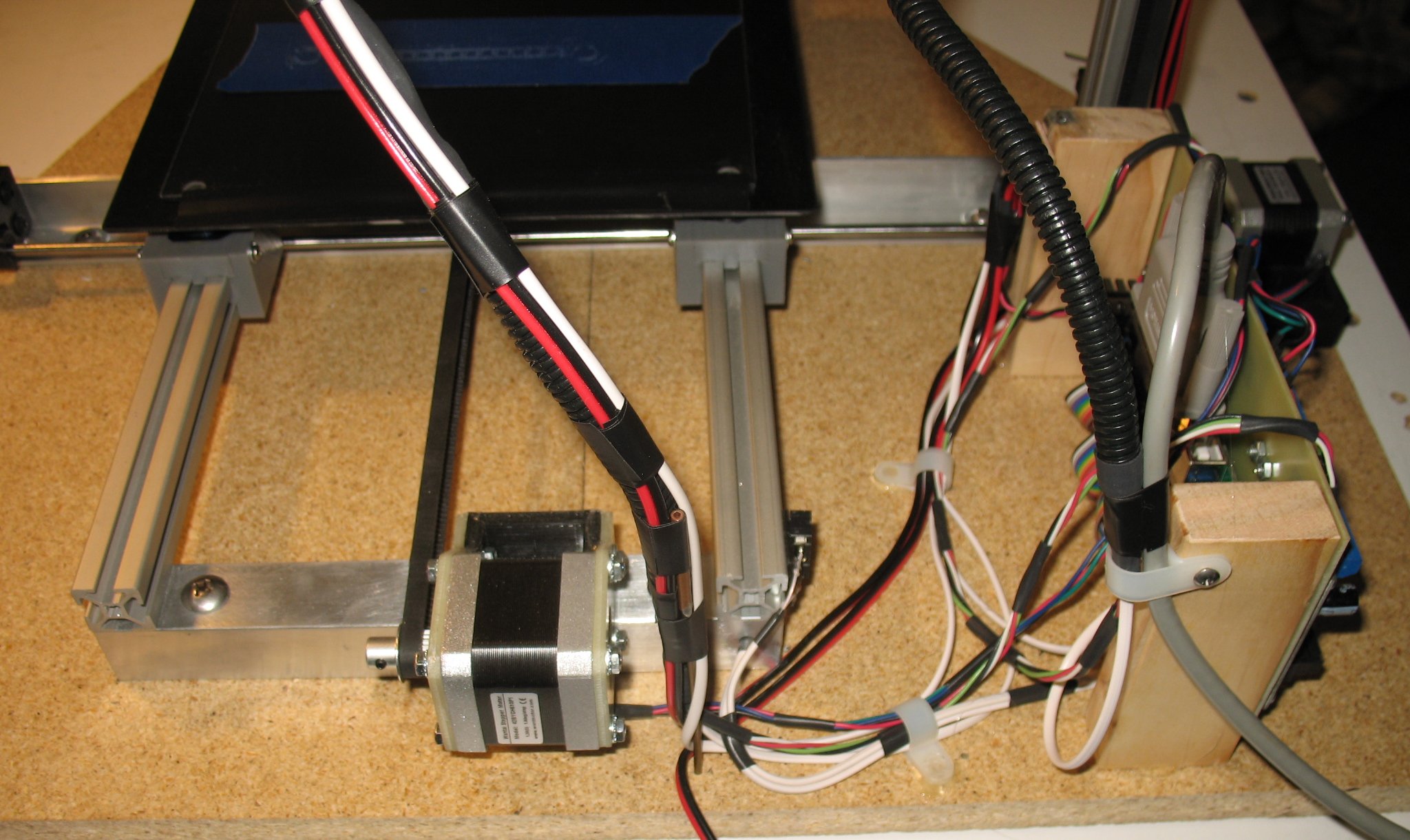

Left: Here's a back view of the printer
You can see all the wires that go to the extruder
There are 4 motor wires, two heater wires, two thermistor wires and two fan wires
This wire assembly has to be very flexible to be able to go left and right, up and own the full range of the X and Z axis
The X axis motor also has a separate wire bundle
There are four motor wires and 2 limit switch wires
This wire bundle only needs to go up and down with the Z axis
Right: You can see the Y axis motor and bunch of wires

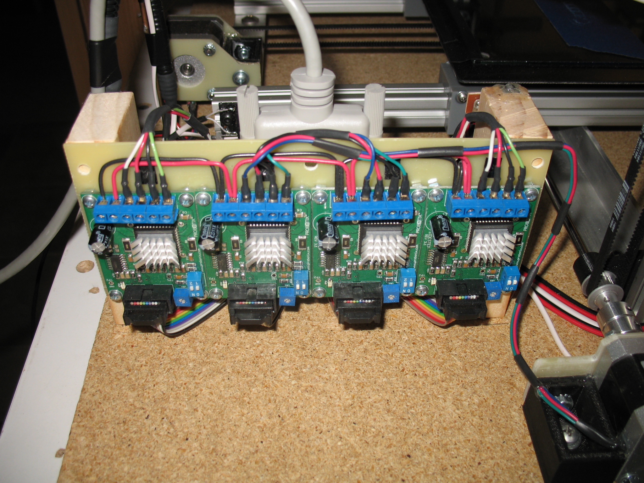

Left: The 4 Probotix stepper driver boards used to control all four motors
Note that most of the Reprap printer builders use different drivers and control software
I have a CNC machine that uses these same driver boards and I use Mach3 to run the Gcode and so I stuck with what I already know

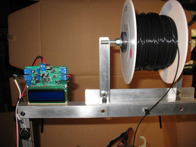

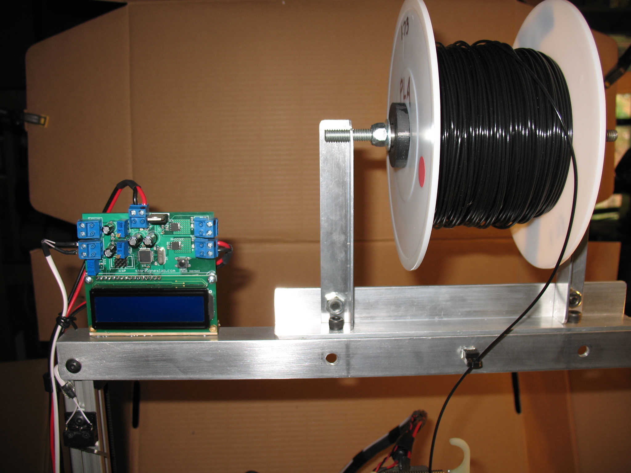

Right: You can see the Gnex temp control board and my filament spool holder
The Gnex board can control two heat sources in case you also want to run a heated bed for ABS printing
I am only using one of the sources to control my hot end heater
There are two thermistor inputs and two 12volt outputs
There are two multi turn pots so you can dial in the exact control temp you want the unit to control
The board reads the thermistors and then turns the 12volt DC outputs on and off to what ever you have set the trim pots to.
I print 1.75mm diameter PLA filament at 180 degrees Celsius
Link to Gnex temp control board

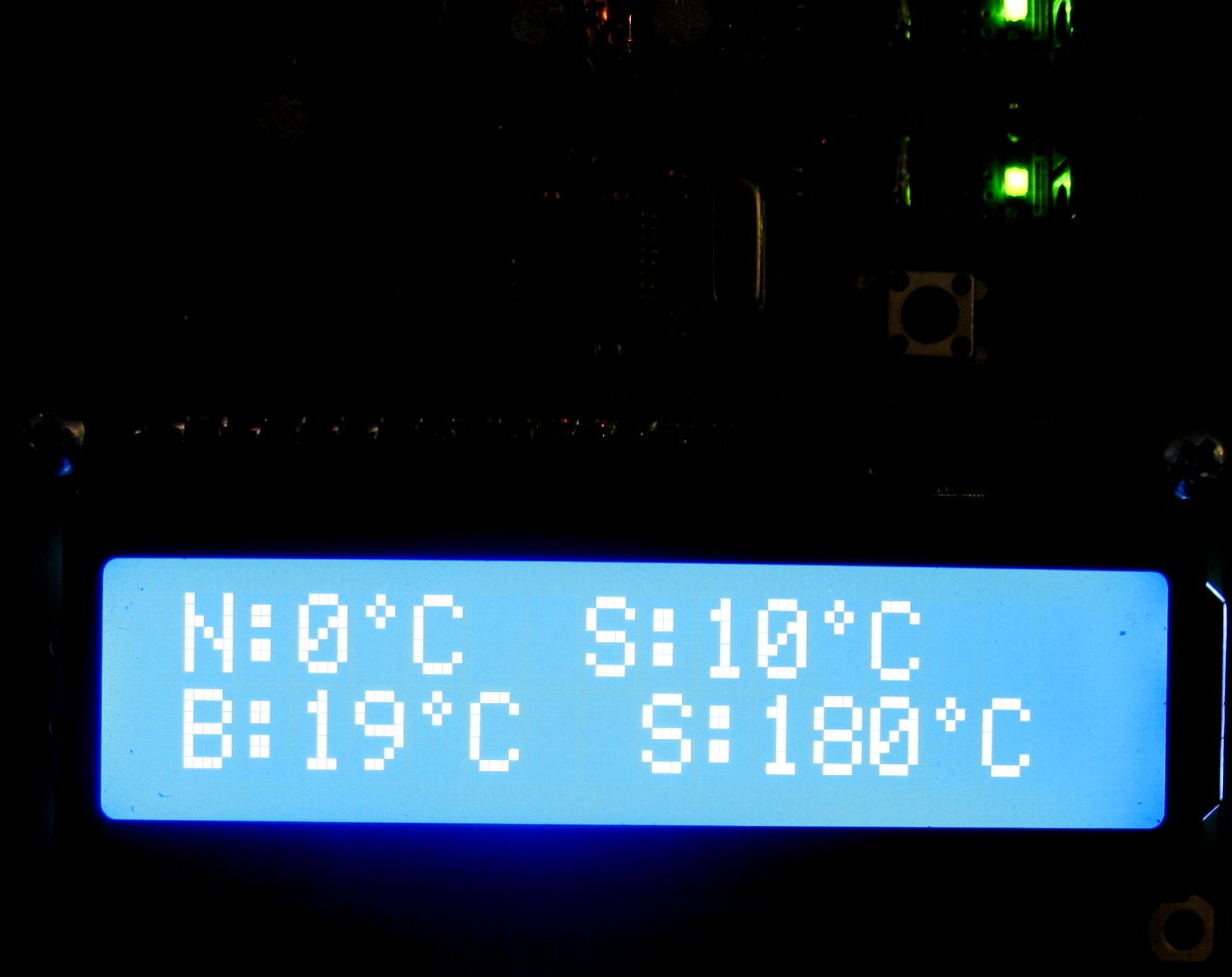

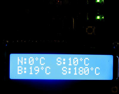

Left: The display on the Gnex control board.
The top line in the display is one control, the bottom line is the other control.
I am using the bottom controller for my hot end.
The B:19C is the current temp of the hot end because I have it turned off and it is at room temperature
The S:180C is the temp I set the pot to and is the temp I want the board to remain at while printing
When I turn the heater on, the temp on the left will continue to rise until it is at 180C
Then the board will continue to monitor the temperature
It will then turn the heater on and off, trying to keep it at 180C
Right: This image shows the two sensor inputs, two 12 volt outputs and the 12 volt source input
The 12 volt source needs to be a very beefy 12 volt dc power supply
I am using a 7 amp 12 volt power supply

Left: A shot of one of the six limit switches
The limit switches will stop the motor if a switch is triggered
This keeps the motors from going beyond the limits of their maximum travel
Each axis has a limit switch at both ends

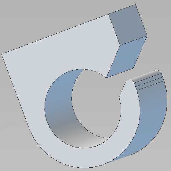

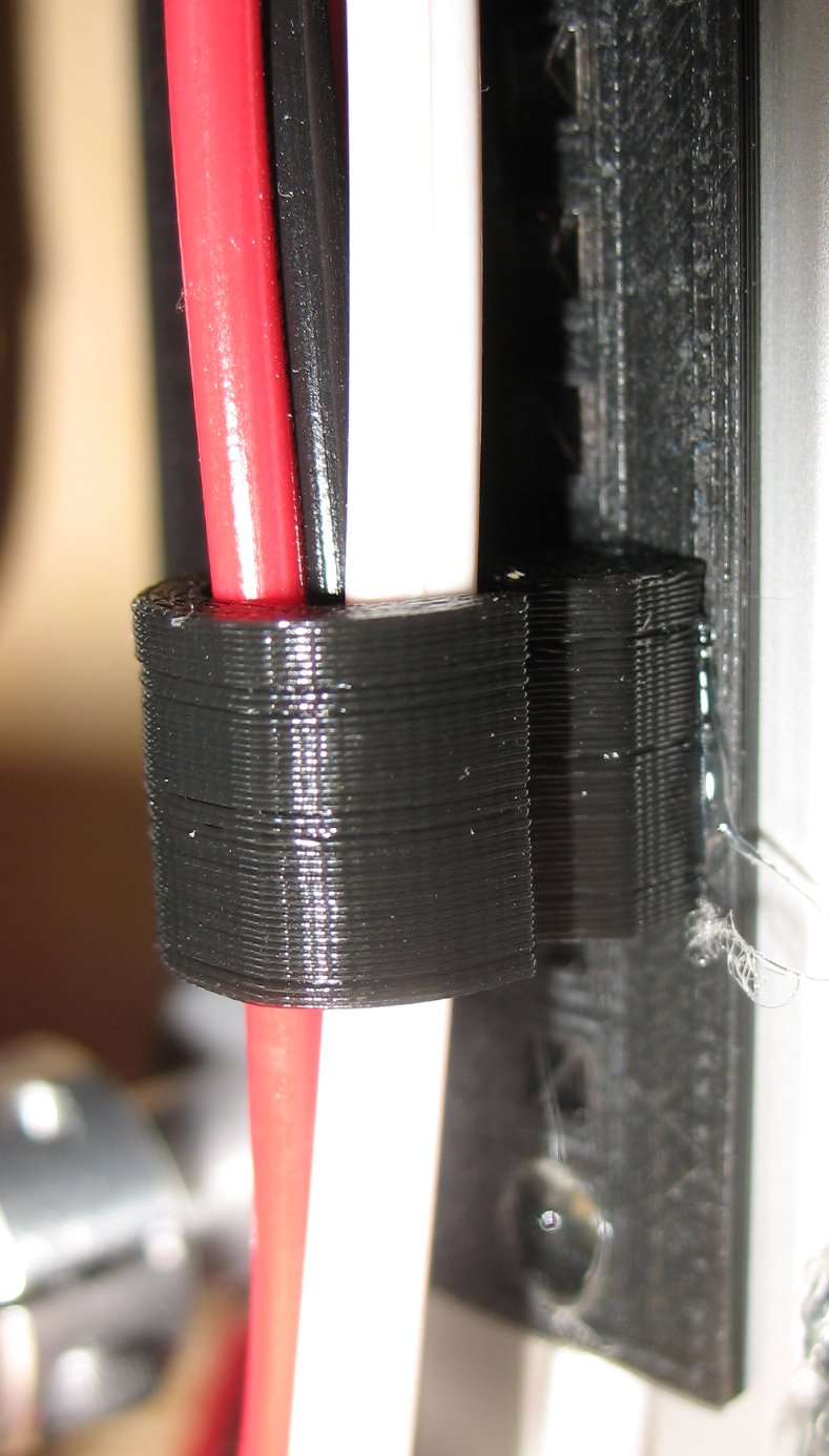

Right: Here's a shot of one of the nifty wire clamps I designed and printed for this printer
I hot glued them in place to keep my wire bundles nice and neat
