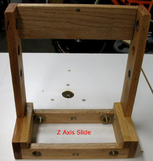

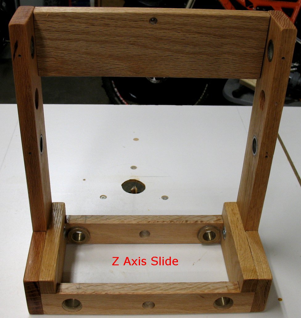

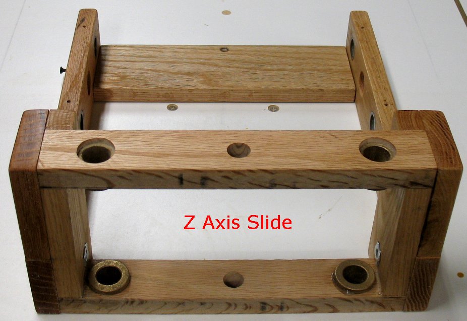

The Z axis slide assembly
Still have to add two center supports to keep this assembly from racking

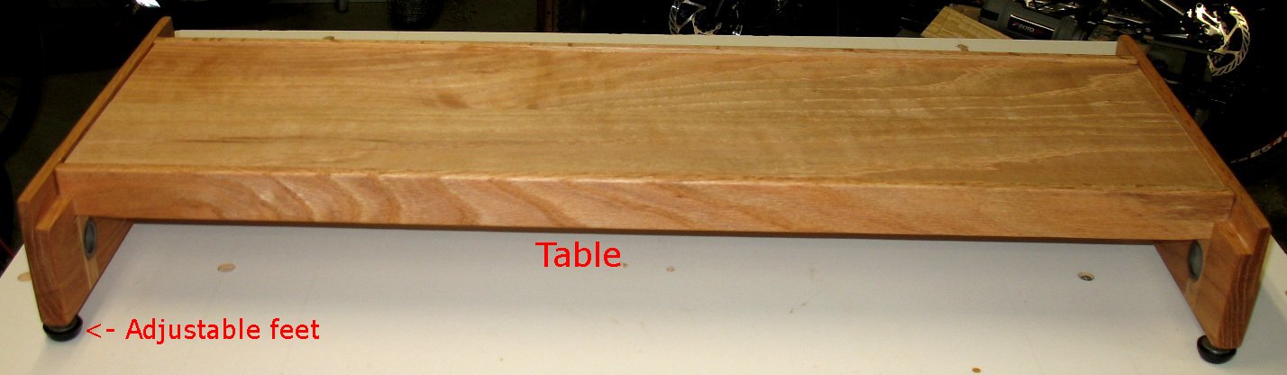

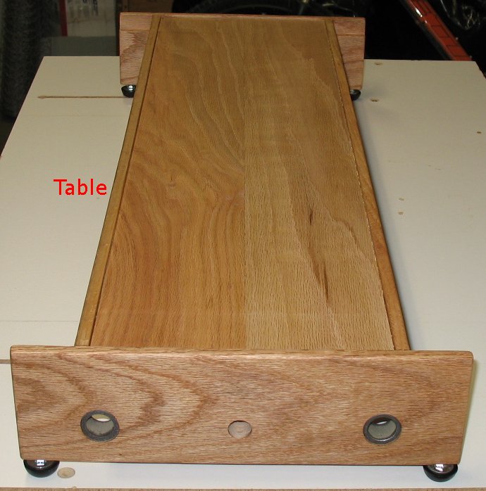

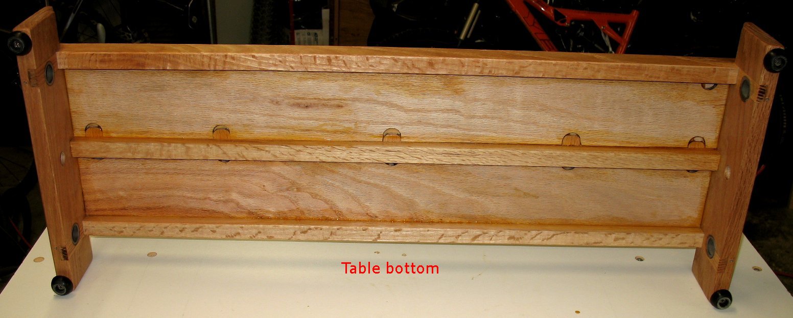

The table.
I added screw in adjustable height feet so the table can be leveled.
image -
I made an oak bolt down surface for the top of the table that is not shown here.
It adds another layer of oak which stiffened up the table surface quite a bit.
