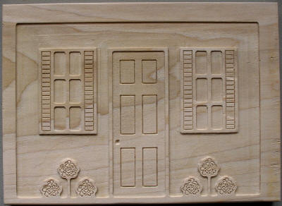

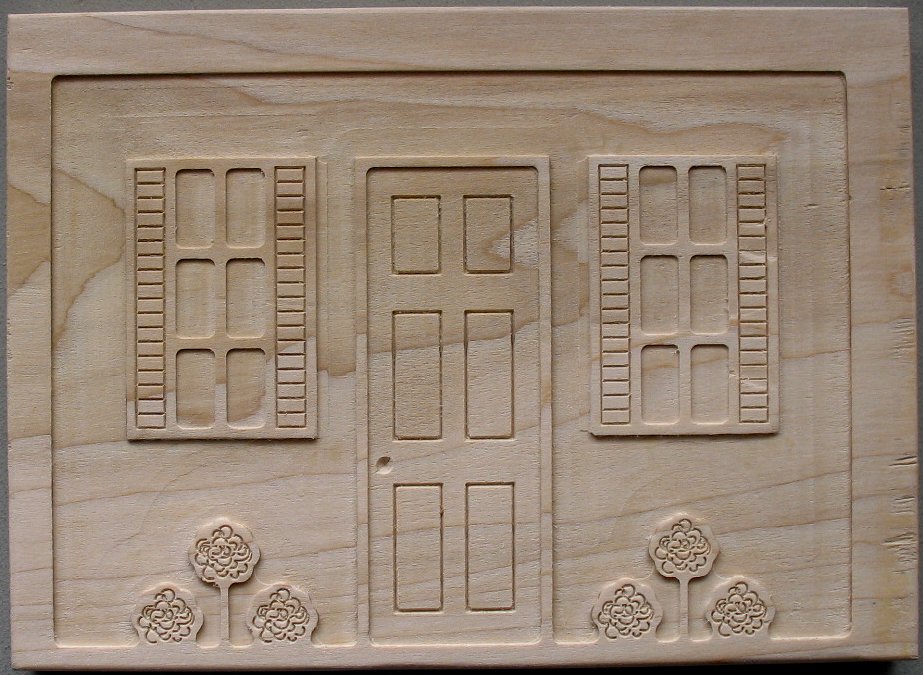

Fancy bird house front.
I was experimenting with doing different depth layers. This wood carving used 3 bits. a .25" flat endmill to remove the bulk, a .125" flat endmill to clean up and profile the edges, and a 60 degree engraving bit to carve the details. The shutters, door panels and squiggly lines on the bushes are engraved.
