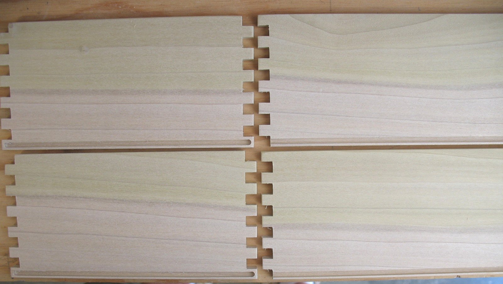

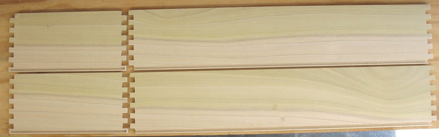

 I made four more finger joint CD/DVD boxes. This time I took it a step further and let the CNC machine cut out the box pieces and also cut a groove for the box bottom. They came out much cleaner than the first set of boxes. On the first set of boxes, I used a table saw to cut the 3" width of all the pieces and I used a router table to cut the .125" groove. I still used the router table to do a .125" roundover on all the box edges after the boxes were assembled.
See my first finger joint box page to see how the Finger joint CNC jig works.
You can see the .125" grooves in the pieces above. The fingers come out super clean and tight.

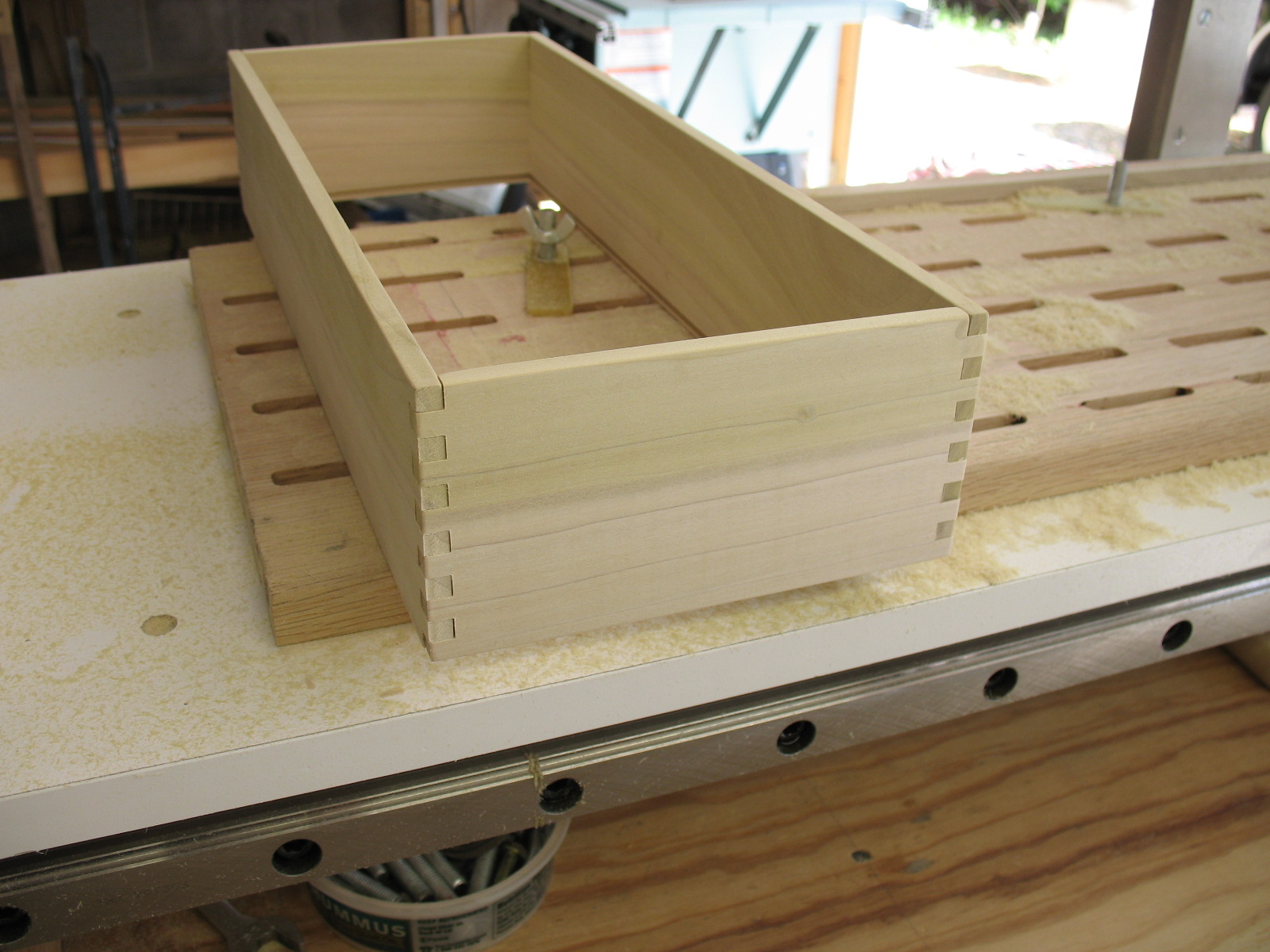

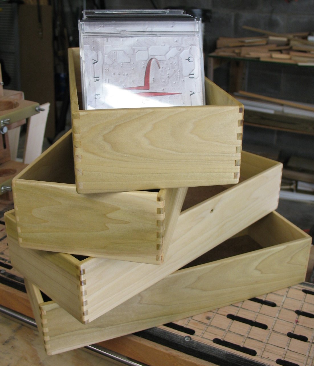

A rough assembly fit All four boxes finished
