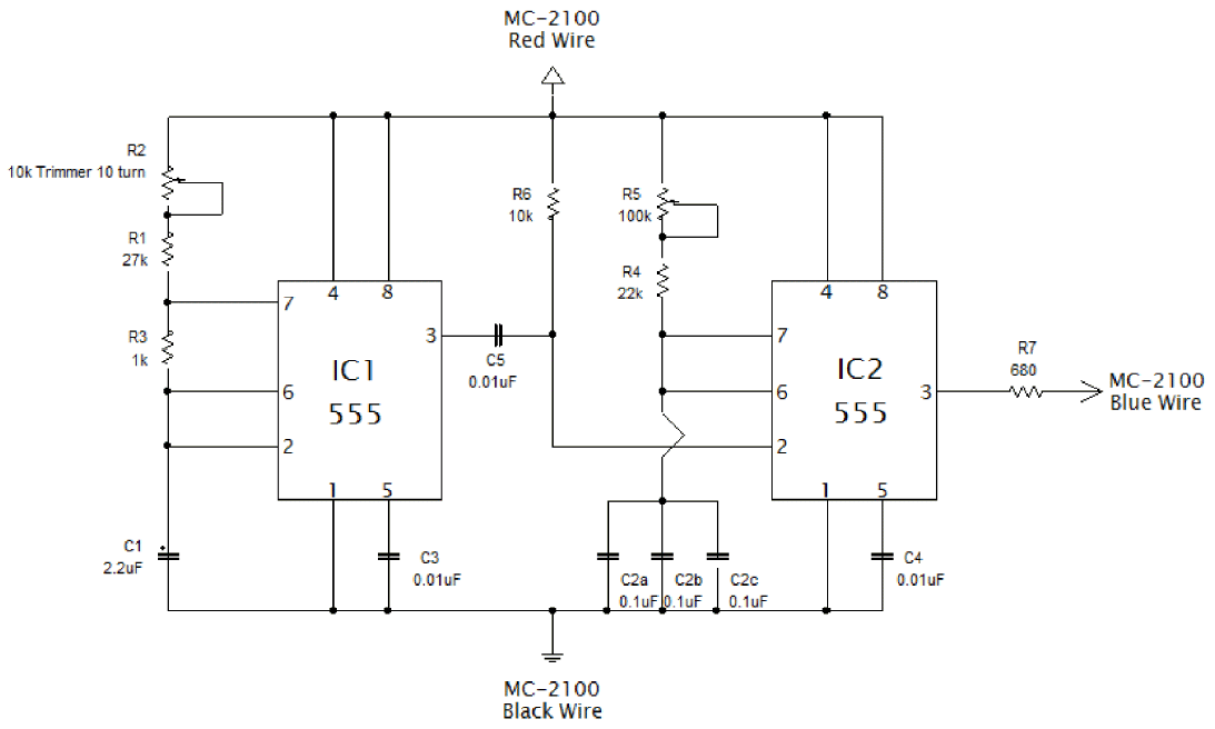

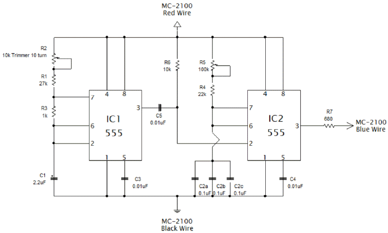

This is the original circuit that I found on the web
It creates pulses and drives the MC-2100 speed control board using a couple 555 timer IC's

I ended up modifying Terry's circuit in a couple places - See my modified version below

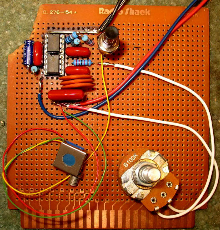

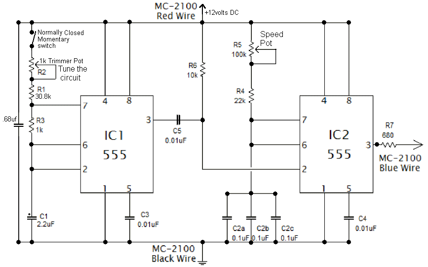

This is my modified version of Terry's circuit

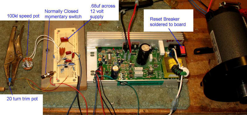

I added a .68uf cap across the 12 volt supply and ground.
I could not get the circuit to start up and generate a pulse until I added this cap
I did not have a 10k trim pot on hand and so I used a 50k multi turn trim pot to tune the circuit
After I had found the sweet spot, I measured the 50k trim pot value and found that 31k was the spot the circuit would start to work properly
I replace the 50k trim pot with a couple resistors that added up to 30.8k and used a 1k multi turn trim pot to do the fine tuning
Note that you need to have a multi turn trim pot for R2
You cannot use a regular pot, it is too coarse and not able to dial in resistance in fine increments
R5 is a pot also and you can use a regular 100k linear pot for the speed control
The last mod I did was to add a normally Closed momentary Switch between the trim pot and the 12 volt supply
A treadmill motor controller is designed to not turn on until there is user input
You do not want a treadmill to start up full blast and possibly injure the person using it
Breaking the voltage connection with a momentary switch seemed to do the trick

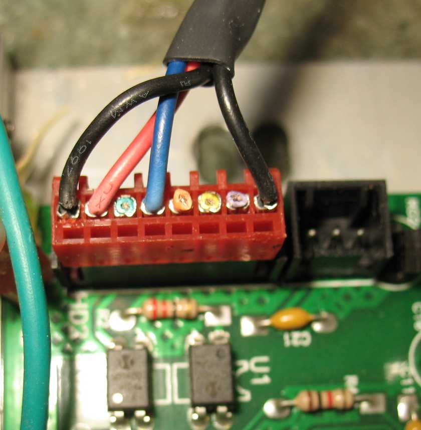

There are four wires coming from the MC-2100 board
Two Black ground wires
One Red +12 volt power wire
One Blue signal wire
The other wires on the jumper plug are not used
After the MC-2100 board receives power, the LED comes on solid
This means the board is receiving power
Once I push the momentary switch, it removes power from 555 timer IC1
Then I release the switch and power is restored
Now the MC-2100 board will start up and turn on the Motor
The MC-2100 LED will now blink because it is receiving a pulse from the 555 timer circuit

I first constructed the circuit on a breadboard to make sure it worked properly
Click on the image to see a larger image
Treadmill Motor Speed control

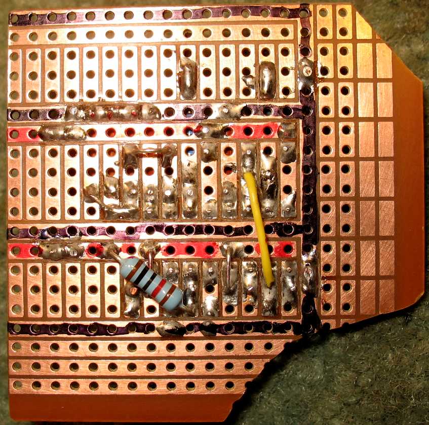

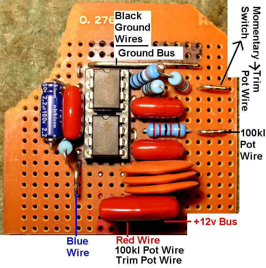

Once I had the circuit working properly, I used this scrap piece of radio shack board to construct the final circuit
The top left corner of the board was broken off, it's just fine for this project
I then cut down the full sized board down to size with a Dremel tool cutoff disc
This image has some descriptions of where the wires get connected

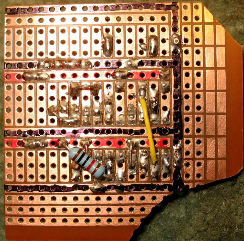

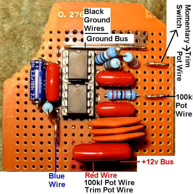

Here's a shot of the back side of the board
It was nice that the board material had copper bus runs on it
I had a +12v bus and a ground bus
They are colored red and black with a sharpie pen
The copper buses allowed me to keep the jumper wires to a minimum

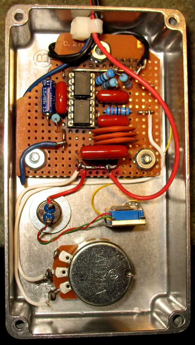

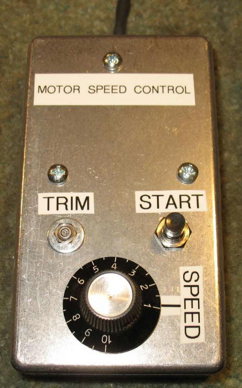

I mounted the board in a box with three standoffs and some #6 screws
The wires from the MC-2100 were routed through a small hole
A cable tie was used to keep the wires from being pulled back out of the box
The normally closed start switch was installed below the board
The 1k multi turn trim pot was installed below the board
The 100k linear speed pot was installed below the board

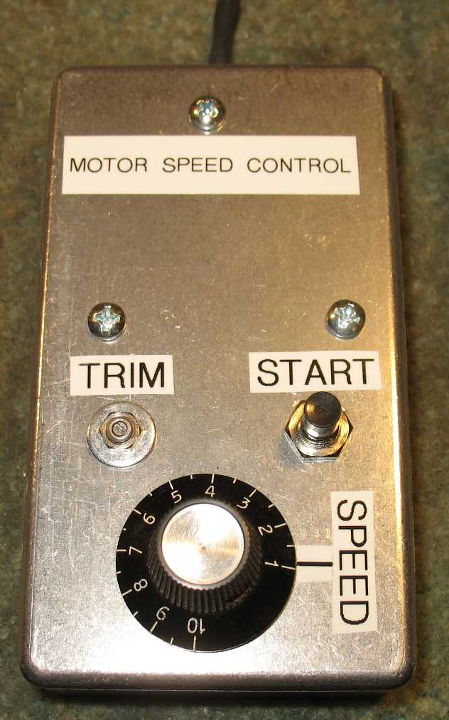

Here's the front shot of the box
I used a Brother P-Touch to create the labels

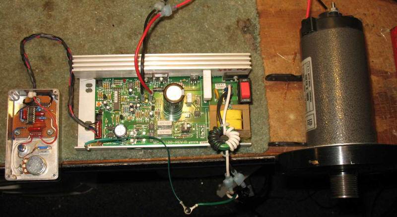

Here's a shot of the whole rig
The 555 control box
The MC-2100 board
The Treadmill DC motor

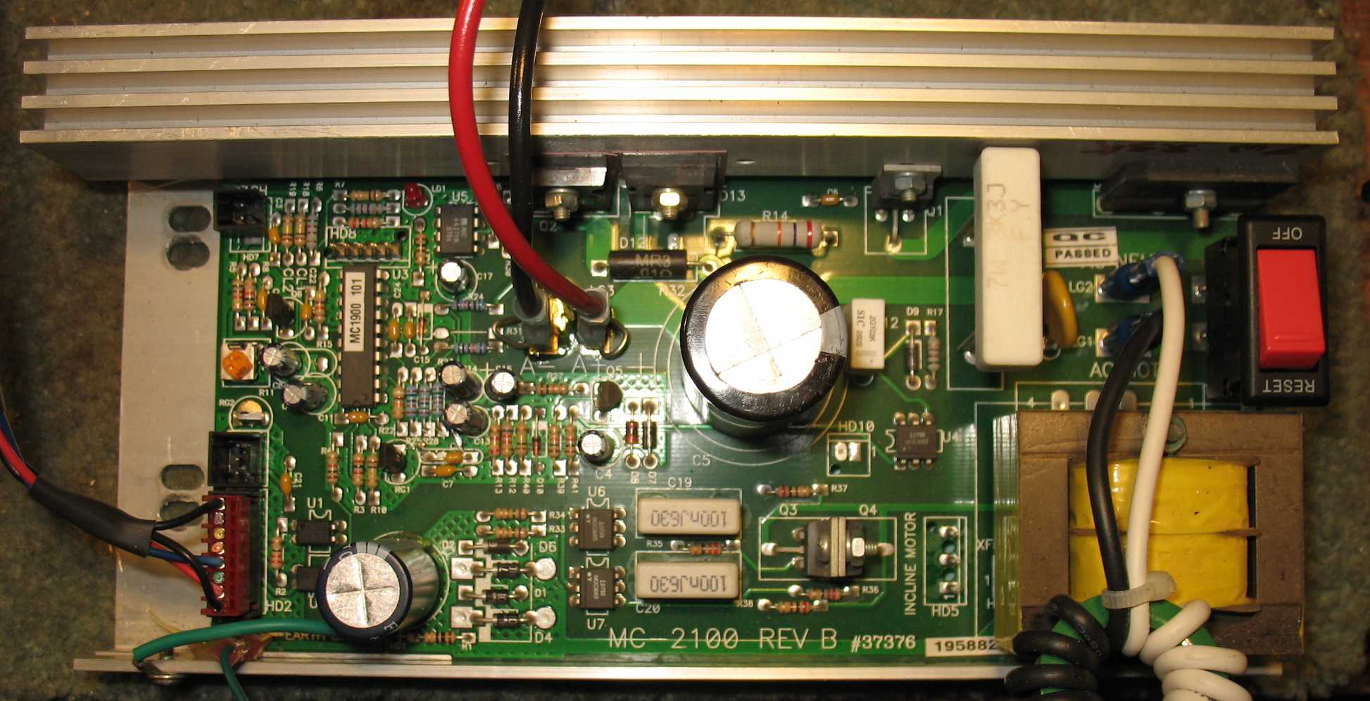

Here's a shot of the MC-2100 board
The Black and White wires on the right side are the AC power cord wires
The black and red wires in the middle are the Motor wires (A- and A+)
Red is A+
Black is A-
Do not reverse your motor wires
Some motors are designed to turn in a specific direction
My motor turns clockwise
The flywheel is threaded onto the motor shaft so that running the belt clockwise does not loosen the flywheel

Here's a shot of the HD2 jumper plug on the MC-2100 board
The two black wires are ground wires. They are twisted together at the other end.
The red wire is +12 volts
The blue wire is the control signal that brings in the pulses from the 555 circuit board
You do not need to use the other wires on the jumper

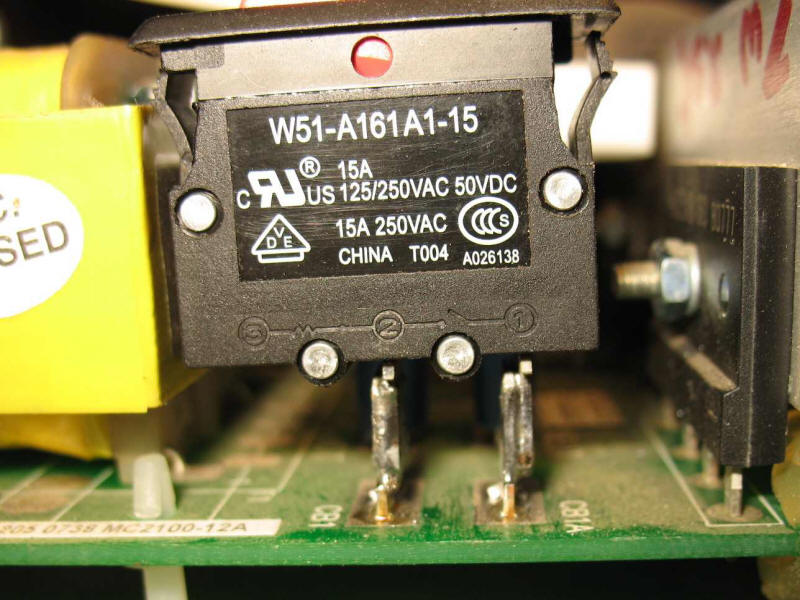

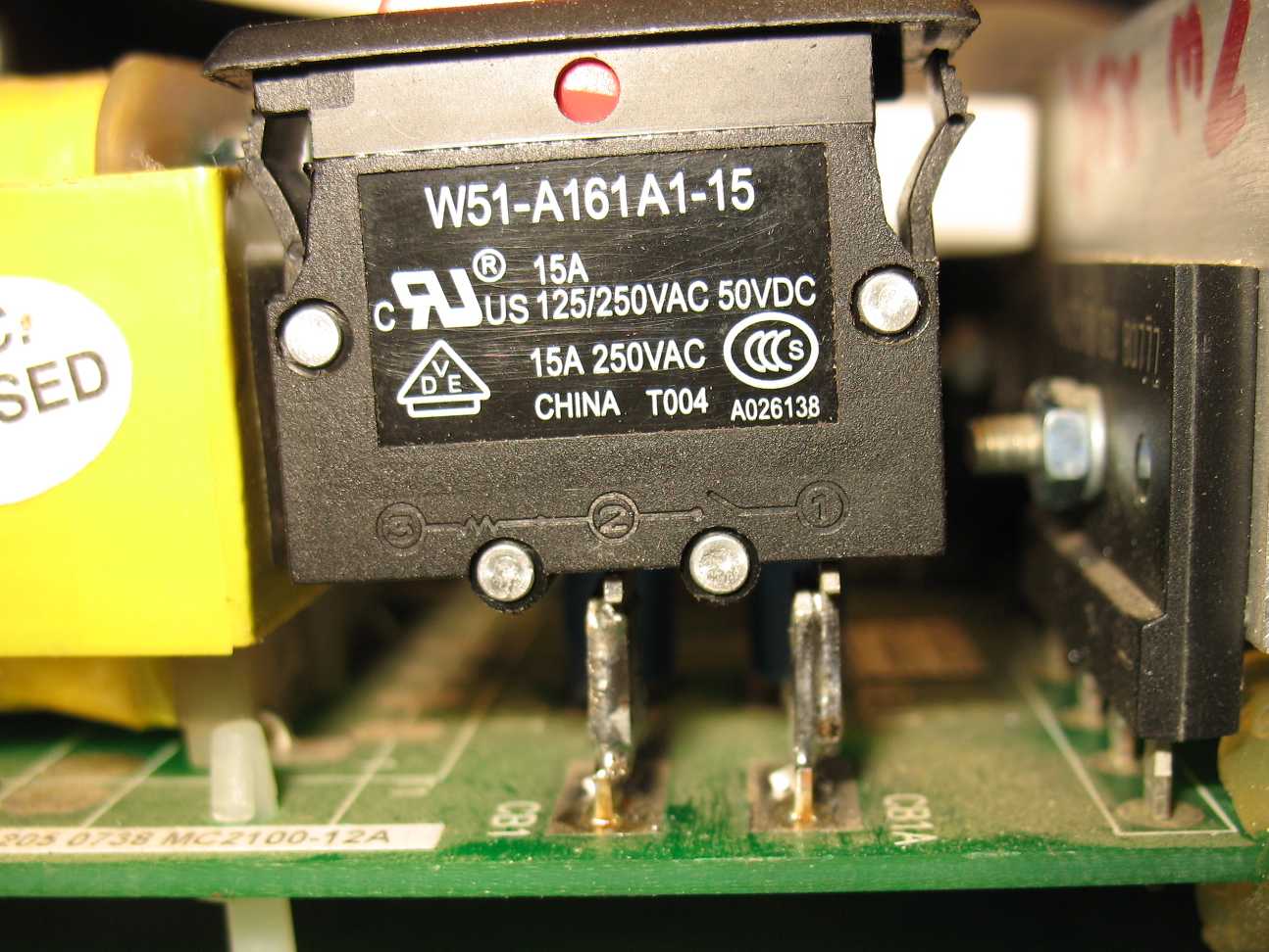

This 15 amp circuit breaker was located on the frame of the treadmill
It is used to prevent a current overload condition
I soldered the breaker directly to the two lugs on the MC-2100 board
I use the rocker switch to turn the MC-2100 On and Off
The MC-2100 board will not operate unless the two lugs CB1 and CB1A are connected
My motor had two blue wires that went to a heat sensor cutoff switch
The heat sensor will open open up and stop the motor if it gets too hot
I removed the heat sensor from the motor because it is not going to be used very hard for my application
