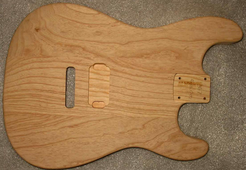

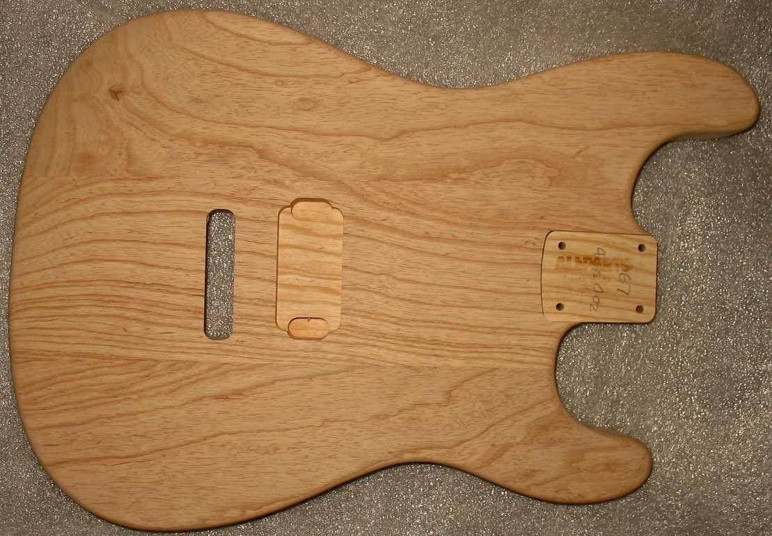

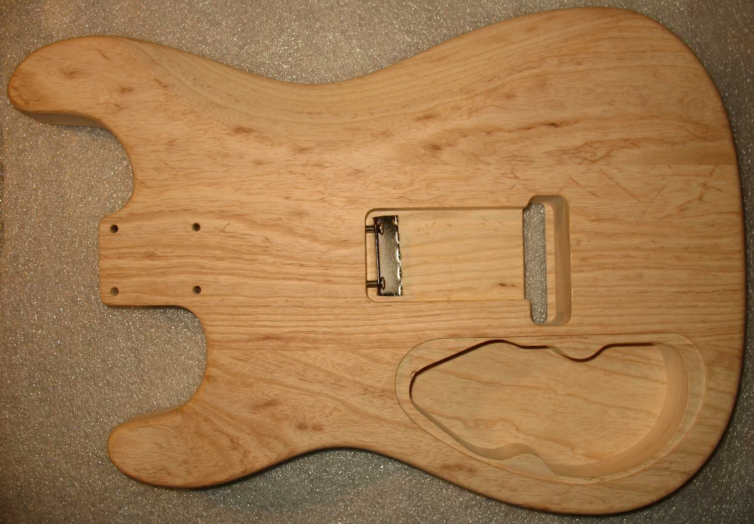

I ordered the body and  Neck from All Parts.
The rear pickup hole is too small for a Jazzmaster pickup.
It will get machined on my CNC machine.

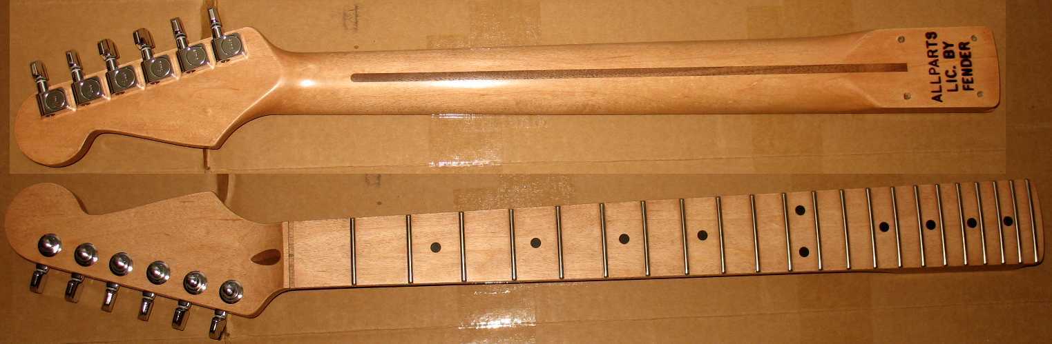

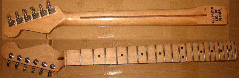

Here's the neck with the Fender custom tuners installed

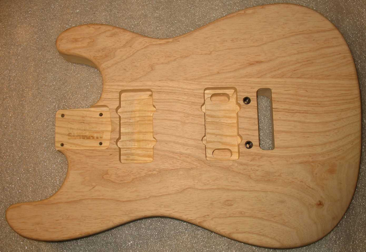

Here's the body after I routed out the pickup holes for Jazzmaster pickups
I also had to drill for the floating trem studs

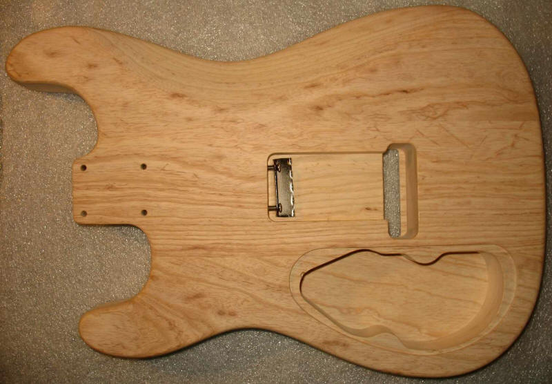

I had to route out truss rod access that is not shown here

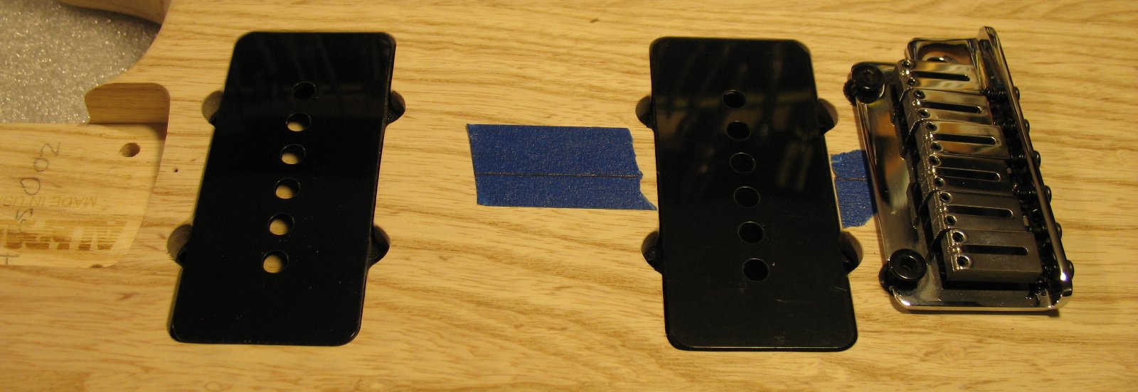

I dropped the pickup covers in to make sure they fit
The Fender custom bridge is checked for fit

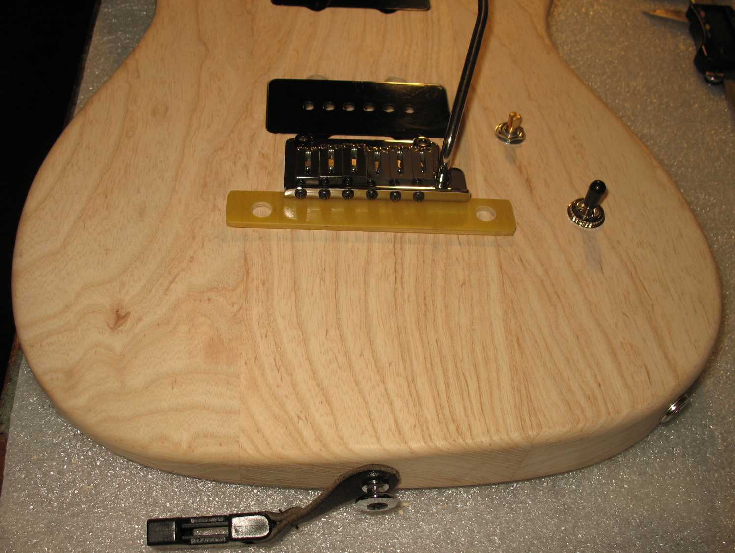

Volume and pickup selector holes were drilled
A tone control pot was added later

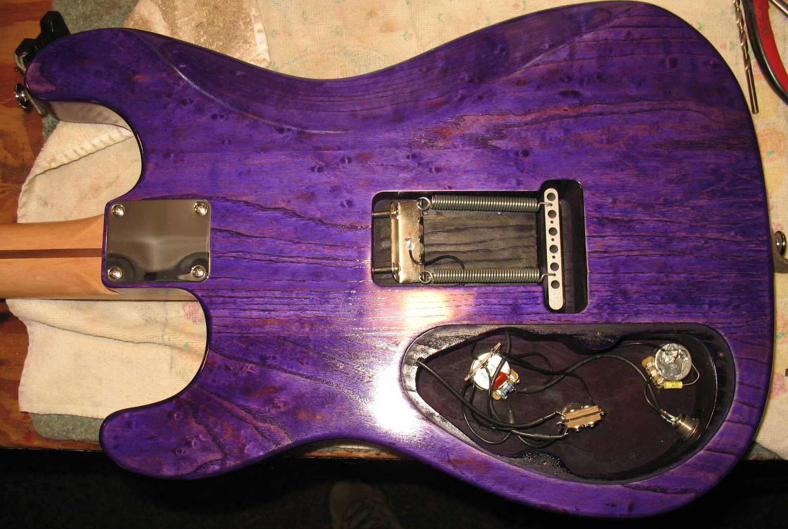

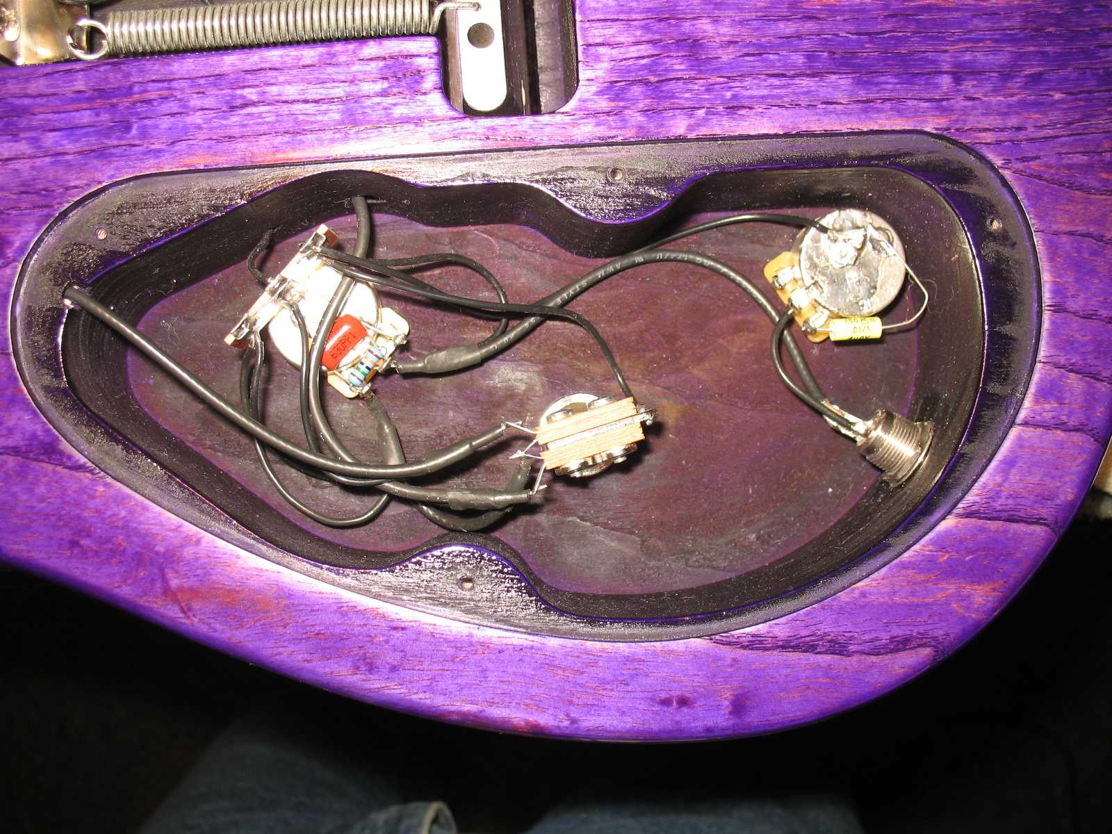

The control panel is wired
The bridge and springs are installed

A close up of the control section
Note that I installed a Fender TBX tone control, not shown here

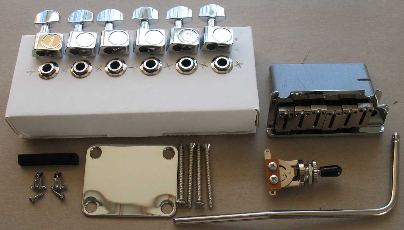

Here's the Fender hardware I used
I added a Gibson pickup selector switch
Note that I switched the metal saddles to graphite saddles later

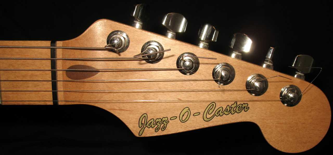

I had a custom decal made at a later date.

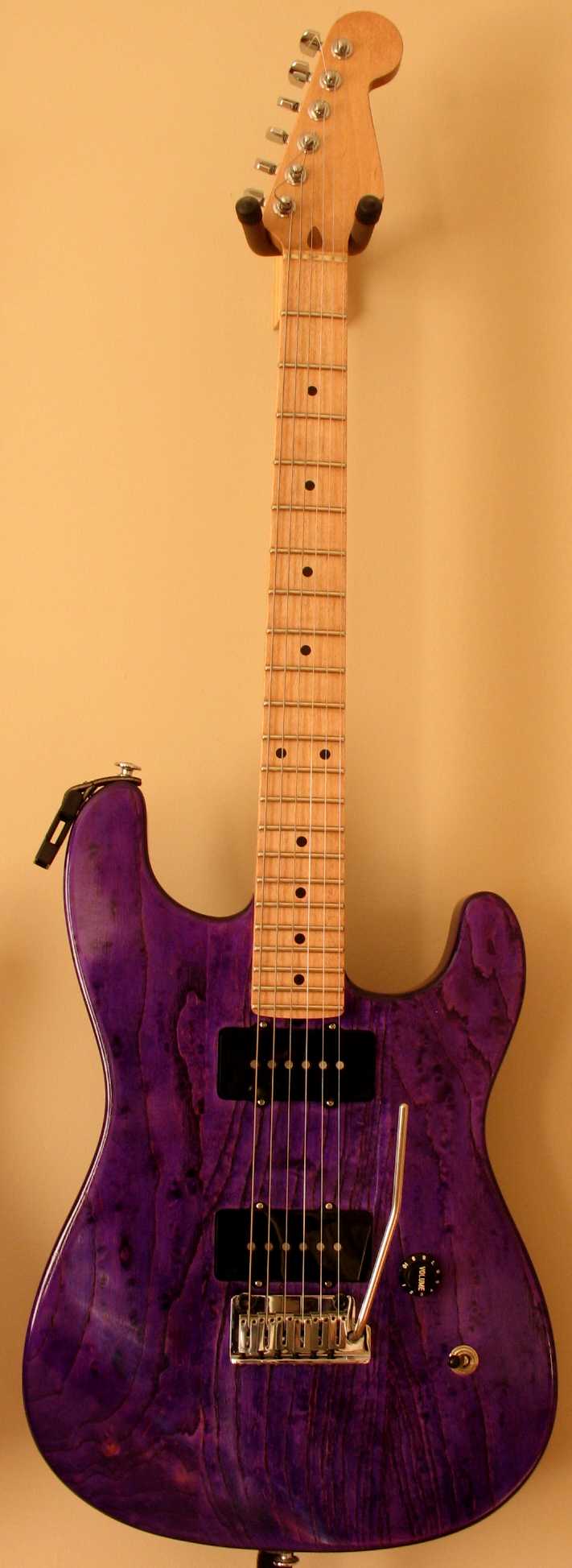

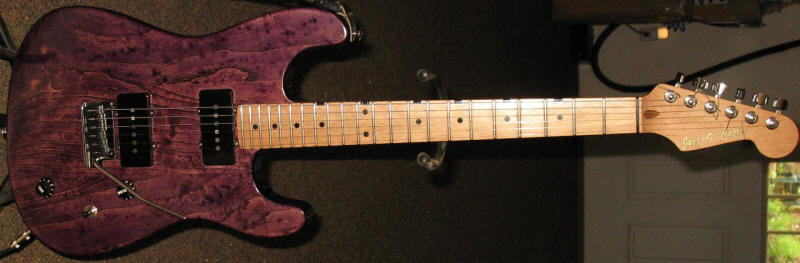

Just a shot showing the color
The tone control and decal were added later
