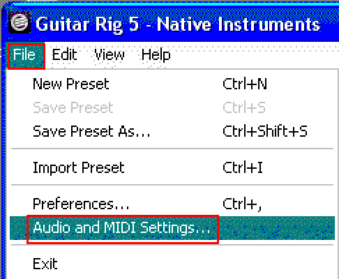

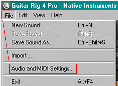

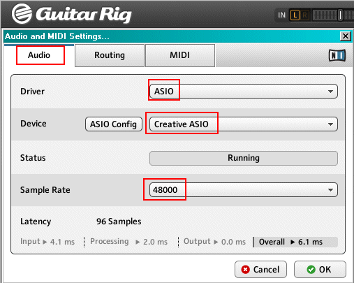

In Guitar Rig, go to File then Audio and MIDI settings to make your audio setups.
image GR5 audio

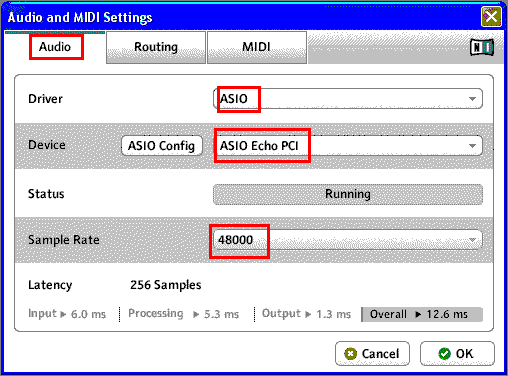

Click on the Audio tab and set the driver to ASIO
in the device drop down menu choose the audio card ASIO you will be using
The screen shots above show two different sound card device setups
Choose the sample rate

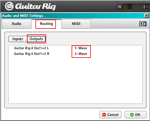

image GR5 Routing

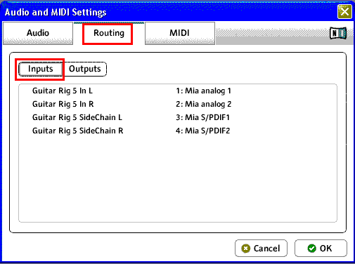

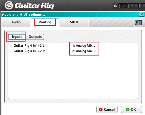

Click on the Routing tab and then click on the Inputs button.
Select which inputs you will be using
image GR5 Routing

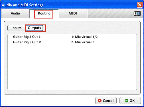

Now click on the Outputs button and set the outputs you will be using

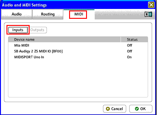

image GTR5 midi

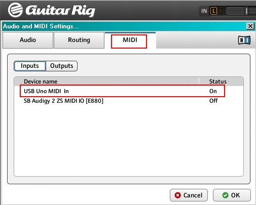

If you have a midi interface you want to set up, click on the Midi tab
I use a USB M-Audio uno midisport for my midi interface
If your midi interface is hooked up and running correctly, click on the status and turn it on
I use two Behringer FCB1010's to control guitar rig
You can see info about the FCB1010 here.

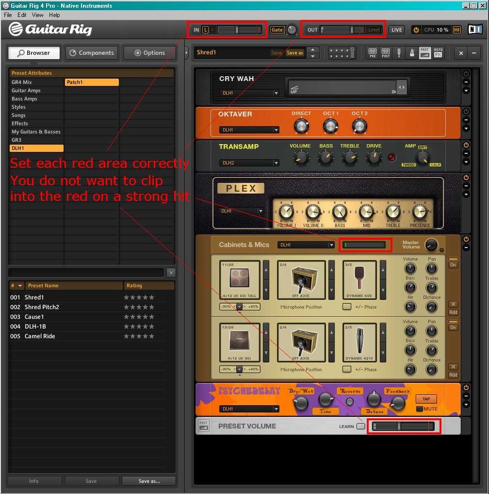

Guitar Rig 4 screen shot
You need to set all the levels correctly in order to get a strong signal without clipping into the red
You set each level in the order it travels through Guitar rig, from start to finish
Set the levels by strumming your guitar hard
Set the Input level - Top Left of screen shot
Set your cabinets & mics - middle of screen shot
Set the pre-set out volume - Bottom of screen shot
Set the output level - Top right of screen shot

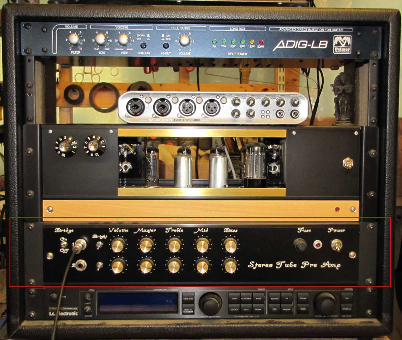

The level coming out of your sound card may need adjusting
Also, I am feeding a signal from my pre amp into my sound card via the line in jack
I have to set the level of that input also in the windows control panel volume
