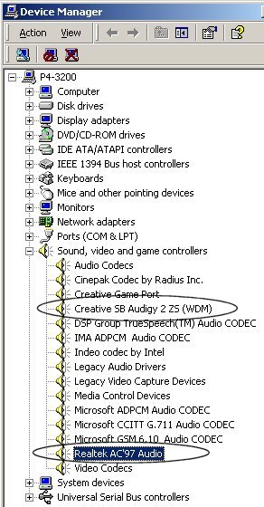

 I have a Creative SB Audigy 2 ZS card installed in a PCI slot that I use for GR and I am also using the on-board Realtek AC'97 soundcard that is on my ASUS mother board for playback. Both cards are installed with the proper drivers and Windows XP has sorted it all out nicely. Each card has it's own IRQ and resources and there are no conflicts. Both sound cards have their own set of speakers so I can hear the output of both cards at the same time on separate speakers.

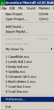

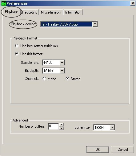

Mixcraft 2 preferences I have the playback tab set to the motherboard AC'97 soundcard.
I have the Recording Tab set to the SB Audigy card.

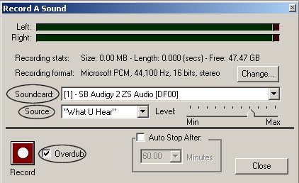

When you hit the record button on Mixcraft 2, this window pops up. To record and overdub Guitar Rig choose the Soundcard that you use for guitar Rig. Choose Source as "What you hear". Check the Overdub box. Play your guitar and set the left and right recording levels. Hit the Record button when you are ready to go.
