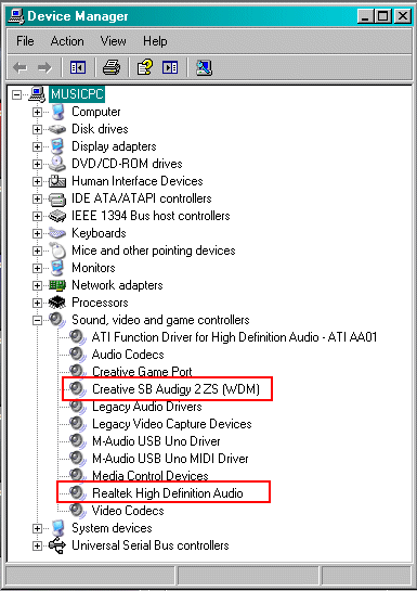

Windows device manager showing the two sound cards I will be using
I also use a  M-Audio Fast track ultra external sound card, not shown on this screen shot
 In order to be able to record the wav output from Guitar Rig and playback the mix without headphones and overdub in Mixcraft, I use two sound cards installed my computer.

 I have a Creative SB Audigy 2 ZS card installed in a PCI slot that I use for Guitar rig wav recording
I am also using the motherboard Realtek soundcard for mix playback.
Both sound cards have their own amps and a set of speakers so I can hear the output of both cards at the same time on separate speakers.

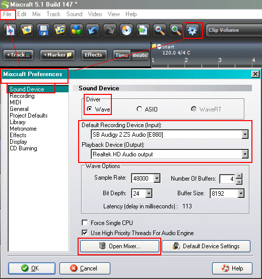

To set up the input and output in Mixcraft, go into preferences
You can get there by going into the file menu or use the icon up on the toolbar
In the preferences screen, click on Sound device
Choose your driver. Here I have chosen Wave
Choose the device you want to record from.
I have Guitar rig set up to use the SB Audigy card and so I am choosing that as my recording device
Choose your playback device
I am playing back the mix on the Realtek motherboard sound card
I do this so that I do not have to wear headphones when I record
Set the Wave options however you like to get a latency that works for your machine.
If you get pops, crackles or stutters, you may have to adjust these setting differently
Another handy Mixcraft feature: You can access the Windows mixer by clicking on the Open Mixer button

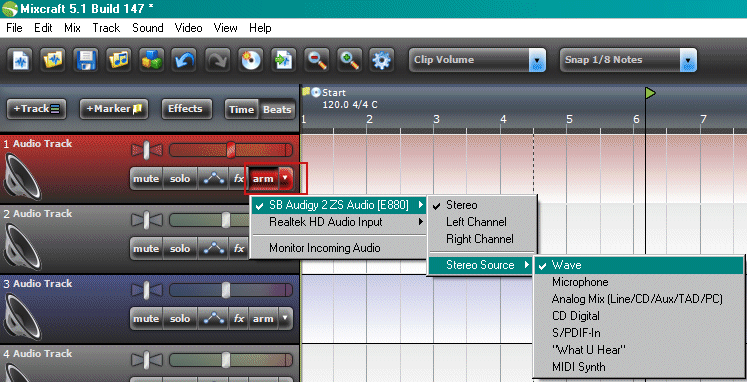

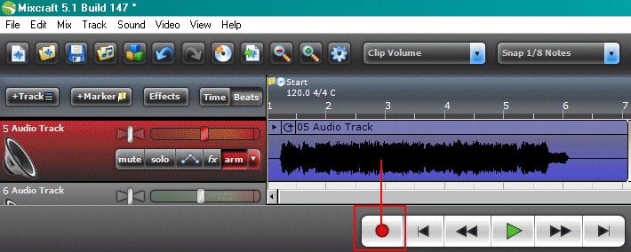

To record the wav output of Guitar rig, arm a audio track in Mixcraft by clicking the arm button
Click on the arrow next to arm to choose your recording source
Here I have chosen SB Audigy, then Stereo, then wave as my recording source
I could also choose "What you hear" or any of the other sources
When you are ready to record, hit the red record button and start playing
Hit the record button again to stop recording
What you recorded shows up to the right on the track
Rewind and hit the playback button to listen to what you recorded
You can move this sound clip down or up to another track and then record an overdub on the same armed track
Click on the recorded track so it is highlighted, then use the up or down arrow to move the recorded sound clip up or down to another track
This way, you do not have to keep arming new tracks and making settings

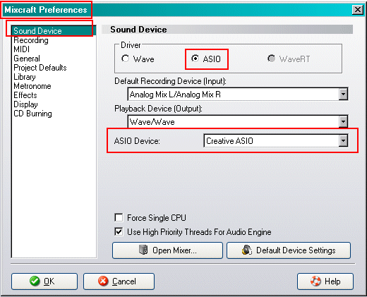

Go into Mixcraft preferences
You can get to there by going into the file menu or use the icon up on the toolbar
Choose your driver. Here I have chosen ASIO
Choose your ASIO Device - I chose Creative ASIO

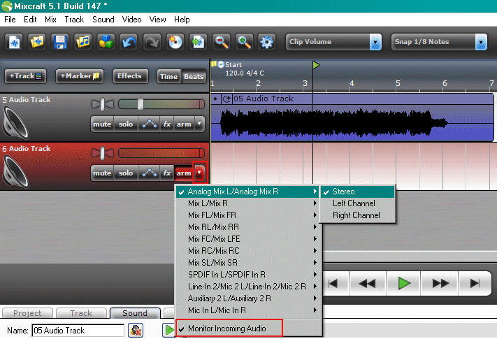

Arm the audio track in Mixcraft by clicking the arm button
Click on the Monitor incoming audio to be able to hear the Guitar rig effect while you play
The arm button is supposed to be red in this screen shot, I shut it off by accident.

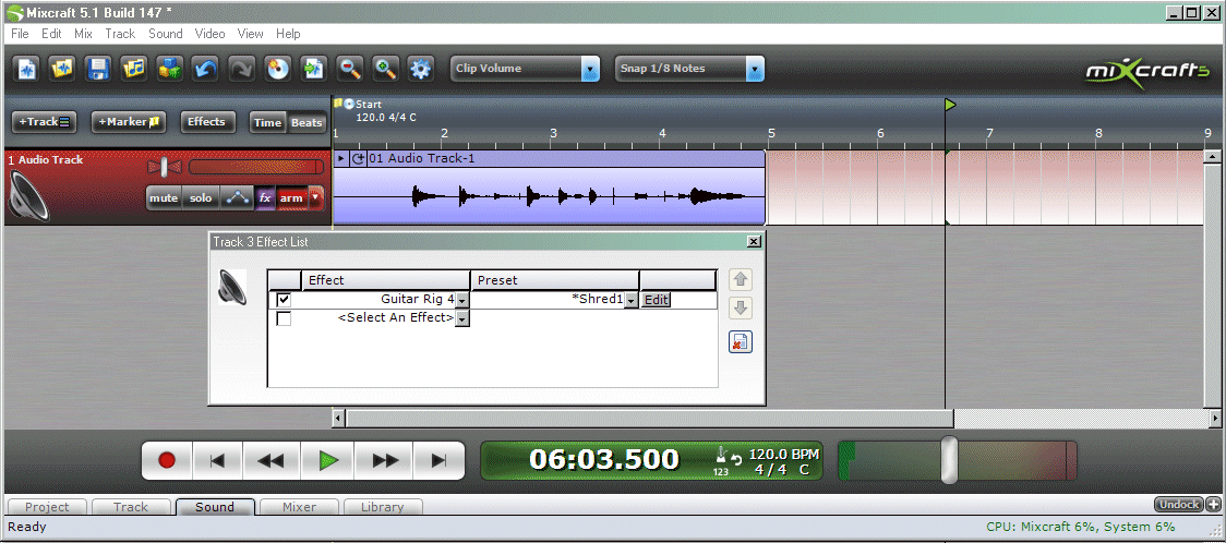

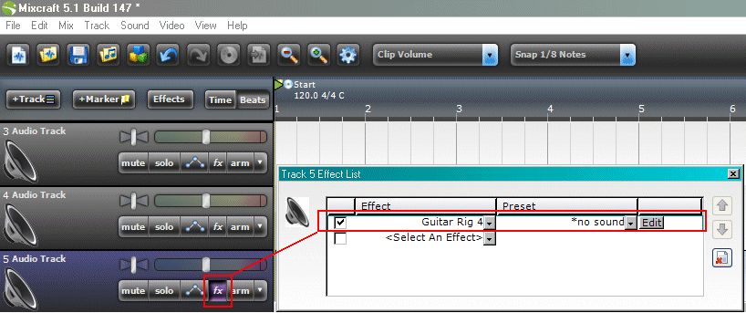

Hit the FX button and add Guitar Rig 4 as an effect for the track
Then hit the edit button to be able to choose which Guitar rig preset you want to use on this track

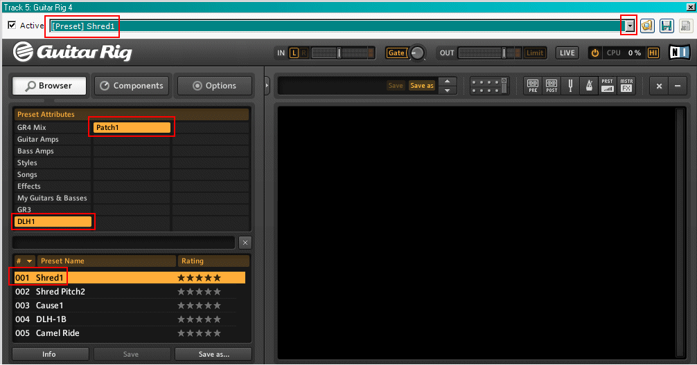

After you hit the edit button, the Guitar rig VST screen will open

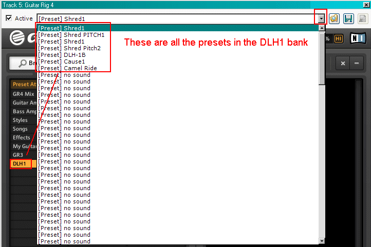

Choose the preset you want using the Guitar Rig browser on the left side of the screen
Here you can see I chose the DLH1 bank
Then hit the down arrow showing at the top of the screen shot above
You can then choose the all the presets that are in the DLH1 bank by using the pull down menu
Here's all the presets in the DLH1 bank
I am now using the Shred1 preset for my FX sound on track #5 in Mixcraft
Now Guitar rig4 is the effect for this track and Shred1 is the preset that will be used
