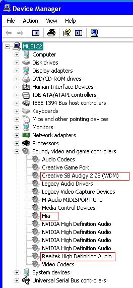

Windows Device Manager
Device manager
Windows device manager showing the three sound cards I have installed
The Soundblaster Audigy card is what I will record from using the Creative ASIO driver
The Mia sound card is being used by Guitar Rig using the MIA ASIO driver
The Realtek is a motherboard sound card that I use to play .mp3's and the windows systems sounds

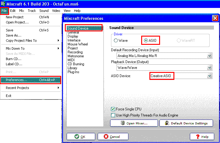

Mixcraft
To set up the input and output in Mixcraft, go into preferences
You can get there by going into the file menu or use the icon up on the toolbar
In the preferences screen, click on Sound device
Choose your driver. Here I have chosen ASIO
Choose the input device you want to record from.
I am using the analog mix Left and Right
Choose your output or playback device
I am playing back the mix as wave
I chose the Creative ASIO driver in the screen shot above
This is what I will be recording from in Mixcraft

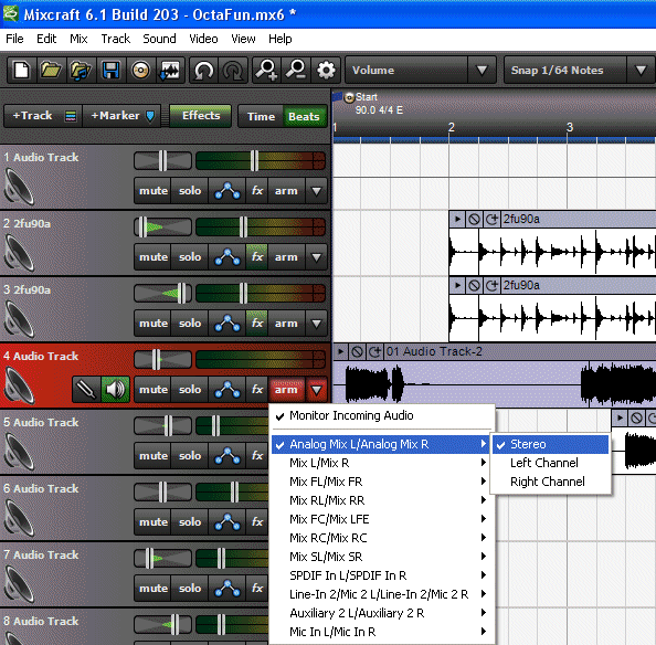

Mixcraft
This screen shot shows how I have my recording track set up in Mixcraft 6
Press the arm button to arm this track and the ARM button turns red
Use the drop down arrow next to the ARM button to select your recording source
I have selected Analog Mix left and Right and then I selected Stereo
Click the Monitor Incoming Audio so you can hear the output from Guitar Rig
Now when you play your guitar, you should see some activity in the level meters on your recording track
