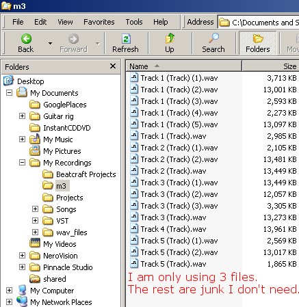

image Wish list - File/project moving utility.
<- This example is just a small test project. Some projects end up with 50 files in a folder. Maybe only 20 of them are really being used on the project.
I end up with lots of bad takes, takes that I re-do, files that I end up not using, etc in a Mixcraft project folder. There's is no way to delete all these unused files except to write down every file used in a project and then go to the folder and weed out all the unused files. What a pain!!!
Ever start a song and not have a name for it? I will write a song and name the folder UnamedTune3, or whatever. Later on, I will have named the tune. Now I want to name my Folder Stir Crazy or whatever the tune name is. If you rename that folder your project will be trashed. Mixcraft will start searching for the file names. Say it is searching for drum6.wav. I must have 30 drum6.wav files in all my different project folders. It will pick the first drum6.wav file that it finds as it searches for the file. That's not the drum6.wav file I used on the project. Your project is trashed unless you keep the same file folder name and do not move that folder.
I need a utility that can move and rename a project.
It would look at the project MXC file.
Find all the file names used for that project.
Ask what the new folder name and location should be.
Create the folder.
Copy all the project sound files to the new folder.
I could then delete the old folder and free up tons of disk space. The unused files would be deleted, problem solved.

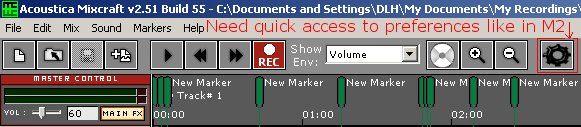

image The preferences toolbar button is missing.
This was a handy feature in M2.
