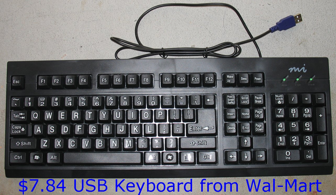

Here's my victim, a $7.84 USB keyboard from Wal-Mart.
How can they make and sell something this complex for that cheap?

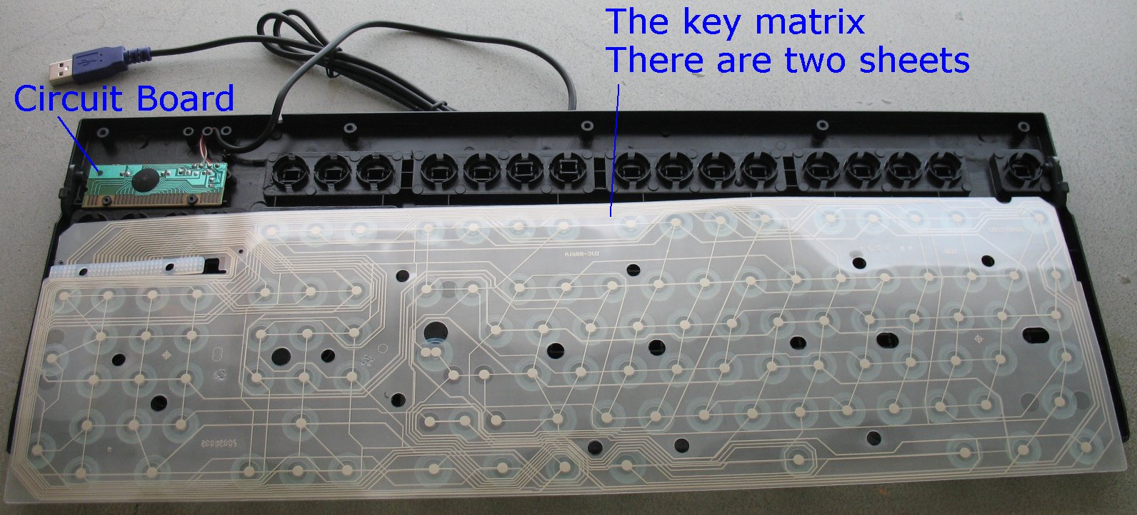

The inside of the keyboard.
The circuit board is on the upper left.
The clear sheets have been pulled forward.

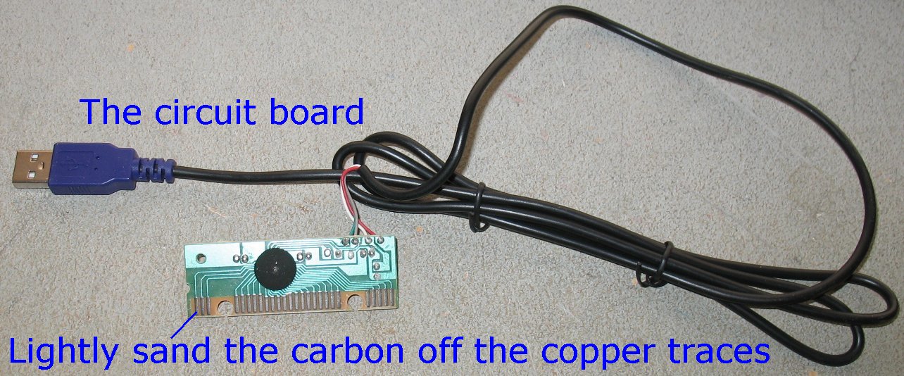

Here's the guts of the whole thing. These are the only parts we will use.
The circuit board and the USB cable

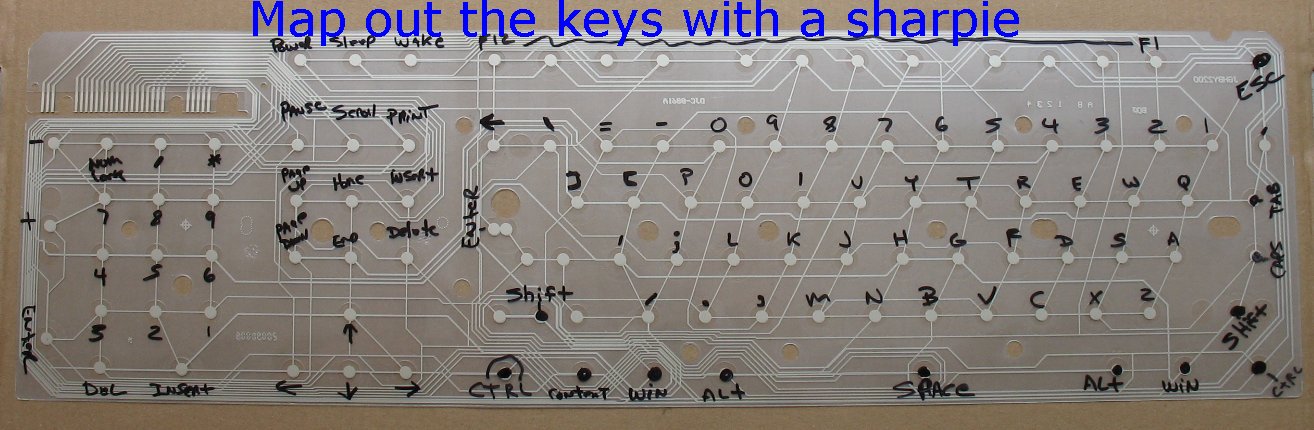

Lay the sheets back on the keyboard and map out the keys with a sharpie
You don't have to do them all, only the keys you are interested in.
The electrical connection between the clear sheets and the circuit board is only a press fit.
The circuit board has copper traces, but the traces are coated with some sort of carbon dust.
When you press the carbon traces on the circuit board up against the carbon traces on the sheets, they make the electrical contact.
You have to lightly sand the carbon dust off the copper traces in order to be able to solder wires to the copper traces.

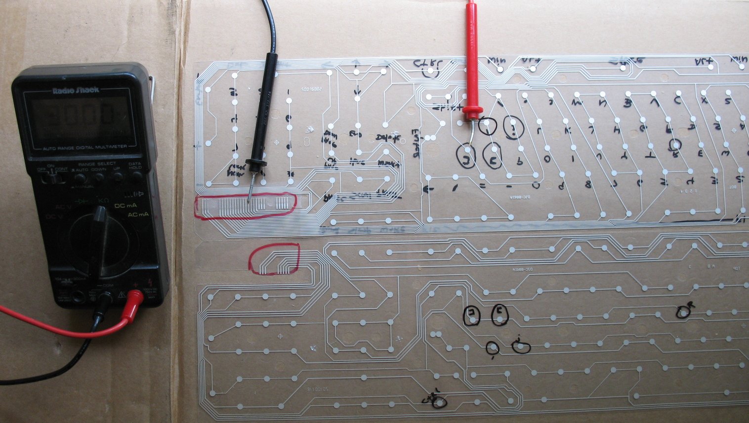

Split the spot welded sheets apart carefully.
Don't rip the plastic sheets apart and break any of the traces
I have the sheets laid out like an open book here.
Only one side of each sheet has the carbon traces.
You can use a multimeter set to continuity-Beep to trace the round key pads back to the area that contacts the circuit board traces.
It's a whole lot easier with a meter that beeps.
If you don't have a meter that beeps, you will have to follow the small traces back manually.
When you press a key, the two sheets come together to make a connection.
For every key pressed, you have to trace two connections back to the circuit board, one from each sheet.
The red circled area on the upper left is the area that contacts the circuit board traces.
Count over from left to right the number of traces and make note of that for each key you want to use.
On my project I am only using the [ and ] keys.
The [ key mapped out to #14 and #20 on the circuit board traces
The ] key mapped out to #7 and #20 on the circuit board traces
So, if I solder a wire to #14 and #20 and I touch those wires together, it will trigger the [ key.
The key mapping is going to be different for every type of keyboard, so my map above is no good for other keyboards.
You will have to map out your particular keyboard.

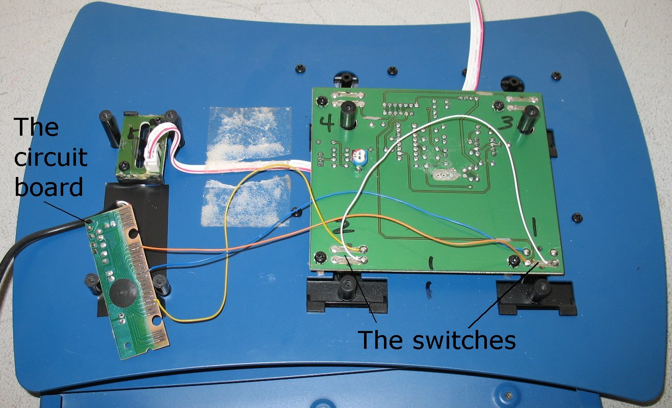

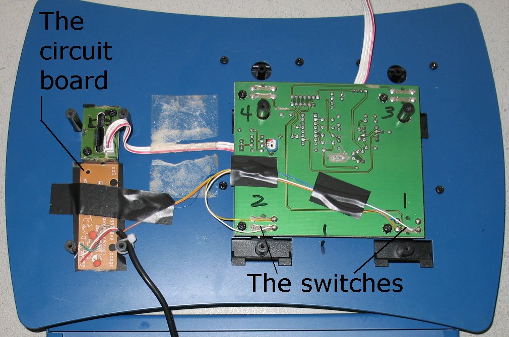

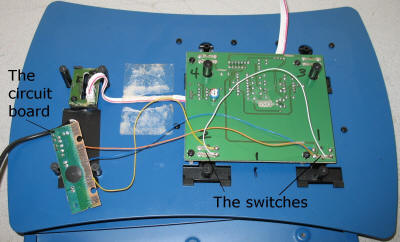

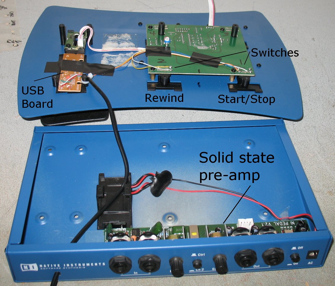

Here's the inside of the foot switch unit I am going to use. Another shot with everything tapped down and the wire secured
On the left above you can see that I have soldered tiny wires to the #7, #14 and #20 copper traces
The lower end of the circuit board is trace #1 and the upper end is trace #26
The blue and orange wires will trigger a [ character when I step on a switch and connect those two wires
The yellow and orange wires will trigger a ] character when I step on a switch and connect those two wires
Both of those characters will set off a macro consisting of multiple keyboard commands
Click on images to see a larger image

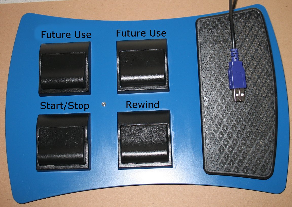

The controller I am using here is the Rig Kontrol from Guitar Rig #1
It's not usable in later version of Guitar rig and so it's now my experiment
There's a solid state pre-amp inside that still works if I ever needed that.
Here's the controller all assembled with the two switches I am using
I have two more switches for future use.
