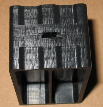

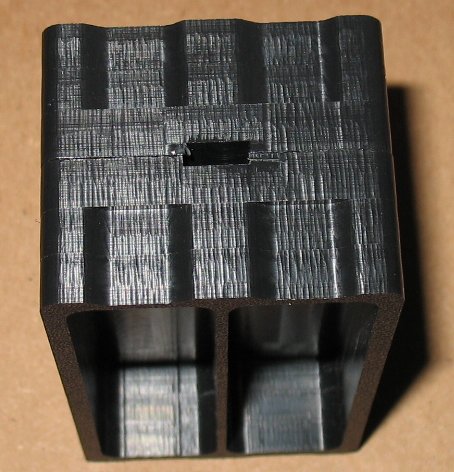

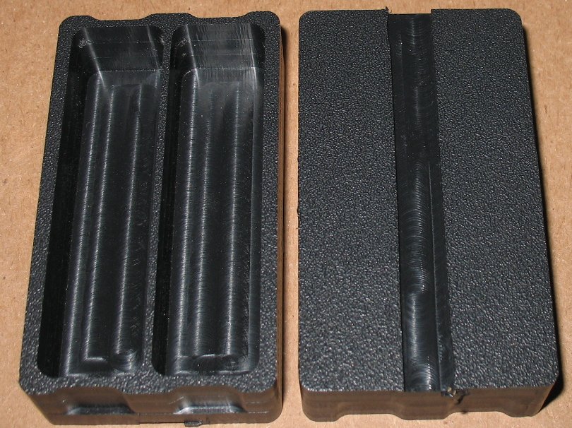

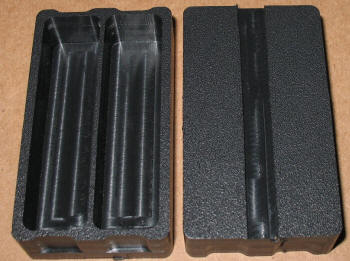

Here's a shot of both half's of the 4 x 18650 Battery Holder.
The groove running down the back side is the wire channel.
Start by tapping both half's together with vinyl electrical tape
Here you can see the groove for the power wire

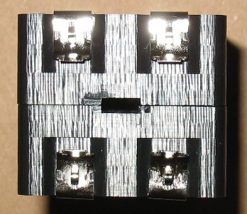

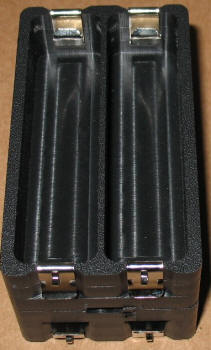

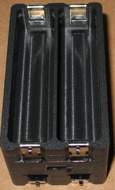

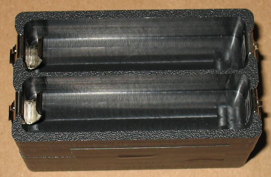

Press the battery terminals onto the battery holder ends.
This battery holder is a 3.6 volt parallel battery holder.

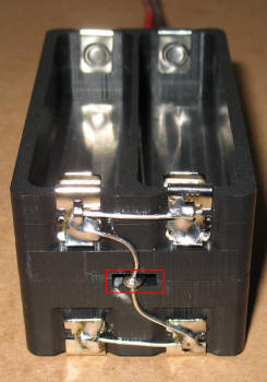

All four + terminals are on one end
All four - terminals are on the other end

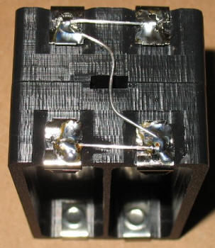

Here's a end shot with the battery terminals pressed into place Here's a side shot with the battery terminals pressed into place

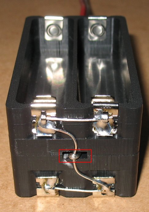

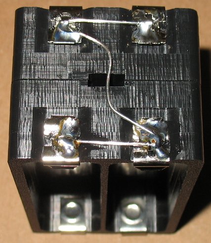

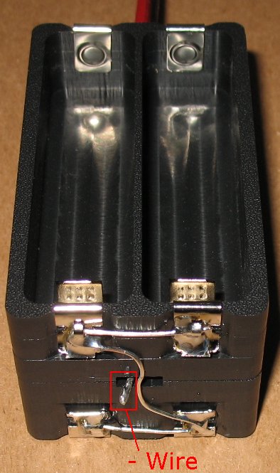

Wind some wire through the terminals to connect them all together
Solder the wire to the terminals.
Warning: Solder very quickly and get the soldering iron away from the terminals.
You will melt the HDPE plastic if you take too long to solder the joint.
I use a 40 watt soldering iron for this because it can solder very quickly

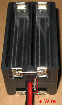

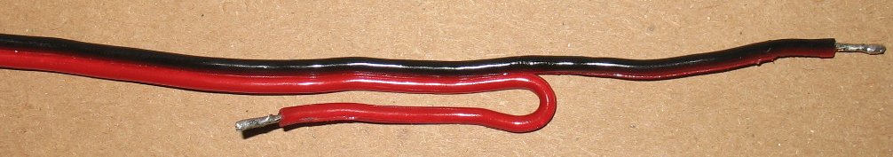

Here I have split my wire so the red positive wire doubles back onto itself.
You can slide on some heat shrink tubing now if you want to use it.
I am using the Red/Black zip cord shown above for my power wire.
You can use what ever type connector you like to use.
Just make sure you wire the + and - wires correctly

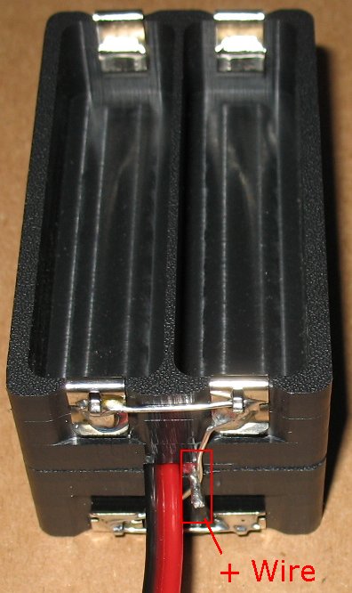

Shove your power wire into the wire hole.
The tip of the + wire can be seen sticking out of the wire hole.

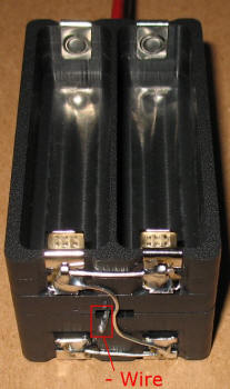

The tip of the - wire also sticks out the hole on the other end
See the picture on how I split wire

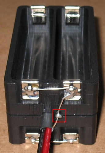

The tip of the - wire can be seen sticking out of the wire hole
The tip of the + wire also sticks out of the wire hole on the other end.

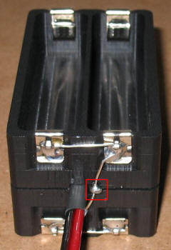

Make a hook shape on the + and - wires and solder them to battery terminal wires.
Pushing and pulling the main wire will help you position the + and - wires

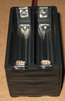

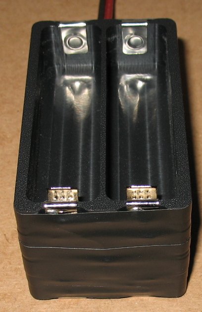

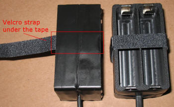

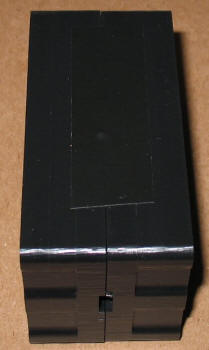

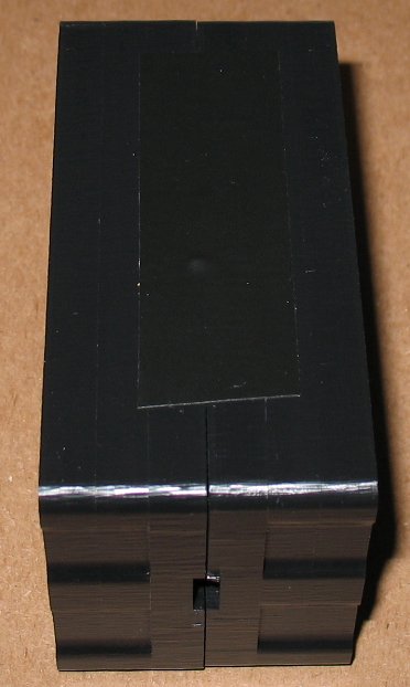

Wrap vinyl electrical tape around the battery body to cover up the bare wires
This also holds the battery holder half's together as one.
See the Velcro strap tip below

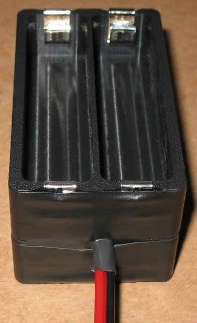

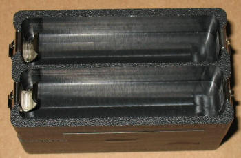

Here's a shot showing what the battery holder looks like with 4 x 18650 batteries inside Here's a nifty little trick I just figured out the other day.
Take a Velcro strap and tape it down as you are wrapping the battery holder body with tape.
I picked up a roll of these 15" long Velcro straps at Lowes.
They come in handy for lots of things
