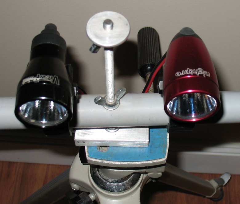

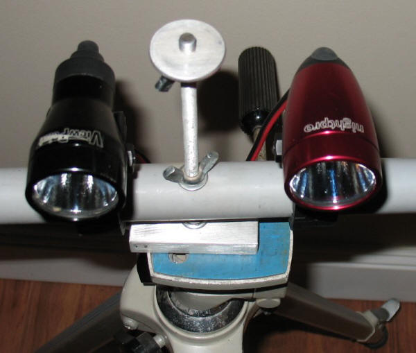

I did a side by side comparison between the Marwi P7 lights and a Marwi Bullet housing XML led light.
The Marwi Bell housing P7 LED light is on the left
The Marwi Bullet housing XML LED is on the right

Note that both lights use the same exact reflector and shared the same battery.

The P7 LED has a dome that pushes farther into the reflector than the XML LED
