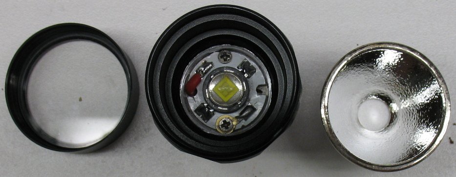

SSC P7 900-Lumen 2-Mode LED Flashlight (18650) - Deal Extreme link
The stock Model 18650 flashlight from Deal Extreme. Battery not included.
Hi and low beam switch and the quality of the product is top notch.
$38 for all of this and free shipping from Hong Kong, it's a great deal. I bought two of them.

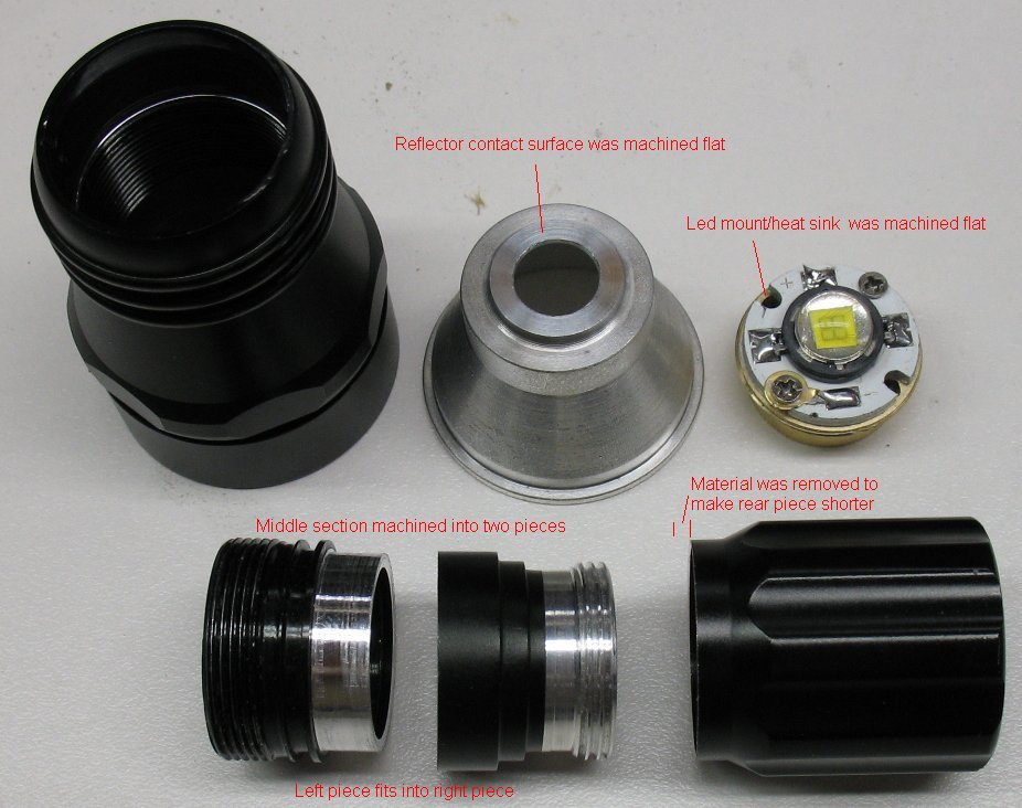

I took the middle knurled section of the flashlight and turned it down on my lathe.
The middle section is epoxied into the flashlight head, but if you use some heat, the epoxy will loosen and you can unscrew the middle section from the head.

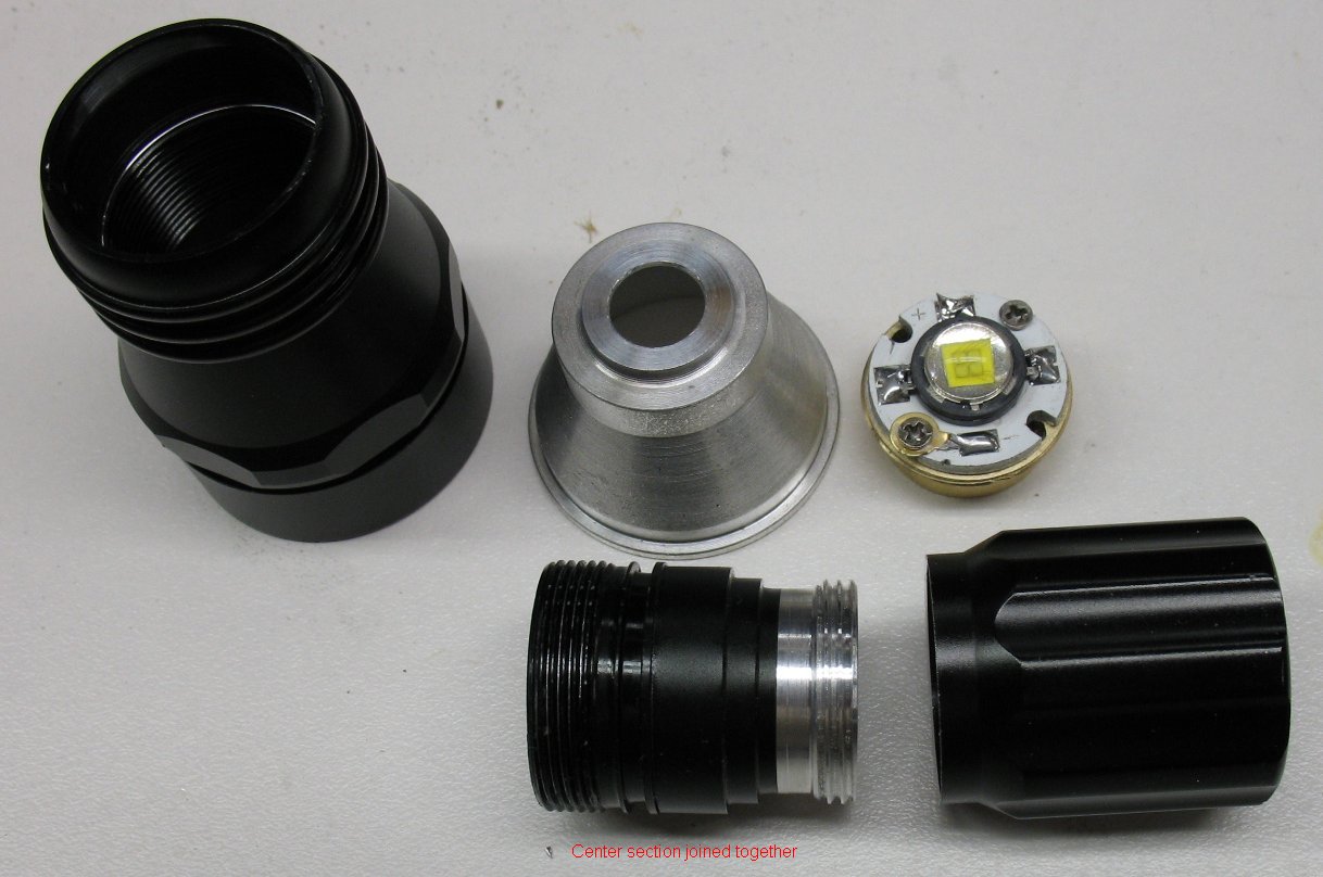

The turned down left piece fits inside the turned down right piece and then they were glued together.

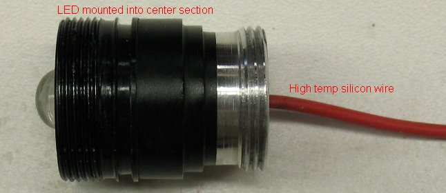

LED center section and top view.
On the left you can see the new middle section with the P7 LED mounted inside.

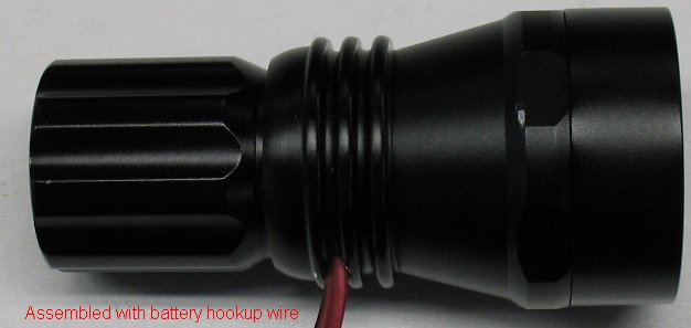

On the right is the middle section screwed into the head.

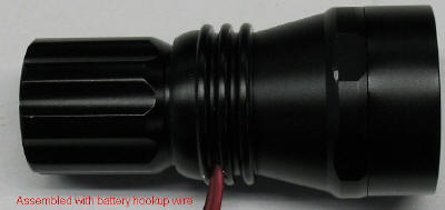

Assembled LED bike light which is now 3 inches long - The heat sink/mount comes next
