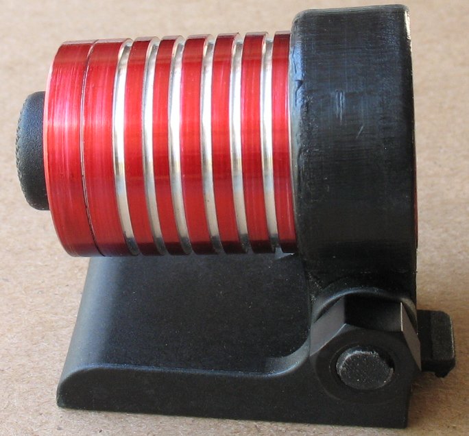

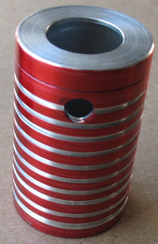

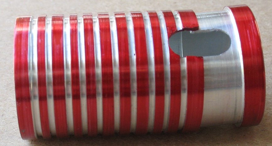

Another idea I had for the body. The only difference in this design is that instead of removing a bunch of aluminum from the outer shell, I made small fins by cutting grooves. into the shell as deep as I could without making the grooves too deep. I'll have to measure the running temp of this shell compared to the smooth shells I made and see if it runs cooler. The red color is not anodizing, it is just a red sharpie pen. I wanted to see how a colored shell would look.
Test shell with grooves The back cap cover pulls off

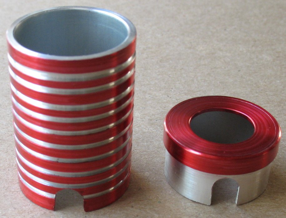

The slots let the wires exit the shell so you can take the light apart easily. -

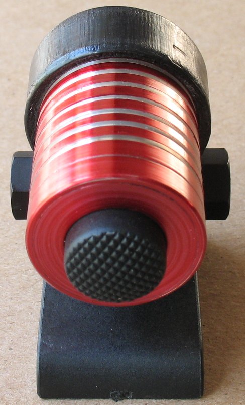

Here is the shell mounted into my new black plastic mounts
