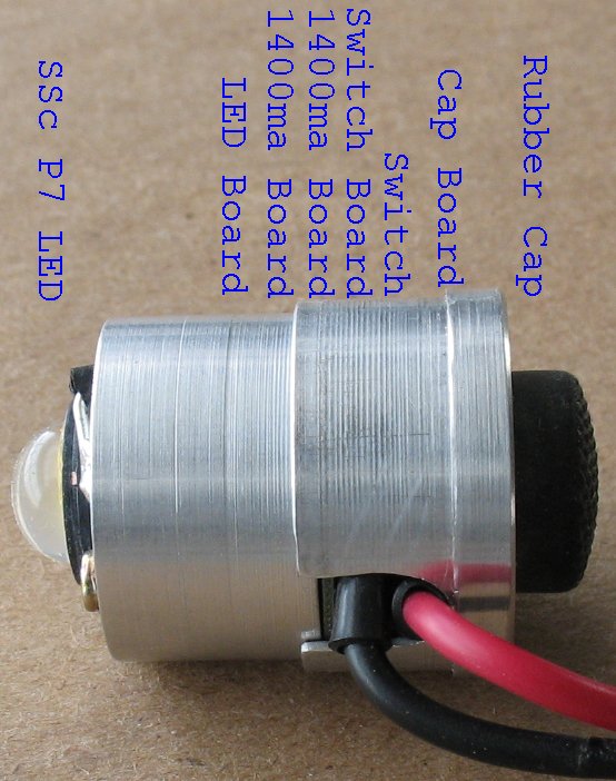

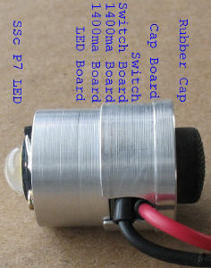

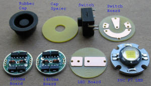

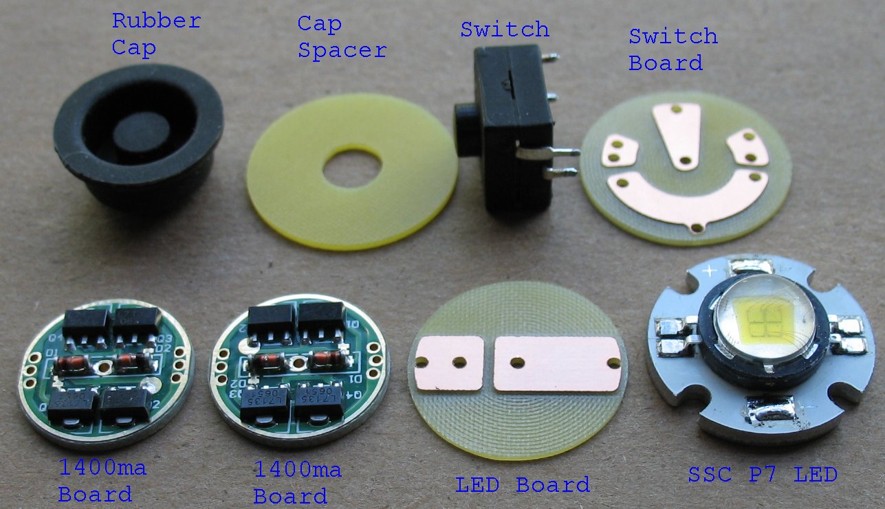

These are all the items inside my SSC P7 electronics stack This is what the whole assembly looks like when it is inside the aluminum case

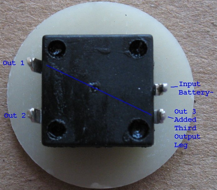

The switch has been modified to be Off - On2 - On 1 and On3
See my main Bike lights page for info on this mod

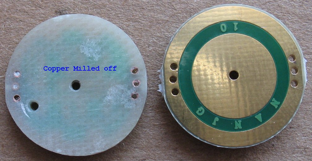

I hand milled the 1400ma boards with a Dremel to remove the copper so that I could stack them against other components without shorting out. I am making a jig so that my CNC can mill them better.
image -

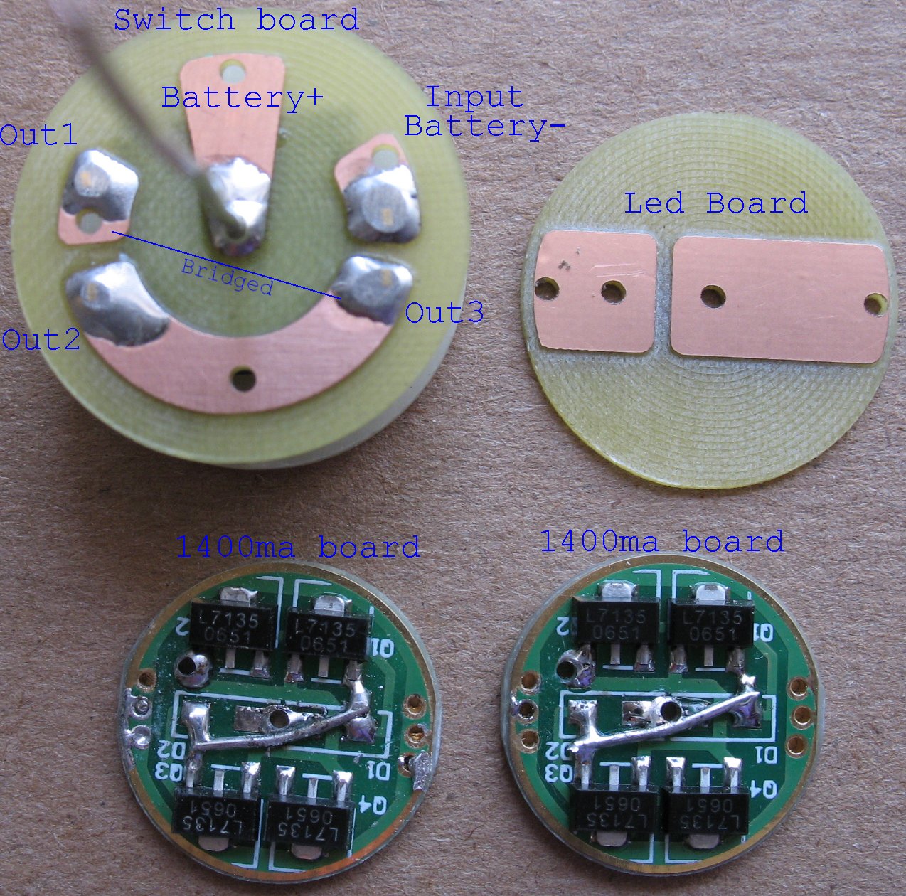

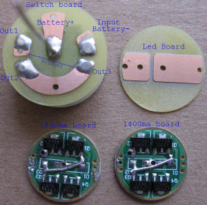

Here's a shot of a the cap spacer board, the switch and switch board all joined together
The center wire is what all the board stack up on and is also the Battery+ connection
Out1 and Out2 get wires soldered that lead to the negatives of each 1400ma board
