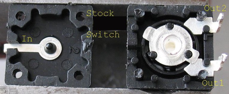

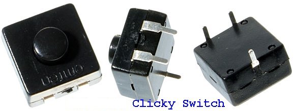

Here's a shot of a stock clicky switch.
The stock switches have 3 positions = Off - On2 - On1

Here's shot of a stock switch. You can see Out1 and Out2 terminals.
You can gently pry these switches apart and put them back together.
I like to add a very small drop of super glue on each corner post after I put them back together
Note on the switch above, I had already glued it together and so I had to drill out the four post to get it apart for this photo.

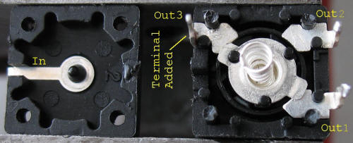

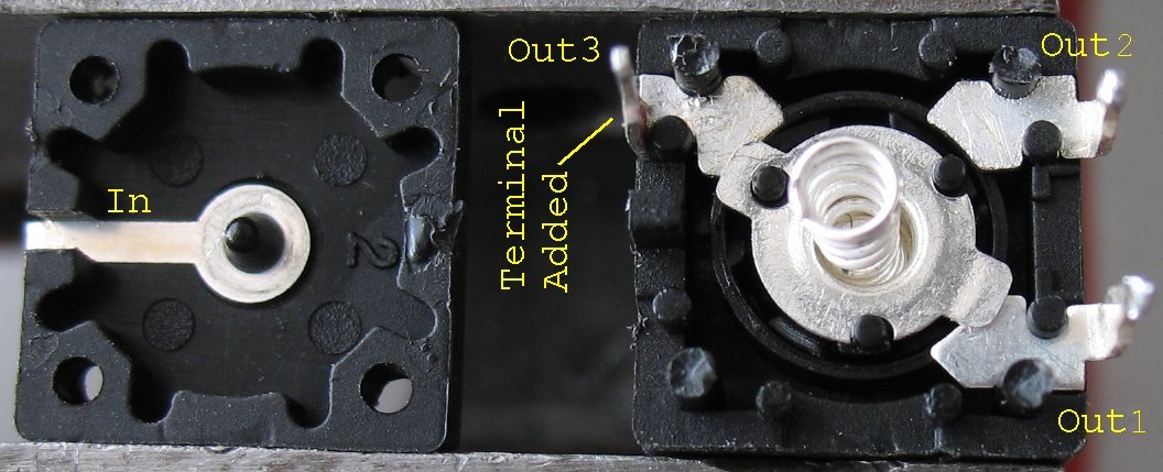

Here's a shot with a new Out3 terminal added.
The switch case already has spots for 4 terminals so it was a breeze to pop in another one.
If you look closely, you can see that out1 and out2 terminals are not the same.
The curved part that contacts the center terminal is curved a different direction.
To add an out3 terminal, take an out1 terminal from another switch
See how the center terminal has two arms on it. This lets it contact two terminals at the same time.
In the photo above Out1 and Out3 are on at the same time.
Note that this switch actually has 6 click positions. The center terminal repeats itself twice for every revolution like this
Off - On2 - On 1 and On 3 then Off - On2 - On 1 and On 3
