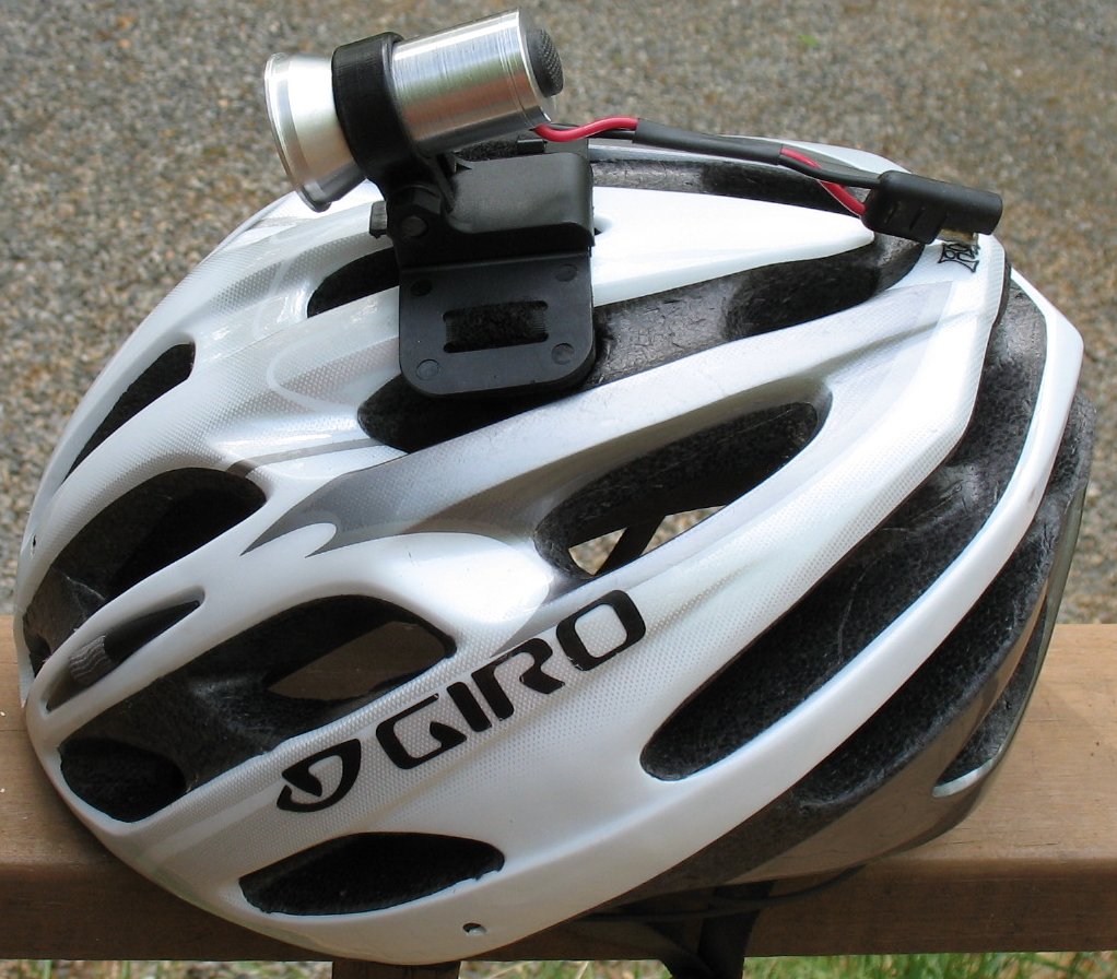

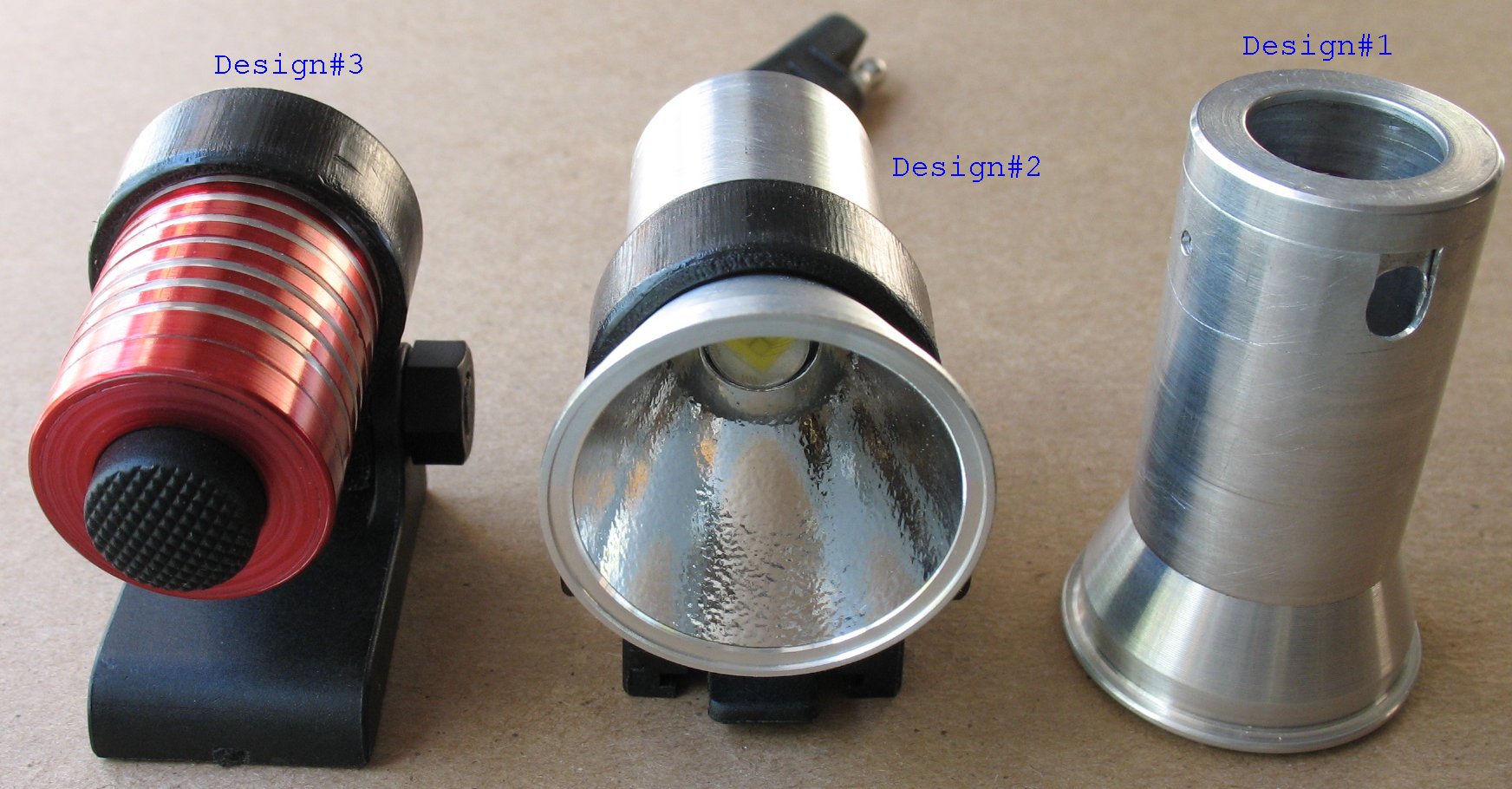

Assorted SSC P7 LED designs HDPE light mount bracket that couples up to the Marwi mounts.
Just a few shots of homebrew lights I have made.

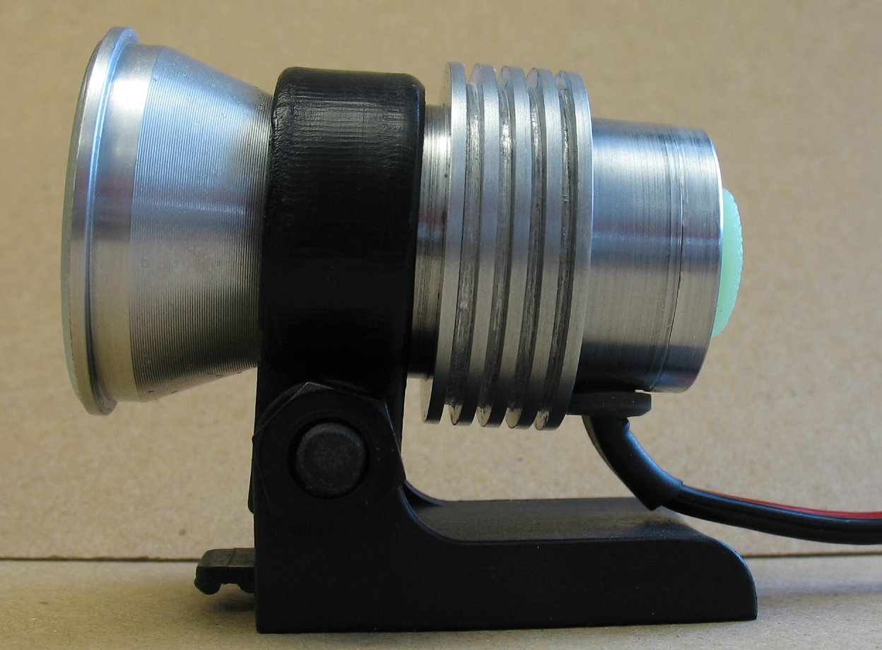

Outer shell with heat sink that sits right over the SSC P7 for increased heat dissipation. I believe the heat sink design will be better. It may be an add on item.
In the image above, I cut the heat sink out on my CNC machine and it is glued onto the shell with high temp adhesive.

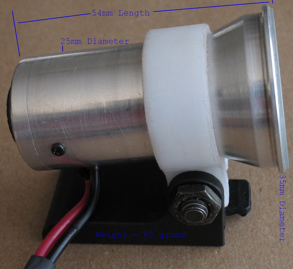

Smooth shell, no heat sink.
