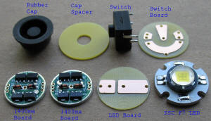

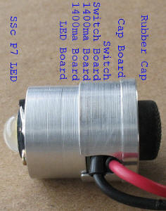

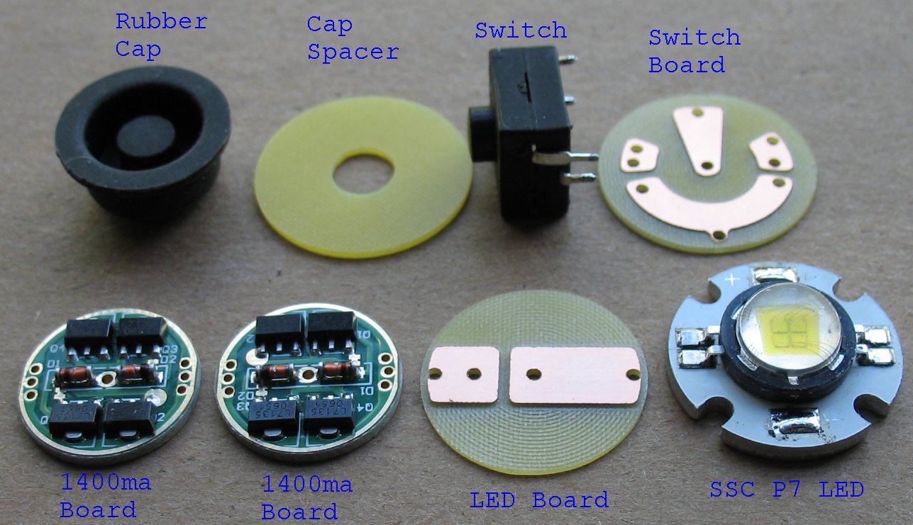

These are all the items inside my SSC P7 electronics stack.
This process is still in the development stage.
I keep finding cooler ways to create a 1400ma/2800ma current limiter for the SSC P7 LED

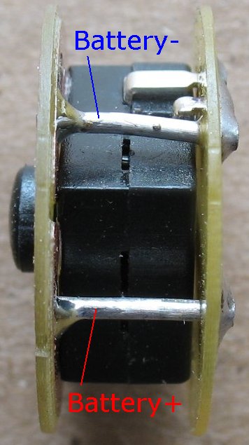

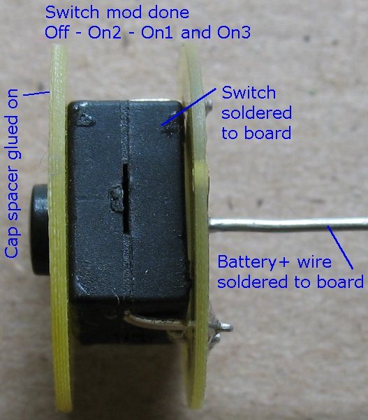

Update: The cap spacer shown above has now been replaced by the spacer below that has solder points for the Battery+ and Battery-.
I did that because it was too difficult to unsolder the battery hookup wires once the whole stack was soldered together.

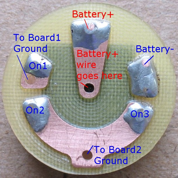

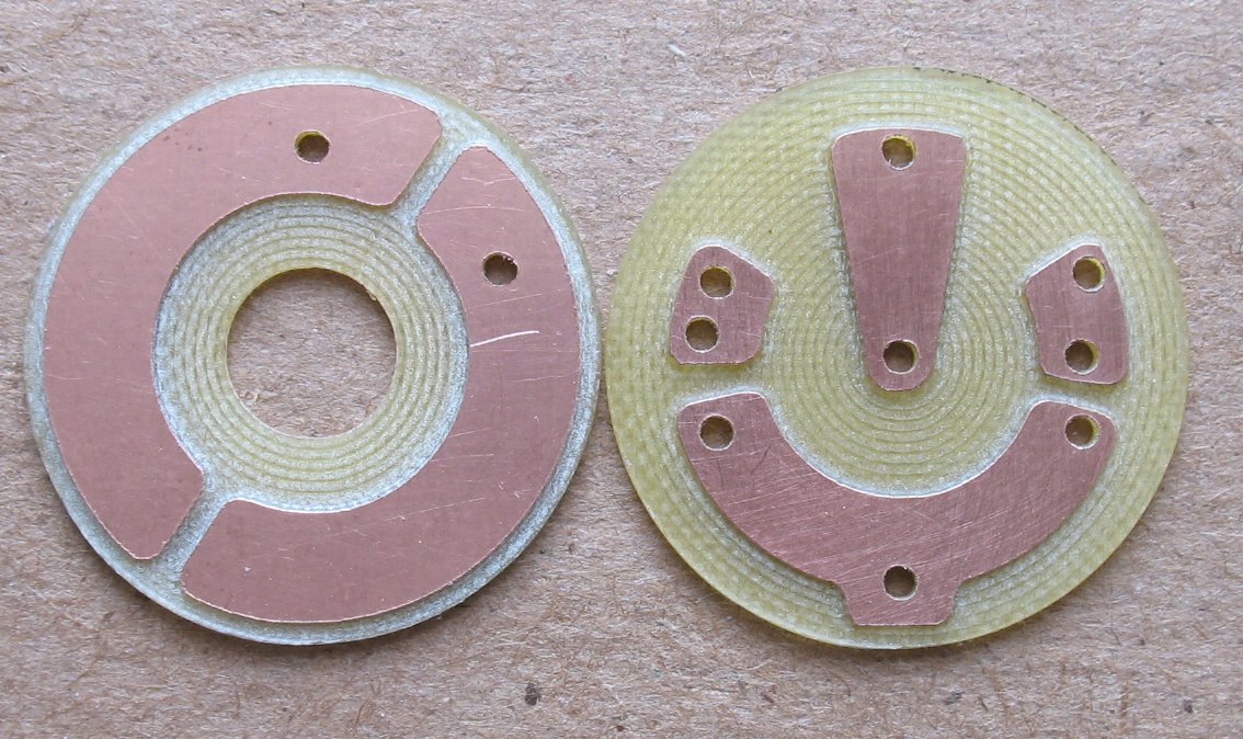

Here's an updated photo of the two boards that go on either side of the switch I made it so you can jumper two large buss wires from one board to the other.
This gives you a nice solid place to solder the battery + and -

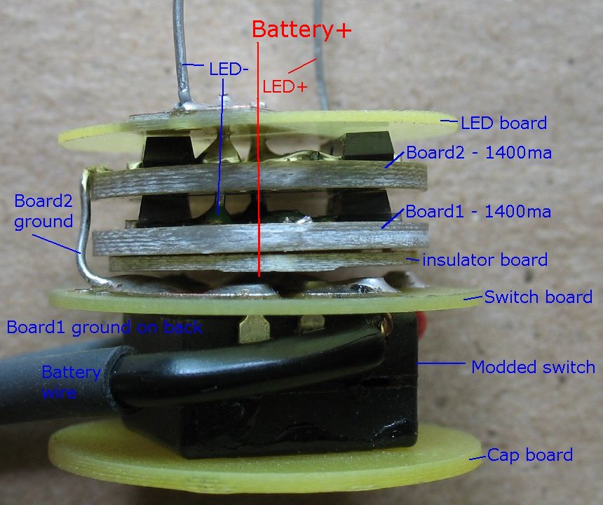

The switch board
on2 connects the battery- to board two and gives you 1400ma current limiting
on1 connects the battery- to board one and gives you 2800ma current limiting
on3 passes the battery- to on1, and so both boards are now on at the same time

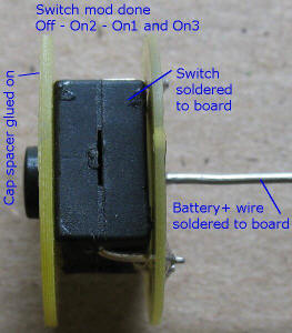

Cap spacer - switch - switch board
The center battery+ wire has been added to the switch board
image image-

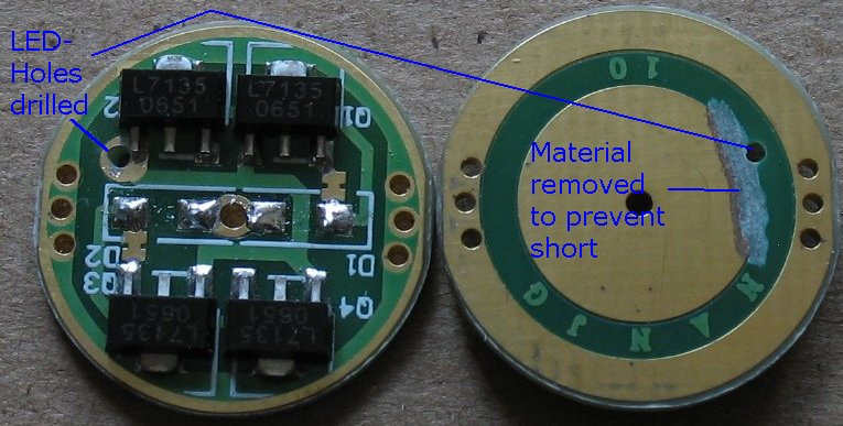

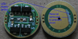

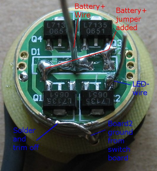

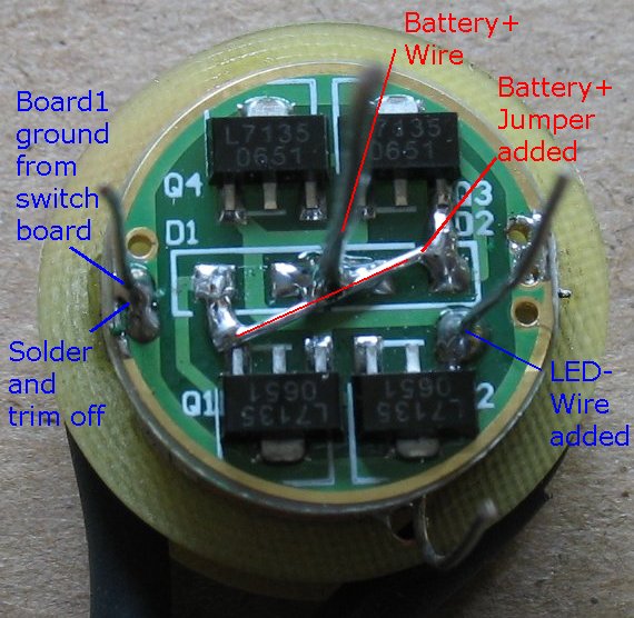

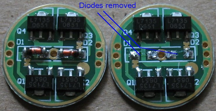

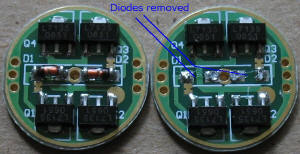

1400ma current limiter boards with the diodes removed on the right board
Both boards get the diodes removed
Holes drilled in both boards for the LED- wire to pass through.
The LED- wire gets soldered and passes through boards two and the LED board
One 1400ma board has been added to the stack
The whole stack is centered on the Battery+ wire
A battery+ jumper wire is added to the board
The negative for board one comes from the switch
The LED- wire gets soldered and passes through to board two
The second 1400ma board is added to the stack
The negative for board two comes from the switch
The LED- wire gets soldered and passes through to the LED board

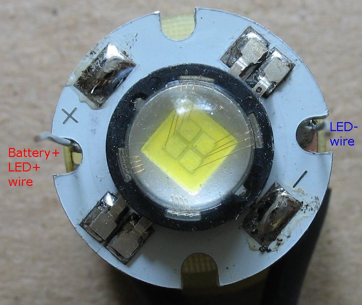

The LED board gets added to the stack

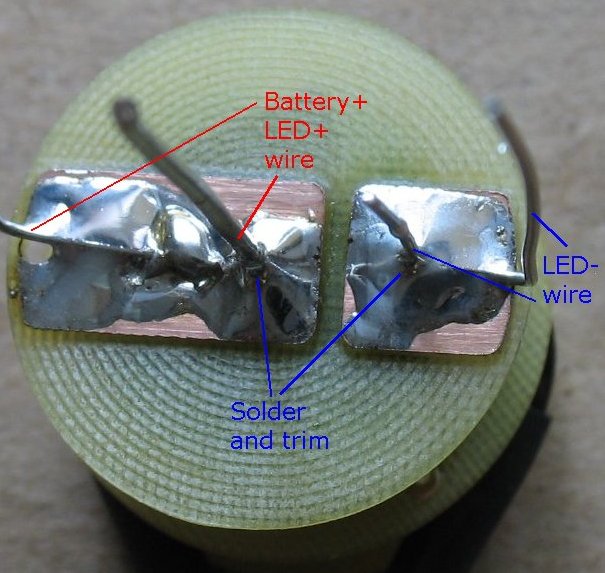

The battery+ wire gets soldered and trimmed off
The LED- wire gets soldered and trimmed off

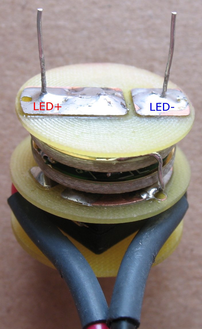

LED+ and LED- wires get added towards the outside of the board
Side view of the stack
image -
LED+ and LED- wires from the board below come up through the + and - holes.
A bit of heat shrink or wire jacket gets put around the + and - to keep them from shorting out.

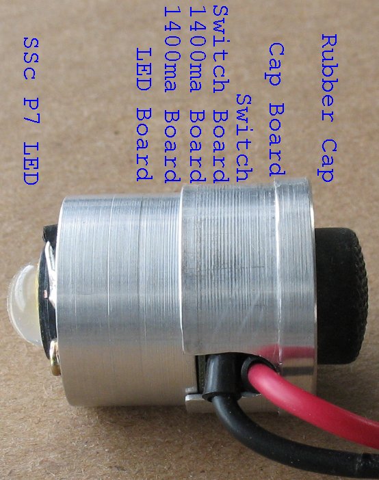

Here's the stack without the LED The whole stack goes inside this assembly.
This assembly fits snug into the main body
