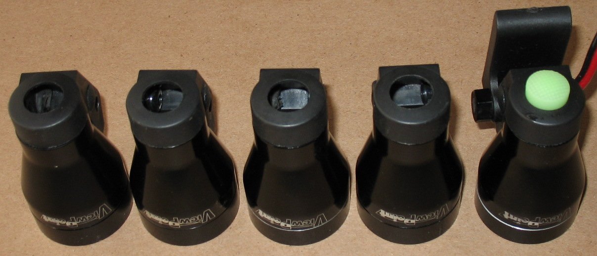

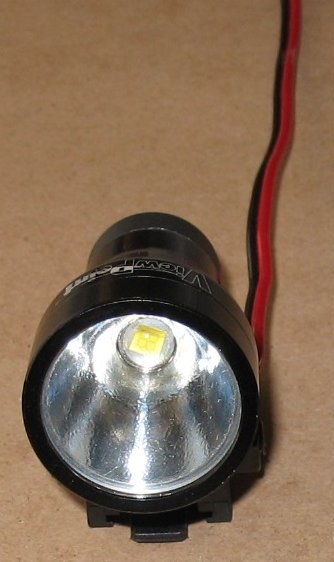

Here's one finished Marwi SSC P7 conversion and four more waiting.

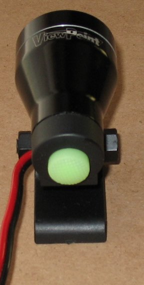

The one with the glow in the dark tail cap is completed.

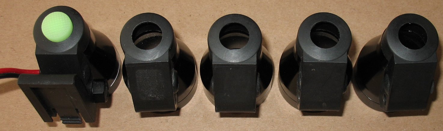

The other four have had the rear housing machined so the tail caps will fit.
These lights originally came with a SPST Judco switch.

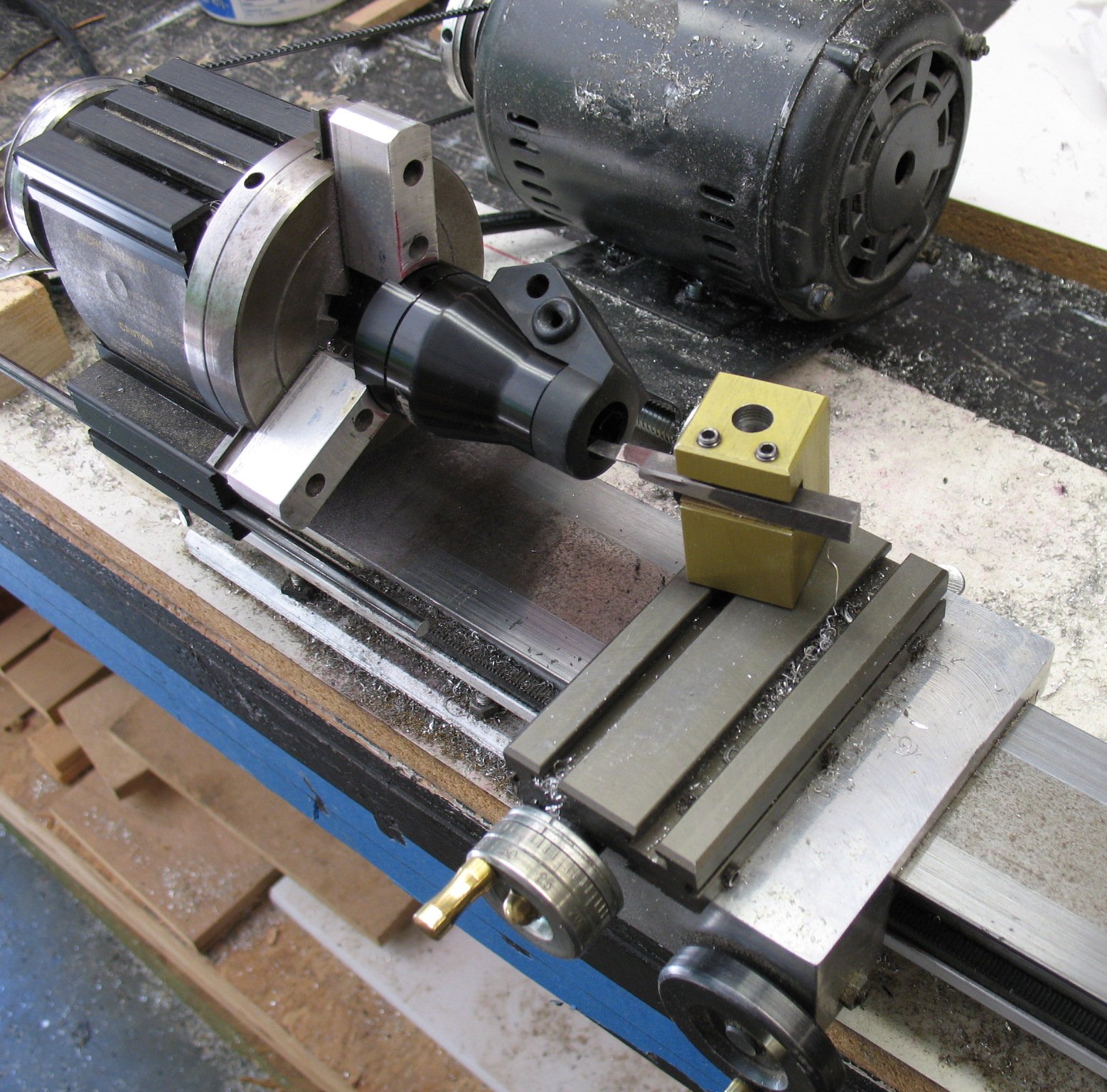

The rear housing hole size needs to be increased to about .54" diameter to accommodate a clicky switch tail cap

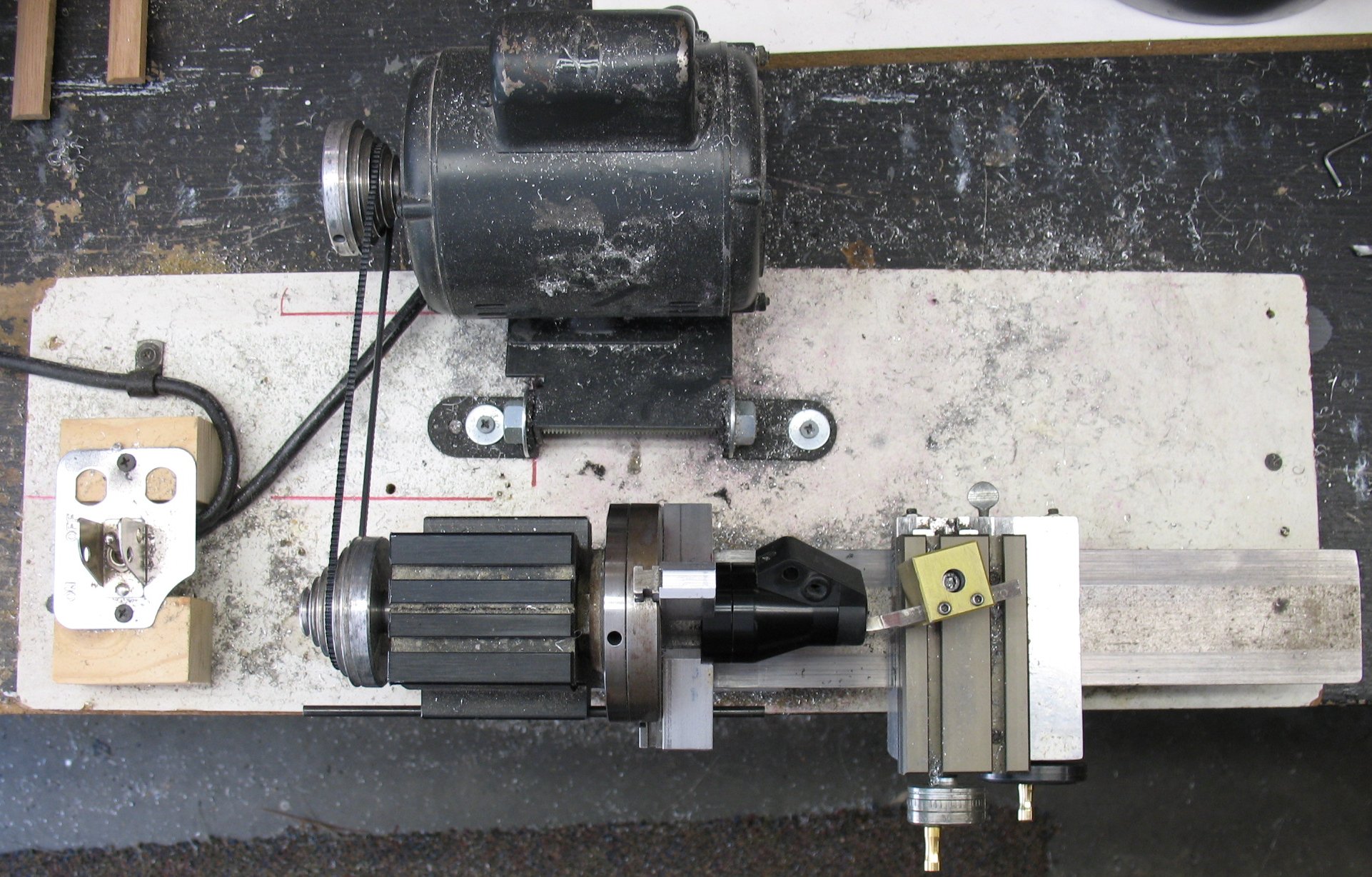

Here's a shot of my Taig lathe boring out the tail cap hole
Here's a windows media movie of the lathe in action.

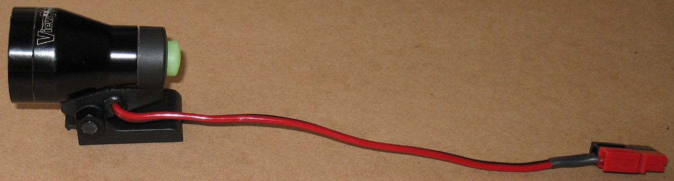

This used to be a 6 volt Halogen light. Now it's a SSC P7 LED
image -
Marwi SSC P7 with a 18 Ga. cord and Anderson PowerPole connector -
