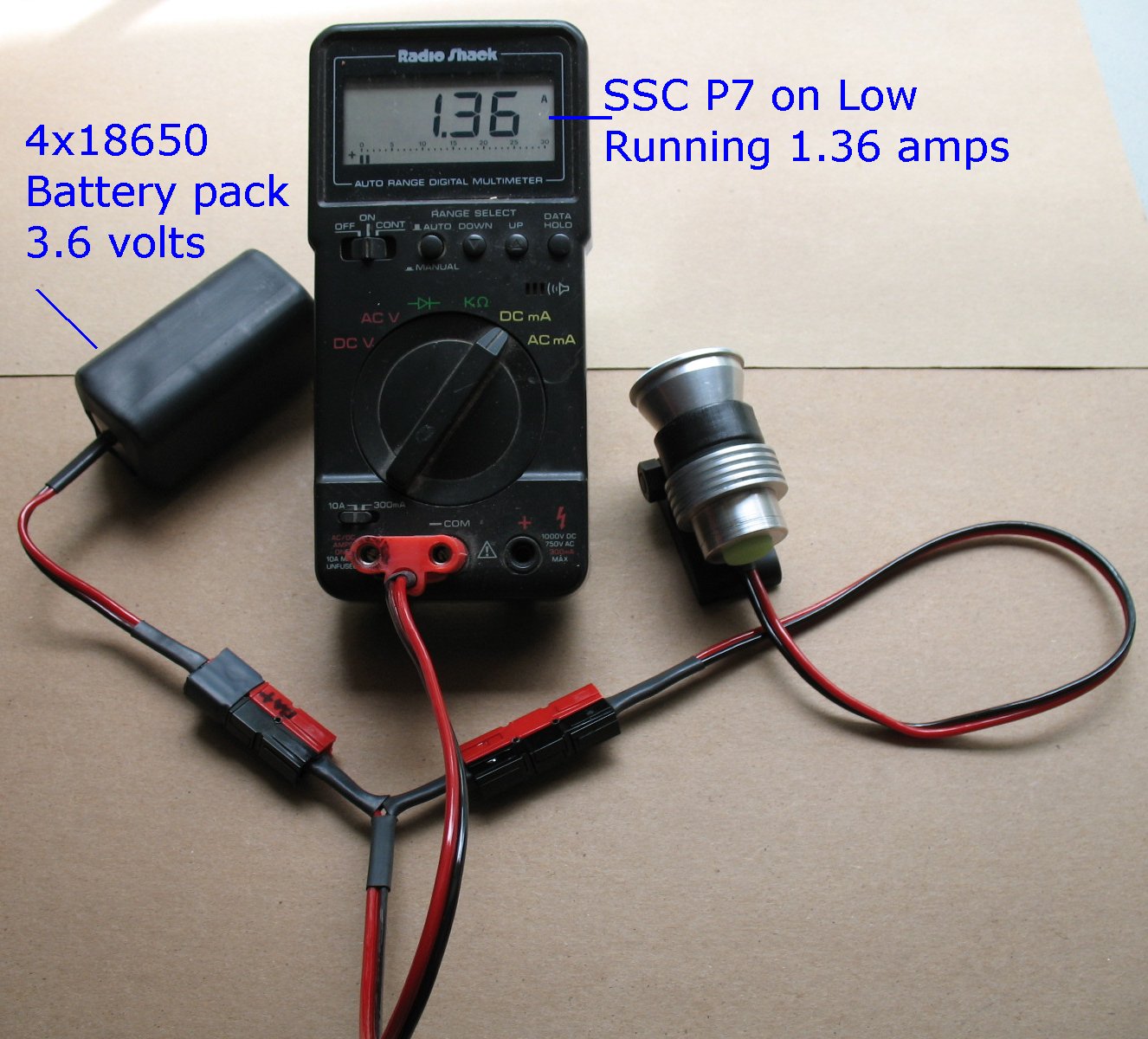

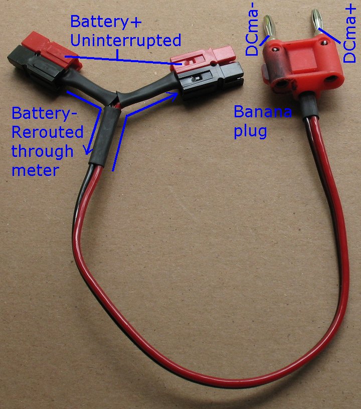

This is a tool I made to make it easier to measure battery current draw on bike lights.
The Red/Black connectors are Anderson PowerPoles.
One plugs into the battery pack, the other one plugs into a light
I have a Banana on the other end that plugs right into my Multimeter.
I set the Multimeter to DC milliamps in a range that can measure at least 3 amps.
Turn on the light and get my current readings

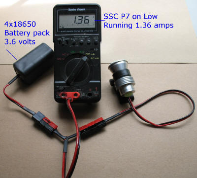

Here I am taking a reading with a SSC P7 LED light set on the low setting.
The meter is reading 1.36 amps current draw

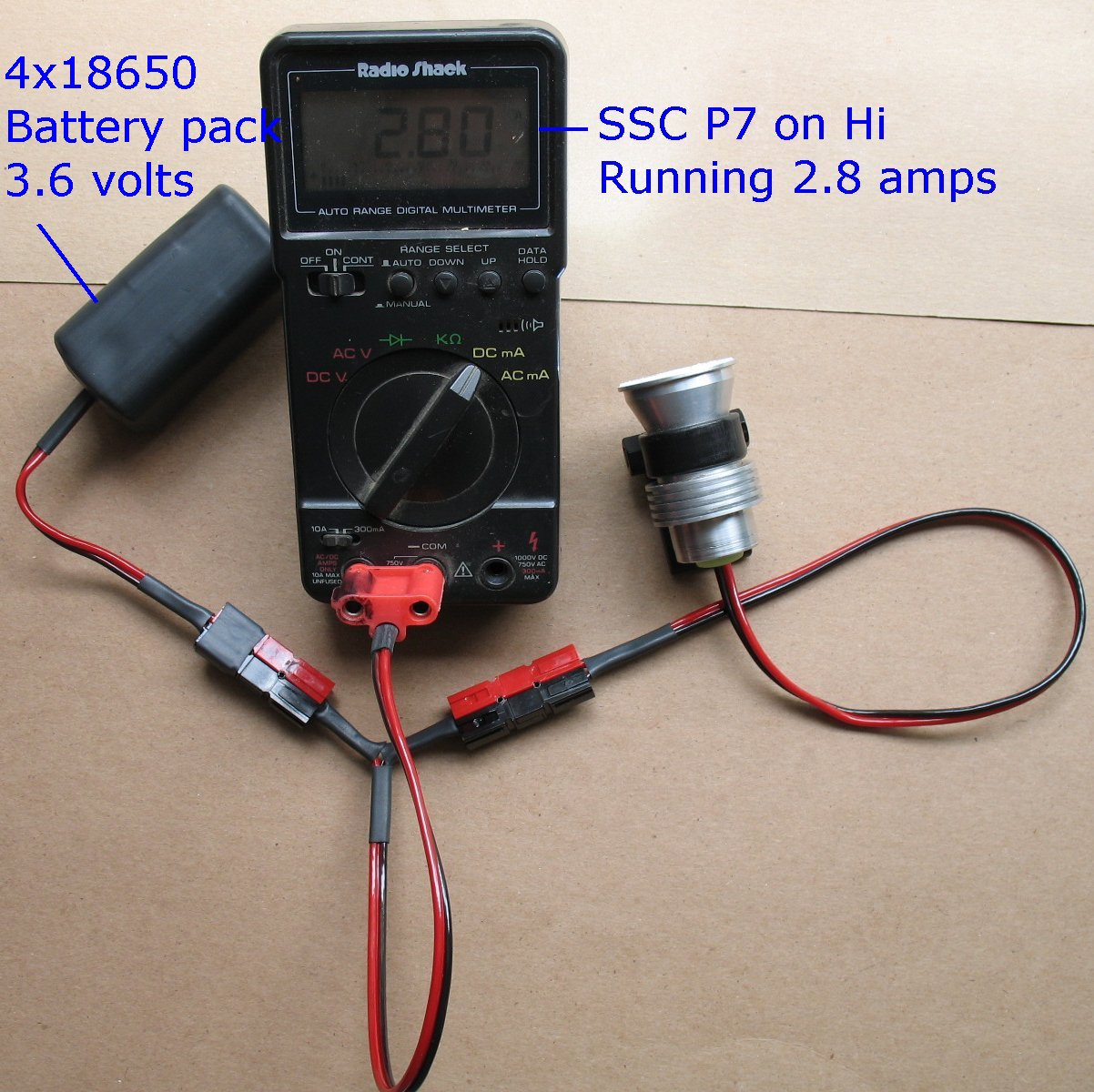

Here I am taking a reading with a SSC P7 LED light set on the High setting.
The meter is reading 2.8 amps current draw
The battery pack above is 4x18650, 3.6volt, 2400mah, lithium Ion batteries all soldered together in parallel to make a total of 9600 mah
