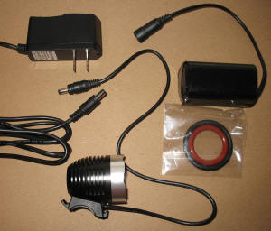

The Magic Shine LED bike light

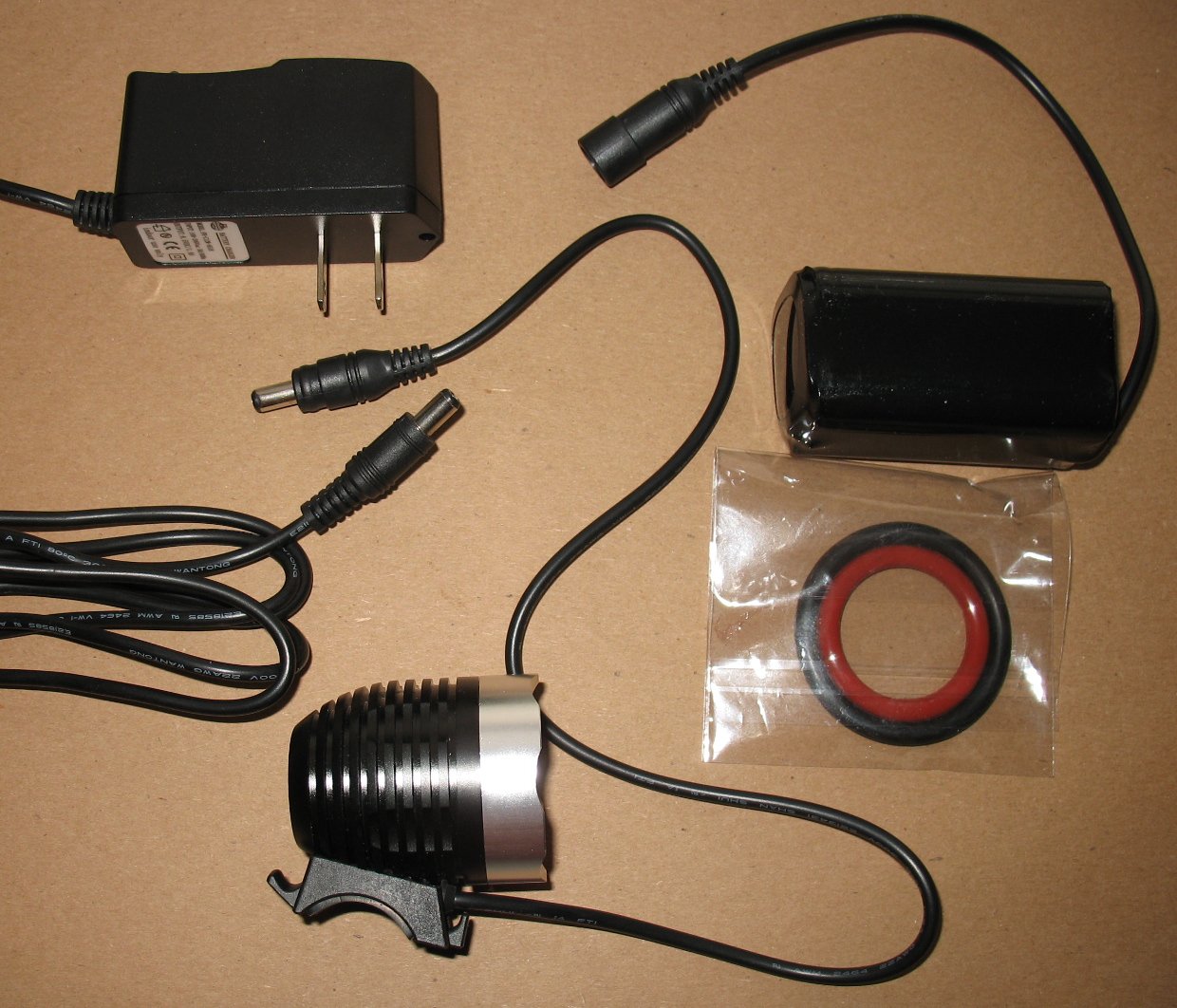

This is the SSC P7 bike light offered by Magic Shine as sold by DX.
It also comes with a little Velcro pouch for the battery pack - not shown in the photo above

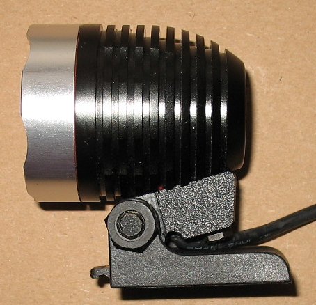

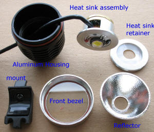

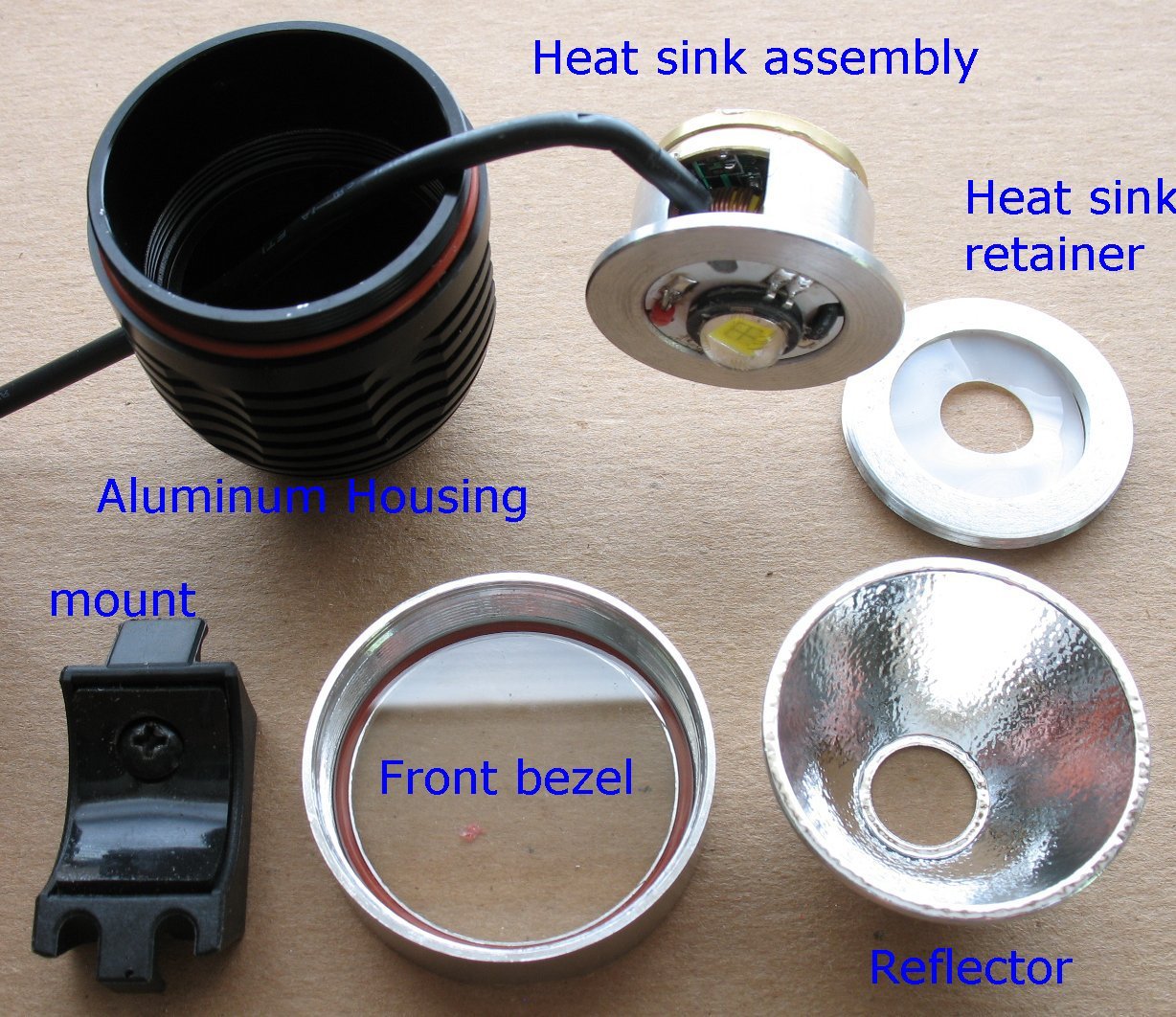

Disassembly:
The mounting foot comes off with one screw.
Unscrew the front bezel and glass

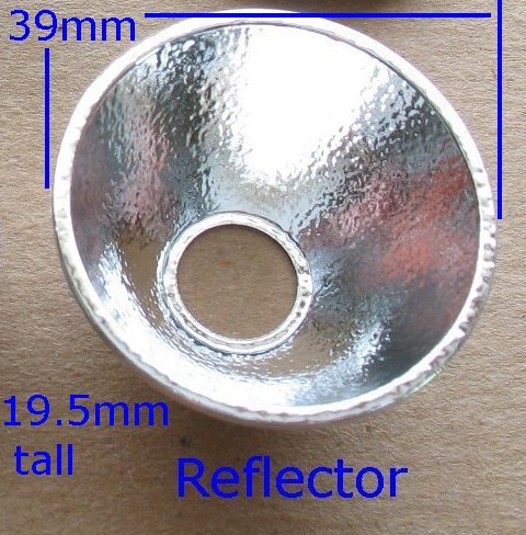

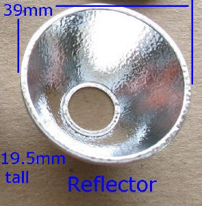

Pull out the reflector
Unscrew the heat sink retainer ring
Pull out the heat sink assembly
Gently pry the brass rear section away from the heat sink. It is a press fit.
Note that there is also a white plastic insulator piece that is shown inside the heat sink retainer above.
Notes: Good thing I took it apart.

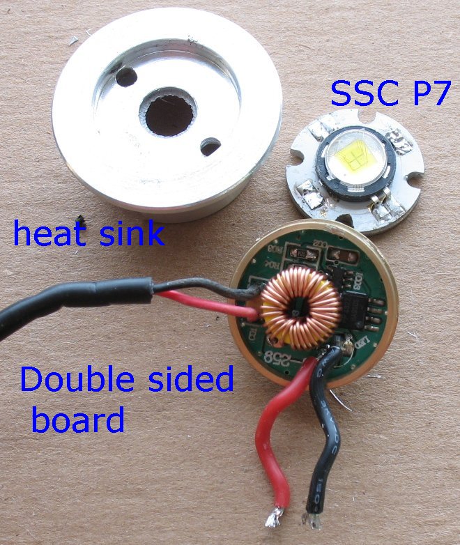

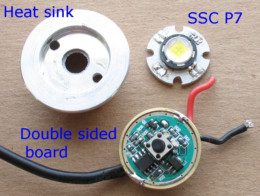

The SSC P7 is not screwed down and there was no heat sink grease under it.
There are aluminum shavings inside the electronics area that are big enough to short out something.
The red wire going to the SSC P7 just fell off the board. It was not soldered properly.

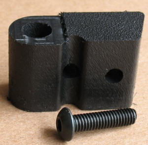

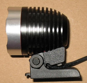

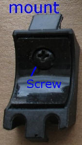

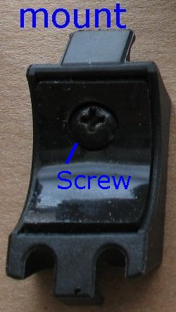

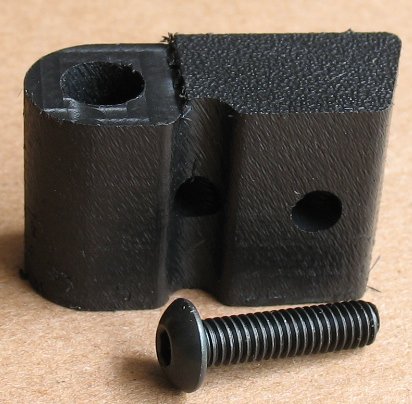

Problem: The screw that holds on the mounting foot is only long enough to enter the body by two threads. Needs a longer screw.

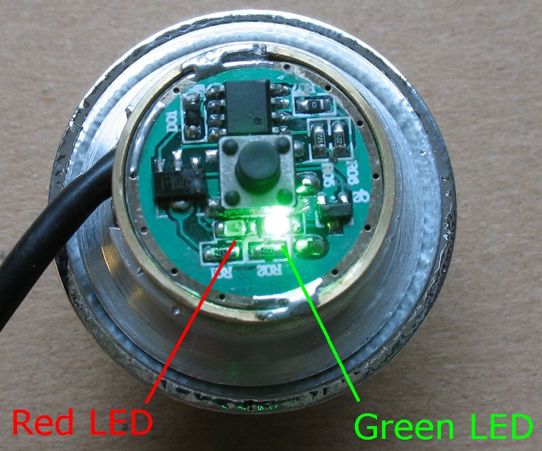

There is a green LED on the circuit board that is always on when the battery is plugged in.
I imagine that the Red LED comes on when the battery voltage drops below a certain point.
I measured 8.5 volts DC on a fully charged battery pack.

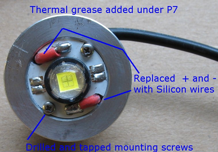

Some of the items I changed.
I drilled and tapped two 1-72 mounting screws.
I added thermal grease under the P7
I replaced the stiff LED + and - wires with super soft silicon wires.

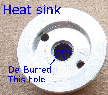

The aluminum heat sink had a huge amount of aluminum pieces hanging off it on the back side.
There were loose thread like pieces inside the area where the circuit board is.
The hole in the center of the heat sink had a thin tin foil section surrounding the hole.
I had to de-burr the hole, removing all that extra aluminum funk.
The screw that holds the mount to the body was too short.
There are only two threads holding the mount to the body.
