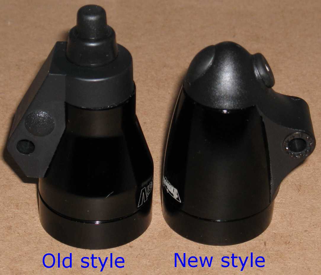

The older style Marwi body |

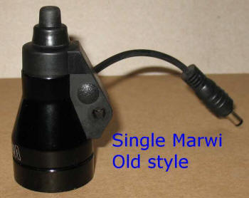

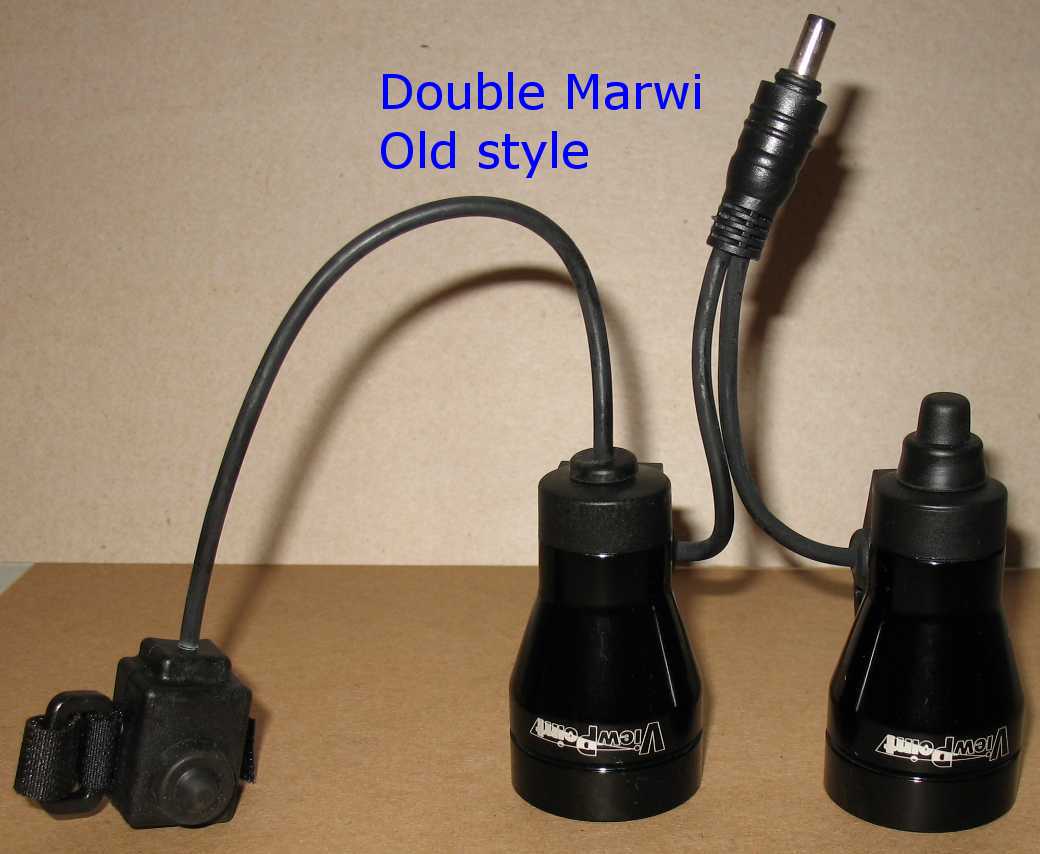

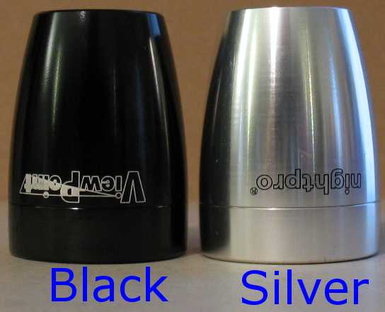

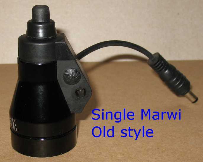

This is the older style bell shaped Marwi Halogen light.
The bodies had more of a bell shape than the newer style Marwi Halogen light bodies
The SPST On/Off switch is located at the back of the plastic housing protected by a rubber switch boot

One MR11 6 volt halogen bulb, a SPST Judco switch, a Trailtech type connector |

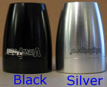

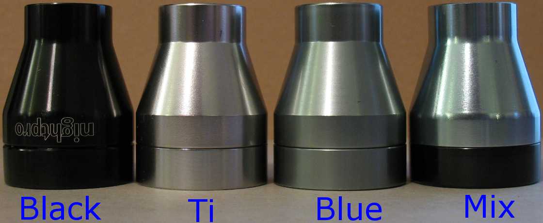

I have seen these light bodies in several colors

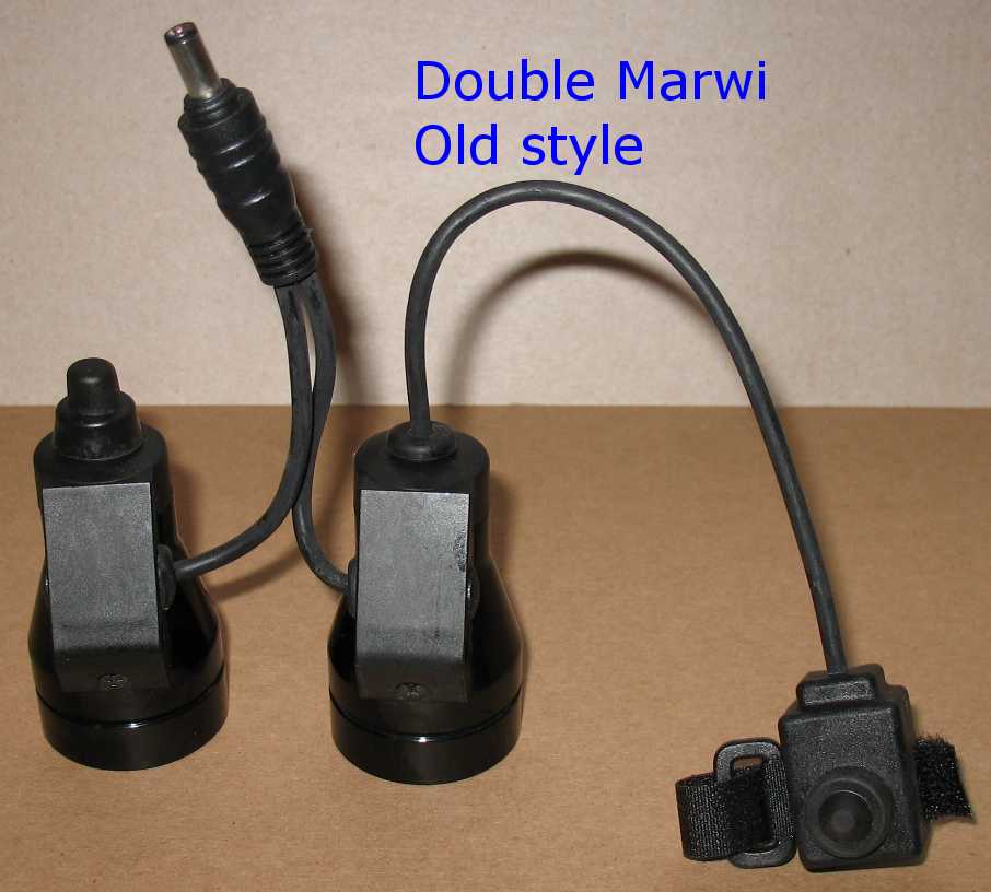

These lights also came as a double set with an external handlebar switch
One light has a rear switch and the other light uses the external switch

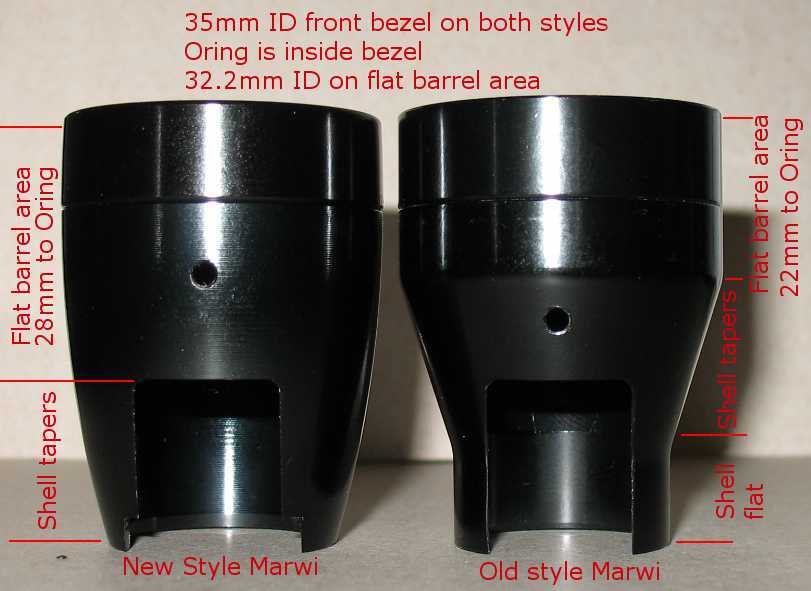

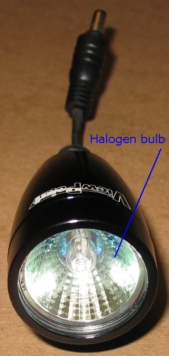

The newer style Marwi body |

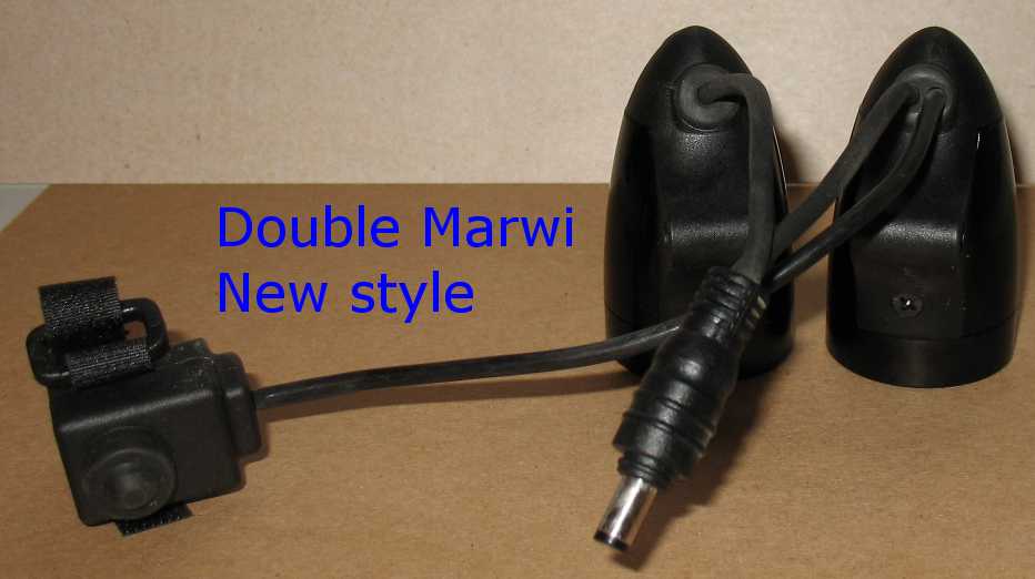

This is the later style bullet shaped Marwi Halogen light.
The bodies had more of a Bullet shape than the earlier Marwi Halogen light bodies

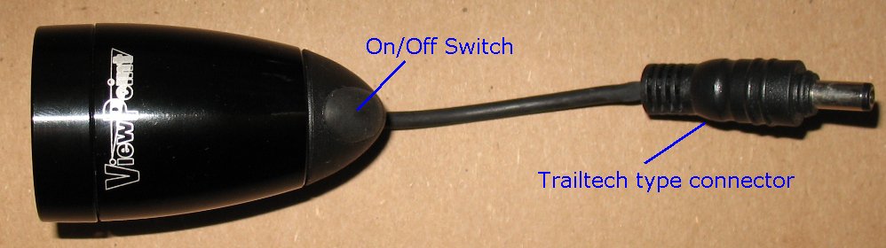

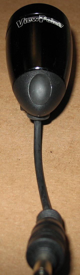

The SPST On/Off switch is located on top of the rear housing under a sealed rubber cap.
Click on the images for a larger image |

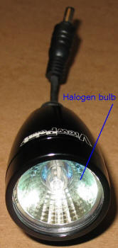

MR11 6 volt halogen bulb |
I have seen these bodies in several colors including red |

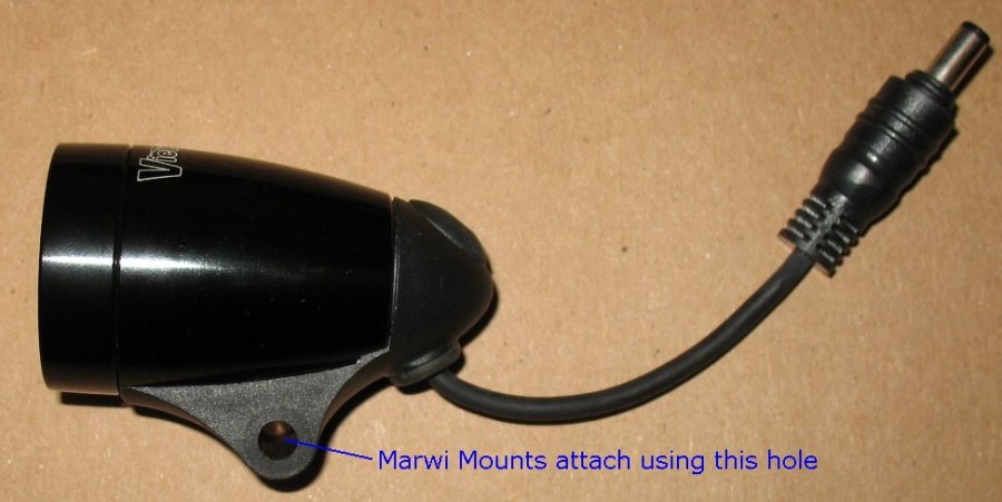

All of the Marwi mounts on my LED catalog store page fit these lights. |
On/Off switch cap and Trailtech type connector |

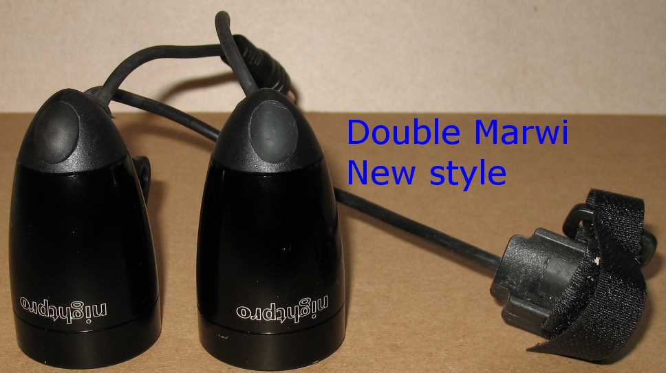

One light has a rubber switch cap and the other light uses the external switch
The light that uses the external switch has a hard plastic cap in place of a rubber switch cap
