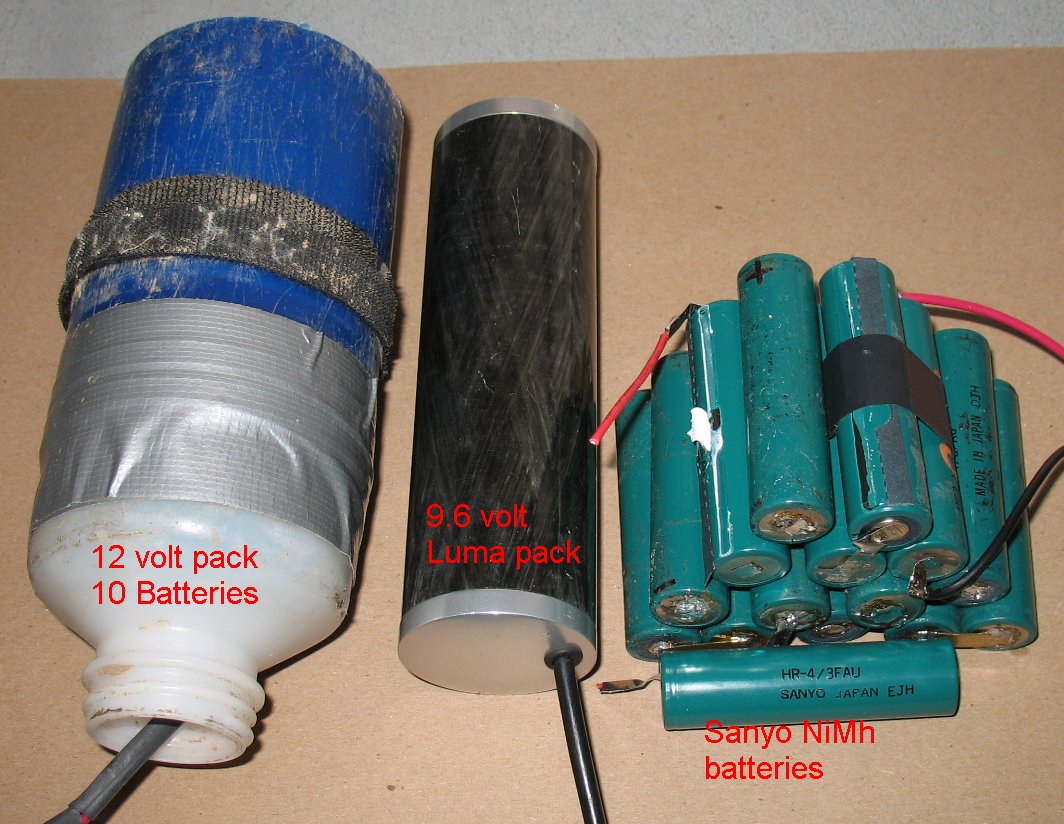

The big homemade pack on the left is the 12volt NiMh battery pack I use for my Marwi handle bar HID.

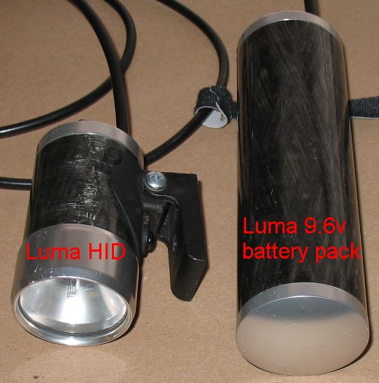

The middle pack is a 9.6v NiMh pack for my Lume HID
The green batteries are Sanyo HR-4/3FAU 4000mah and HR-4/3FAUX 4500 mah NiMh batteries
These batteries are in just about every bike light battery pack I have ever taken apart.

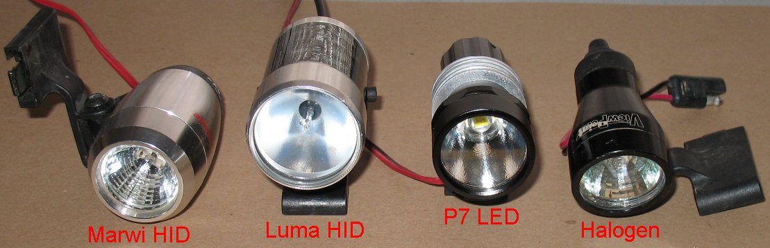

Here's the lights. I threw in a Halogen just for comparison.
See the New P7 design further down the page.
Lume spot beam HID combo Marwi flood beam HID combo

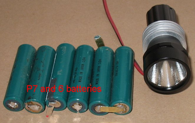

MTE Flashlight P7 LED and 6 batteries.
I included 6 batteries in the photo because I do not know how I am going to drive this light yet.
It takes 3 of the green batteries in series to make 3.6volts at 4500 mah.
If you take two of those packs and put them in parallel, you will have 3.6 volts at 9000 mah.

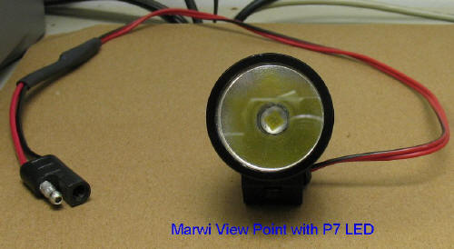

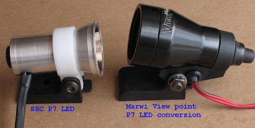

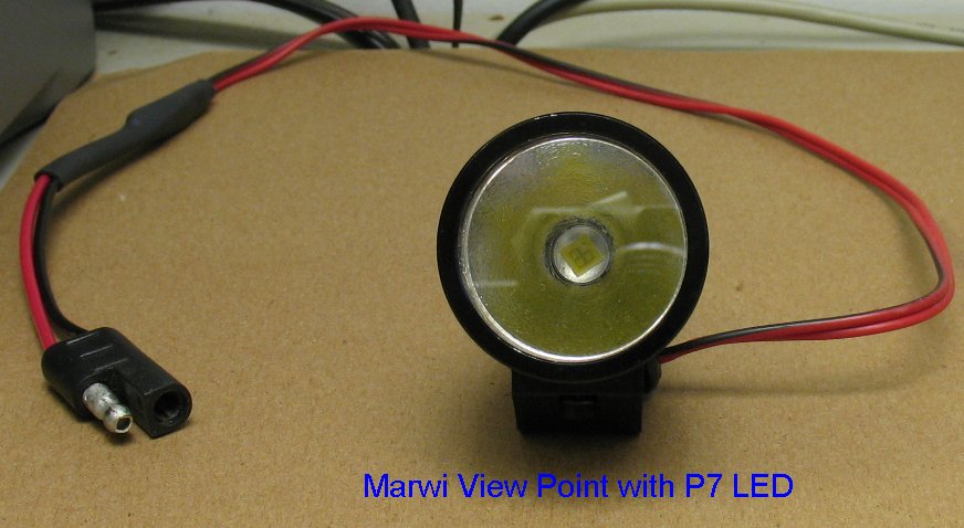

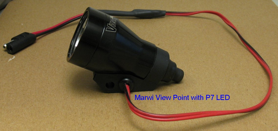

Marwi View point Halogen converted to us P7 LED. Note that the mounting base was on the light when I weighed it.

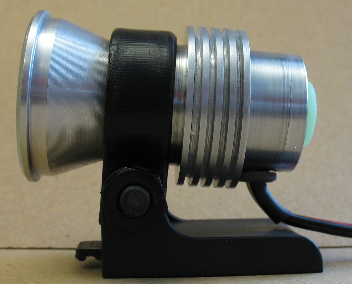

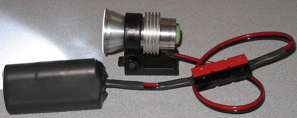

One of my Homebrew P7's P7 LED and  3 x 18650 Li-On Battery pack

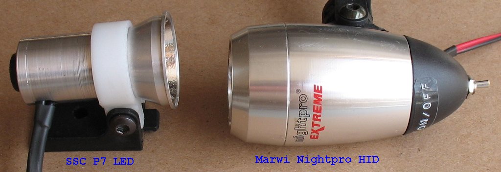

Size and weight comparisons
Left: P7 LED - Right: Marwi View point conversion LED Left: P7 LED - Right: MTE flashlight conversion LED

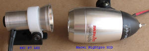

Left: P7 LED - Right: Marwi Nightpro extreme HID Left: P7 LED - Right: Lume Strada HID
My Triple SSC P7 light - 241 grams
The weights of all the above items
Lights including cords Grams Ounces
Latest P7 LED design 65 g 2.2 oz
Old View point Halogen light 74 g 2.6 oz
Marwi P7 conversion LED 86g 3.02oz
MTE Flashlight P7 conversion LED 131 g 4.6 oz
Marwi HID light 176 g 6.2 oz
Lume HID light 209 g 7.4 oz
Battery packs Grams Ounces
3 x 18650 Lithium Ion battery pack 157 g 5.4 oz
5 of the Sanyo Hr-4/3FAU batteries 300 g 10.5 oz
Lume 9.6 volt pack 544 g 20 oz
Homemade 12 volt pack with 10 batteries 747 g 27 oz

Marwi P7 conversion with 6 Sanyo batteries 487 g 18 oz
