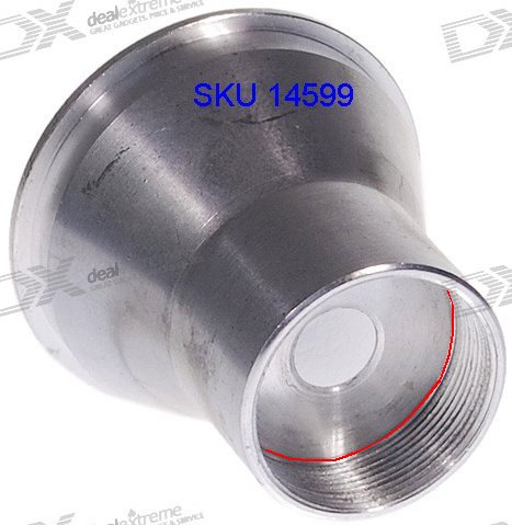

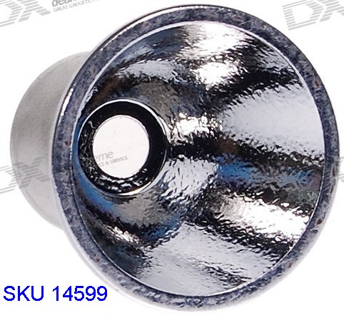

35mm diameter Aluminum reflector.
This reflector fits the Marwi View point bike lights
Reflector link
Note that this reflector has a threaded area on the back. (red line)
The reflectors that I used for my experiments do not have this.
I will probably trim this off with my lathe for my experiments.

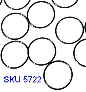

27mm O-ring for the front threads of main light body
O-Ring link

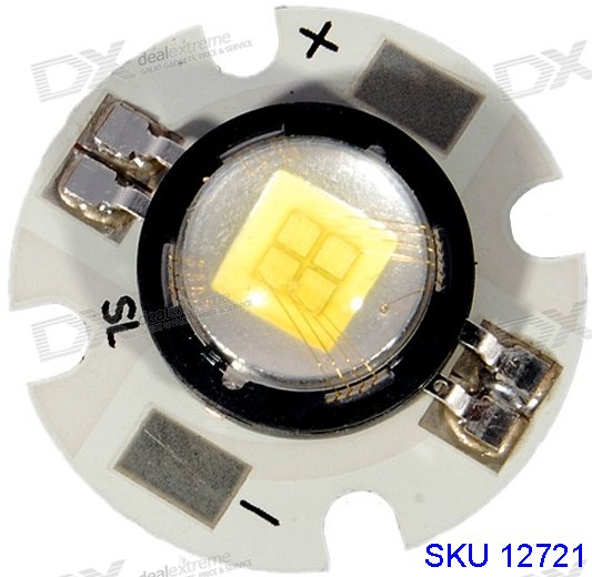

The SSC P7 LED - 2.8 amps max current rating - 900 lumens (theoretical)
LED link

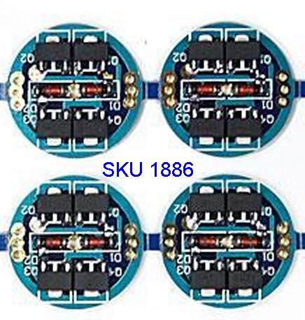

1400 ma current regulating boards - 16.8 mm diameter
These boards regulate the current to the LED
For the SSC P7 LED, you use two of these in parallel to get the full 2.8 amps of current.
2.8 amps is the max rating for the LED
Board link

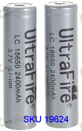

2400 mah Lithium batteries
Note that deal extreme has a bunch of different 18650 batteries.
Any one of them would be useable.
Battery link
