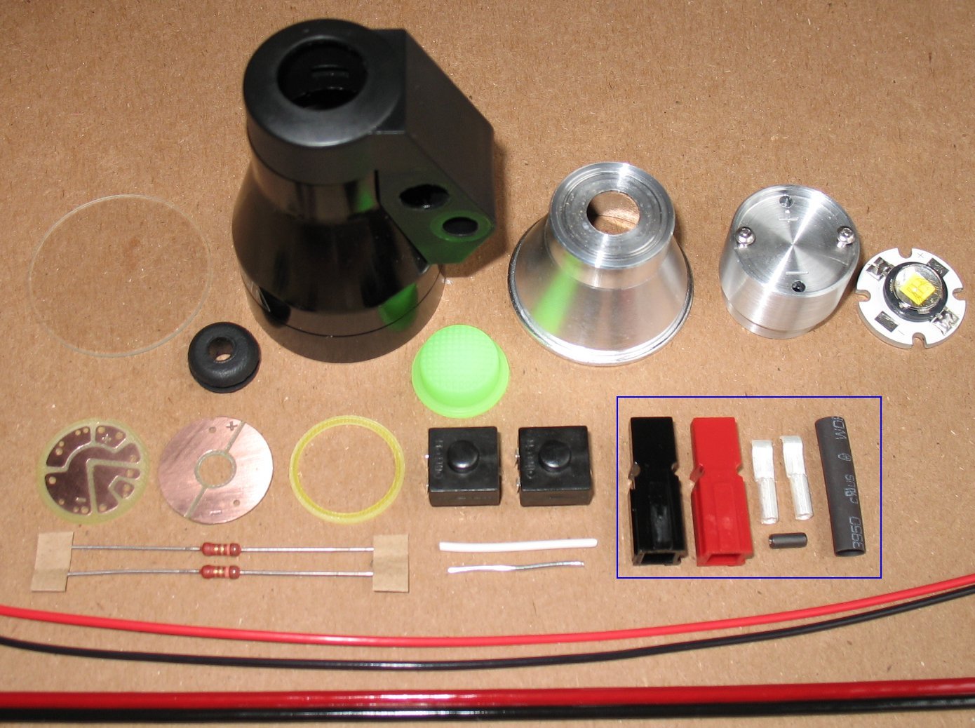

Click on the image for a larger image
Parts List for Marwi to SSC P7 conversions
1 - 34.8mm glass lens
1 - Machined Marwi light body
1 - 35mm machined reflector
1 - Marwi SSC P7 heat sink with 2 mounting screws
1 - SSC P7 LED
1 - 5/16" grommet
1 - Rubber Tail cap, your choice of color
1 - Resistor based current limiter board set
2 - 1.3ohm current limiting resistors
2 - Clicky switches (So you can do the double contact mod)
1 - Foot each Black and Red Teflon wire
(You only need a couple inches of each color. You will have some extra for your next project)
3 - feet of Red/Black 18 gauge  stranded Zip Wire
1-Set of Anderson PowerPole connectors
1-foot of 1/4" diameter heat shrink for power wires
(You only need a couple inches. You will have some extra for your next project)
A couple short pieces of wire
18ga solid core for the battery board hookup
22ga solid core for the short switch board jumper wire
You may also need a Marwi Helmet or Handlebar mount and the nylon Marwi mounting kit.
This list does not include batteries or chargers.
