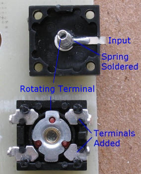

One of the main problems with the stock switch is that the internal contact surfaces are small.
What I am doing here is adding two more contacts so that the contact surface is doubled.
This improves the current handling capacity and the reliability of these switches.
The only way to take advantage of this mod is to jumper each of the two sets of terminals together.
This doubles the output path out of the switch.
It also insures that if one of the terminals is not making good contact, the other one probably is.
I am now cutting some of my circuit boards to take advantage of this mod.
The switch board has jumpers that jumper the new terminals together.
I am also soldering the input spring to the input terminal to improve this connection.
This is a very precise solder joint. You must have a very sharp solder tip and a steady hand to pull off this solder joint.
You will need two of the clicky switches to do this mod.
You are using two contacts from one switch and adding them to the other switch.

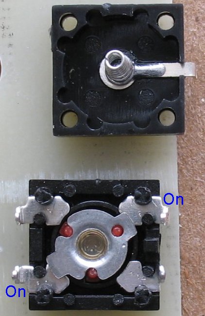

One 360 degree rotation looks like this.
Off-on-on-Off-on on

Here you can see I have added two more terminals.
You can also see that I soldered the Input spring to the Input terminal

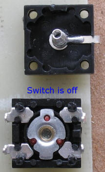

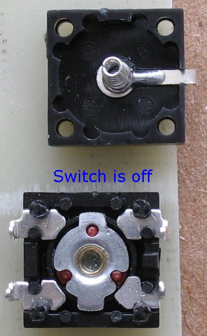

Here is what the switch terminals look like when the switch is off.
The center terminal is not touching any of the other terminals

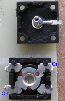

Click the switch once and now two terminals are on.
This is the first on position when used on my copper circuit boards

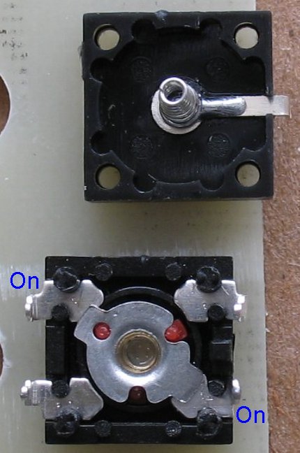

Click the switch once again and the other two terminals are now on.
This is the second on position when used on my copper circuit boards
