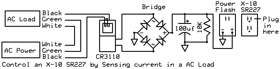

Here's a diagram of how this project works

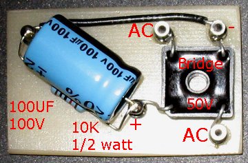

The CR3110 senses current flowing in the Black AC hot wire that leads to a AC Load.
A small AC voltage appears on the two CR3110 secondary wires.
A bridge rectifier turns the AC voltage into pulsating DC voltage.
The 100uf cap smoothes out the pulsating DC into smooth DC.
The 10K resistor is a load resistor.
The X10 Powerflash senses voltage on it's + and - terminals and then sends an X10 code when it is triggered.
The X10 - SR227 receives the X10 code from the Powerflash and turns on the top outlet.
Anything plugged into the top outlet of the SR227 with turn on.

The voltage rating of the Bridge and 100UF Capacitor probably need to be 50 volts at the very least.
I used parts that I already had on hand in my shop, the parts are not critical.

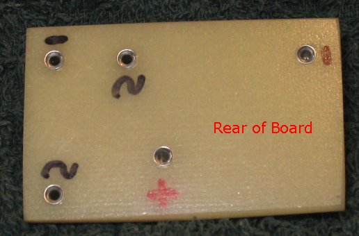

Here's a front and back shot of the circuit board that I will install inside my power strip.
It had to be small to be able to fit inside the powerstrip.
Click on the image below for a larger image.
X10 image

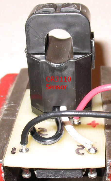

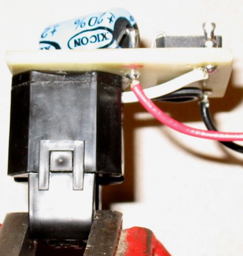

I epoxied the CR3110 current sensor to the back of the circuit board to keep it from moving around.
X10 image
The complete board assembly with the CR3110 epoxied to the back.

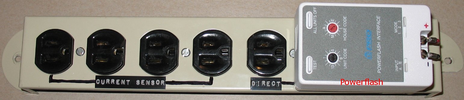

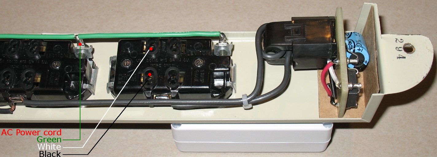

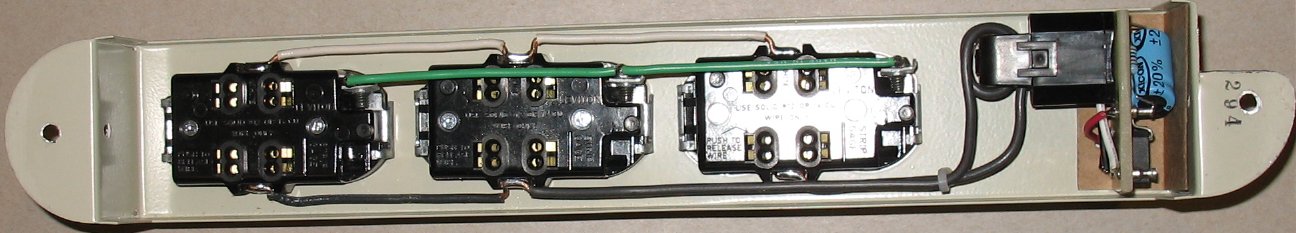

Here's the Cr3110 circuit board assembly mounted inside the power strip.
The four AC receptacles on the left are the current sensing receptacles, they must flow current through the CR3110.
The two AC receptacle on the right do not flow through the CR3110.
Note: Each black AC receptacle in the pictures actually has two AC receptacles.
X10 image
Note the two turns of 12 gauge solid core wire through the hole in the CR3110.
Click on the photo above to see how to connect the Powerstrip AC power cord.

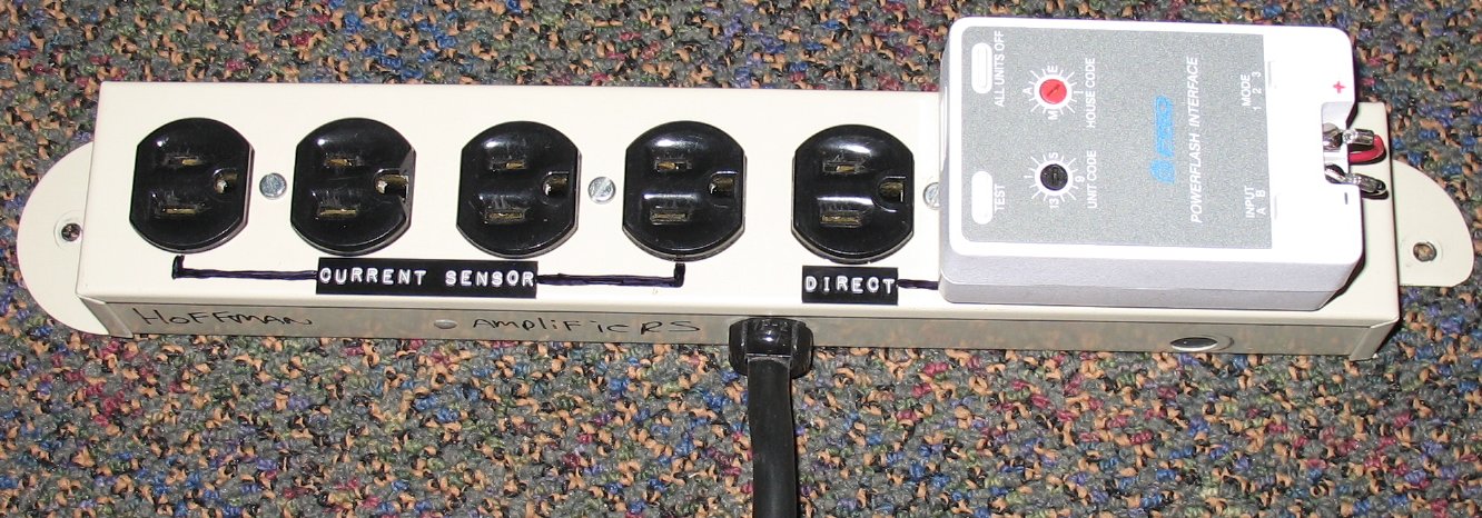

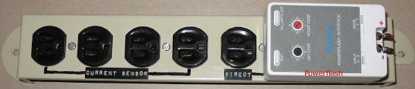

The front side of the power strip. There are 6 total AC receptacles.
There is four current sensing AC receptacles on the left and two non sensing AC receptacles on the right.
The Powerflash is plugged into the far right AC receptacle.
X10 image-

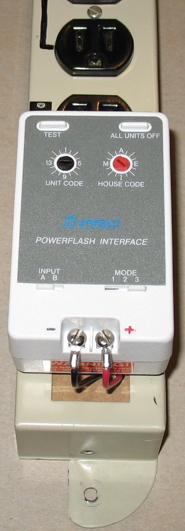

End view of the X10 Powerflash unit.
The Black Negative and Red Positive wires from the circuit board are connected to the Powerflash - and + terminals.
The Powerflash is set to Input A (voltage sensing input) and
 Mode 3 (turn on all X10 units set to the same code as the Powerflash)
I set the Powerflash house code to the same code as the SR227 appliance module that I will be controlling.
