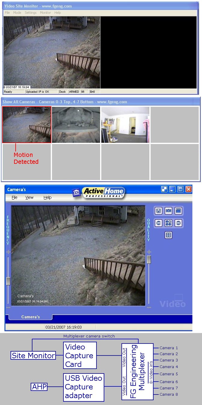

 What I am able to do now by combining VSM and AHP's Iwitness software is this. VSM does the camera scanning and motion detection, VSM and AHP both share the video signal out of multiplexer. Whatever camera VSM is scanning also is displayed in the AHP software because AHP is getting it's camera signal from the multiplexer. If motion is detected by VSM, it will stop and focus on that particular camera, and AHP will be seeing the exact same camera. There is no need to use motion sensors, no need to turn cameras on and off the way that AHP does. See the diagram below for a schematic of how the system works.
Note that VSM is doing all the video recording normally. I also have a very good motion sensor that triggers a X10 Powerflash unit (see project #1 on the main projects page). It turns on lights outside so my main security camera can see at night. This sensor can also trigger the AHP software to run macros, take snapshots,etc. So basically VSM and AHP can both be triggered to do their video functions.

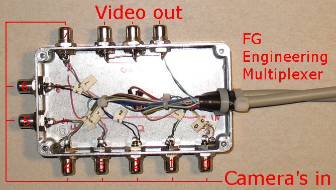

Here is a picture of my customized 8 camera multiplexer.
The FG Engineering multiplexer is basically just a camera switch.
There is also small circuit board and that is where the actual switching hardware is located.
Normally, all the RCA jacks are free hanging, each on it's own wire.
I wanted to make it a bit more bullet proof and so I removed all the free hanging female RCA jacks and then installed the jacks inside a nice die cast aluminum box.
On the other end of the two large wires are parallel port connectors.
One connector goes to your computer parallel port and the other connector goes to the multiplexer circuit board.
Any one of the 8 camera inputs can be switched to the outputs by the VSM software or manually by you.
There's a cover that screws on and closes the box up.
Go to the FG Engineering link above to see pictures of the stock multiplexer.

The very top screen shot shows the VSM main screen and what camera is currently being scanned. The black area on the right shows where motion is being detected. Motion shows up as a white negative image.
The next screen shot down shows the 8 camera window. When motion is detected in the camera that is currently being scanned, VSM draws a red box around that camera image and watches it for a certain amount of time that you set up. There are several options available of what can happen when motion is detected.
The next screen shot down shows the AHP camera window for the current camera that is being scanned or watched. The camera image changes every time that VSM scans a new camera.
The drawing below the AHP screen is a diagram of how the system is set up.
Up to 8 cameras can be connected to the multiplexer video inputs.
The multiplexer normally has one video output, I added two more.
In my setup I have one video output going to a Video capture card in my PC.
The other video output goes to a AHP USB video capture adapter.
VSM gets it's signal from the video capture card.
AHP gets it's video signal from the USB adapter.
VSM has control of the multiplexer camera switcher or you can switch it manually and look at any camera you want.
