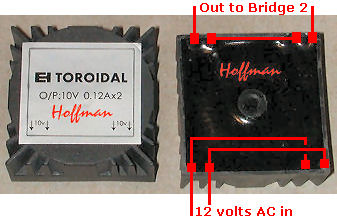

Toroidal power transformer hookup.
Tube pedal power supply diagram
Hookup Notes:
You use a 12 volt AC wall wart, not a 12 volt DC wall wart for the input to this transformer.
12 volts AC input side = Jumper the lugs together as shown
Out to bridge rectifier side = Jumper the lugs together as shown
Size specs = 40mm x 40mm x 19mm high.

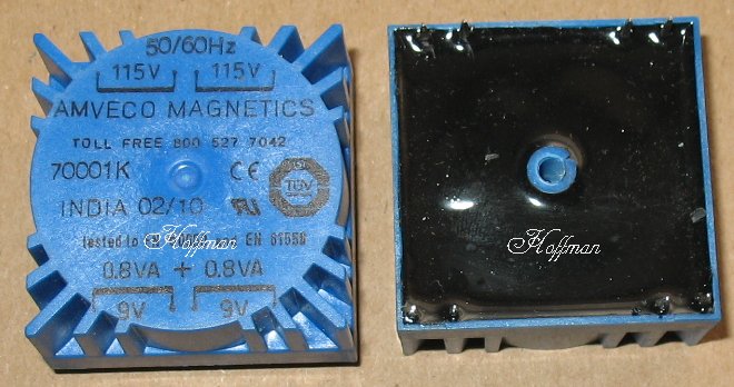

Note that the Toroidal transformers I stock look like this.
The black ones above are wired the same as the blue ones.
