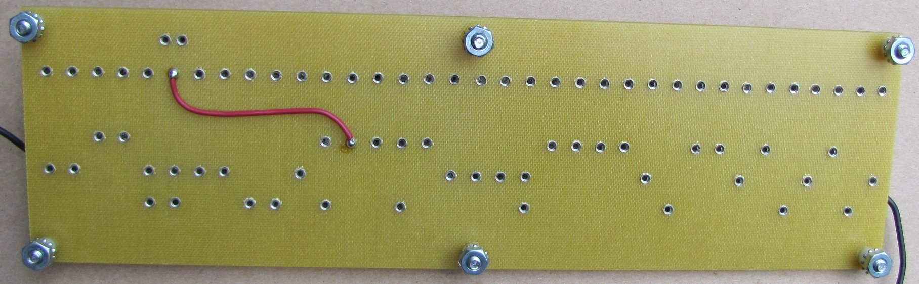

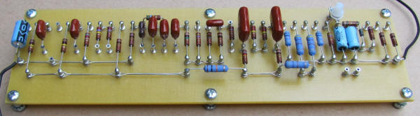

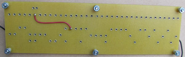

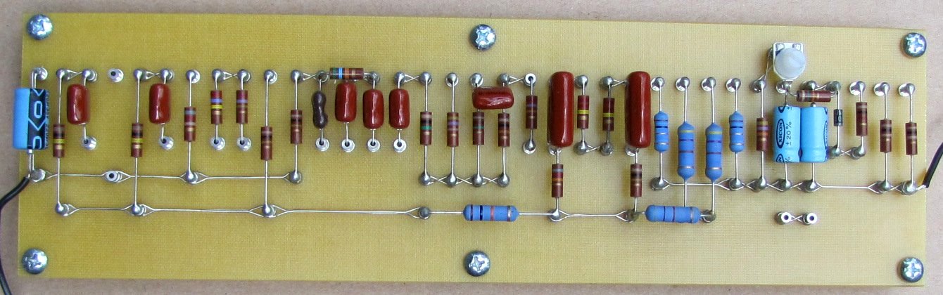

Here's a few images of a 5F6A board front and back
You can click on the images to see larger images
Hoffman board info from the old web site.
  The boards shown on this page are all hand wired construction using turret lugs and 1/8 inch thick epoxy type circuit board. Carbon comp resistors and polypropylene caps are standard. You can specify metal film resistors if you want. Some very large sized capacitors will not fit on the boards. For example a .1/600 volt Sprague orange drop may be too large to use on a board. The fixed bias circuits all have a bias pot and one ohm resistors on the board so you can bias the amp yourself with a common multi meter.

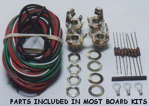

If you purchase a Hoffman board and intend to install it yourself, the boards will come with additional items.
Each board has different needs. For example, the reverb unit kit does not have 4 input jacks.
Items that come with a Hoffman Board
The Complete Circuit Board assembly, with all the ground wires, resistors, capacitors, bias pot, etc already mounted. Ready to bolt in and start wiring to all the tube sockets, pots, filter caps, etc.
Circuit board standoffs, mounting screws and nuts.
Quantity 4 of #12A Switchcraft input jacks.
Input jack resistors, quantity 4-68K and quantity 2 of the 1 MEG, half watt carbon.
Complete pot harness assembly with all pots joined with a buss wire soldered down the back and all jumper wires, caps, resistors soldered in place and ready to go.
Power tube input grid resistors for each power tube. Depending on the kit, usually 1.5k or 5.6k.
All hook up wire.
Mini shielded cable for the input jack to first pre amp tube connection.
Heat shrink tubing for the mini shielded cable.
Quantity 4 round ring terminals for making grounds to the chassis and power transformer.
Installation instructions and the layout diagram.
image  These are the assembly items that come with most of the Hoffman boards. Not all boards get the same items. You get several colors and gauges of wire. Some mini shielded cable for the input jacks to the first tube. A piece of heat shrink tubing for the ends of the shielded cable. 4 x #12A Switchcraft input jacks. 4 x 68k and 2 x 1 meg input jack resistors. 2 or 4 x 1.5k, 5.6k power tube control grid resistors. 4 round spade lugs for grounding wires to the chassis. The mounting hardware for the board includes the standoffs, mounting screws and nuts. The Marshall boards come with tall standoffs so you can get over the top of the big cap under the board. The other boards come with 1/4" nylon standoffs.

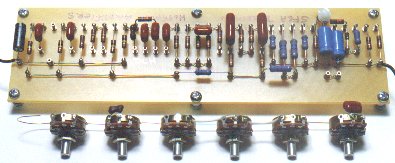

5F6A Bassman board
The 5F6A kit includes:
The complete circuit board with all the parts mounted point to point using turret lugs.
The board includes the bias pot and one ohm biasing resistors for each power tube.
The ground wires are already connected to the board.
Includes all mounting hardware and standoffs.
Includes the complete pot harness assembly.
Includes four #12A Switchcraft input jacks and all the input jack resistors.
Includes all the hook up wire, shielded cable, heat shrink tubing and ring terminals.
Board dimensions are 3.125 inches wide x 10.75 inches long.

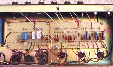

Plexi board
 The photo above shows the Plexi kit installed in a JTM 45 Bluesbreaker chassis. This chassis had a tube rectifier and only two big LCR filter caps so I had to add an extra filter cap because the plexi circuit uses six filter caps. I highly recommend using this chassis because the voltages are lower than most other chassis and the amp is not as aggressive and loud as most other chassis such as a JMP or JCM 800 chassis.
NNote: JTM45's and Blues breaker's were the 5F6A Bassman circuit, not the later plexi circuit. I used the JTM45 chassis for a plexi board because it had a tube rectifier and the voltages that I was looking for.

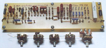

Vox AC30 board
 The AC30 kit does not include channel three, the tremolo channel. That channel requires three more 12AX7 tubes and as many parts as the main amp, so the kit would be too large to fit in any amp carcass. The way that Vox did it on the old amps was to make two separate boards and place them 90 degrees to each other and use tons of wire in a very rats nest fashion. The old amps are horrible to work on and a fire hazard but they have a very cool tone. Channel one on the kit is the regular no boost channel and channel two is the cool top boost channel. Channel three the tremolo channel is not available.
The kit includes:
Board dimensions are 3.125 inches wide x 10.25 inches long.

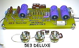

5E3 tweed Deluxe board
The kit includes:
The power supply filter caps are already mounted on the main board.
Board dimensions are 3.125 inches wide x 8.25 inches long.

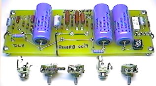

6G15 stand alone reverb board
 Replace the PC board in the Fender re-issue stand alone reverb unit with a hand wired point to point board. The re-issue reverb unit uses a bridge rectifier and this board kit is ready to go with a bridge mounted right on the main board.
The kit includes:
Includes the complete pot harness assembly including the input and output jack.
Board dimensions are 3.125 inches wide x 9.125 inches long.

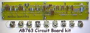

AB763 board
 The AB763 circuit is the Black face era Fender combo with reverb circuit that was used in the mid 1960's by fender.
The same circuit was used on
Deluxe reverb,
Vibrolux Reverb,
Super Reverb,
Pro Reverb,
Bandmaster Reverb,
Vibroverb and
Twin Reverbs.
All of the chassis are different lengths on the models above. So you can see there is not just one chassis or model of AB763 circuit.
 Basically the only thing that makes any of those models different from the next is the transformer set and speakers. I have included the tremolo that was used on the 63-64 Vibroverb which does not uses an Optoisolator. The Vibroverb tremolo modulates the power tube bias voltage and is much smoother sounding than the Optoisolator tremolo. The pot assembly comes with the mid range pots for both channels. You can remove the mid range pot and replace it with the 6.8K fixed mid range resistor that is included with the kit. This kit is a monster to install because there are so many hook ups and I do not recommend you attempt it if you are not familiar with building an amp from scratch. I don't even like to do this kit because it is so labor intensive.
The kit includes:
Includes the complete pot harness assembly for both channels, including mid range pots.
Two 6.8K mid range resistors if you are not using the mid range pots.
Board dimensions are 3.125 inches wide x 15.75 inches long.
