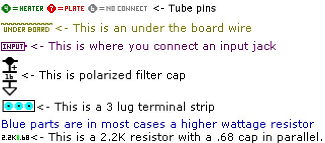

Common Hookup info for layout diagrams #1 - Old layout diagrams
image  This drawing shows common hookup info codes used on my layout diagrams.
Notes:
Blue parts are usually 3 watt, 5 watt or 10 watt.
A Blue .1 cap can be a 250V cap.
See the parts listing for each project.
No connect is a pin on a tube that is not connected internally.
You can use these pins as terminal connectors since they just dead end and do not enter the tube.
Note that a bias caps polarity is reversed because you are filtering negative voltage.

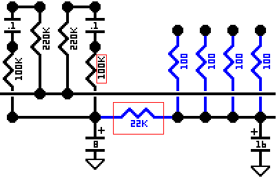

Drawing scale issues
image  image
The layout diagram  The actual circuit board holes
Some of the components on my old layout diagrams take up a lot of space on the drawing.
I have to wedge these components into the layout drawing any way I can.
Examples:
The 100k resistor circled in red looks longer than the .1 capacitor right above it.
The lug spacing looks closer together on the .1 than the 100k.
The actual board holes for these parts are shown in the image above right
Note that the .1 and 100K holes are spaced evenly on the board.
The blue 22k resistor on the layout diagram shows that it crosses a long gap.
There is no long gap on the actual circuit board where the blue 22k resistor gets installed.
All four lugs to the right of the 22k get laced together
You can hook the right side of the 22k resistor to any one of those four lugs.

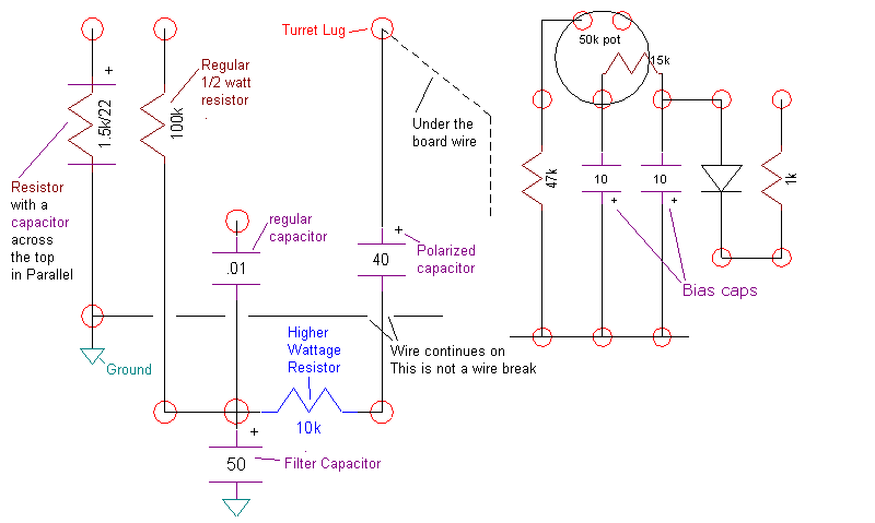

Common Hookup info for layout diagrams type 2 - Newer style layout diagrams
Layout diagrams #2 - newer style
The newer style layout diagrams are taken from the same CAD program I use to make the pre-drilled boards
The turret lug layout on these diagrams is exactly like it is on the pre-drilled boards I sell.
Many of the drawing parts are explained on the image above.

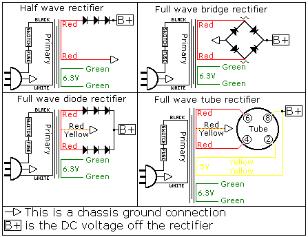

Power transformer hookup and rectifier info
Note: I am not showing any bias windings or bias taps on any of the above diagrams.
Half wave rectifier circuit - This circuit is found on the old 6G15 Fender stand alone reverb units. It produces very rough DC voltage and needs lots of filtering to smooth it out. The transformer does not need a 5 volt tube rectifier filament winding since there is no tube rectifier. It is very cheap to set up but all you save is 3 diodes and the DC is so rough that you have to filter the crap out of it.
Full wave diode rectifier circuit - This circuit produces DC voltage that is twice as smooth as the half wave circuit. It requires a center tap on the high voltage winding. The transformer does not need a 5 volt tube rectifier filament winding since there is no tube rectifier.
If you measure the AC voltage across the two Red AC windings you will usually see about 700 volts AC. You may end up with roughly 400 plus volts DC coming off the rectifier, depending on the winding current spec's for the high voltage winding. The larger the current rating, the less of a voltage drop you will get under load.
Full wave tube rectifier circuit - This circuit produces DC voltage that is twice as smooth as the half wave circuit. It requires a center tap on the high voltage winding. The transformer requires a 5 volt tube rectifier filament winding to heat the tube rectifier filament.
Full wave bridge rectifier circuit - This circuit produces DC voltage that is 2 times as smooth as the half wave circuit. It needs way less filtering than a half wave circuit and has the added advantage of not needing a center tap on the high voltage winding. The transformer also does not need a 5 volt tube rectifier filament winding.
If you measure the AC voltage across the two Red AC windings you will usually see about 350 volts AC. You may end up with roughly 400 plus volts DC coming off the rectifier, depending on the winding current spec's for the high voltage winding. The larger the current rating, the less of a voltage drop you will get under load.
NOTE: Notice that the high voltage winding AC voltage is roughly half that of the full wave rectifier.

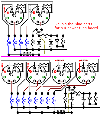

Making a 4 power tube board
The blue parts have been doubled in the diagram above.
 You can make a 4 power tube version of any board. I don't sell 4 power tube mask because it's easy for you to make a 4 power tube board if you already own a two power tube mask. You must own my drilling template and a mask to be able to do the procedure described here.
 Basically, all you are doing is adding two more 1 ohm cathode resistor spots and two more screen resistors spots to your board. You must plan ahead by making your board longer by 4 more lug places horizontally. You can also just drill the board and then trim it to length after you are done. This is the foolproof method.
 As you are drilling the board left to right or from the pre amp end towards power tube end, you must stop when you get to the area where the 1 ohm cathode resistors and screen grid resistors are. You go ahead and drill the normal 4 spots it takes for a two power tube board. Then you just shift the mask to the right four places. Once the mask has been moved you can drill the 1 ohm and screen grid resistor holes again. Now you should have 4 x 1 ohm resistor spots and 4 x screen grid resistor spots.
 You can leave the mask where it is and drill the remaining holes to the right. If there is a bias pot on your board, the template should be correct because I designed it to be able to do two or 4 power tube versions of the boards.
 If your board has negative feedback, you will have to change the value of the feedback resistor to two times the normal value. Example: a 50 watt Marshall has a 47K feedback resistor and a 100 Watt Marshall has a 100K feedback resistor.
