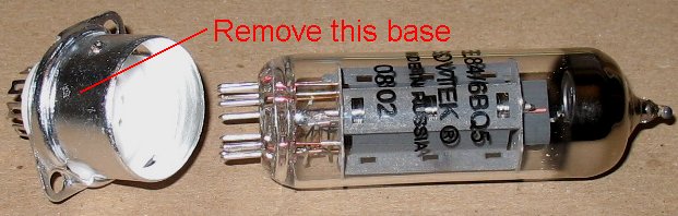

| The metal base on regular 9 pin sockets is too narrow for most EL84's to fit down

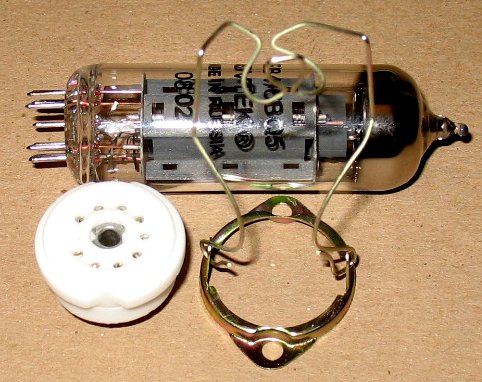

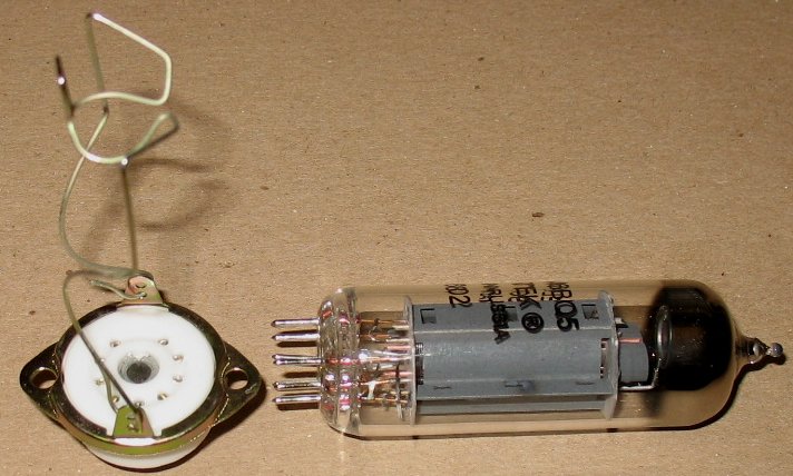

into the socket. Here's how you mount an EL84 in a 9 pin socket. Take just about any 9 pin socket and remove the metal base that the tube shield mounts to. Get one of the EL84 spring/clamps that has a two hole mounting base. Clamp down your 9 pin socket with the EL84 spring/clamp combo. I sell 9 pin sockets that have no base attached on this page. |
| The EL84 spring/clamp holds the socket nicely. EL84 tubes and springs are located on this page |
