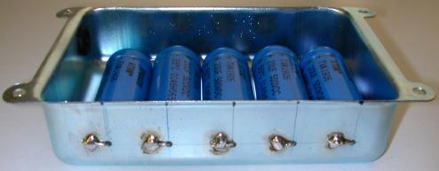

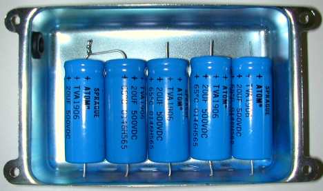

| This method does not use a circuit board or insulating backing board. I will be using 5 x 20uf/500v Sprague atom filter caps. The negatives of all the caps are soldered to the can itself and then the can must be screwed down tight to the back of the chassis so that the four corners of the can make good contact with the chassis. That way you will get a good ground contact between the can and the chassis. The positive ends of the caps are clipped short. There will be four positive wires that are soldered to the filter caps and then exit out of the can through a rubber grommet. The four wires go to each of the four filtration stages. You can secure the caps to the metal can with double stick tape, glue or RTV silicon. |
Here you can see that I have taken a small Fender cap can and drilled 5 holes 1 hole for each of the cap negative wires. |
Push the negative leads of each cap through the drilled holes. Bend them 90 degrees and then clip them to about 10cm or roughly 3/8 inches. Solder all the negative leads to the filter can. You may need a 40 watt or more soldering iron to be able to solder the leads properly. The metal can will suck the heat right out of a small soldering iron. |

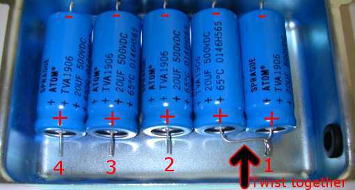

(1) Twist the first two capacitors positive leads together to make two 20uf capacitors in parallel. This is the first stage of filtration downstream from the rectifier. 20uf + 20uf = 40uf total filtration on stage one. (2-3-4) Stages 2 through 4 are single 20uf/500v caps that will go to the board |

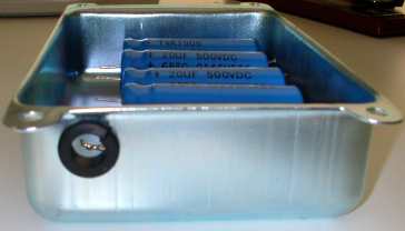

| Here you can see that I took a 1/2 inch grommet and cut out a small wedge
so that it would fit into the smaller diameter cap can hole. Solder 4 x 18 gauge stranded red wires to the ends of the caps Use some 3/16 inch heat shrink to seal the solder joints The four positive wires exit through this grommet and go inside the amp to the circuit board. You may have to drill a hole in the chassis where the four wires enter The cap can can be screwed down to the chassis using #8 tapping screws |

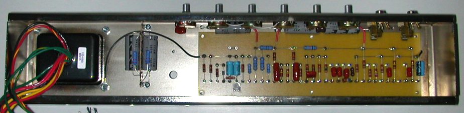

| Here is another way to do the filter caps without a cap can or circuit board. All the filter caps are inside the chassis going point to point. The stage one filter caps are between the power transformer and the circuit board on an 8 lug terminal strip. The remaining three stages are along the front edge of the chassis, under the pot harness. |
| Here you can see the whole chassis and all five filter caps. The main filter caps are shown to the left of the board. The other 3 stages are under the pots |
These are the two main stage one filter caps mounted to an 8 lug terminal strip. I have done a series arrangement here of two 100uf/350v caps. You could do a parallel arrangement here also. The bottom lug on the terminal strip, and the top lug of the 8 lug terminal strip are bolted to the choke holes in the chassis. The choke is on the other side of the chassis bolted to the same holes. The 220k/3 watt resistors are bleeder resistors. The bottom lug on the terminal strip acts as the chassis ground connection for the filter caps. You can also solder a wire here and ground that on a transformer bolt with all the other grounds. Lug #2 is the main B+ connection. Lug #7 is where the two caps and two resistors are all soldered. Lugs 3, 4, 5, 6 and 8 are not used. Note that the top lug, #8 of the terminal strip is not connected to anything, it is just used to bolt down the terminal strip You can see more info about parallel and series cap arrangements on the library page here. |
| Here you can see the last 3 stages of filtration. The positive ends of the caps go right to the lug on the circuit board so no wire is needed. The negative ends are all soldered to the buss wire that runs down the back of the pot harness, so no wire is needed I have put some #18 gauge red wire jacket on the positive ends of the cap leads as a safety feature. The caps are all tucked neatly under the pots and out of the way. Illinois caps and F&T caps are small enough to mount this way Sprague atom caps are too large to mount this way. |
