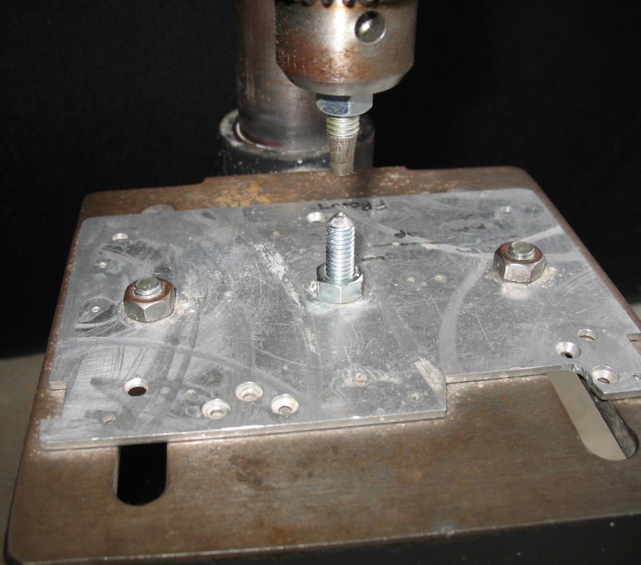

I use the press method shown below with a cheapo drill press that has had the motor removed and now it is a full time turret lug press.

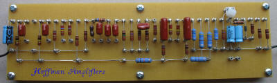

Hoffmanamps Turrey lug board
This is what a Hoffman turret lug board looks like if you take your time and work neatly

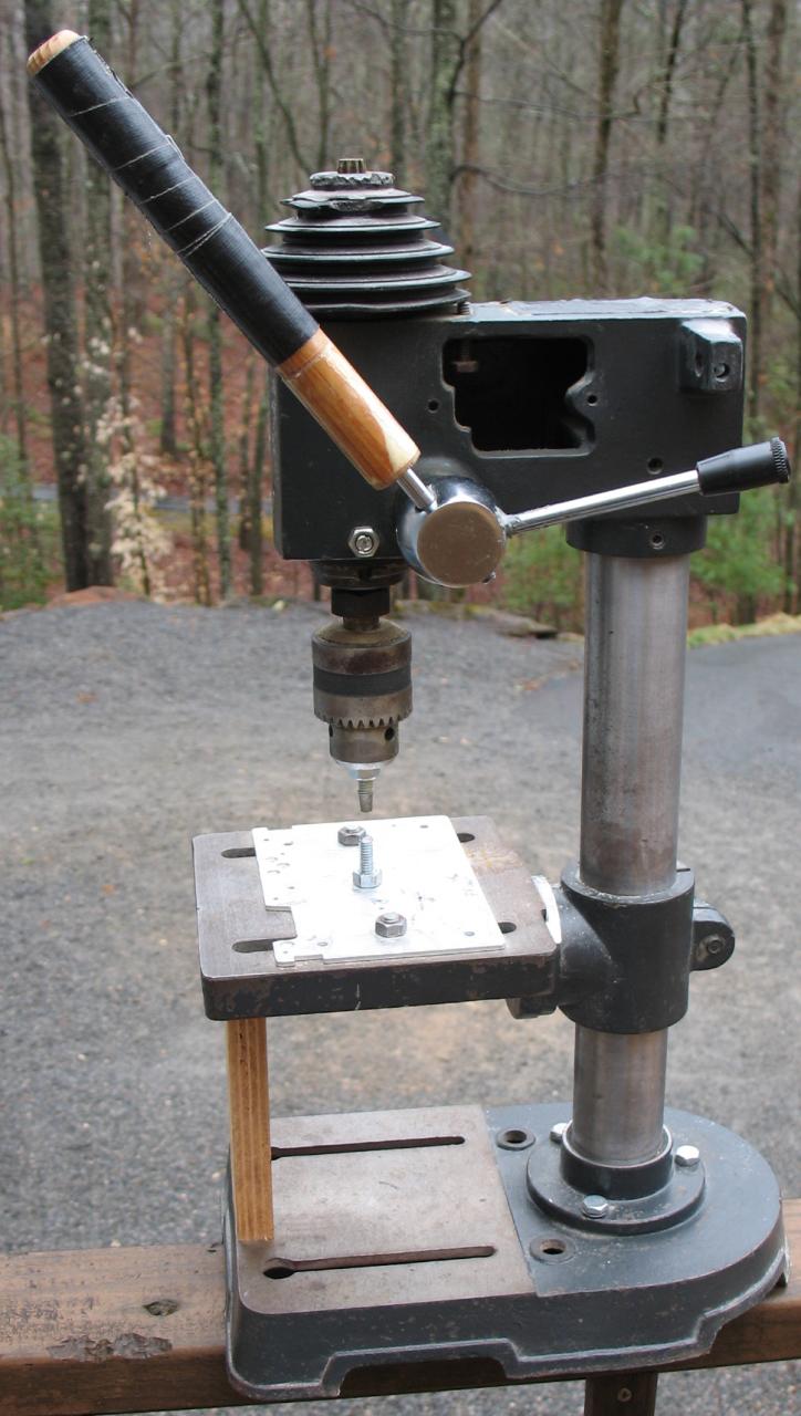

This is the press I have been using for 25 years

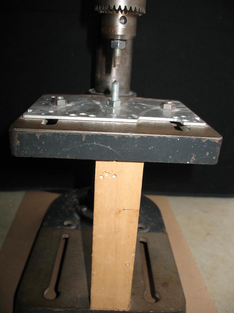

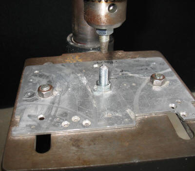

A few shots of my Turret lug press
I mount the pointy tool to a metal plate and then bolt that plate down to the press work platform.
Line up the tools so that the pointy tool meets exactly in the center of the hole tool
I have a wooden support under the work platform to keep it from flexing down when pressing a lug
If the work platform moves, the two tools will not be lined up correctly
Bolt everything down solid so that nothing can move and mess up the alignment of the two tools
I have some photos down below that show how far apart the two tools should be
The reason I mount my turret lug tools this way is that you can install all the lugs in the board and swage them very quickly.
If you reverse the tools, you would have to drop a lug into the hole on the lower tool and then move the board over the top of the upside down lug until you found a hole.
That's very slow and time consuming to do it that way
You may have noticed that I have ground down the top tool piece to a smaller diameter.
I did this so that I could press lugs very close together without the tool hitting a neighboring turret lug
On the Hoffman turret boards, the hole spacing is far enough apart that you do not need to grind down the tool diameter

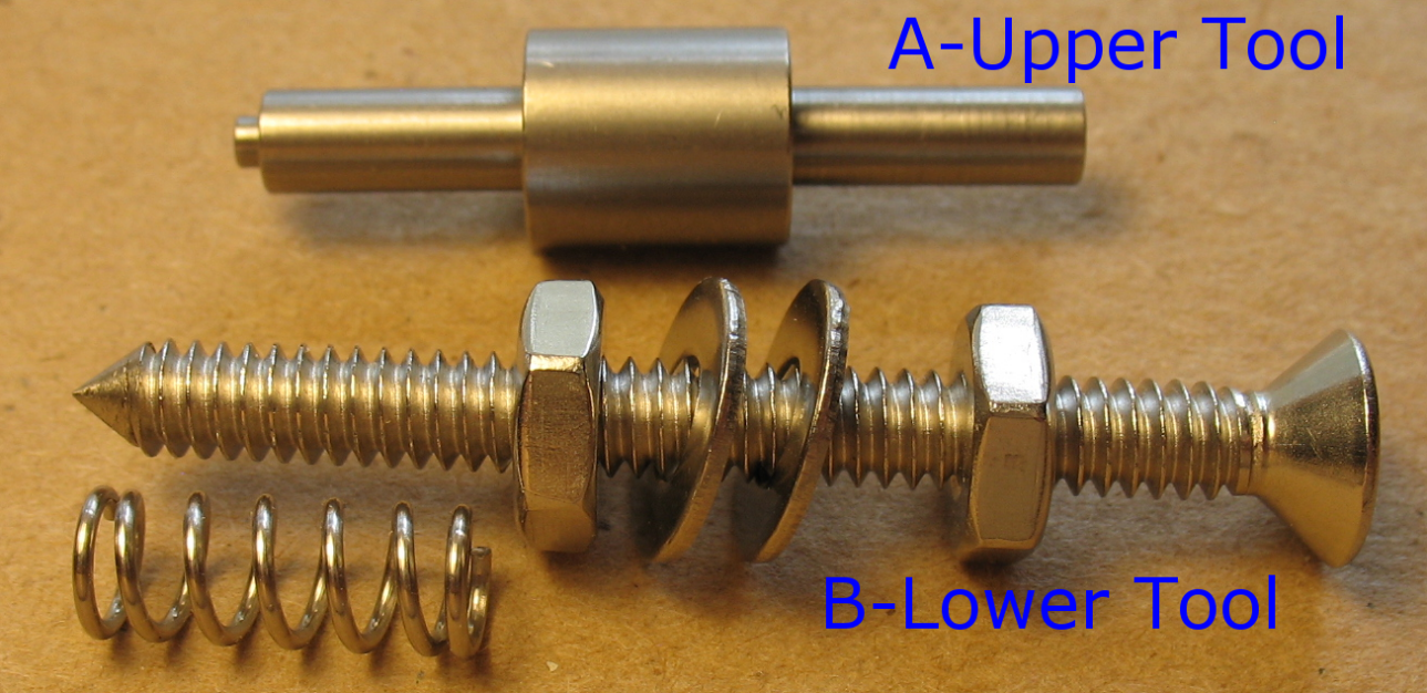

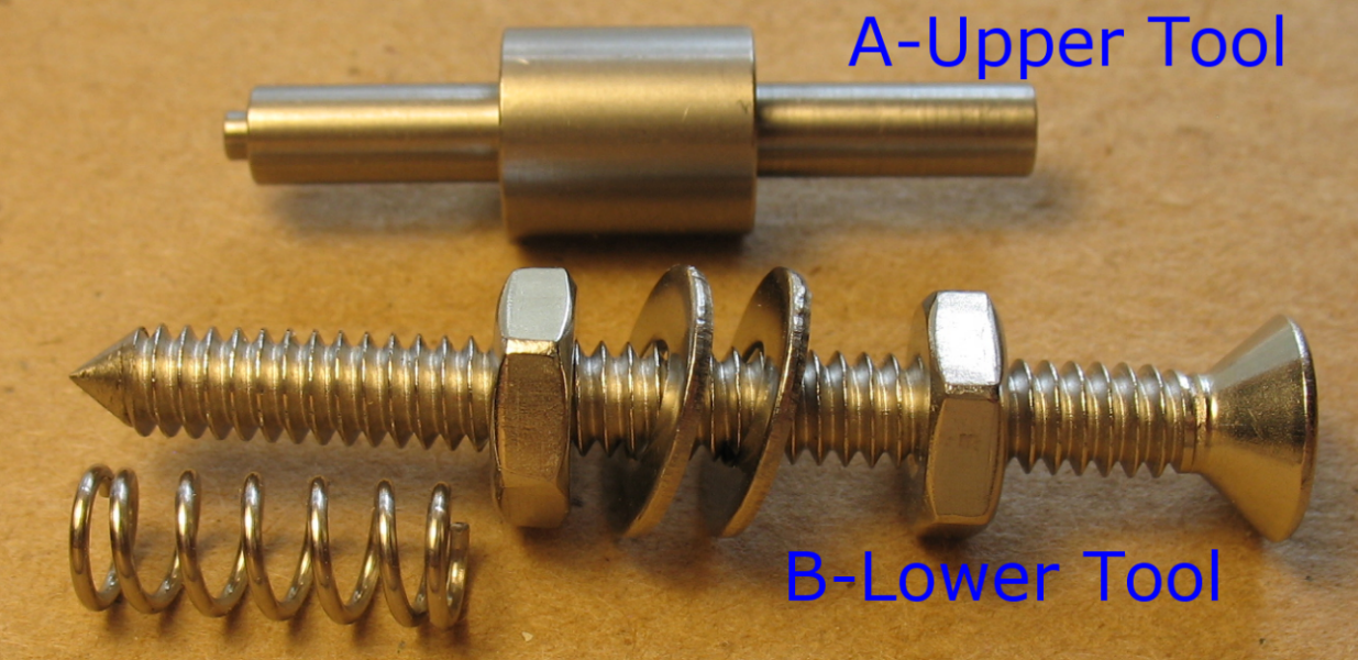

Turret lug tool
Here's a picture of the turret lug tools that I sell
The tool comes with a pointy tool and a tool with a hole that is the correct size for the turret lugs I sell
It also comes with 3 nuts so you can blot it down
These tools are listed on this page in my web store

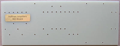

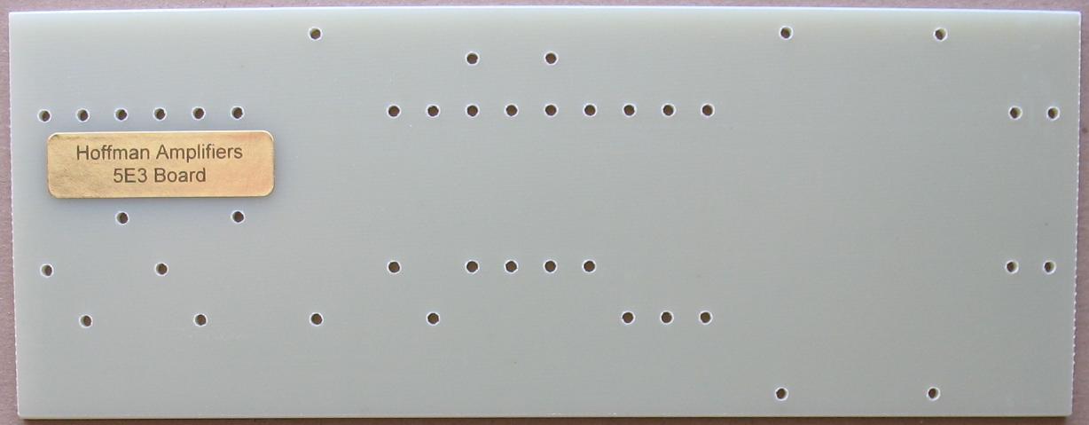

Hoffman 5E3 board
Drill all the holes in your board using a 3/32 drill bit.
I use plain old jobber drill bits and they work just fine.
I sell drill bits and other tools on this page
The drill should be run at the fast speed.
Or you can buy pre drilled boards like the one shown above on my Hoffman Turret Boards page here

TIP: Make sure you are installing the lugs on the correct side of the board.
Double check yourself before you start pressing

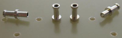

Turret board and Turret lugs
Install all the lugs into the drilled holes or do sections of the board at a time.
Press them all the way down until the flange sits flush on the board surface.
I use a large flat object to press them all flush at one time.
Be careful not to jiggle the board so the lugs fall out.
As your 3/32 drill bit wears down, the lugs may fit more snugly in the holes
When the lugs get too hard to push into the holes, it's time for a new drill bit

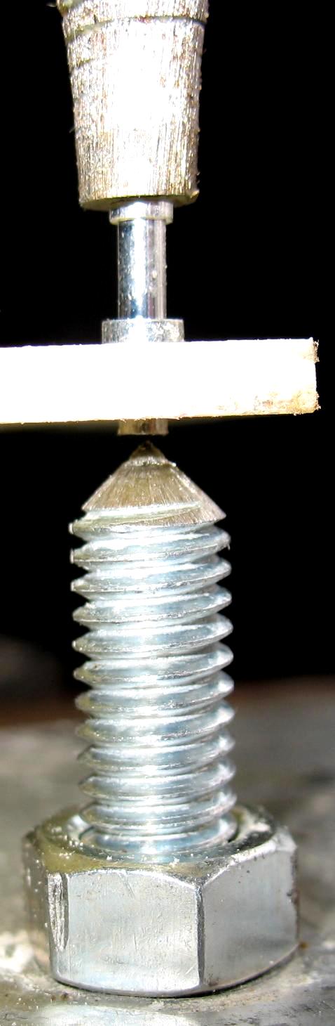

Turret lug press Turret lug press Turret lug press

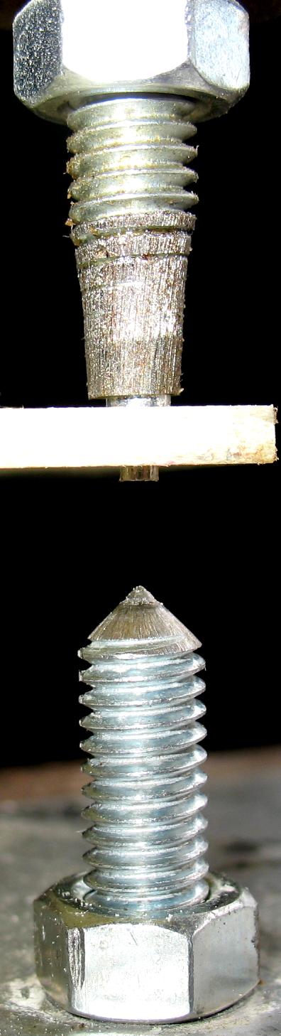

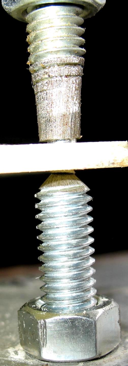

Left: The two tools are only far apart enough to slide a lug in and have just a bit of room on the top and the bottom of the lug
Middle: push the board upward into the top tool hole
Right: Pull the handle down on your press and swage out the lug
It does not take very much pressure to swage or flair out the lug.
They are soft brass inside with a nice plating on the outside. They are not steel

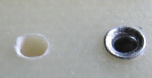

The picture Below is what the backside should look like after being swaged
If the swaged out backside is off center, you may have to align your tools better.
If the rim is cracked, the tool may be off center or your board is not the right thickness
If too much of the lug sticks out because your board is not thick enough, the rim will be cracked

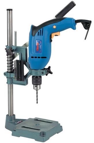

A customer of mine found this nifty tool at Home depot.
It is a tool that holds a hand drill and turns your hand drill into a drill press.
She says that it was perfect for installing the lugs in her circuit boards.
Of course you do not mount the hand drill in the tool, you just use it as a lug press.
I went to Home Depot and looked at it in person and it looks like it will do the job.
Home Depot's SKU number for this item is SKU 459380 and at the time I looked at it, it sold for $39.97.
You can buy it on line at www.homedepot.com.
Thanks for the great tip Laura.
Update 2014. This item may an old model that is not being made. -Here's a link to the Wolcraft web site
I have also seen hand drill presses like the one shown on the right on Amazon, Ebay and while doing Google searches but I have never seen them in person.
It looks to me that you would have to do some fabrication to be able to mount the top tool in the big hole that is used to hold the hand drill securely
