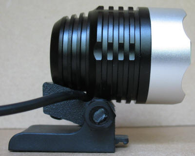

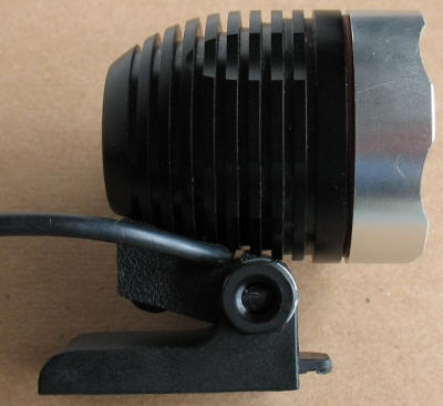

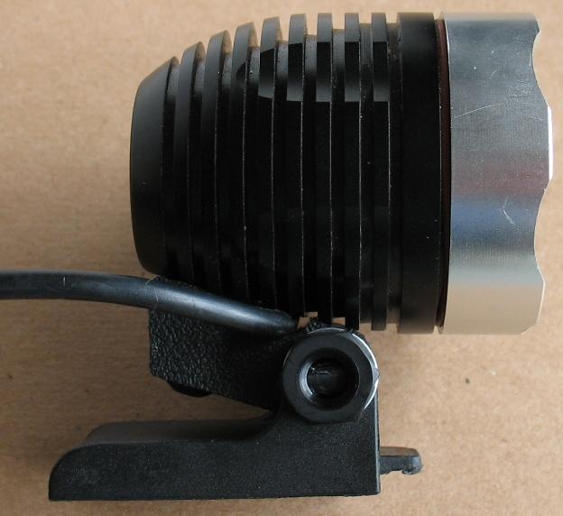

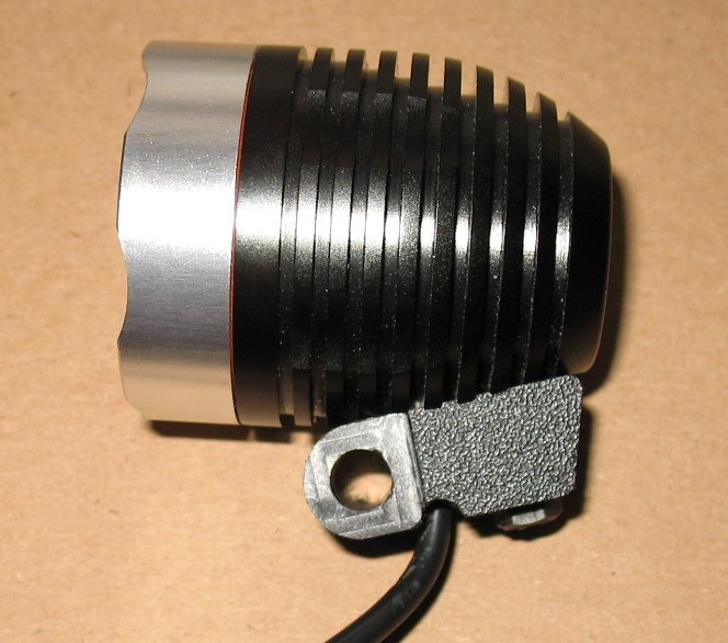

  | The original Magic Shine MS900 light body looks like this
 | Here is a newer style MS light body. Notice the reduced size at the back of the light.
 My MS900 adapter works on this this body style also

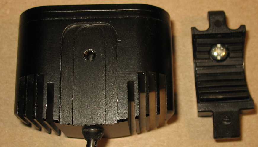

  | First remove the original mount from the bottom of your light There is a small screw that you remove and the mount comes right off
 There may be a small rubber grommet under the mount
 You can snip this grommet off the power cord, it is not needed.

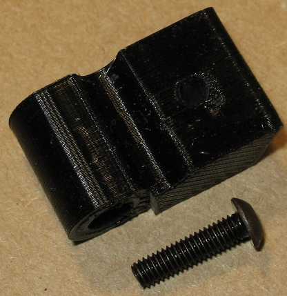

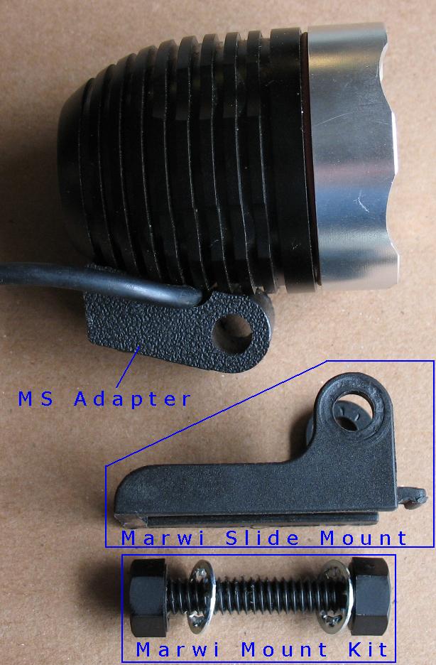

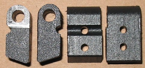

 | MS900 adapter You will be replacing the stock mount with these parts
  | Click on the images for a larger image |

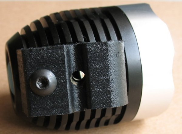

  | Bend the power cord to the right or left side, your choice. Push the adapter up against the MS light body.
 The wire lays in the half round channel in the adapter
 Thread the screw into the body with a metric Allen wrench
 | See the image on the left The Marwi slide mount comes with the Marwi Helmet or Handlebar mount.
 So you will have to order a Helmet or Handlebar mount

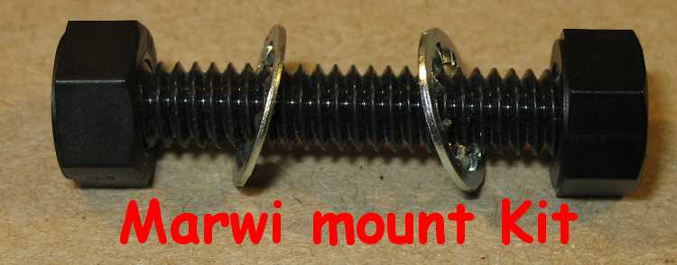

 You will also have to order The Marwi Mount kit
 The Marwi mount kit is a Nylon bolt, 2 nylon nuts and 2 lock washers.

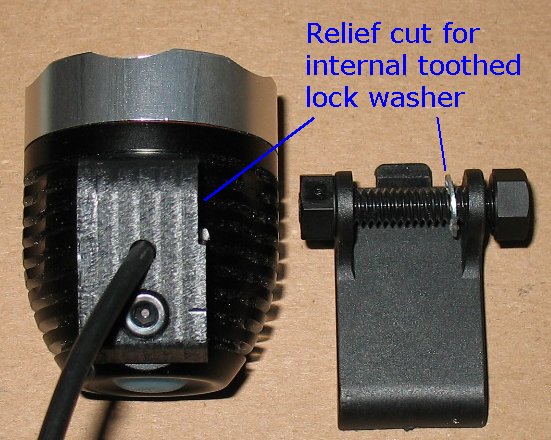

  | It may be hard to see in the images but the light bodies are machined flat where the adapter bolts on

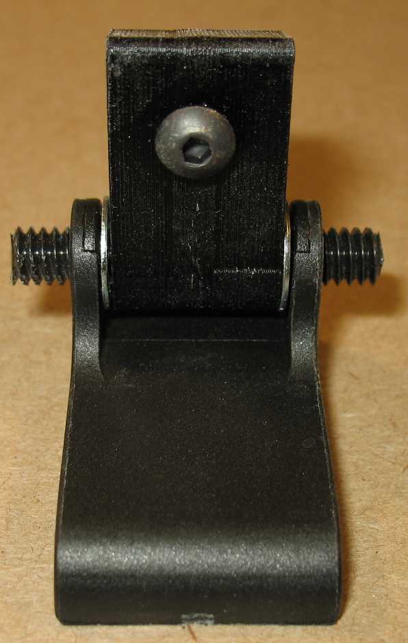

 Hold the Marwi slide mount up to the MS adapter so the big holes line up
 Slide in the threaded Nylon bolt on the side that has the washer recess area
 Slide a lock washer into the recessed area and push the bolt all the way through to the other side.
 You may have to tap the bolt with a hammer to get it to slide through the holes
 Put
  one lock washer on the inside and one on the outside of the slide mount
 Screw on the two nylon nuts

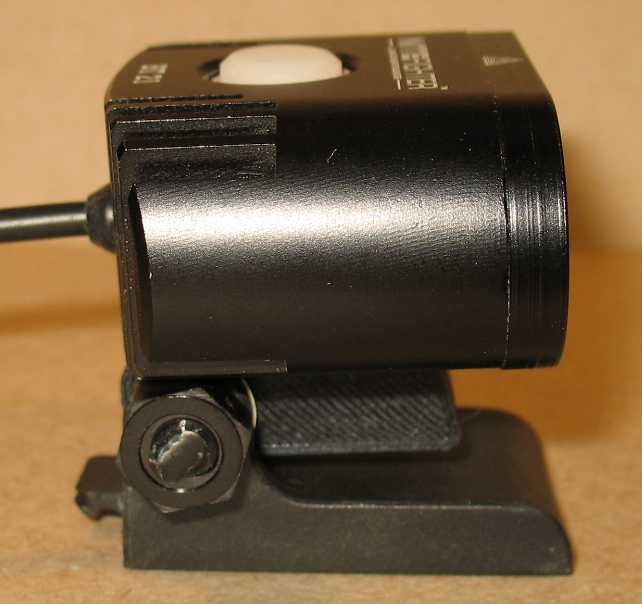

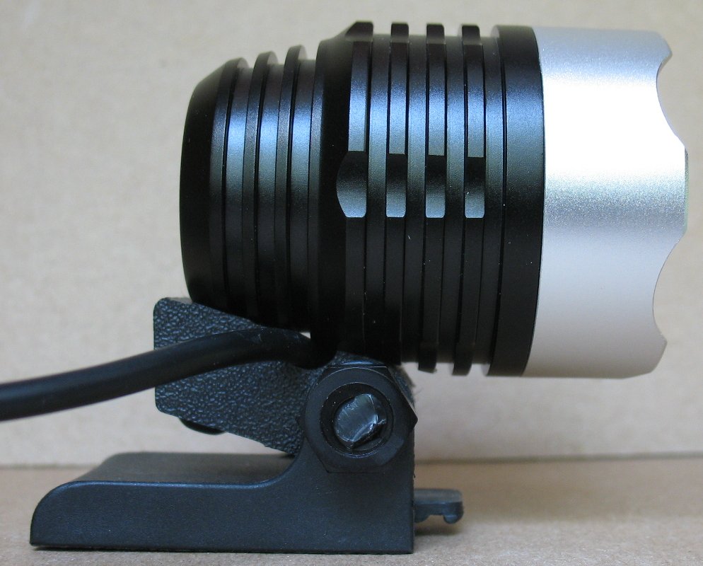

 | Starting on the left, the parts go together like this for the MS900 adapter Nut - Washer - Slide Mount - MS Adapter - Washer - Slide Mount - Nut

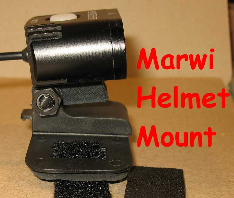

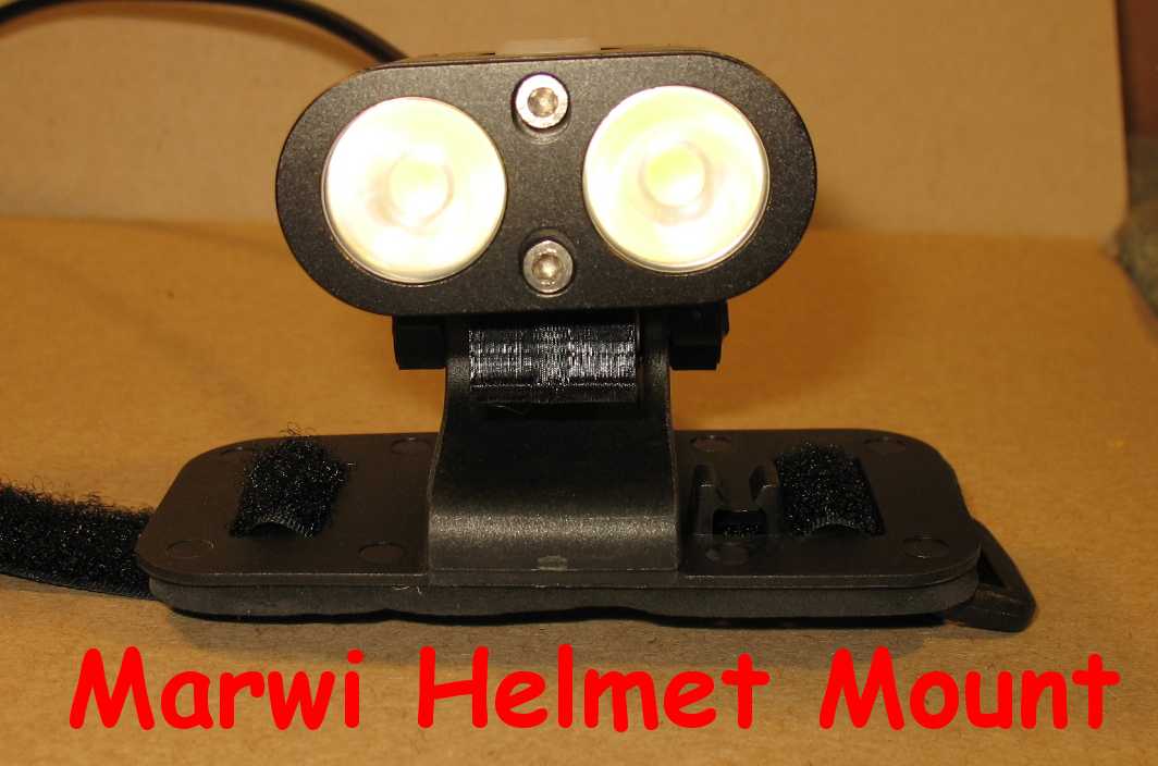

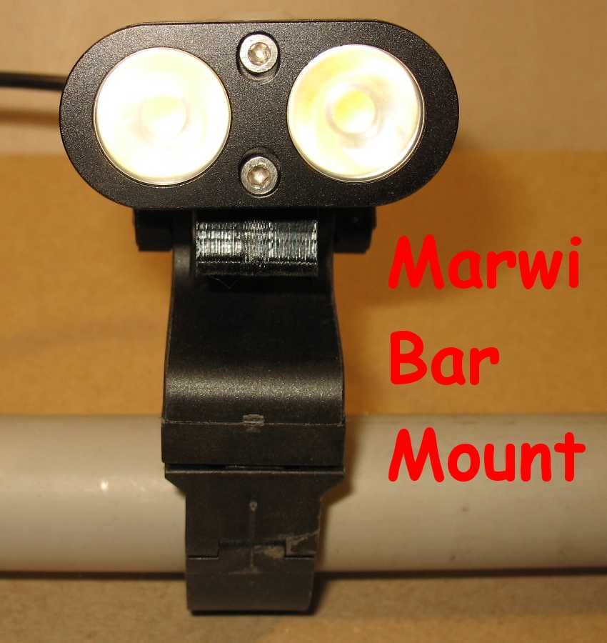

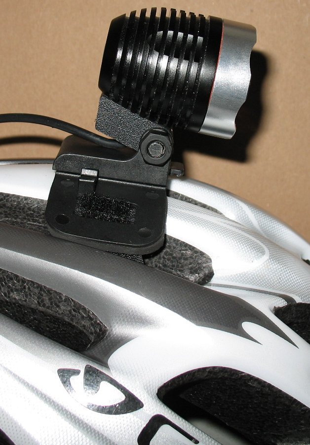

 Now you can slide your MS light onto your Marwi Helmet or Handlebar mounts

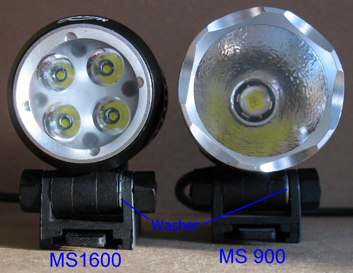

  | The section is for the MS1600 body style lights

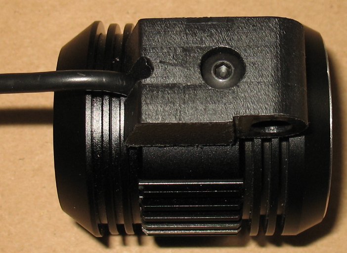

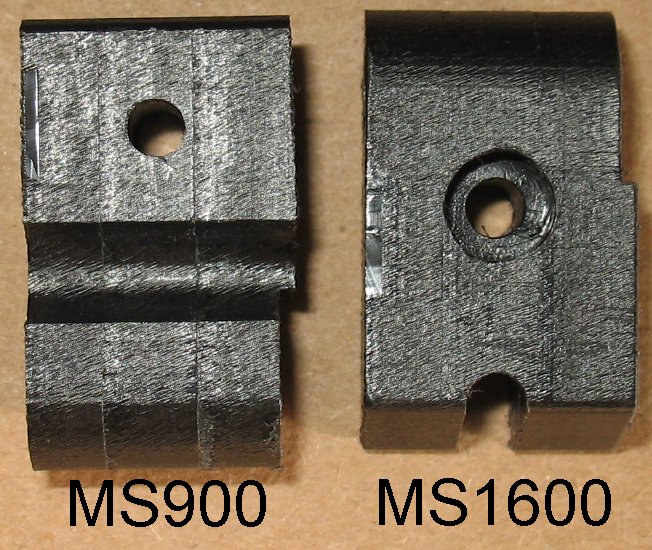

  | The cord and bolt are reversed compared to the MS900 type lights The cord exits at the back through a slot in the MS1600 type lights
 The Marwi adapter has a slot where the wire can exit

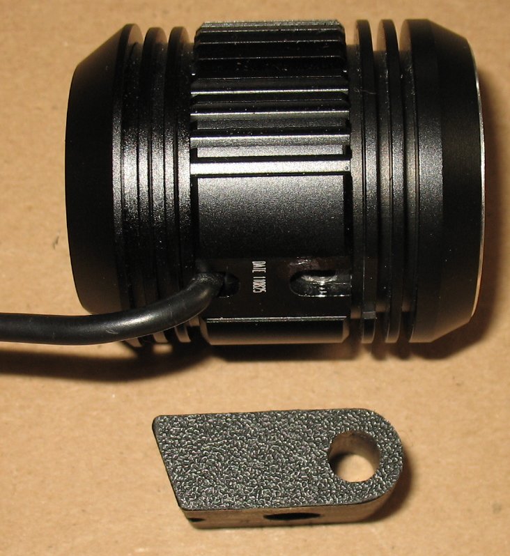

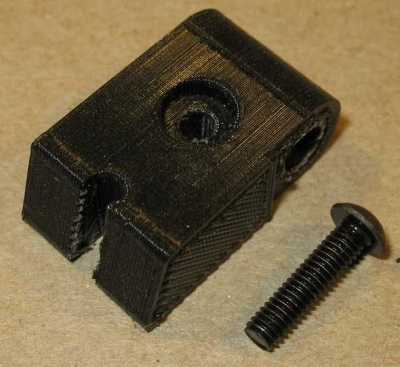

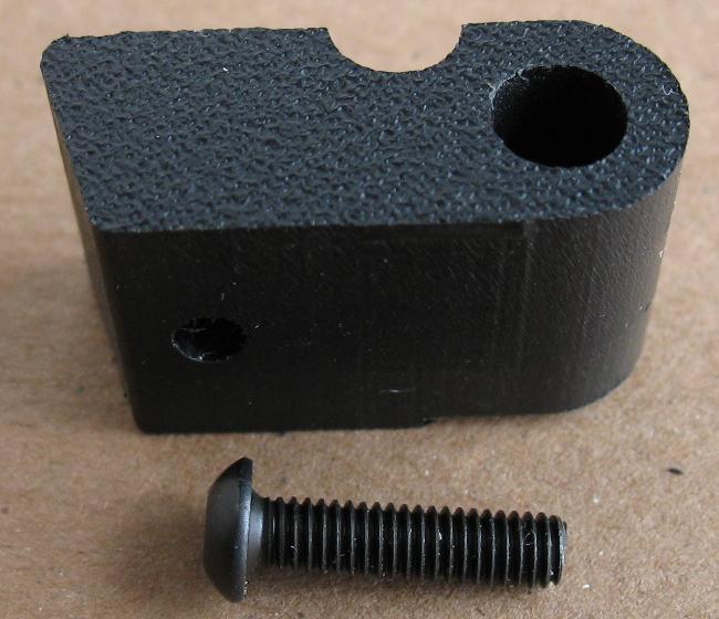

 | You will be replacing the stock mount with these parts |

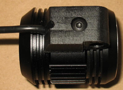

  | The bottom of the light looks like this with the original mount removed | Mount the adapter to the light using the supplied screw. Thread the screw into the body with a metric Allen wrench
 The power cord exits out the rear through the slot.
  | Attach the slide mount to the light using a Marwi Mount kit

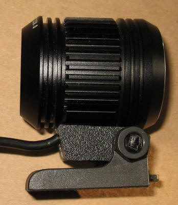

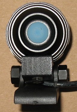

  | The section is for the BT21 type lights

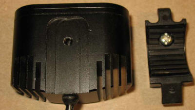

  | This is the NiteFighter BT21 body

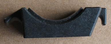

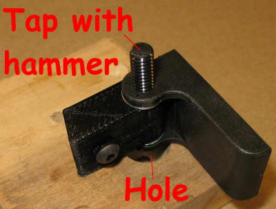

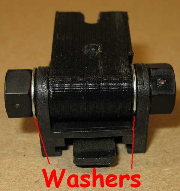

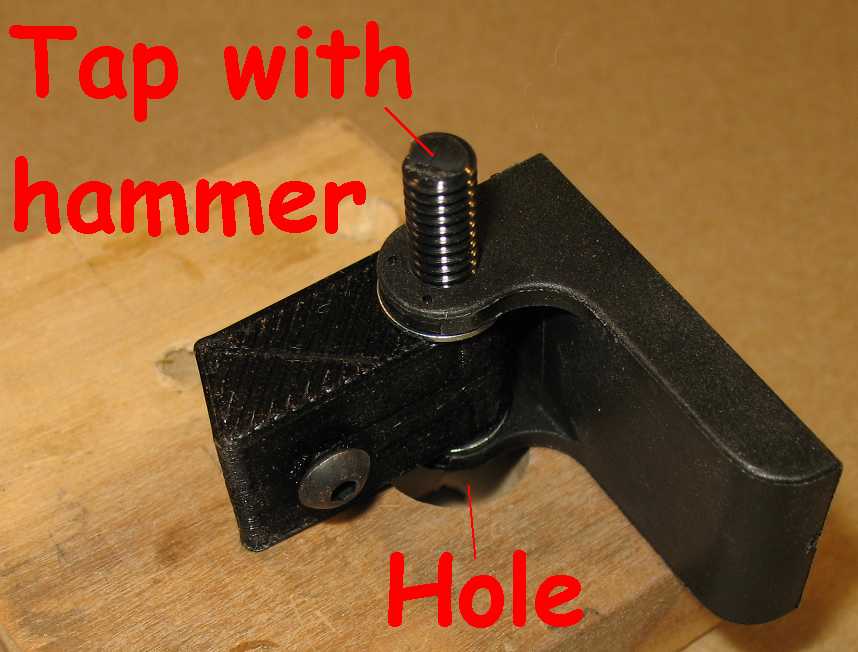

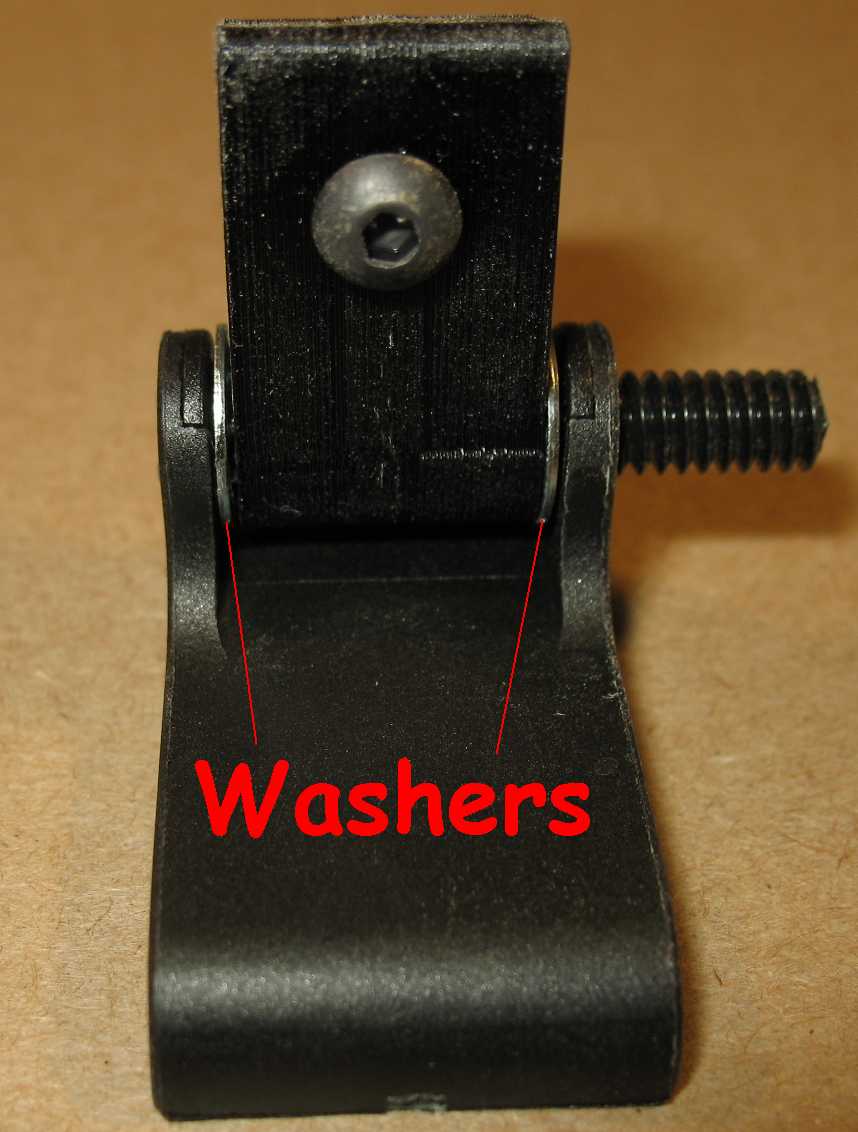

  | I found it is easier to assemble the slide mount without attaching the adapter to the light body

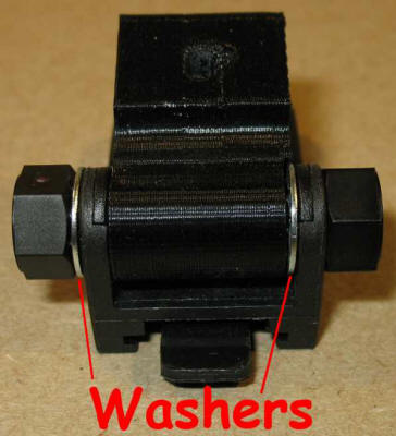

 The two washers go on the inside of the slide mount
 | If the Marwi mount kit bolt does not slide in easily, tap it lightly with a hammer.
 A wood block with a hole works great for this.

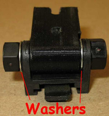

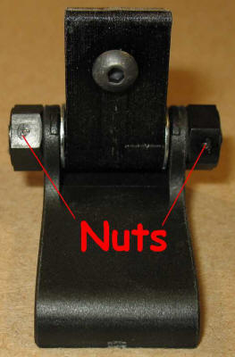

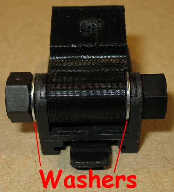

  | It looks like this once the bolt is in place The two washers go on the inside of the slide mount
 | Now thread on the nuts Don't tighten the nuts down yet.

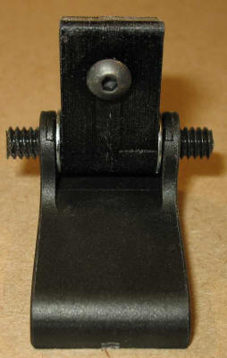

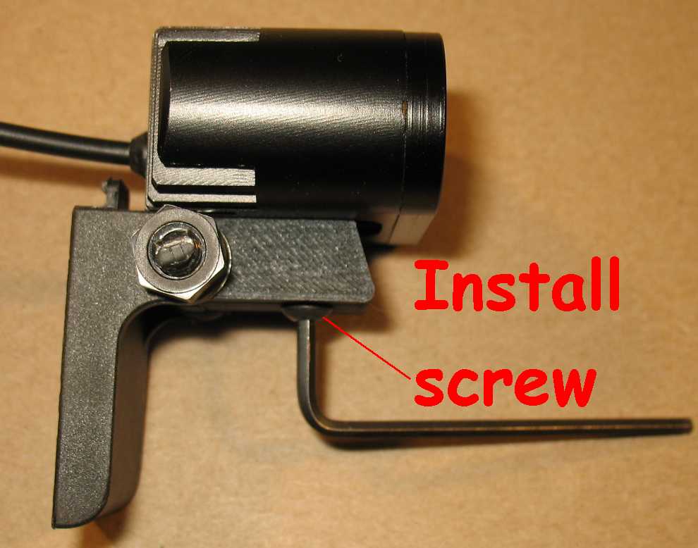

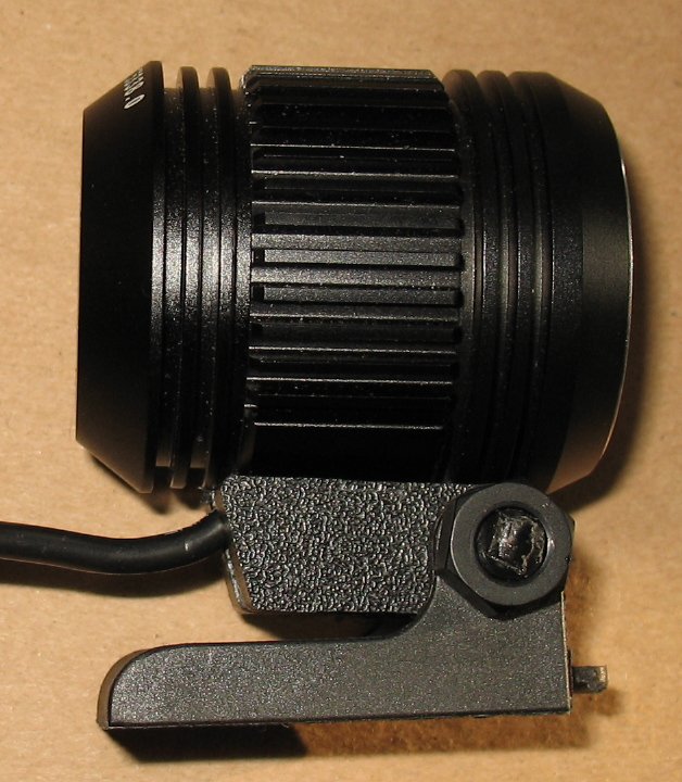

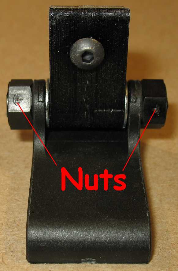

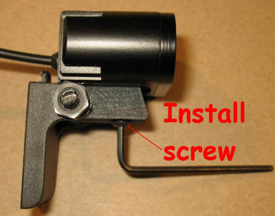

  | Swivel the adapter so you can get access to the screw head with a wrench Thread the screw into the body with a metric Allen wrench
 Tighten down the screw, but do not over tighten it.
 | Swivel the light down and then tighten the two nylon nuts Now you are ready to slide the light onto a
 Marwi Helmet or handlebar mount

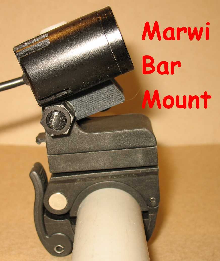

  | Marwi handlebar mount

  | Marwi helmet mount
 | Marwi helmet mount
