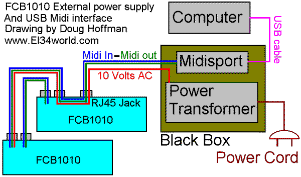

I am also adding a USB to Midi interface inside my FCB1010 power box
The power box will have a USB cable that will go to the computer
The USB Midi adapter wires will go to a RJ45 jack
The RJ45 jack will send and receive Midi info to and from the FCB1010's
So my power box not only makes 10 volts AC for the FCB1010's, it also sends and receives Midi data from the computer to the FCB1010's
Everything is in one small box

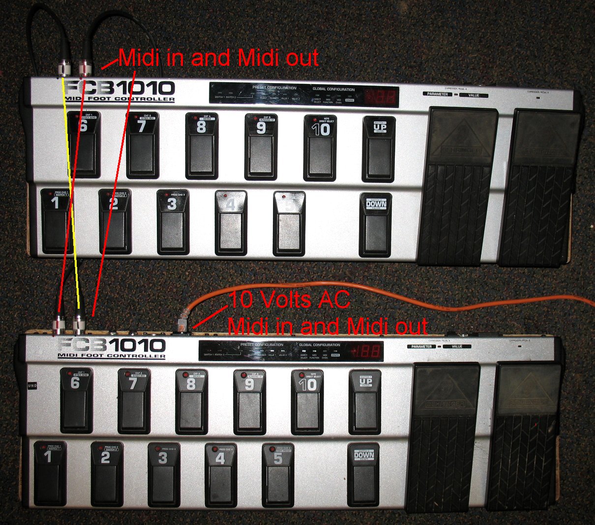

The image below shows just how clean my dual FCB1010 setup is now
Behringer FCB1010 image
One CAT5 network cable enters the bottom FCB1010
The network cable wires carry the 10 volt AC power, the Midi in and Midi out signals
The bottom FCB1010 has two short Midi jumper cables that connect to the top FCB1010
The bottom FCB1010 sends 10 volts AC to the top FCB1010 through two short the Midi jumper cables
The two short midi cables that join the two FCB1010's are hooked up like this:
Midi out/thru on the bottom FCB1010 goes to Midi in on the top FCB1010
Midi out/thru on the top FCB1010 goes to Midi in on the bottom FCB1010
Note that the bottom FCB1010 has the UNO chip and it has 5 stomp box pedals
That's the FCB1010 I decided to do the major mods to because it has already been modded
The top FCB1010 is a stock FCB1010 except for the simple power in wires I added
That simple mod is described further down this page

This simple diagram illustrates how the black box connects to the computer and FCB1010's

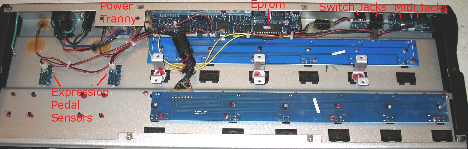

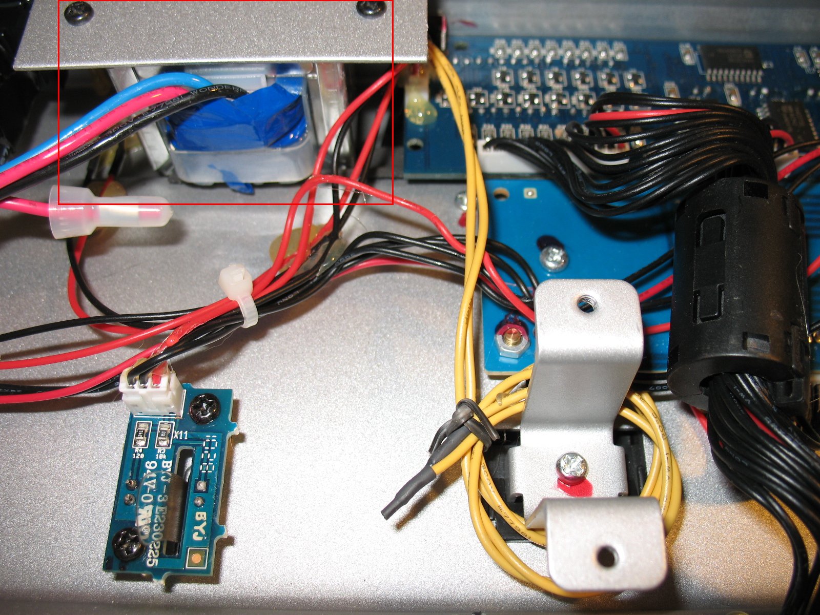

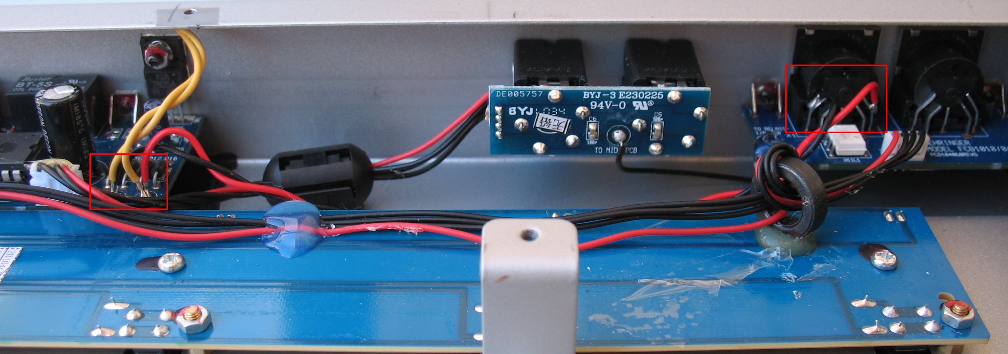

Full view of the insides of a FCB1010
The power transformer is on the upper left
There are two yellow wires that leave the power transformer and go to some diodes
The diodes rectify the 10 volts AC into DC
The Midi in and out jacks are on the upper right

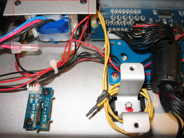

Behringer FCB1010
The image above shows the power transformer in the upper left
This is my #2 FCB1010 that receives power from the 1st FCB1010

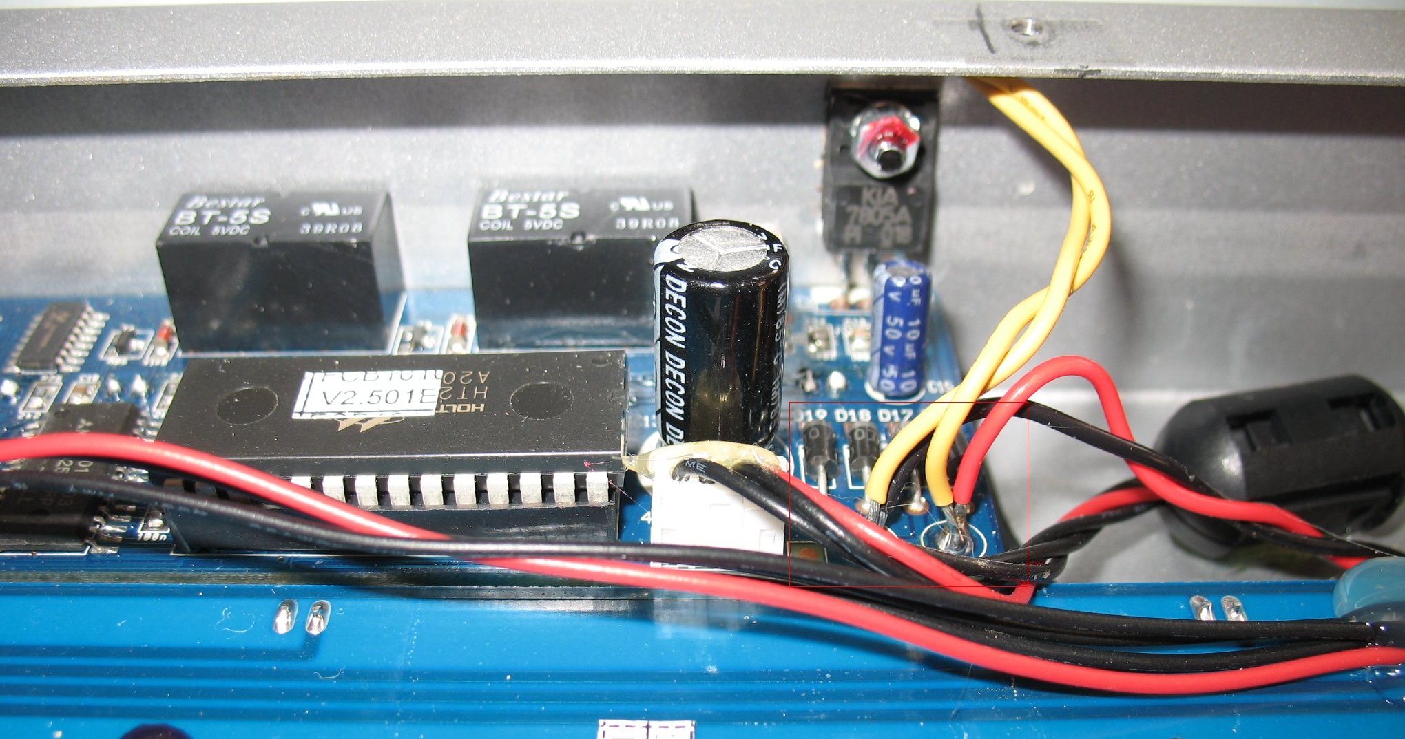

I have clipped the yellow wires from the diodes and heat shrinked them because I am going to use external power full time in this unit
Behringer FCB1010 image Behringer FCB1010 image
Left: In a stock FCB1010, the yellow wires from the power transformer go to 4 diodes.
The diodes rectify 10 volts AC into DC
Note that in this image I have added a red and black wire that are not part of a stock FCB1010.
The red and black wires are going to bring 10 volts AC to the diodes from an RJ45 jack
I will add another red and black wire so that I can send 10 volts AC to my second FCB1010 through a MIDI jack
The 2nd FCB1010 does not have to have a power jack because I can use two of the Midi cable wires

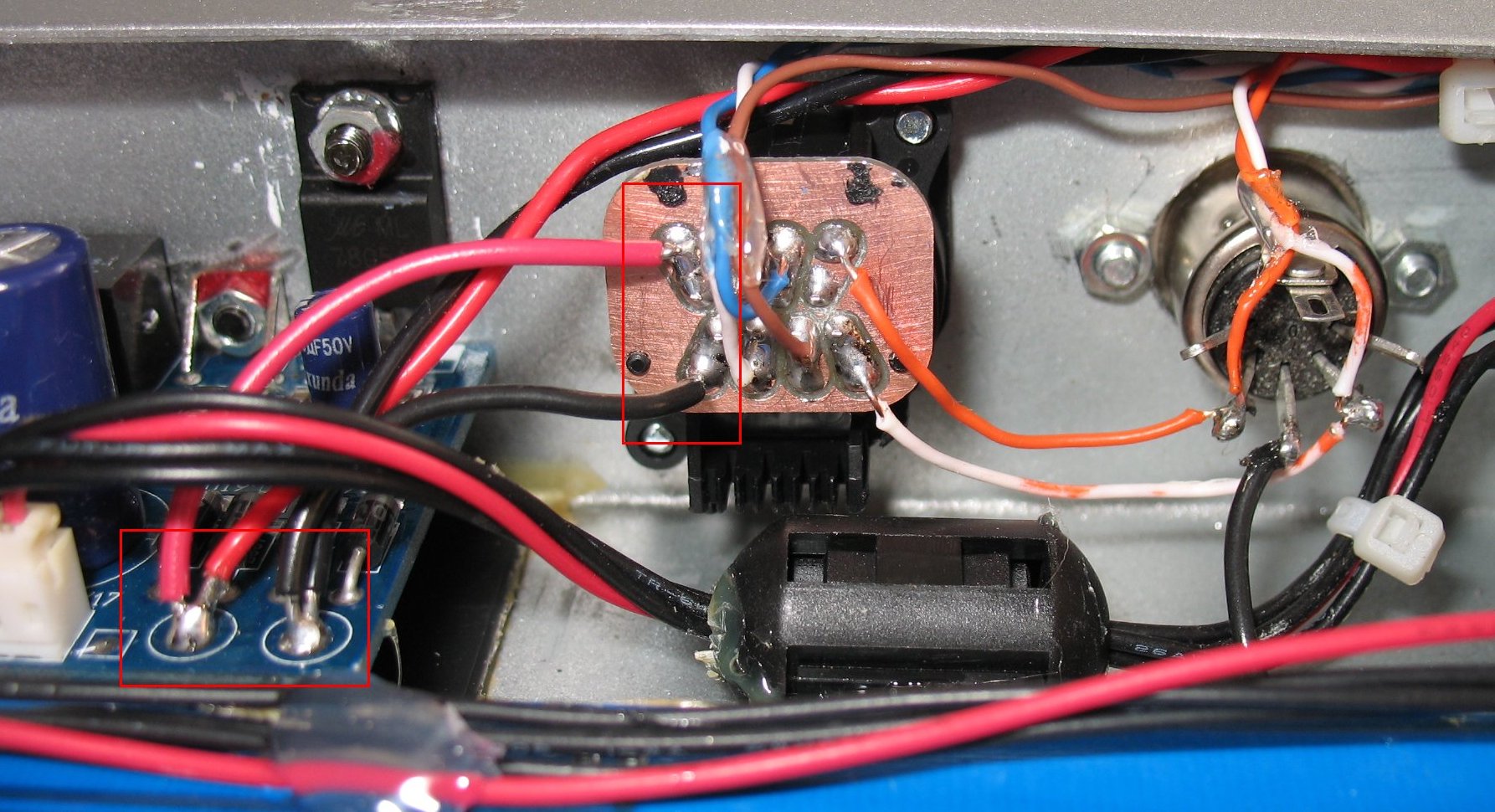

This is the FCB1010 that has the RJ45 input jack
The back of the RJ45 jack is shown in the center
It has a small copper PC board on it so you can make solder connections to the 8 wires
I have added a second pair of red and black wires to the diodes
One red/black pair goes to the RJ45 jack
The other red/black pair goes to the Midi in jack
A Midi cable will then carry 10 volts AC to the 2nd FCB1010
Ignore the silver colored Midi jack to the right of the RJ45 with the two orange wires
That is another experiment and is not part of my dual FCB1010 power mod

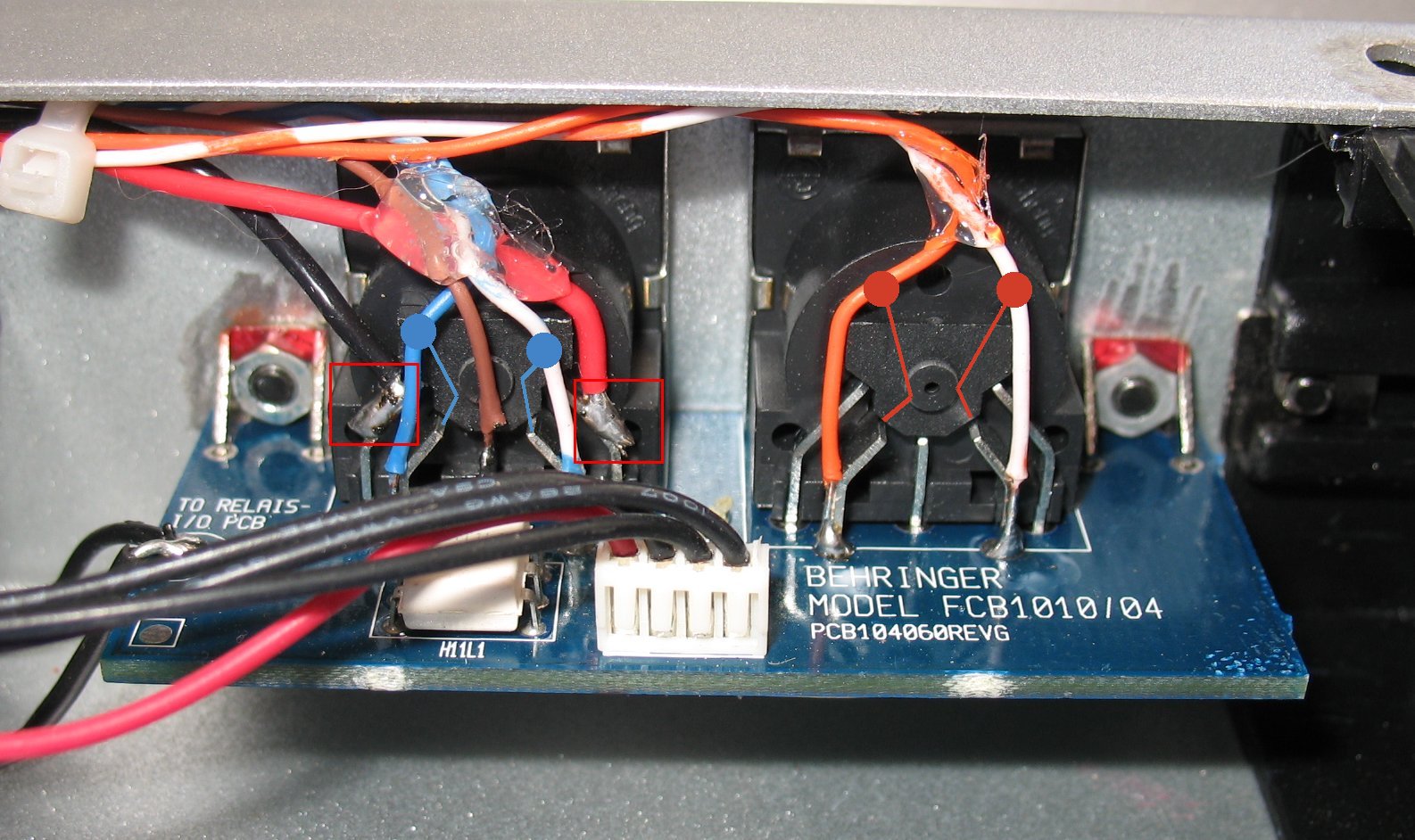

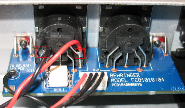

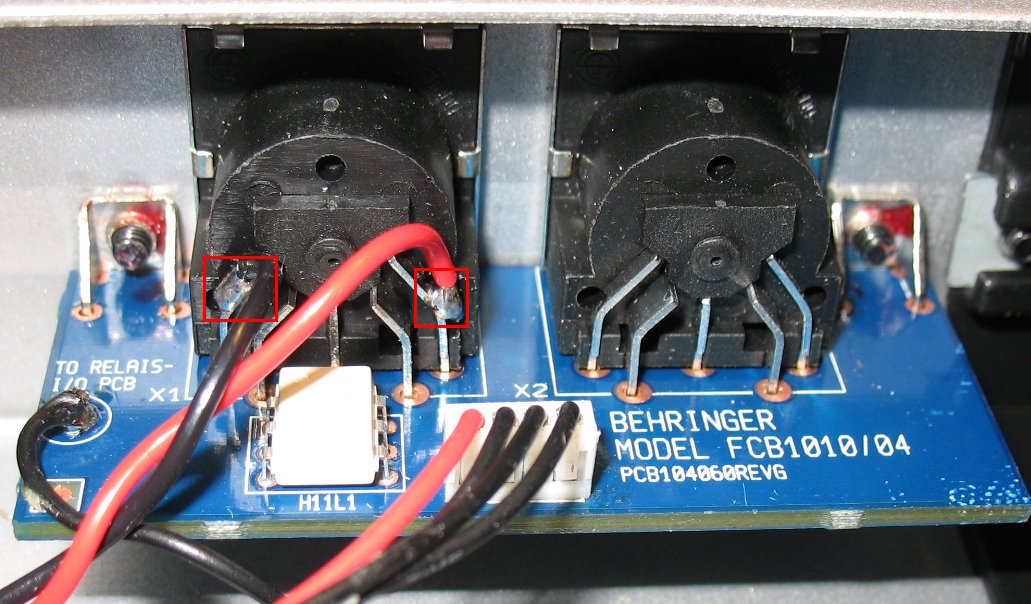

This is the #2 stock FCB1010 that will get power from the 1st FCB1010
The 10 volts AC comes in through a Midi jack and then goes to the diodes
The red boxes on the images show the connection points
If you look at the image above left you can see which to pins I am using on the Midi jack
Note that since this is AC, the wire connections do not matter
I only used red and black wire because that is what I had one hand
This is also how you would mod a single FCB1010 to use external power
I describe how to do that below

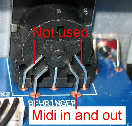

If you had only one FCB1010 and you wanted to bring in external power, this is how you would do it
You would use two wires inside a Midi cable to bring in the 10 volts AC
You use the two outside pins on the midi in jack
The other two pins are the Midi signal
Ignore the center pin, it is a ground pin that provides ground to the shield on the Midi cable

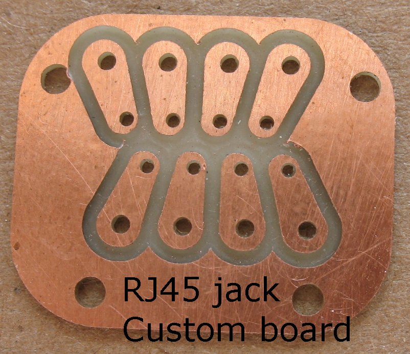

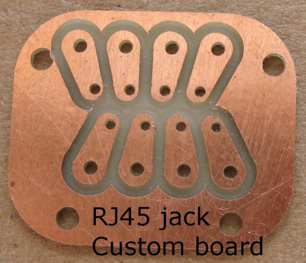

This image shows the custom RJ45 jack pc boards I made on my CNC machine
There were only tiny pc board pins on the jack and so I had to have a way to solder wires to those tiny pins

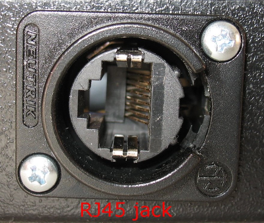

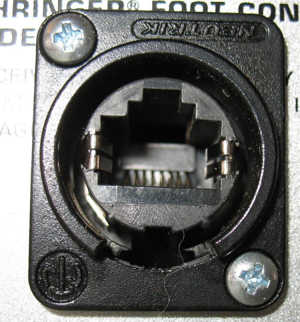

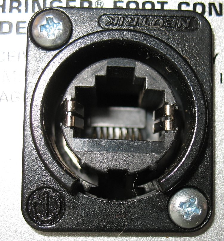

This image shows what the front side of the RJ45 Neutrik jacks look like
I used a step drill bit to cut a round hole in the FCB1010 chassis and then mounted the RJ45 jack

Left: This image shows the red/black power wires going to the outside pins on the Midi in jack
The connections to this jack are described further up this page
This image also shows the Midi in and Midi out wires that go to the RJ45 jack
The orange dots, lines and wires are connected to the Midi out jack
The blue dots, lines and wires are connected to the Midi in jack
Right: The orange and blue wire pairs on the Midi jacks go to the RJ45 jack

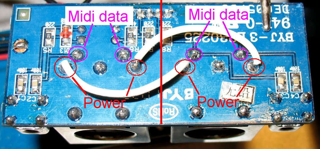

I also jumpered together the outside pins on the Midi in and Midi out jacks in the modded FCB1010 so that both jacks can send power
I did this on the underside of the Midi jack board because it was easier than adding more wires to the back of the jacks
The image above shows the underside of both Midi jacks
The two inside connections on each Midi jack are Midi data
The two outside connections on each Midi jack are used to supply 10 volts AC power

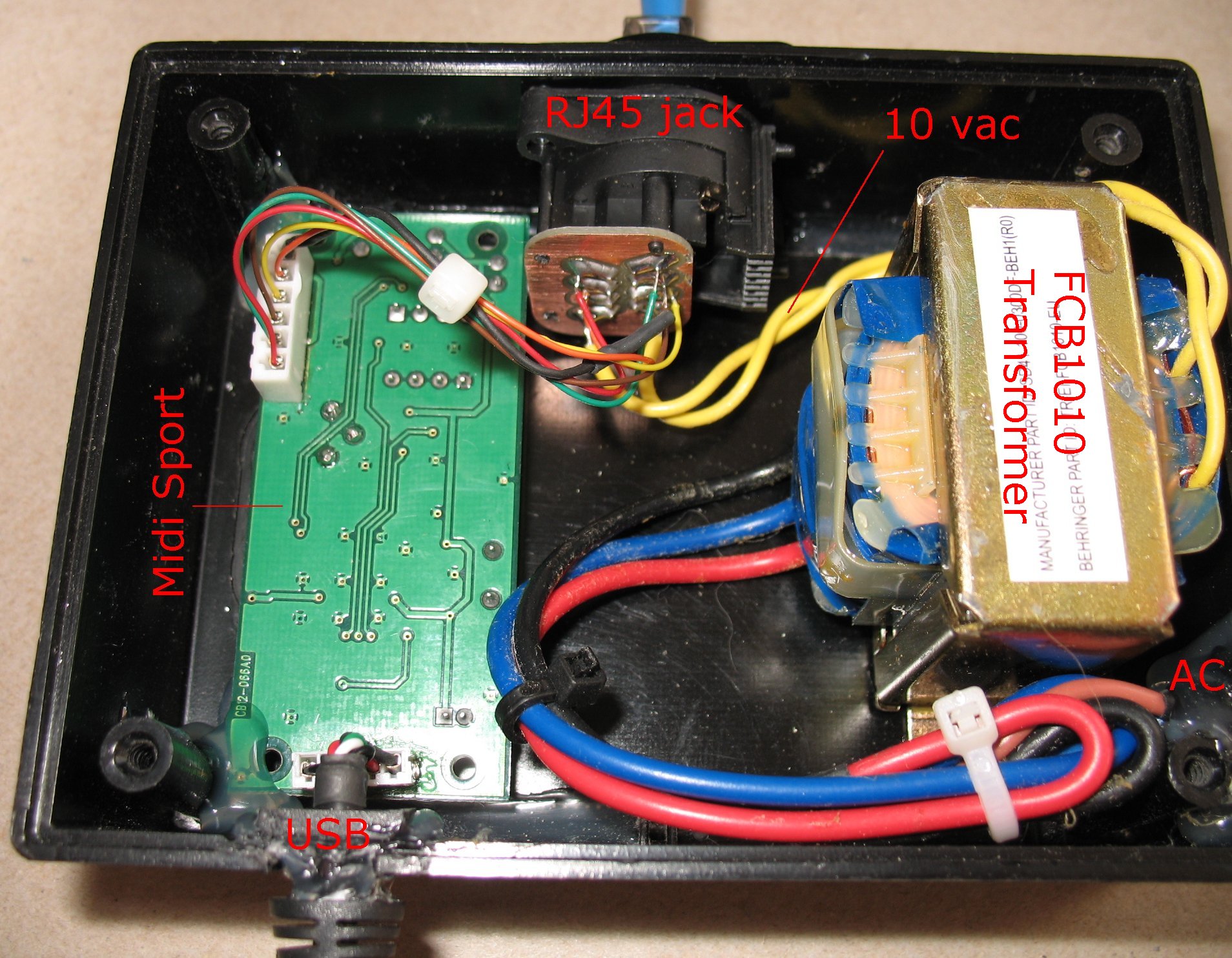

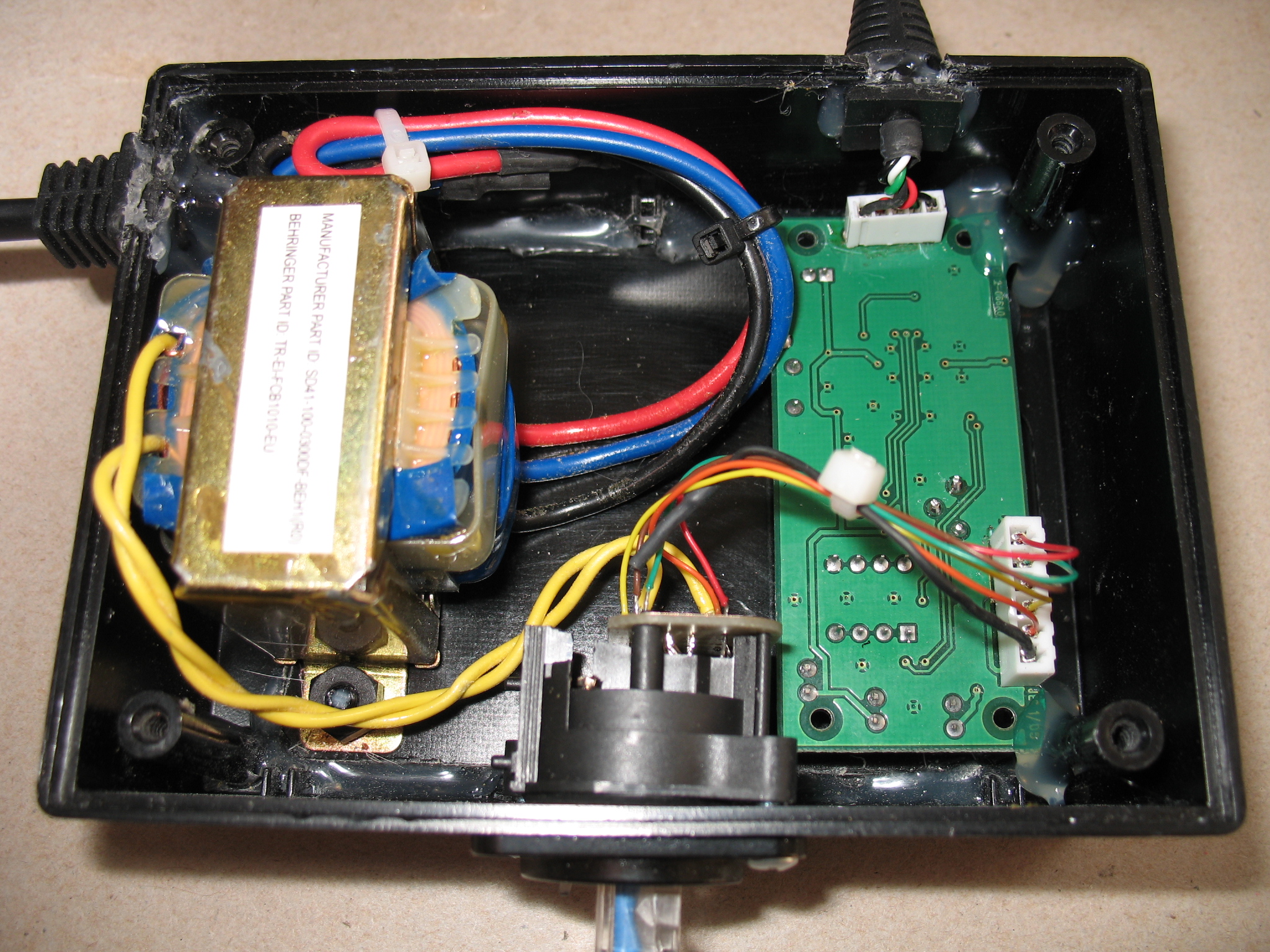

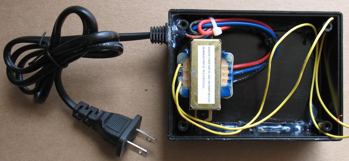

I mounted the FCB1010 power transformer in a black plastic box and added a small power cord
I used a step drill bit to make a hole for the RJ45 jack and mounted it on the side of the box

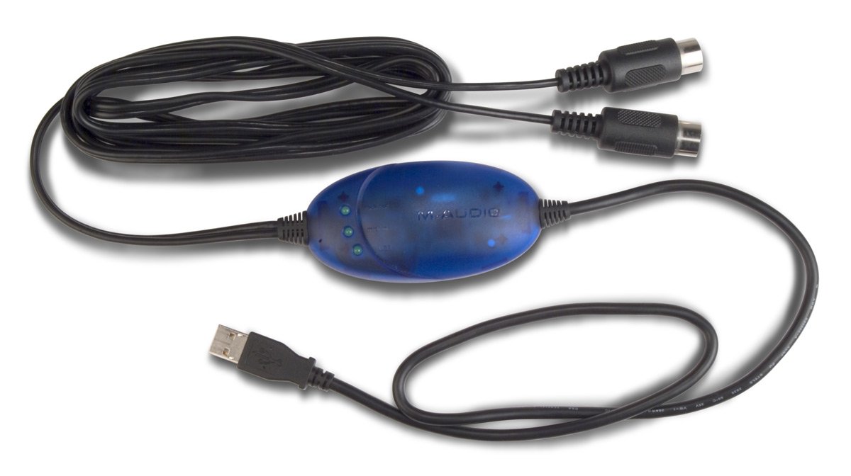

I dismantled a M-Audio USB Midi sport and mounted it in the box
A USB cable enters the box and goes to the Midisport board
The wires leaving the white connector on the USB Midisport go to the RJ45 jack to send and receive Midi from the FCB1010's

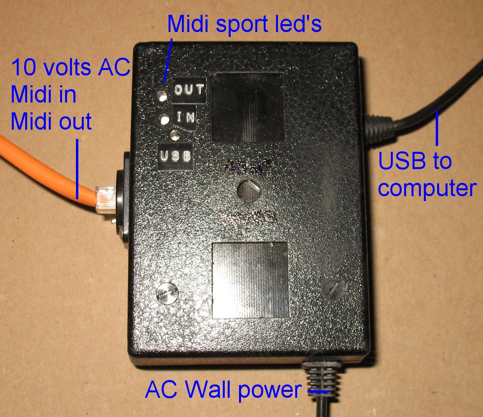

So now this little black box does all this:
It provides 10 volts AC to the FCB1010's via the RJ45 jack
It sends and receives Midi in and Midi out data to the FCB1010's via the RJ45 jack
It sends and receives Midi in and Midi out data to the computer through the USB cable

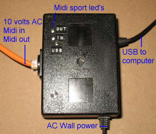

Here's the little black box
It used to be a surge suppressor in it's previous life
Note that I drilled 3 small holes so the LED's on the Midisport would be visible
The USB LED is lit up when the Midisport is connected to the computer
The in and out LED's light up when Midi data is being transmitted

This is the M-Audio USB Midisport interface that I installed in my black box
The blue cover comes apart quite easily
Use a multimeter to find out which pins on the circuit board are for Midi in and Midi out
The Midi plugs are labeled as in and out
If you use a beeping continuity meter you can touch a probe to a pin on a Midi jack and find that same pin on the circuit board
Write down the wire colors and info to make yourself a wiring map
Then you can map out those wires and connect them to the RJ45 jack in the black box
When the wires enter the FCB1010, you can then send them to the proper Midi jack on the FCB1010
Here's a Midisport link on the M-Audio web site
http://www.m-audio.com/products/en_us/Uno.html
