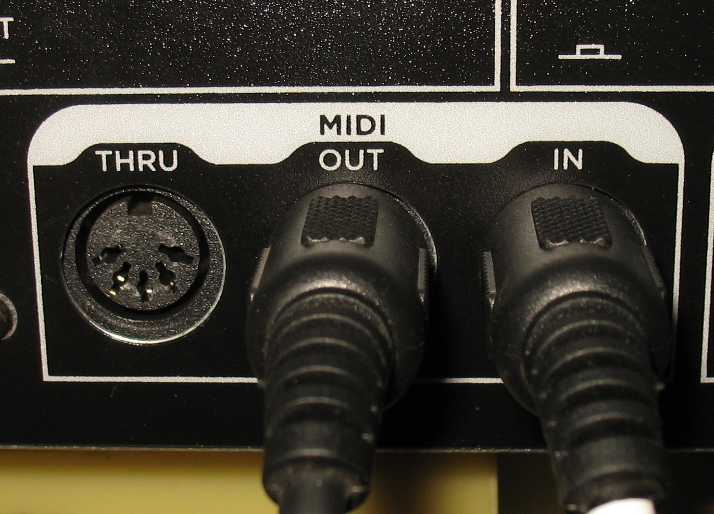

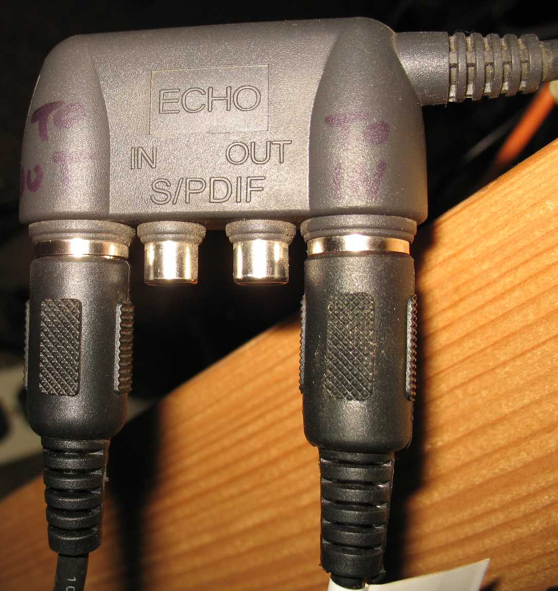

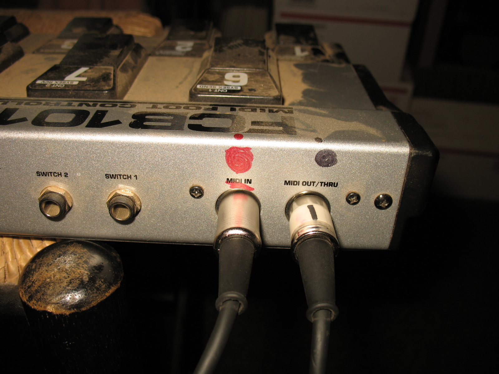

Step 3: Connect the FCB1010 to your Midi sound card or Midi device
You need to have a sound card or some other Midi device installed in your computer that has Midi in and Midi outs
You also need two Midi cables
Connect the Midi Out on your sound card to the Midi in on the FCB1010
Connect the Midi In on your sound card to the Midi out on the FCB1010
Note: Some of the Kemper Midi functions only work properly when you have two Midi cables connected

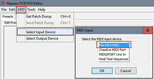

Start Ripwerx and choose your Midi input and Midi output devices
I am using a Mia Midi sound card as my Midi input and Midi output device
After you choose your input device from the list of installed Midi devices, then choose your Midi output device from the list of installed devices
If you don't see anything in your list, then you do not have a Midi device installed in your computer
Some sound cards may show up on the list that only have internal Midi connections and no external Midi connections
In my screen shot above, the Creative MIDI port device is a Soundblaster sound card with no external Midi ins and outs
There are pin headers on the Soundblaster card itself that I could connect to external Midi in and Midi out connectors

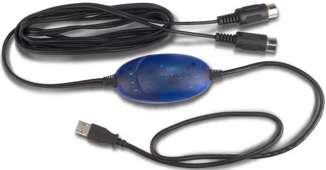

You can buy external devices that plug into your sound card internal connections and have external Midi in and outs
The Midisport UNO is a inexpensive USB Midi device that works very well
You can also buy inexpensive USB Midi devices like this M-Audio USB Midisport Uno MIDI Interface
FCB1010 Kemper programming - Ripwerx
This is a M-Audio USB Midisport Uno MIDI Interface

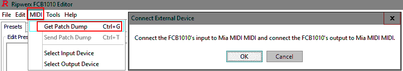

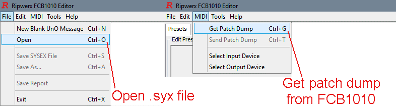

Now that you have your Midi device connected to your FCB1010 you are ready to start programming it
You can open an existing .syx file and edit it or you can do a patch dump from your FCB1010 to Ripwerx
A patch dump loads all the settings inside your FCB1010 into Ripwerx
Or you can just start with a blank slate and create something from scratch in Ripwerx
here's a .syx file you can download as a starting point
Kemper - FCB1010 - Ripwerx - SYSEX file link
This is the .syx file I am using on this page
The screen shot above also shows that you can save a .syx file to your computer or send a patch dump to your FCB1010
The save and send options are not selectable until you have loaded something into Ripwerx
Save SYSEX File and Send patch dump are grayed out in my screen shot because I have not loaded anything into Ripwerx yet

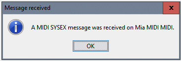

This screen shot shows the dialog box you get when loading a patch dump from your FCB1010 into Ripwerx
After the patch loads into Ripwerx you get the dialog box shown below
Then the Ripwerx Preset tab fills out with all the data that came from your FCB1010 patch dump

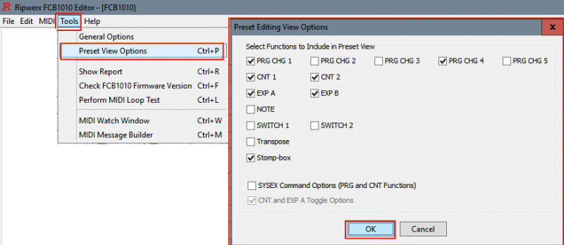

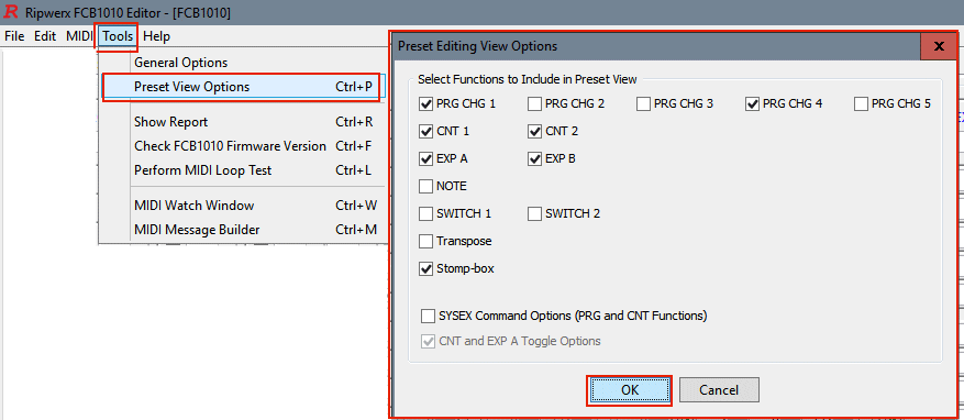

Set the Preset View options in Ripwerx
The big grid that opens up in Ripwerx will have way more columns than we need for this tutorial
Click on preset view options and check and uncheck the boxes shown in my screen shot above
These are all the columns we will need to program the FCB1010

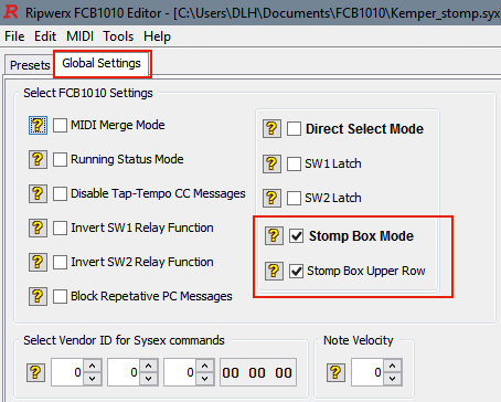

Set Ripwerx for stomp box mode
In the Global settings tab, check the stomp box mode boxes
I have my stomp box pedals set to the upper row, pedals 6 to 10
It will be easier to follow along on this page if you set your stomp box pedals to the upper row

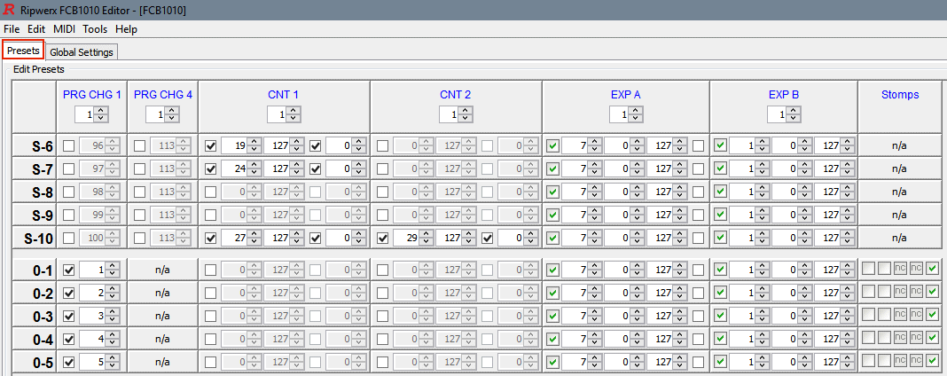

Now load a .syx file or get a patch dump from your FCB1010
This is what the Ripwerx preset tab looks like once you load a .syx file or receive a patch dump from your FCB1010
You can download this .syx file to use as a starting point
Unzip it and open it in Ripwerx
Kemper - FCB1010 - Ripwerx -SYSEX file link

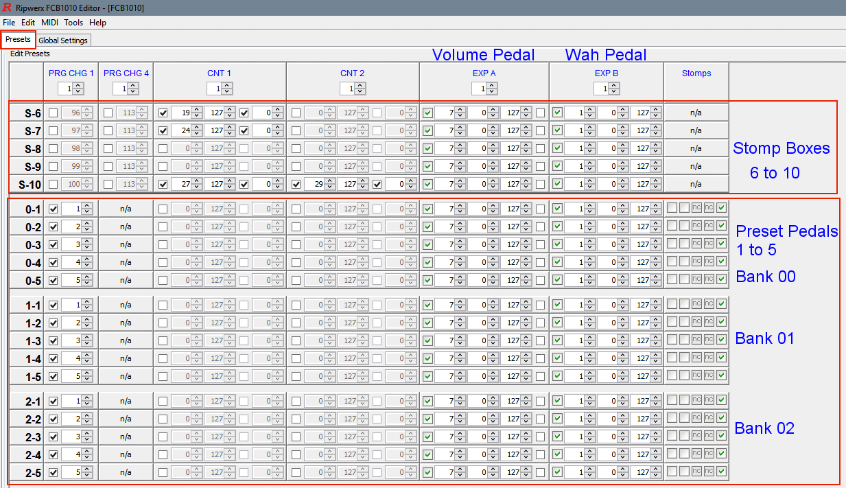

In the screen shot above, I have filtered out the columns I do not need to see
The stomp box settings are at the top of the screen
Banks 00 to 18 show up below the stomp boxes
I have my stomp box pedals set to the upper row on my FCB1010 which is pedals 6 to 10 on my FCB1010
Notice on the left side of my screen shot that the stomp box pedals are listed as S-6, S-7, S-8, S-9 and S-10

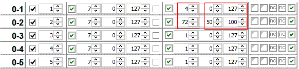

Pedals 1 to 5 are my preset selection pedals on my FCB1010

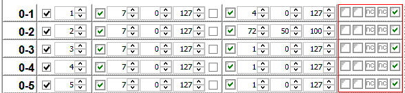

My preset pedals are listed as this in my screen shot
0-1, 0-2, 0-3, 0-4 and 0-5 for bank 00
1-1, 1-2, 1-3, 1-4 and 1-5 for bank 01
2-1, 2-2, 2-3, 2-4 and 2-5 for bank 02
And it keeps going all the way down to bank 18
So you have 5 preset selection pedals times 19 banks = 95 preset selection pedals total
Click on the image below for a larger image.

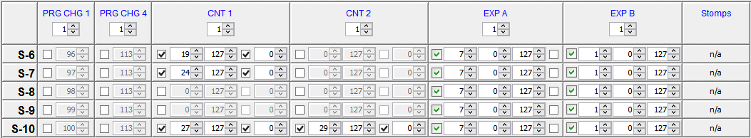

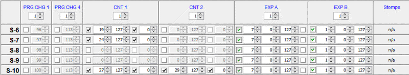

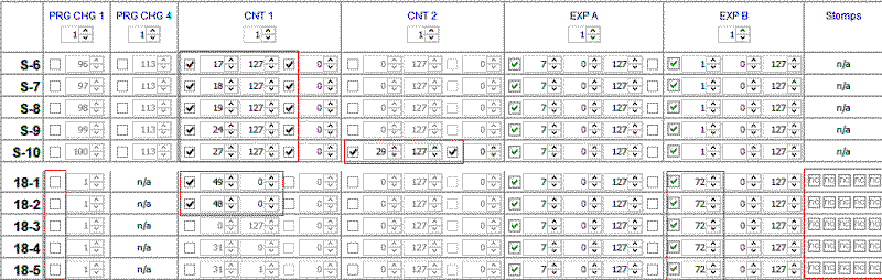

I'll explain the Stomp box section first
My FCB1010 Stomp box pedals are S-6, S-7, S-8, S-9 and S-10
Columns PRG CHG 1 and PRG CHG 4 are not used for stomp boxes
CNT 1 and CNT 2 are where we control what happens when you step on a stomp box pedal
EXP A and EXP B are the two expression pedals
Midi channel setting
You can ignore the numbers under each heading
This is the Midi channel that the FCB1010 will transmit on
The channel number automatically defaults to channel 1
The Kemper will listen to all 16 Midi channels, so this setting is not critical
You can set this to any Midi channel you like if you need to use specific Midi channels
Refer to the Kemper manual for more info on Midi channels.

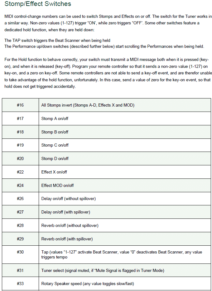

Refer to the Kemper Stomp/Effects image down below and the image up above as I explain this section

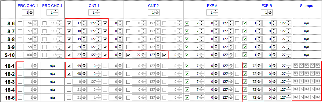

S-6 stomp box pedal is set to send CC 19 with a Value of 127 when it is stepped on the first time
CC 19 is Stomp Box C on/off in the Kemper
S-7 pedal is set to send CC 24 with a Value of 127 when it is stepped on
CC 24 is Effect MOD on/off in the Kemper
S-10 pedal is set to send CC 27 with a Value of 127 when it is stepped on
S-10 will also send CC 29 with a value of 127 at the same time
CC 27 is Delay on/off with spillover in the Kemper
CC 27 is Reverb on/off with spillover in the Kemper
Notice that I am able to turn Delay and Reverb on and off with one stomp box pedal
Pedals S-8 and S-9 are set so that they do not send any CC numbers when they are stepped on
I am not using stomp box pedals S-8 and S-9 in this tutorial
notice that the Expression pedals are still active for S-8 and S-9
The Expression pedals boxes are checked for all 5 stomp box pedals
More info on the expression pedals in the sections below

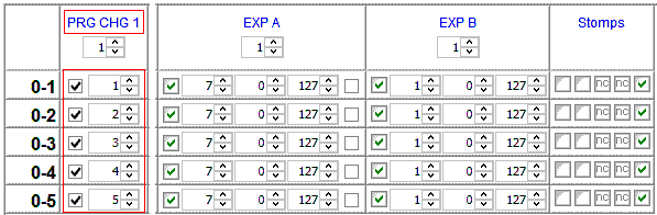

How to make the FCB1010 stomp box pedals toggle switches

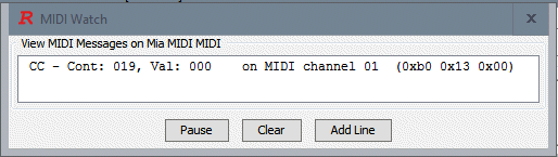

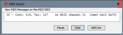

The check marks to the right of the CC 127 values make the FCB1010 stomp box pedals into toggle switches
When you step on a stomp box pedal once it sends the CC number and a value of 127
The effect is turned on in the Kemper and the stomp box pedal LED comes on
Any value you send above 0 means on
When you step on the same pedal again it sends the CC number and a value of 0
 The effect is turned off in the Kemper and the stomp box pedal LED goes out
So now you have stomp box pedals that are toggle switches and the LED's on the pedals show the true on/off state
If you do not make the stomp box pedals toggle, they will only send on commands
That means you can only turn on the effects in the Kemper
You would not be able to turn them off with a stomp box pedal on the FCB1010
So make sure you make your FCB1010 stomp box pedals toggle switches

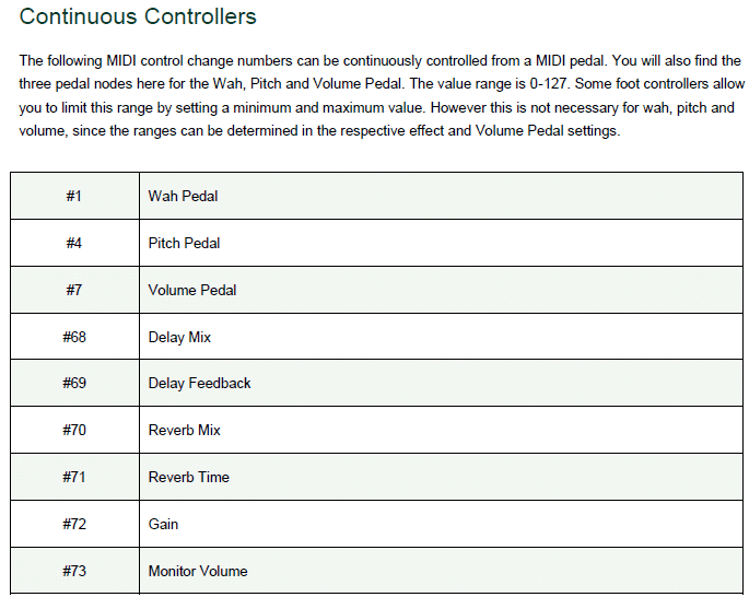

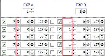

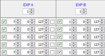

Now look at the Kemper Continuous Controllers diagram down below the Stomp/Effects diagram
EXP A is set to 7, which is Volume pedal in the Kemper
EXP B is set to 1, which is Wah pedal in the Kemper

Kemper Stomp/Effects diagram from the Kemper manual
Edit CNT 1 and CNT2 to control Kemper effects
The numbers in red are the CC numbers you would edit in order to turn on and off effects in the Kemper
Use the Kemper chart above for reference
In my example, I am using 27 and 29, Delay and Reverb
Use any numbers in the Kemper chart above to control the Kemper effects
Kemper Continuous Controller diagram from the Kemper manual
The numbers in the Kemper chart above are what you would use to make the expression pedals control different things
Note that I have my expression pedals set for Volume pedal 7 and Wah pedal 1

The 0 and 127 numbers to the right of the controller numbers are the value range that the expression pedal will send
The info below assumes you have already calibrated your expression pedals
See the info further up this page if you have not calibrated your FCB1010
When the expression pedal is all the way off (heal down), it will send a value of 0
When the pedal is all the way on (toe down), it will send a value of 127
All the values in between 0 and 127 get transmitted as the pedal is pushed heel to toe
You can set the sweep range of each expression pedal by changing these numbers
Lets say that you liked how an effect sounded at the range of 25 to 100
Below 25 was not usable and above 100 was not usable
Set the values to 25 and 100 and see how the effect sounds
Edit the two values until you have the sweep/range dialed in
The image below shows my Wah pedal set for 25 minimum and 100 maximum

Editing the FCB1010 preset pedals
I edited the image above to only show the sections we need to set up the FCB1010 preset selection pedals
PRG CHG 1 is where you set the preset number you want when you step on a preset pedal
Check the boxes to make a FCB1010 pedal active and then enter a preset number
In my example above, this is bank 00, pedals 1 2,3,4 and 5
When I step on FCB1010 pedal 1, it sends program change 1 to the Kemper
Whatever profile you have set to Midi program change 1 in the Kemper will then be called up and active
Make sure you check the boxes or nothing will be sent when you step on a preset pedal
I already explained how the Expression pedals work further up the page
The cool part about editing each preset individually is that you can call up a preset and have the expression pedals do different things for each preset
In my example above every preset has a Volume pedal (7) and a Wah pedal (1)
In the example below,  preset #1 has a volume pedal (7) and a Pitch pedal (4)
Preset #2 has a Volume pedal (7) and a Gain pedal (72)
Notice that I also set the range on the gain pedal (72) so that the sweep was from 50 to 100
Editing what the FCB1010 stomp box pedals do when you change a preset
The section in red on the right side shows what will happen to each stomp box pedal when you call up a preset
Each box represents stomp box pedals 6,7,8,9,and 10 on the FCB1010
A green check means to turn on that stomp box pedal
Nothing in the box means to turn off that stomp box pedal
nc = No change, do nothing
So in the diagram above, starting from the left side
Stomp pedal 1 = Turn off
Stomp pedal 2 = Turn off
Stomp pedal 3 = Do nothing
Stomp pedal 4 = Do nothing
Stomp pedal 5 = Turn on
The LED's on the Stomp box pedals will go on and off also showing the true on/off state of the pedal
The reason you want to turn pedals on or off as you change a preset is that you may have turned a pedal on in one preset and do not want it on in another preset
So for example, you kicked in a gain pedal in one preset, now you change presets and want that gain pedal turned off
The green checks in my example above is stomp box pedal 5
I have this set for Delay and reverb in my FCB1010 and I use that on just about every preset
I want Delay and reverb to turn on when I change presets
The LED's on the FCB1010 pedals also go on and off when you issue these commands
So you can look down and see what stomp box pedals are on or off

Midi Tab - Send Patch Dump to the FCb1010
You should already be connected to the FCB1010 via two Midi cables
You get this reminder dialog box - click on OK to continue

If the patch dump went well, you get this dialog box
Your patch dump download to the FCB1010 was successful

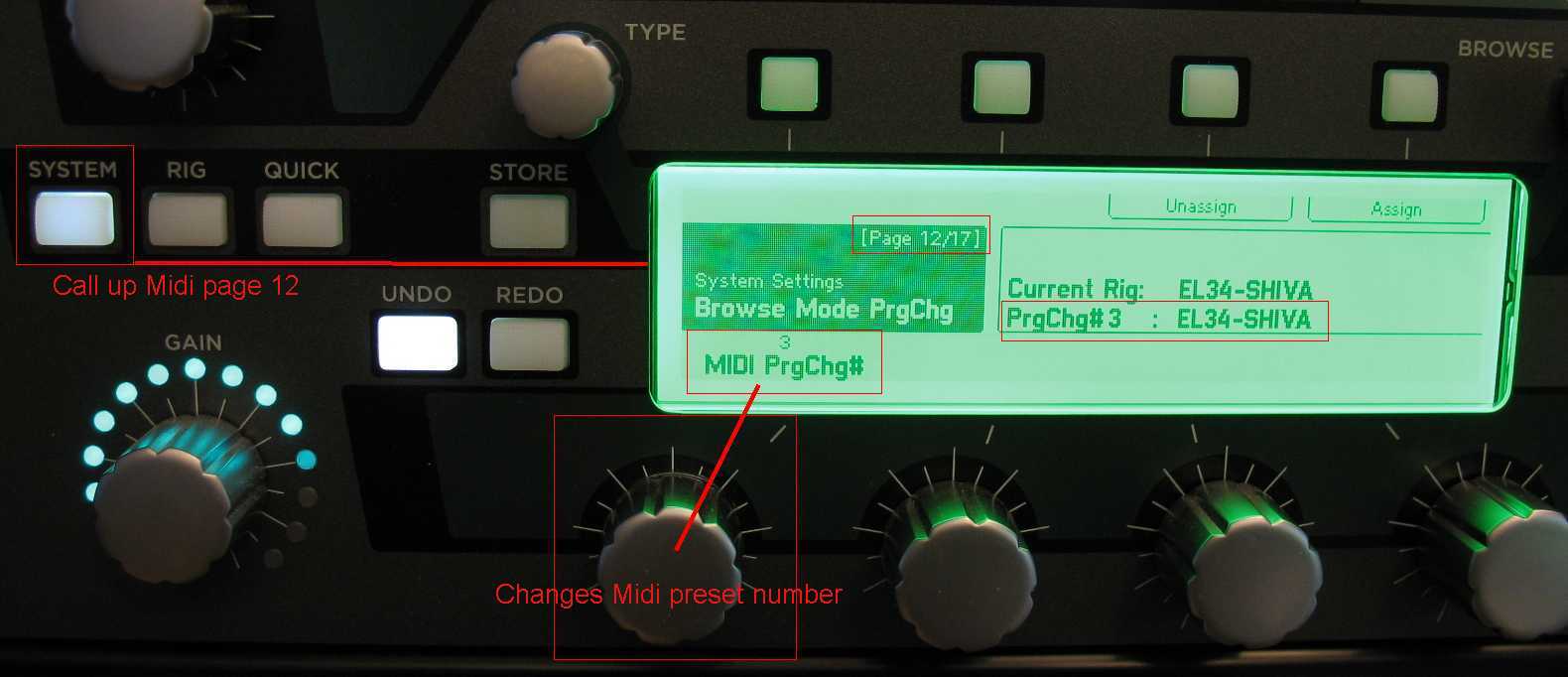

How to set the Midi program change number in the Kemper
As you are viewing a profile on the Kemper, press the System button on the left
Use the page buttons to go to page 12
Turn the knob shown in the image above to change the Midi Program Change number
Press the store button to save your changes
You may have to press store twice if the Midi numbers do not save
Press the exit button after the Midi program numbers have been saved successfully

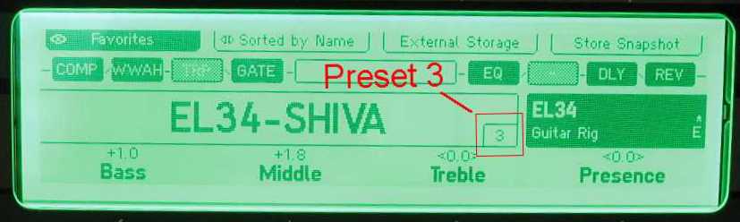

Now when you are viewing the profile in the Kemper, the Midi number will show to the right of the profile name
In the example above EL34-Shiva profile is assigned to Midi program change 3
When you step on a preset pedal on the FCB1010 that is assigned to program change 3, the Kemper will change to whatever profile is set to program change 3
And all of the stomp box/effects changes you programmed will happen also in the Kemper

Connect two Midi cables from the FCB1010 to the Kemper and test the stomp box pedals and preset pedals
To re-edit your FCB1010, go to Ripwerx and load a saved .syx file or get a patch dump from your FCB1010
Go back up this page for editing instructions in Ripwerx

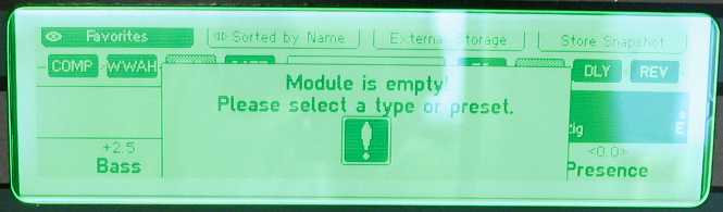

If you change a preset and tell the Kemper to turn on a stomp box or an effect and nothing is loaded into that slot, you will see this error message
It will go away after a couple seconds
In the example above, I sent a command to turn off MOD, the effect slot to the left of delay
There was nothing loaded into that slot and so I got the error message

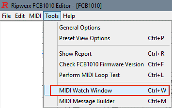

Use the Ripwerx Midi watch window to see what Midi commands your FCB1010 is sending
In this example, I stepped on preset pedal 1 on the FCB1010
The FCB1010 sent program change 001
It also sent all my stomp box commands and the values at the same time
The LED's on the stomp box pedals turned on or off according to what I programmed
This is what happened in the Kemper
The Kemper switched to the profile that was assigned to Midi program change 1
CC 19 was switched off
CC24 was switched off
CC 27 was switched on
CC 29 was switched on
In this example, I stepped on Stomp box pedal 6 on my FCB1010
You can see that the FCB1010 sent CC 19 value 127
This turned on Stomp C in the Kemper
The LED on FCB1010 stomp box pedal 6 lit up
In this example, I stepped on Stomp box pedal 6 again
The FCB1010 sent CC 19 value 0
This turned off Stomp C in the Kemper
The LED on FCB1010 stomp box pedal 6 turned off

How to step through profiles - down one profile or up one profile at a time
Look at bank 18 - Pedals 18-1 and 18-2
The PRG CHG 1 check boxes are unchecked
18-1 is sending a CC number of 49 and a value of 0
18-2 is sending a CC number of 48 and a value of 0
CC 49 value 0 = Go down one profile in the Kemper
CC 48 value 0 = Go up one profile in the Kemper
This will step up or down one profile at a time in the Kemper
Hoe to Control the Kemper Gain knob with an expression pedal
Notice that EXP B has been set to 72 for 18-1 through 18-5
a value of 72 controls the Gain knob in the Kemper
Also notice that the Stomps on the far right are all set to nc
If set any of the stomps on the far right are set to on or off,  the stomp box settings at the top will override the Expression pedals settings when you step on 18-1 or 18-2
So the stomps for 18-1 and 18-2 are set to nc = no change
No change will not trigger a stomp box setting
If you did not set these to nc, EXP B would still be set as a 1, which is a Wah pedal
As it is, EXP B will be set to 72, which is the Kemper gain knob
