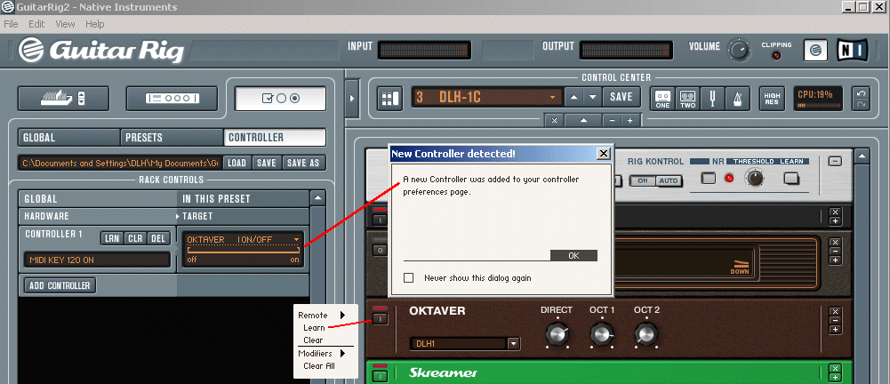

Here's how I turn on and off my Octavia using pedal #6/Stomp Box #1 on the FCB10101.
* Right click your mouse on the Octaver on/off button.
* A small dialog box opens up.
* Choose, Learn
* Now press footswitch pedal #6/Stomp Box #1 on the FCB1010.
* A bigger dialog box opens up saying that a new controller has been detected.
* GR2 adds the new controller to the list of controllers on the left side of the screen.
In this case, the new controller found is Controller #1, Midi key 120 ON.
You can see on the right side of the controller target area that it now controls Oktaver ON/OFF.

You can set parameters for the controller on the right side target area by moving the sliders. See the off----on sliders under OKTAVER ON/OFF in the image above.
You can also set up components by left clicking on top of the right side controller target area. All the components in the current preset show up in a window.
