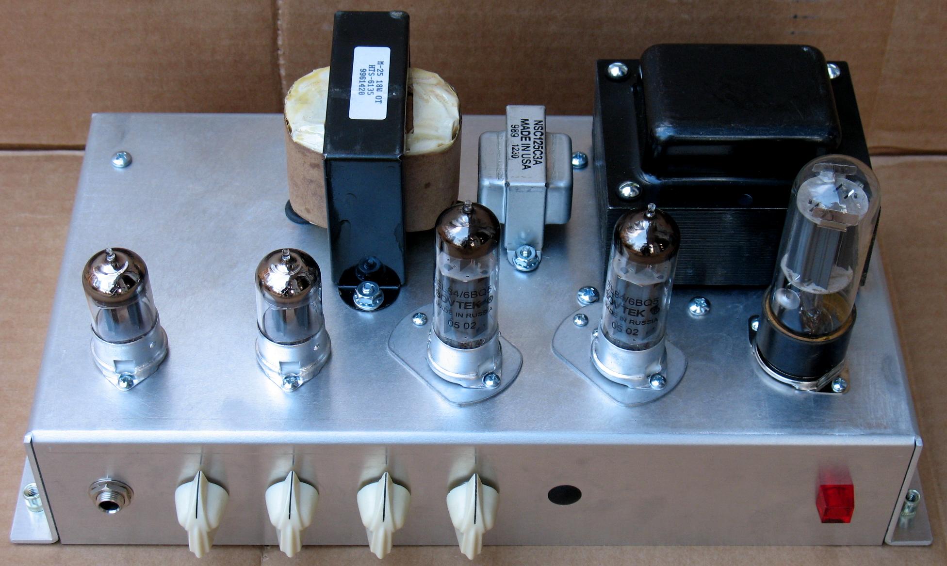

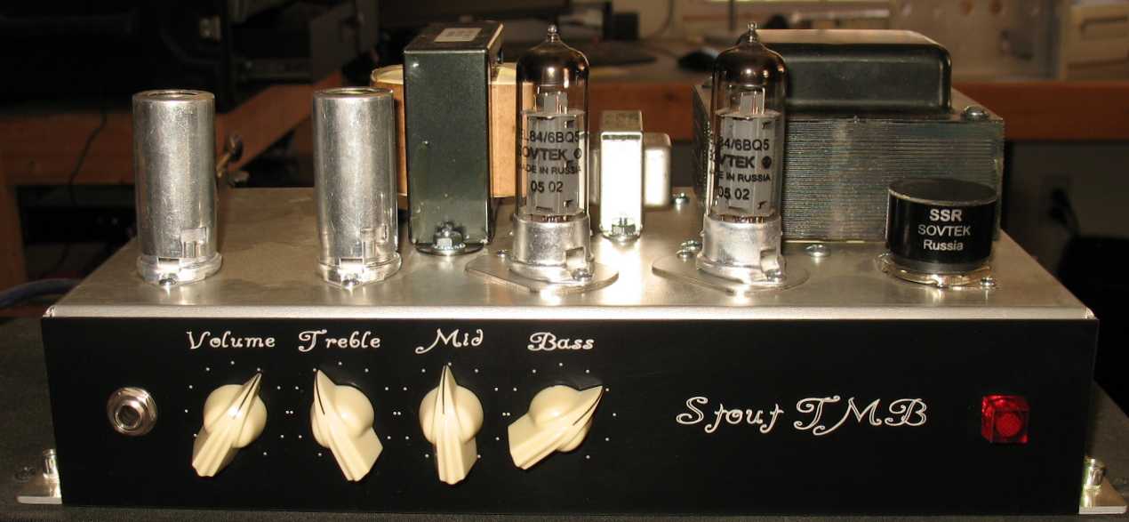

An updated picture of my Stout TMB with a faceplate
I made this faceplate on my CNC machine
I do not make faceplates for sale because it is a huge time consuming process
I have to say that because people are going ask me to make them a face plate
Hoffman Stout TMB
This is the updated 18 Watt Stout TMB (Treble-Mid-Bass)

I am using the Hoffman Stout Chassis found on this page - Page Link
The transformer set the Heyboer 18 watt PT and OT, plus a 125C3A choke - Page Link
The tubes are EH 12AX7's, Sovtek EL84's and a Sovtek 5Y3 rectifier - Page Link

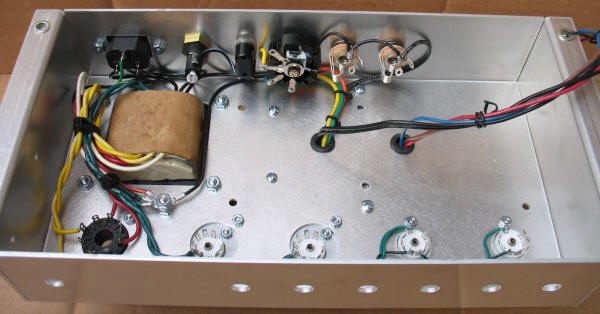

Some detail about the chassis

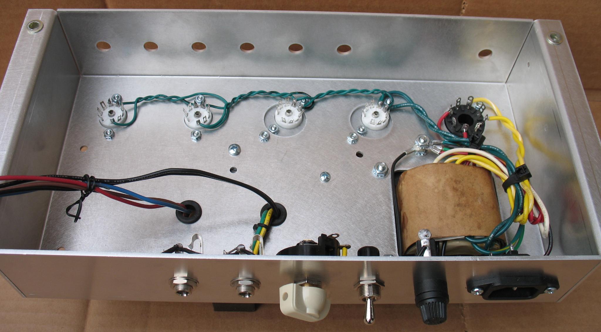

The chassis is pre punched with all the holes you see plus a few extra pot holes
There are 2 x 9 pin sized holes and 3 x 8 pin sized holes
I used 9 pin block off plates because I wanted to use EL84 power tubes - Page Link

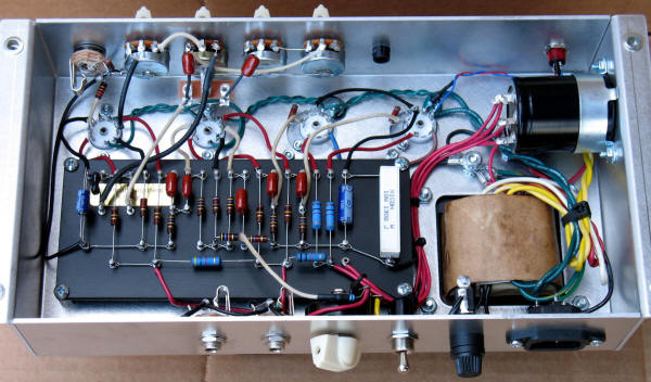

As I do a build for the first time, things are bound to change as I assemble the amp

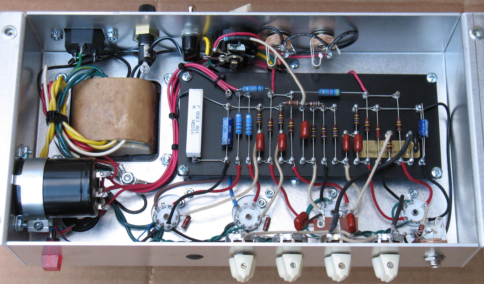

Some of the pictures below may be slightly different than the current Stout TMB turret board
note that I add the parts to the board after I have run all the wires to the tube sockets
I add the wires that go to the pots last because they are above the board
This results in a very clean looking board
All the parts have straight leads and there are no big solder flux blobs on the board

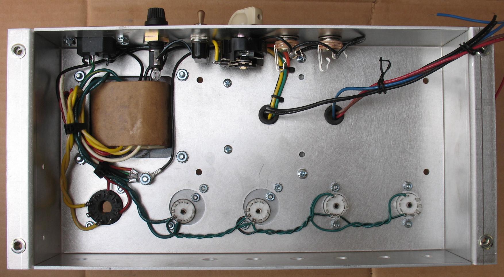

The back of the chassis has a rectangular hole for a IEC power cord receptacle - Page Link
A double D hole for a Fender style fuse holder - Page Link
Carling SPST On/Off switch hole - Page Link
Rotary impedance selector switch hole - Page Link
And two Switch craft speaker jack holes - Page Link

Inside look
Lookey how nice and clean it is :)
Hoffman Stout TMB
There's a bunch of stuff packed into this small chassis

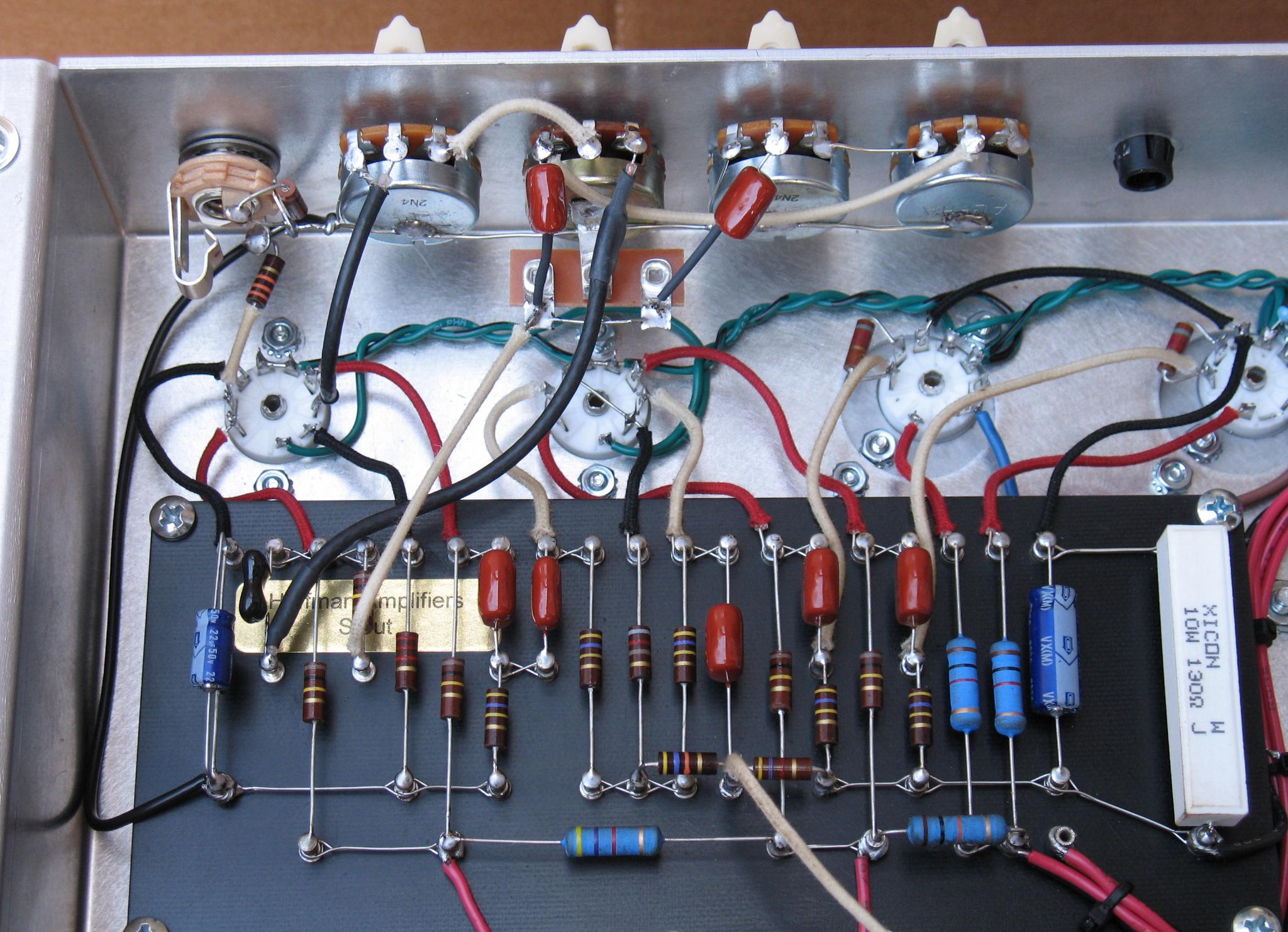

All the filter caps are contained in a JJ 40x20x20x20/500v cap - Page Link
The Turret board is a Hoffman Stout board version #1 - Page Link
I have since updated this board to include the parts for Treble, Mid and Bass
Other changes I made
 I moved a few lugs around to new places and shortened the board length
The updated stout TMB board is shorter and incorporates all the design changes I made during this build
Hoffman Stout TMB

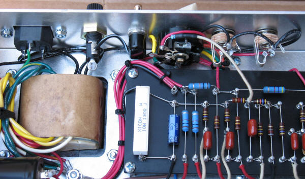

I decided to add Treble, Middle and Bass to the original Stout circuit
I added a 3 lug terminal strip to the back of the treble pot to have a place for the tone control parts
I attached the capacitors for the tone controls to the terminal strip
The new Stout TMB board now has these caps on the board so the terminal strip is not needed
Hoffman Stout TMB
One change I made to the Stout TMB design was that I added some negative feedback
This tamed the high end harshness and reduced the amp hum level in the original Stout circuit
You can see the feedback resistor leaving the rotary impedance selector switch and going to the board

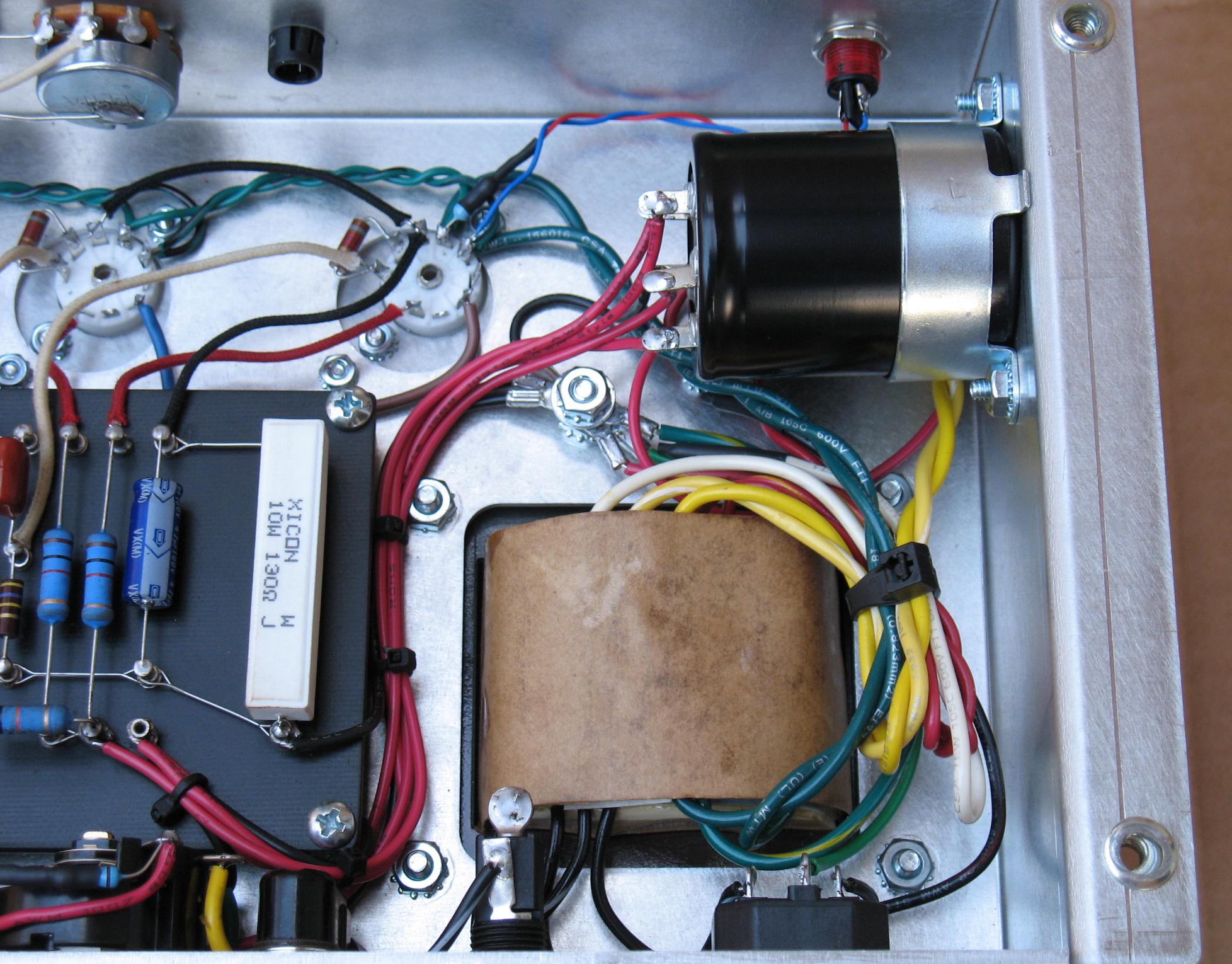

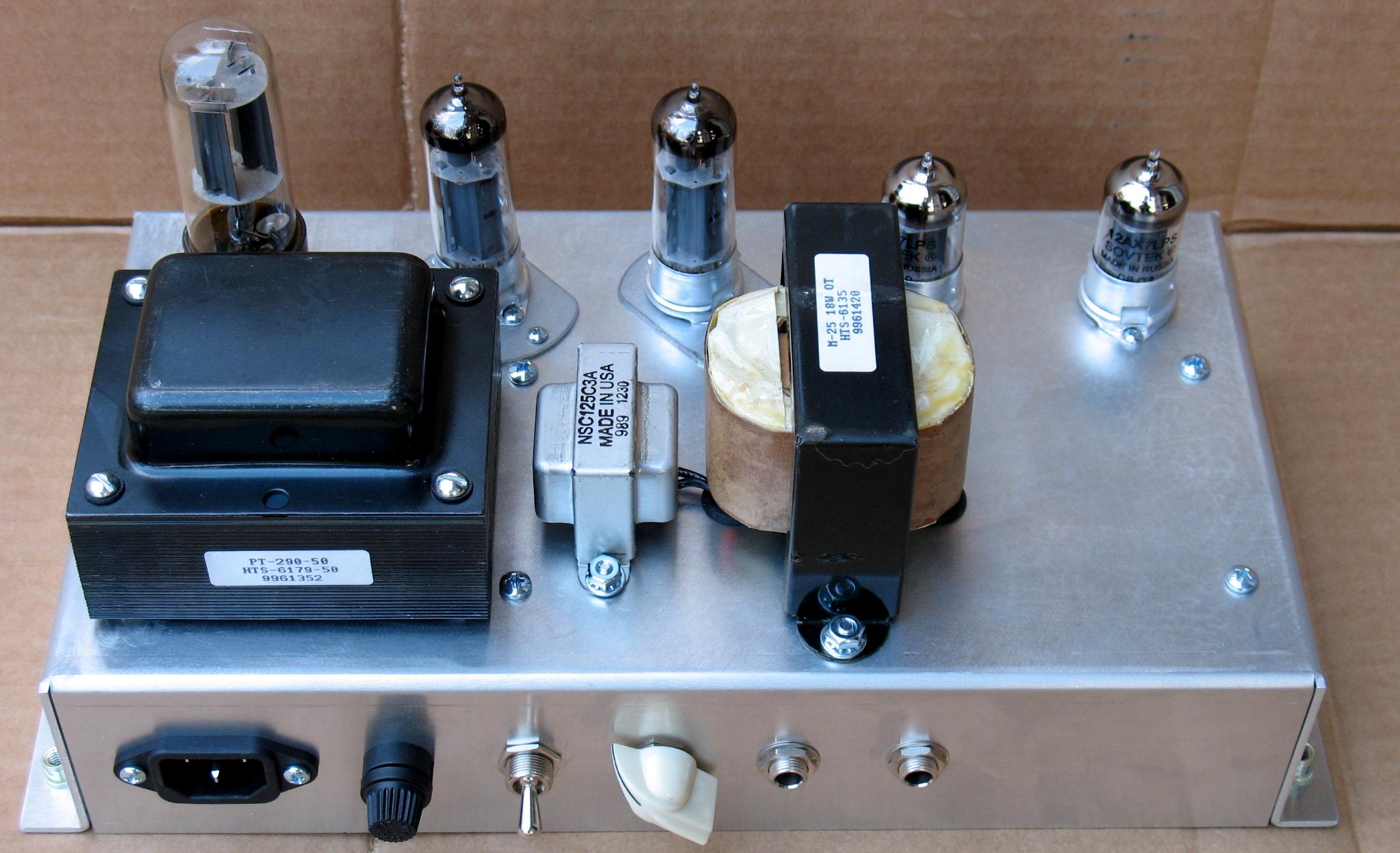

Here's a shot of the Heyboer 18 Watt power transformer and filter cap

I mount the transformers, tube sockets and back panel items first
Hoffman Stout TMB
Hoffman Stout TMB
