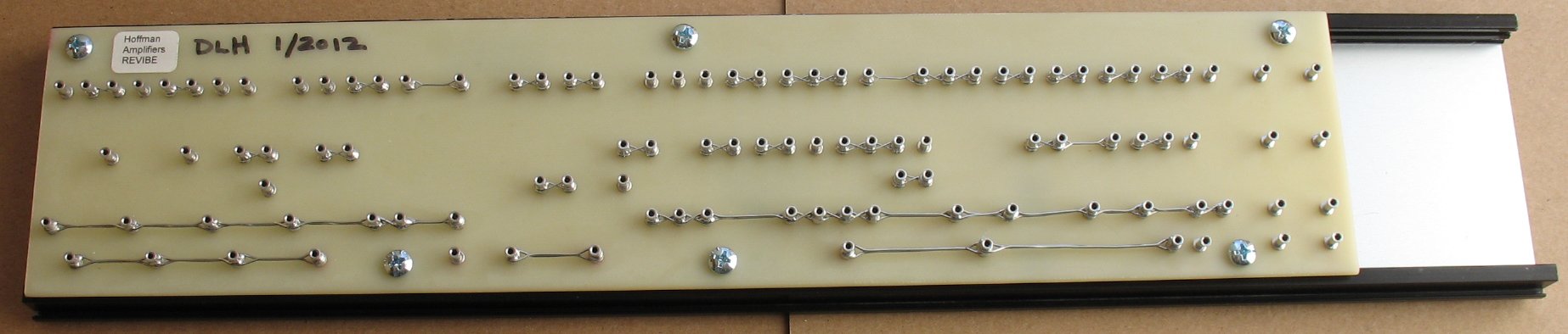

This is one of my pre-drilled ReVibe boards with all the lugs installed
The lugs have been laced together.
The board has been mounted to the bottom of the rack floor with 1/4" standoffs, 5/8" # 8 screws and #8 keps nuts

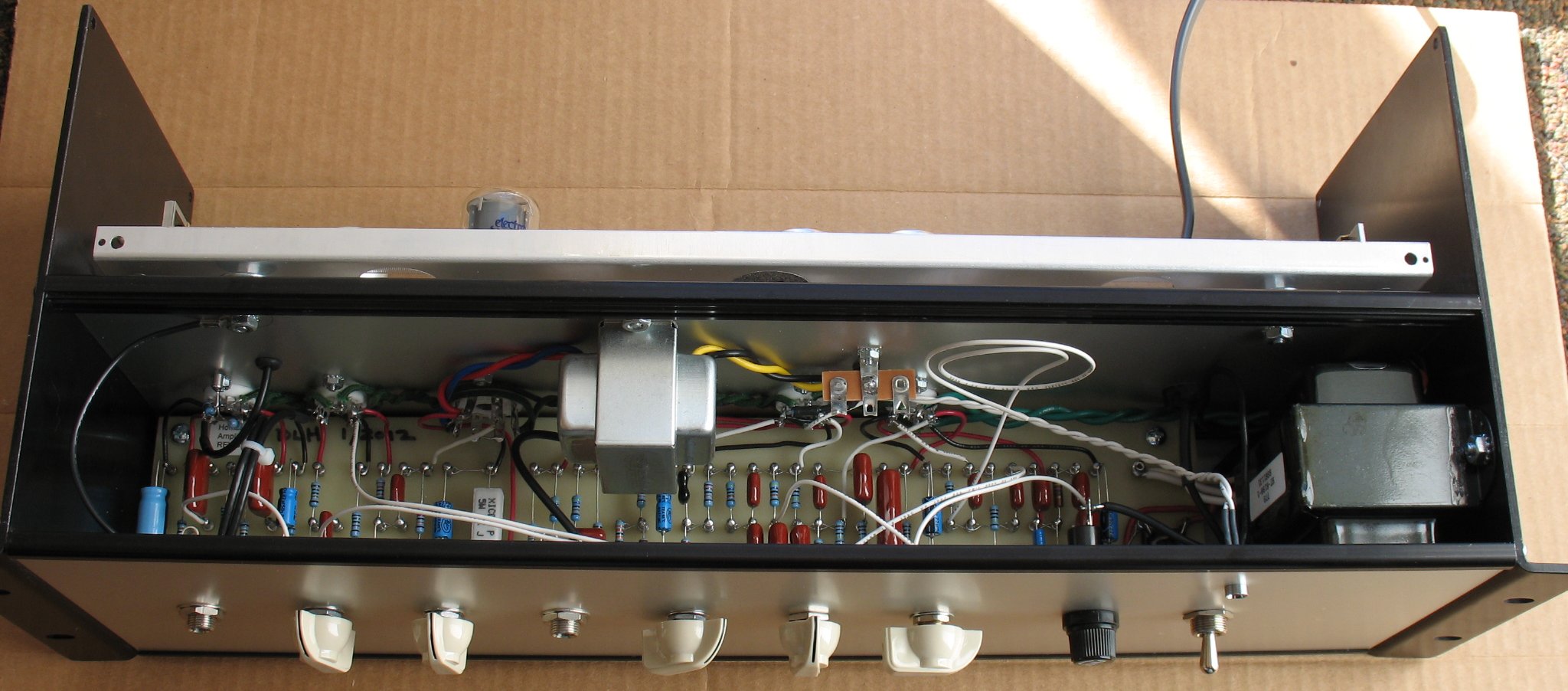

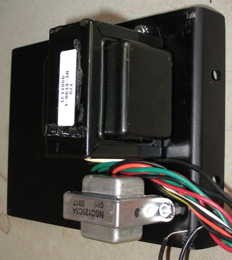

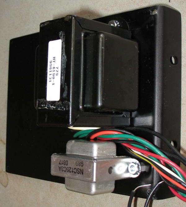

I mounted the power transformer and choke on the right side rack piece
Click on the images to see larger images

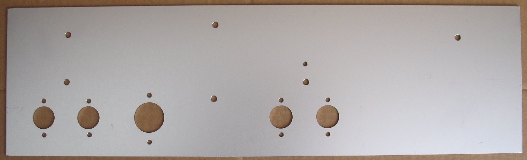

This is the back panel after if was cut on my CNC machine
The back panel has been attached to the rack sides

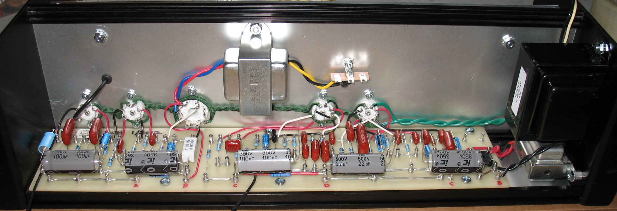

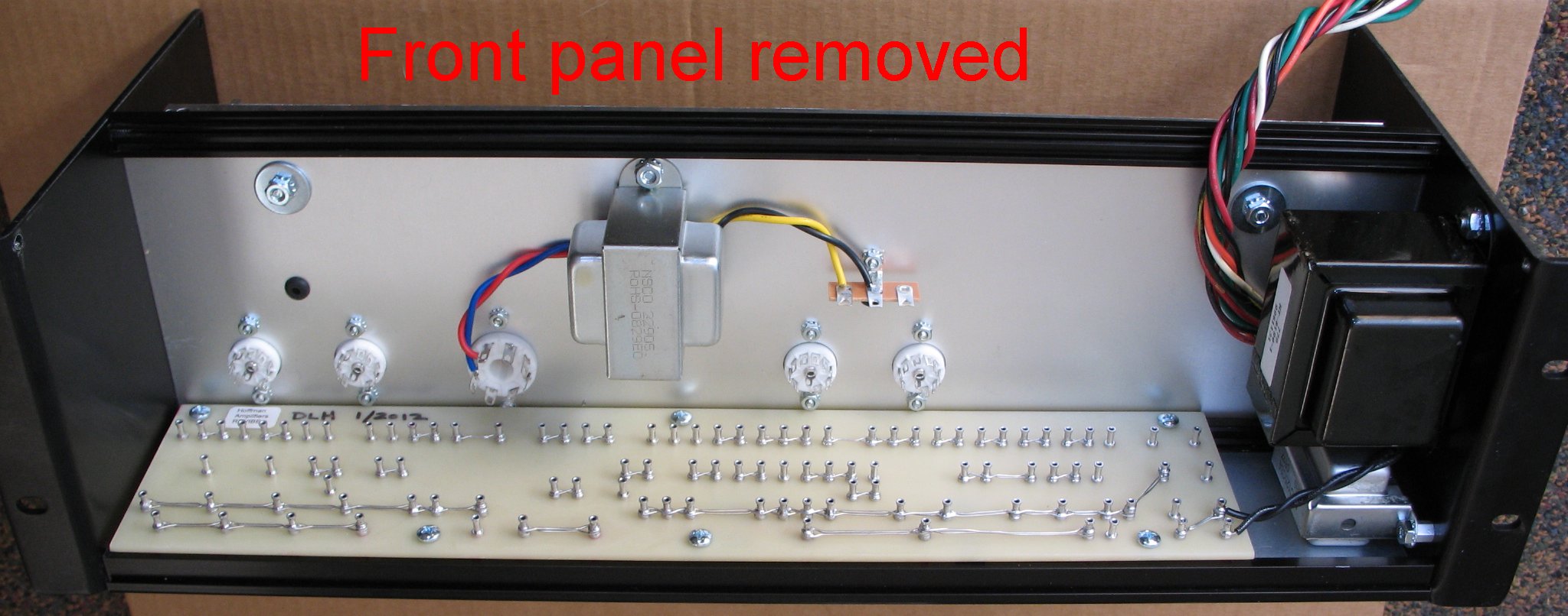

The tube sockets are bolted in using #4 screws and nuts
The output transformer is bolted in place between the 6V6 and the first vibrato section tube
Now you can see how the power transformer and choke sit right next to the board

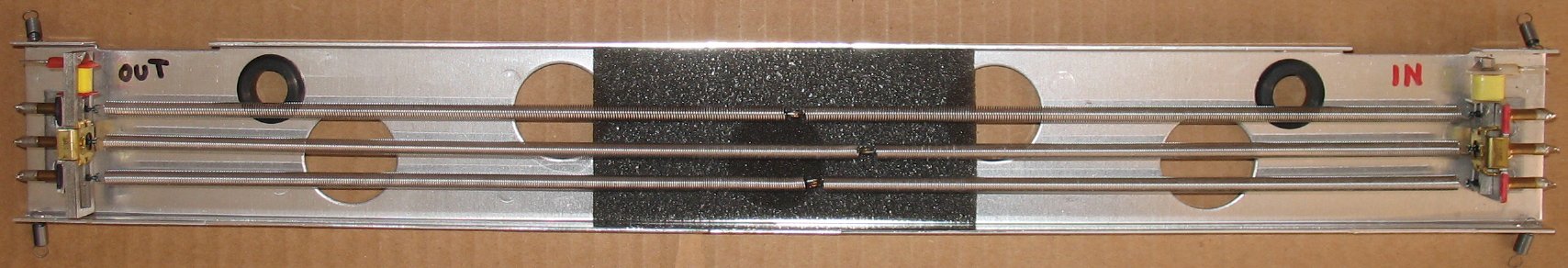

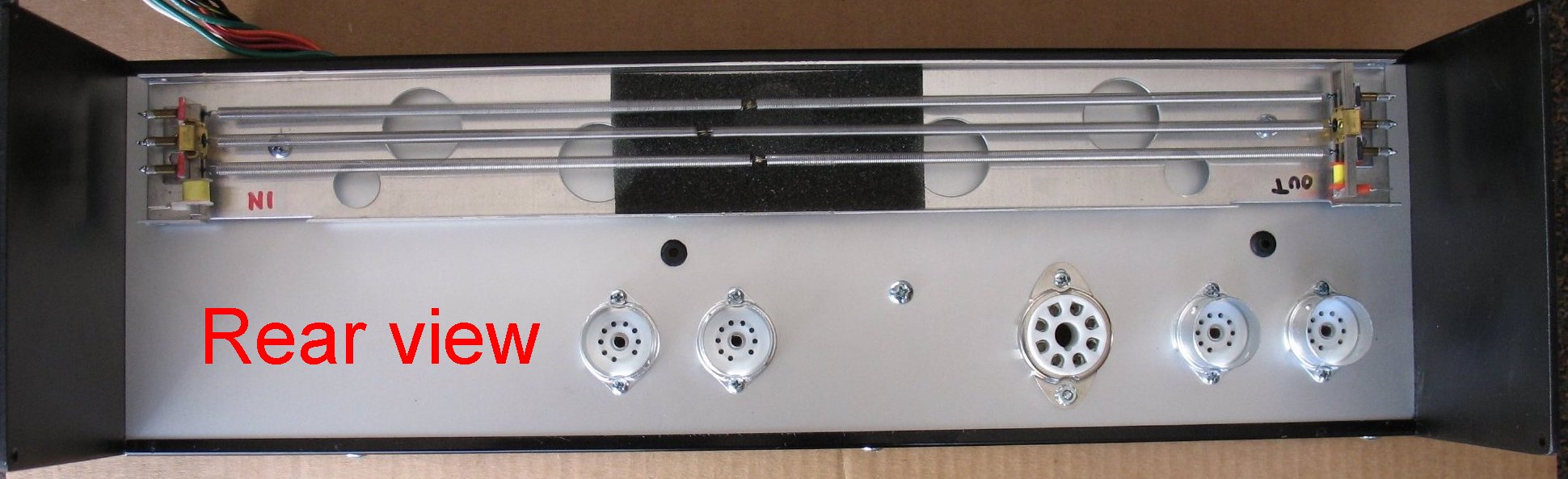

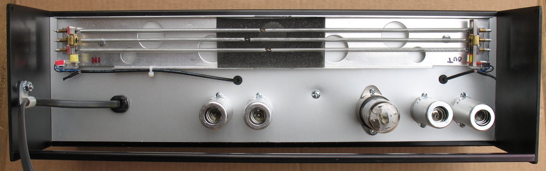

I removed the center spring assembly from a 9AB3C1B 3 spring reverb tank

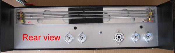

This is the rear view of the back wall
The reverb springs sit right above the tubes
The output end of the tank needs to be as far from the power transformer as is possible to avoid hum.
The input end is less critical because the signal level is much higher than the output end

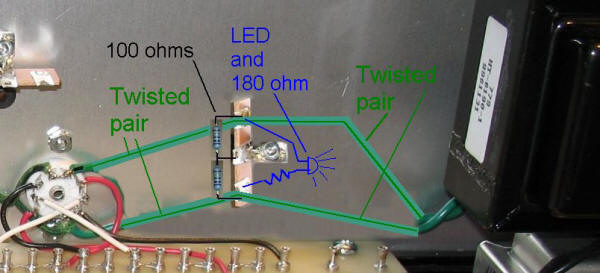

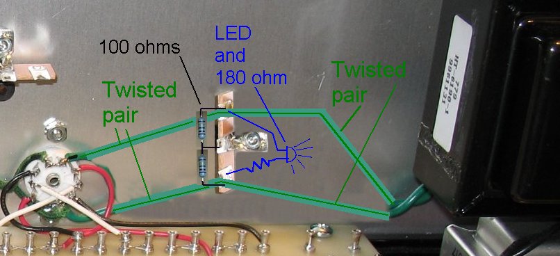

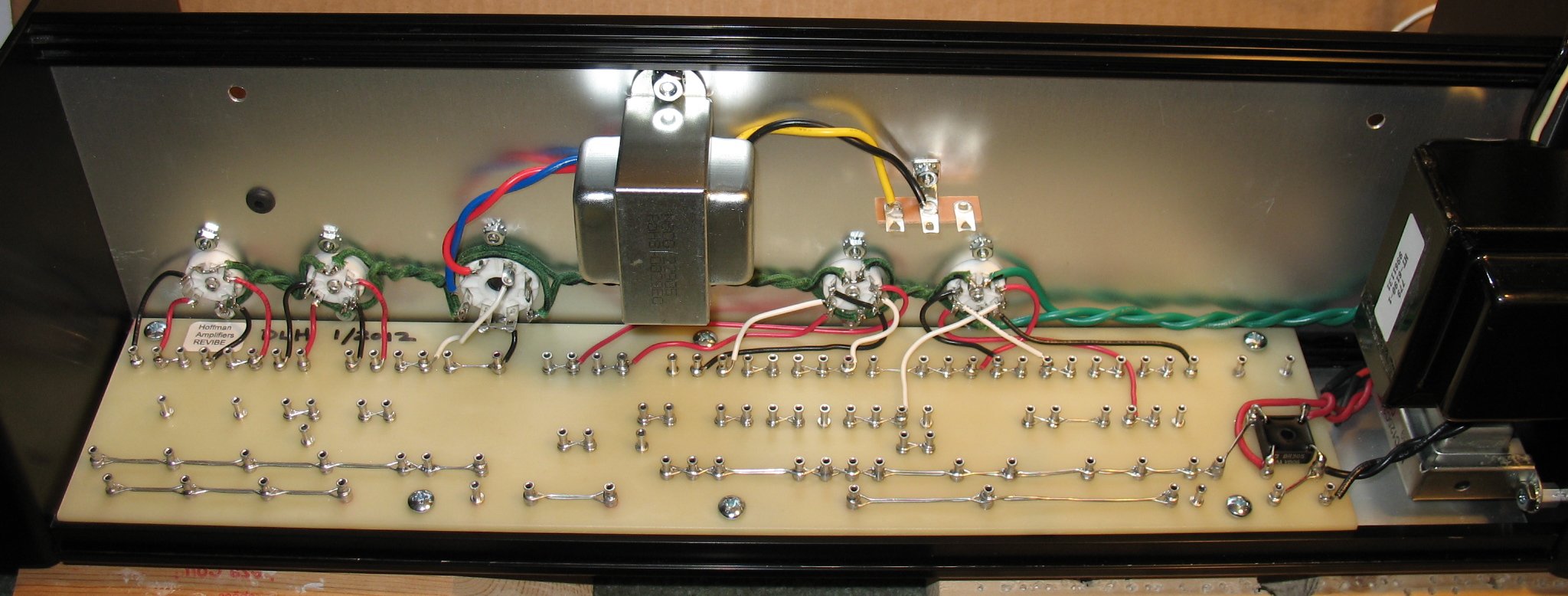

The tube sockets have been wired up
The heater string has been wired up
Note that I would run the heater string differently next time.
I would insert a 3 lug terminal strip right after the power transformer
The green heater wires from the power transformer would go to the terminal strip
From the terminal strip you will have 2 sets of wires leaving
One twisted pair goes on to the tube sockets
One twisted pair goes to the LED pilot light
On the terminal strip you can mount the two 100 ohm resistors to make the artificial center tap
The foot of the 3 lug terminal strip is bolted to the chassis and makes the ground for the 2 x 100 ohm resistors.

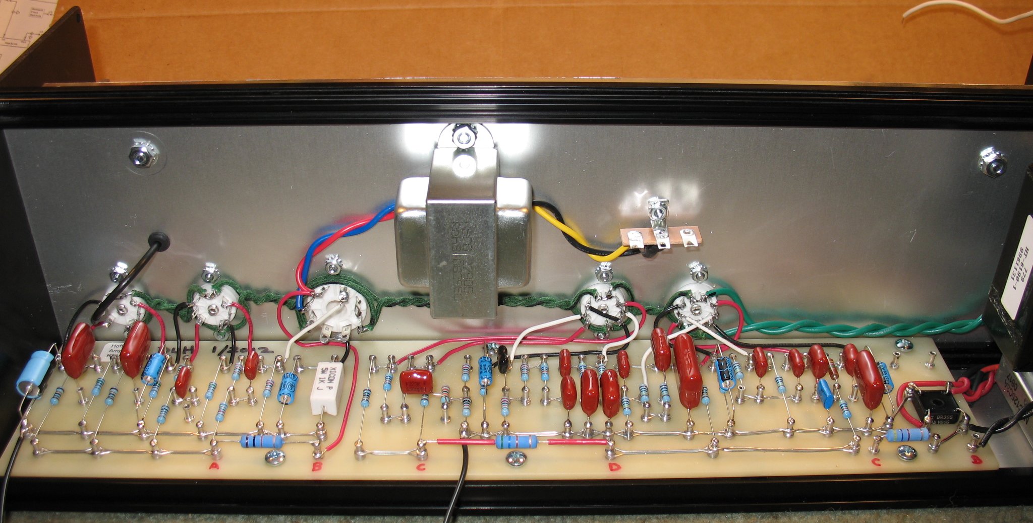

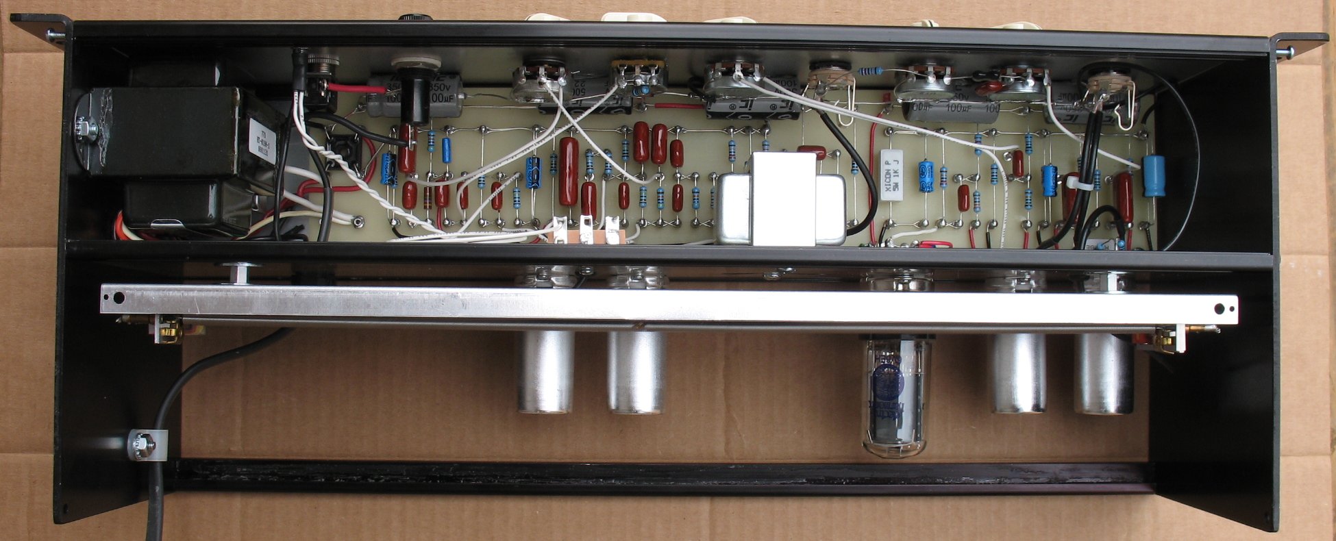

The parts have been installed on the board
Note that I do not put and solder on the lugs where pot wires are to be inserted later

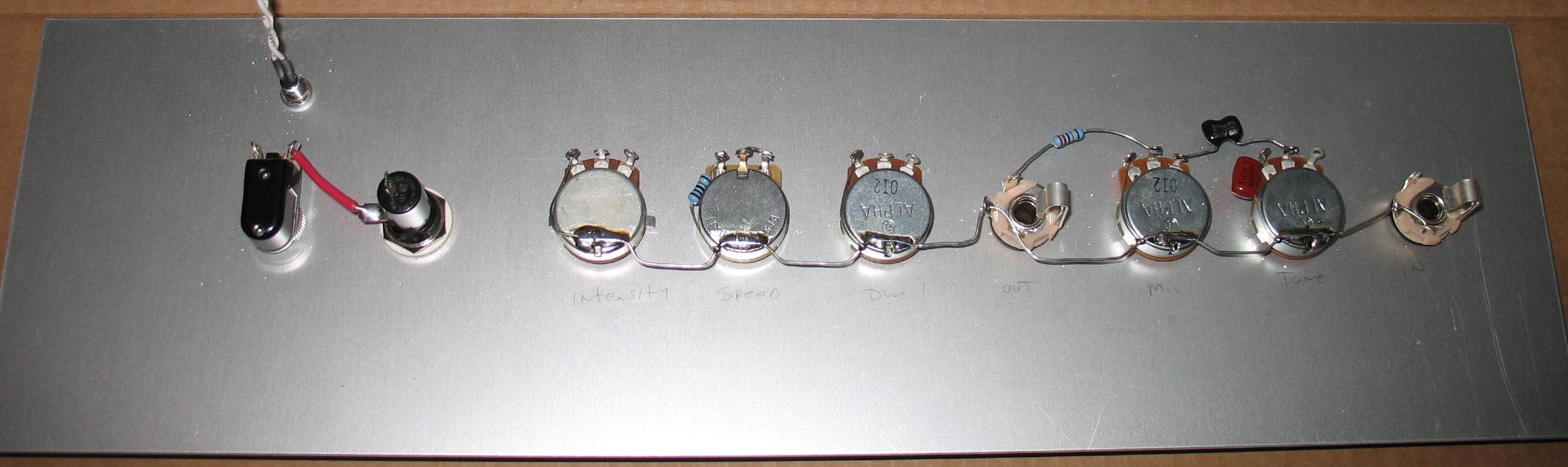

The rear of the front panel
The pots have a soldered buss wire running down the back
Note that the speed control is wired wrong in this image
I also forgot to add the 1 meg resistor on the input jack
The layout diagram shows the correct wiring for the pot string

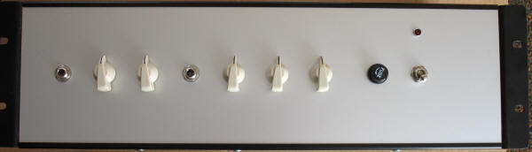

The front panel
The filter caps have been soldered the correct lugs
the negatives of each cap go to the buss wire on the back of the pots

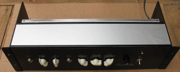

Top view
Another top view

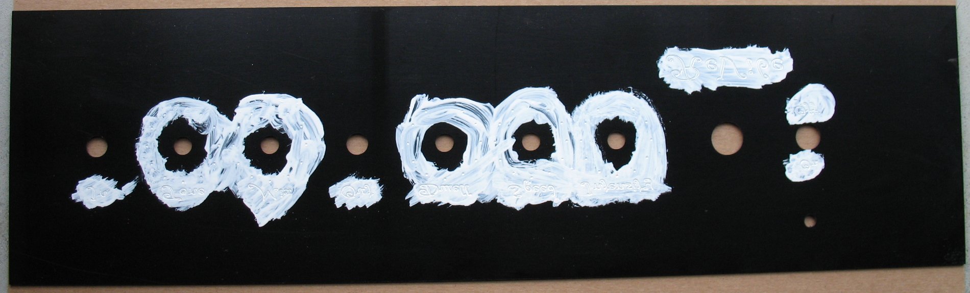

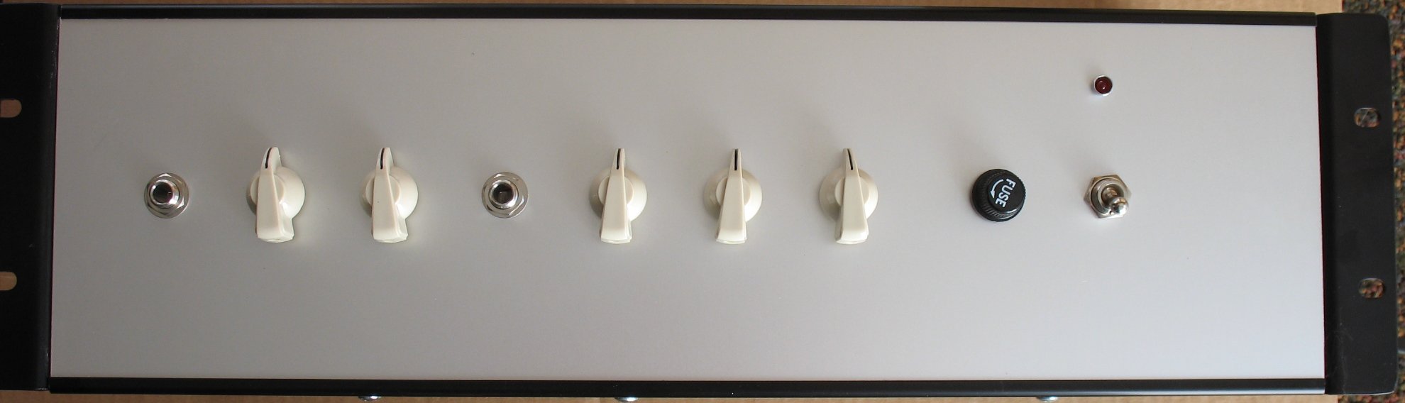

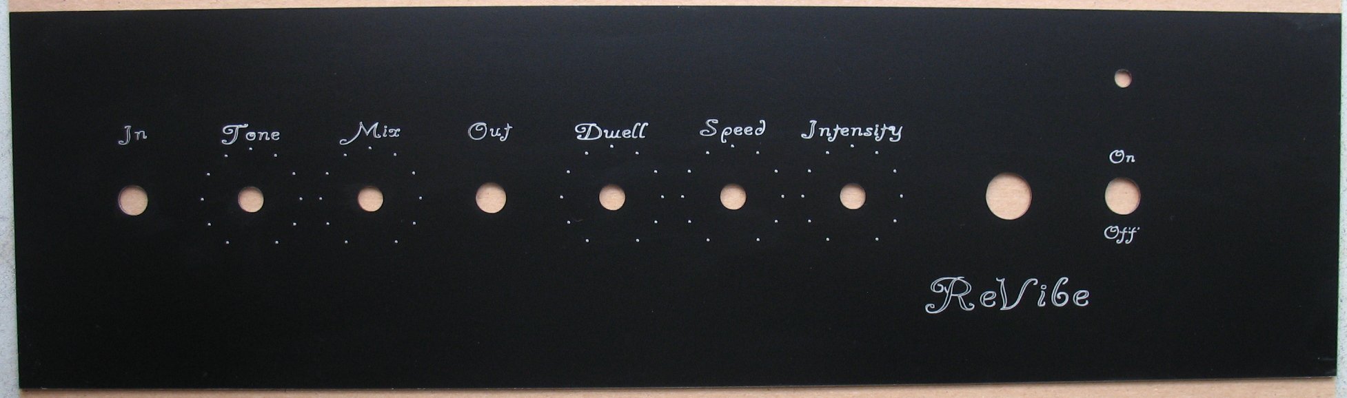

The face plate I made on my CNC machine
Please don't ask me to make face panels
They are a royal PITA to make
Sign shops have the right machines to make face panels
The face panel is rear engraved and then white paint is smeared on
The material is a clear and black sandwich
You engrave through the black just a tiny bit into the clear
The front clear side is smooth to the touch

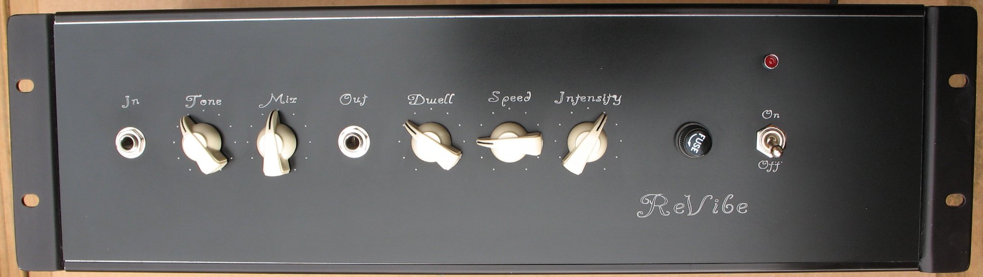

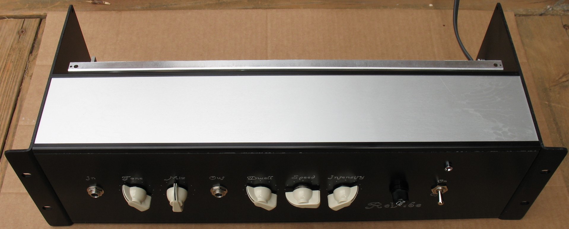

And here's the ReVibe with the face panel glued on
The top lid has been installed

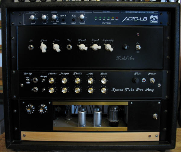

Here's the ReVibe sitting in my rack
From top to bottom:
Palmer speaker emulator/Load box
ReVibe
My Stereo guitar tube pre amp
My Stereo EL84 power amp
