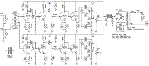

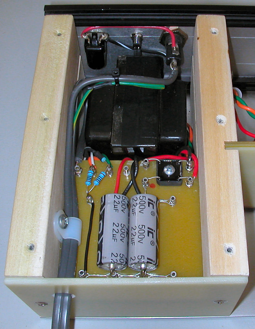

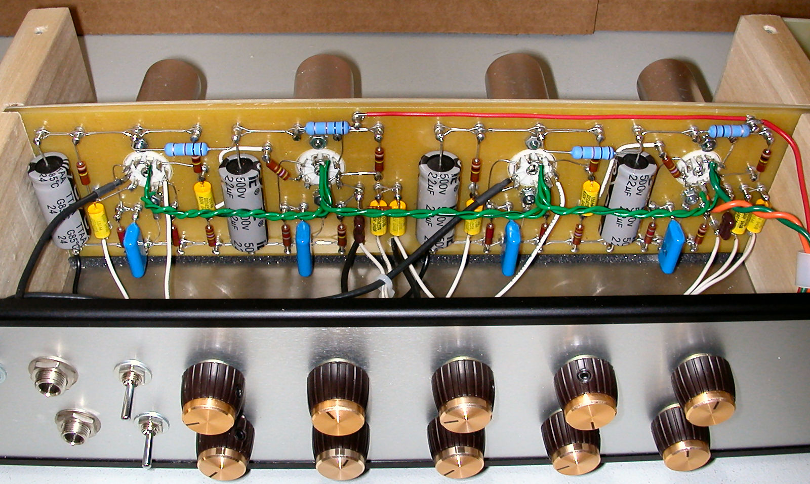

| This project is an all tube stereo Guitar pre amp is a 2 high rack unit. The stereo outputs let you do ping pong delays and other true stereo effects such as chorus. I happened to have a few pieces of a rack unit laying around and so I pieced together what I had and used some poplar to make the wooden parts. If you purchased a 2 high rack unit, you would have to figure out how to make a divider |

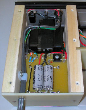

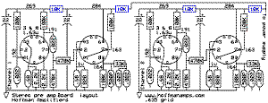

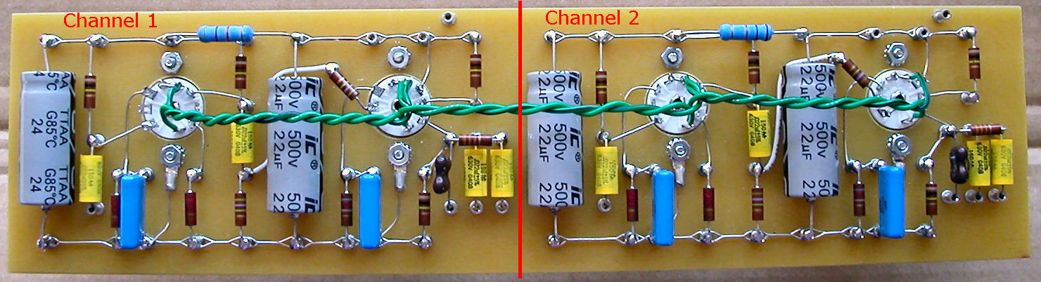

| Here's the board with the lugs mounted | The board with parts mounted |
| Click on the images below to see a larger image | |

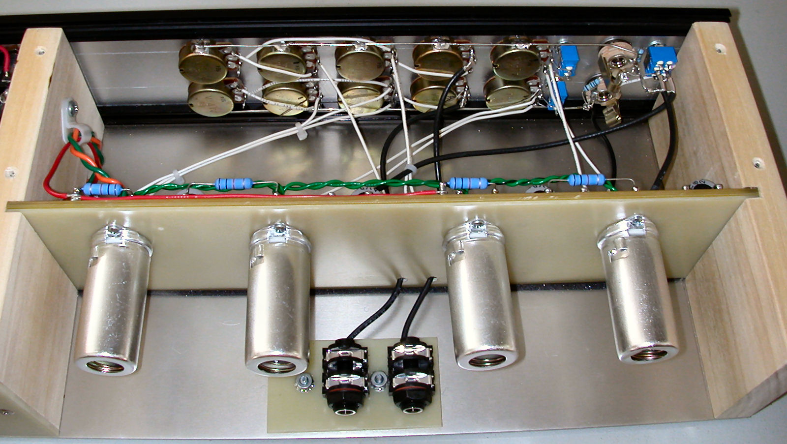

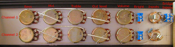

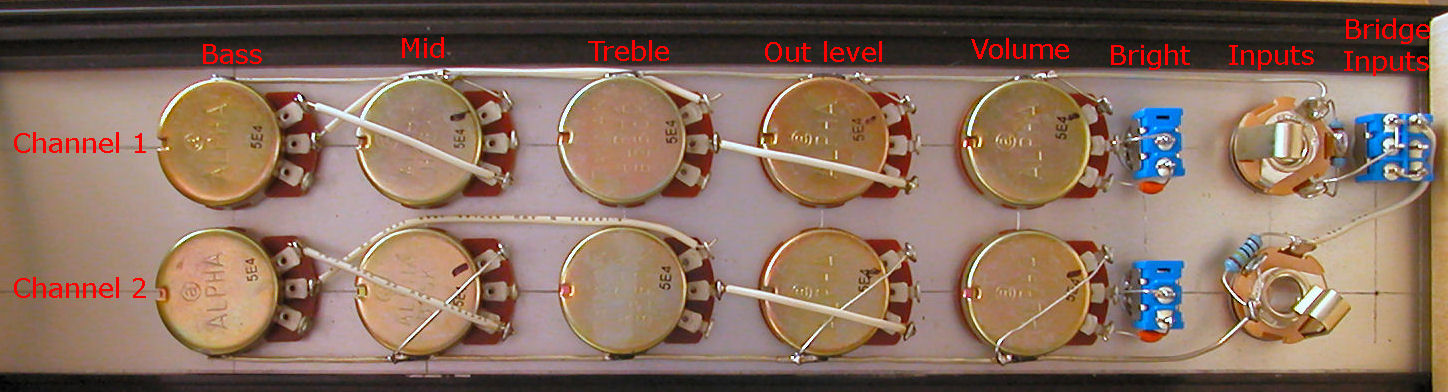

| Rear view of pots. The bridge switch lets me plug into channel one and the guitar signal is then fed into both channels. Other wise each channel is separate when the switch is off. |

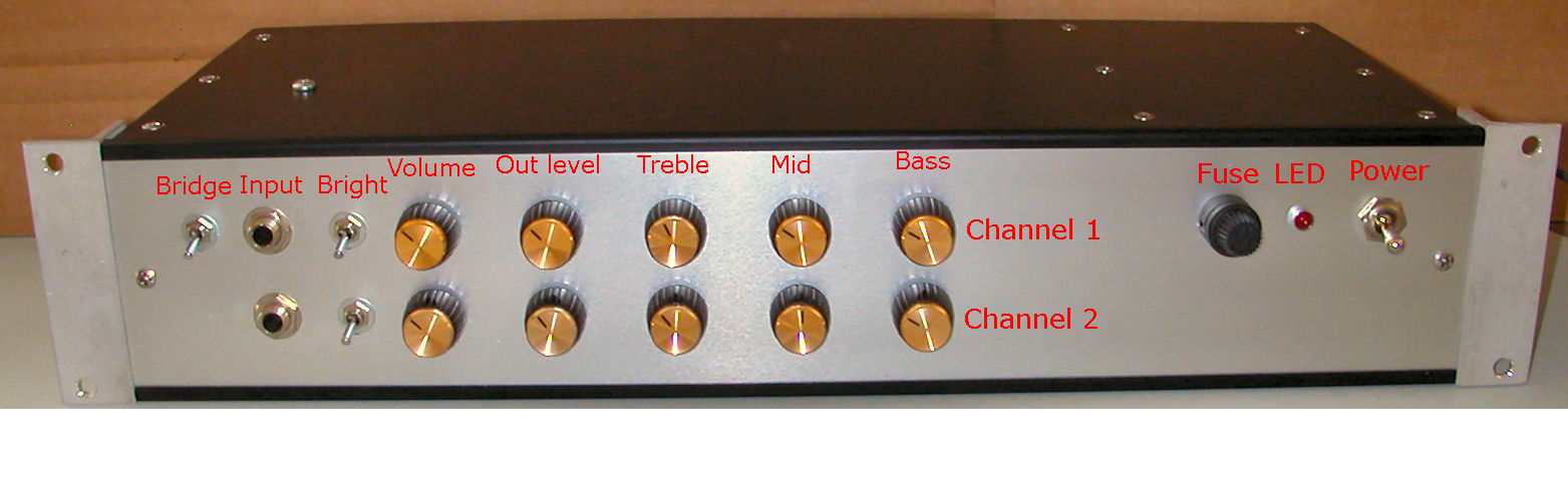

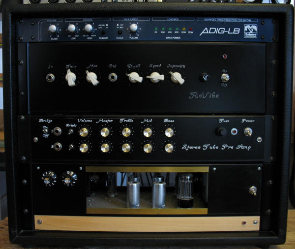

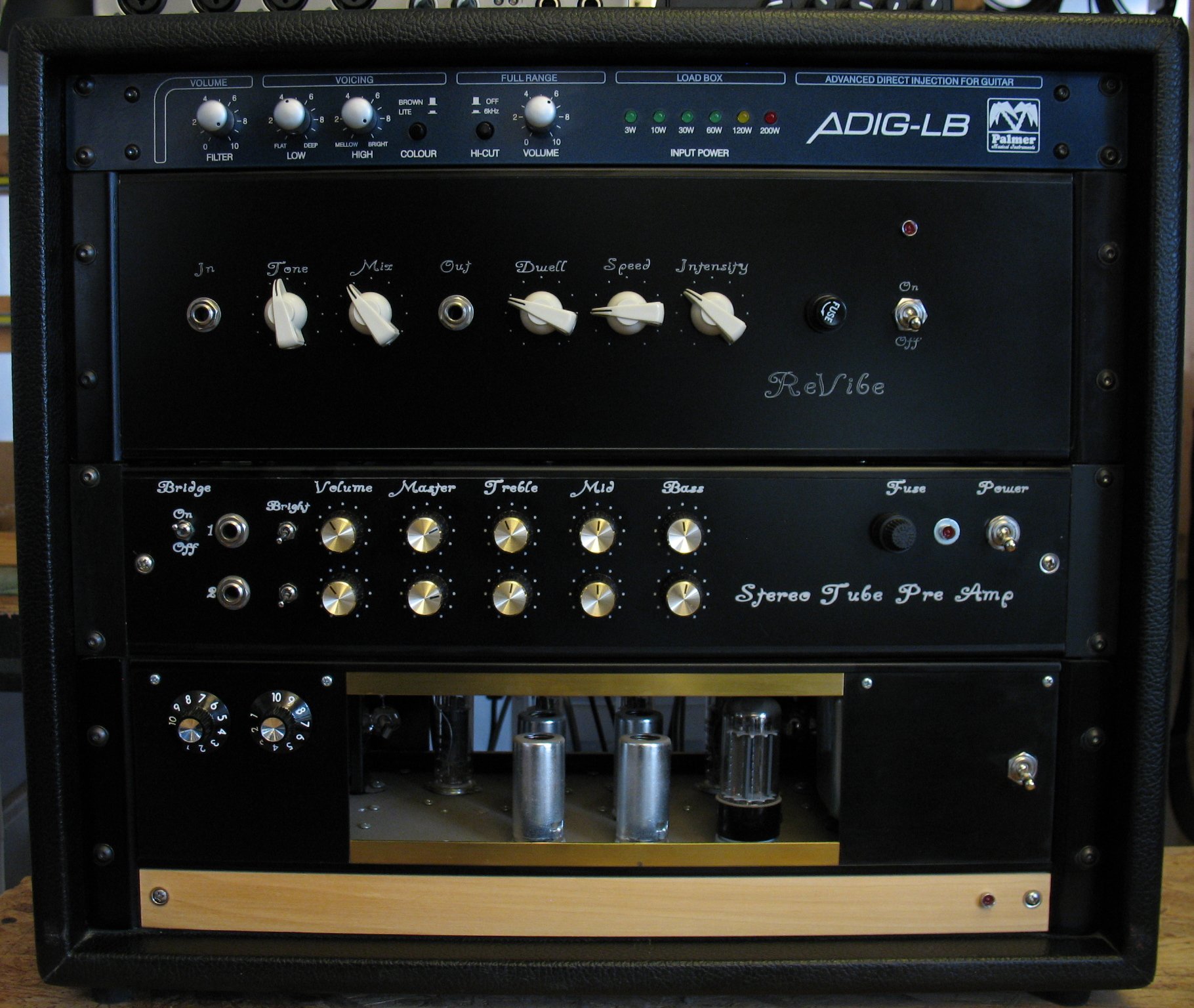

| Front view | Rear view. The jacks are the outputs for each channel. |

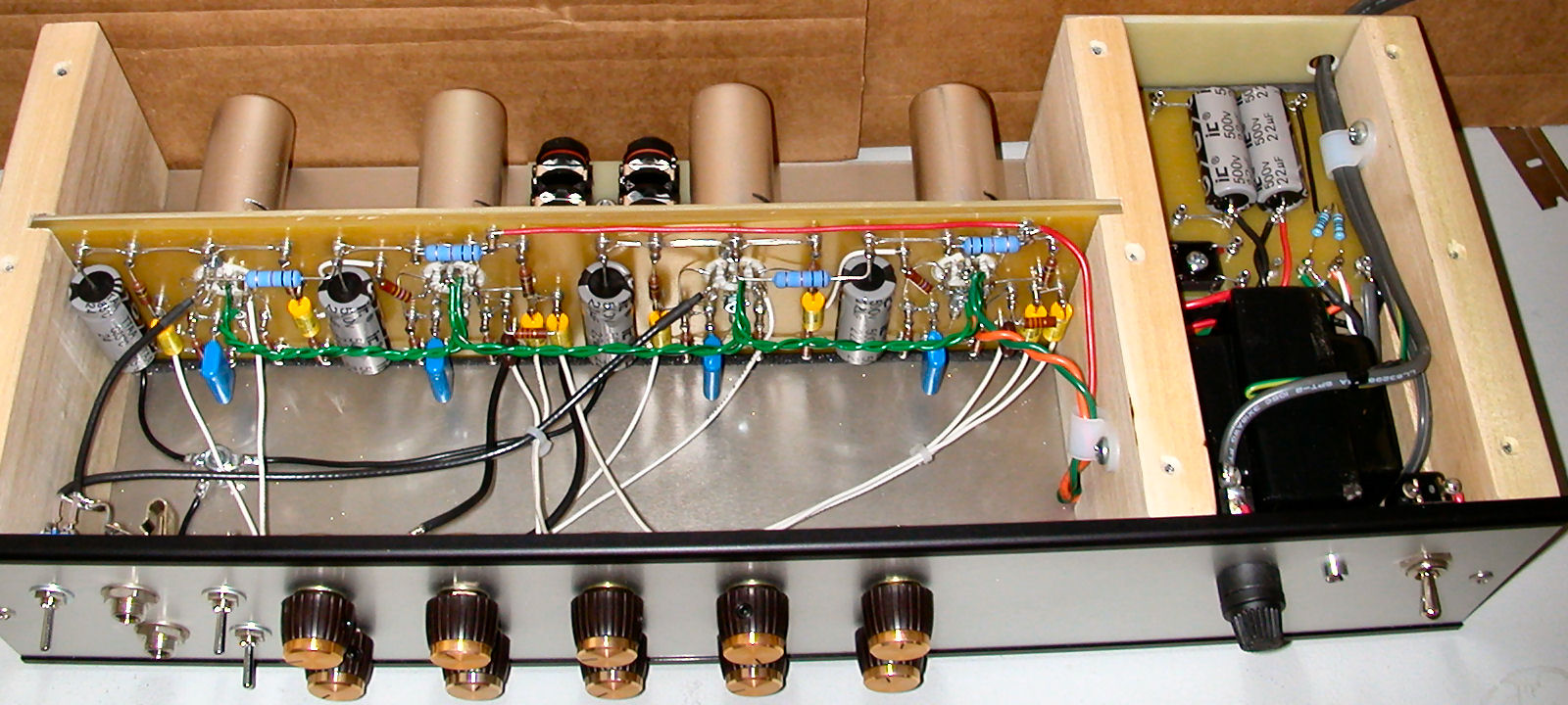

| Completed inside view | External view without Face Plate I made the rack ears from 6061 aluminum |
